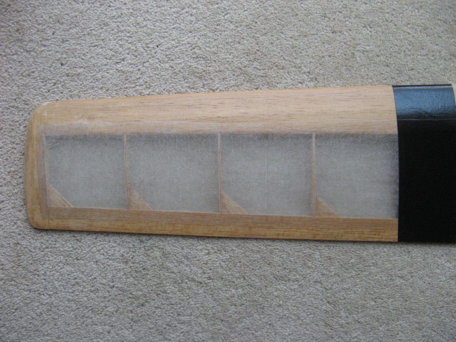

Carl, with the Soarcerer, you could recover with laminating film then tissue over the top, but you would lose the original tissue finish & appearance. Alternatively, if the tissue is sound, apply the laminating film over the top. I've done this with an old fuselage with reasonable success - kept the original appearance but improved the durability enormously.
Tack the film down around the framework with the iron then judiciously shrink/heat with a hot air gun while rubbing the film onto the underlying tissue with a soft cloth (or thick cotton garden gloves). Experiment on something "sacrificial" first!

I would agree with Wayne but definitely laminating film UNDER tissue. Personally I just don't like the look of shiny plastic film on vintage or retro models..... It just doesn't look "vintage"! But clear laminating film is virtually invisible under tissue and of course makes the tissue much more durable. I recovered my Monterey this way and it looks just the same as the original plain tissue covering though in this case I only used film on the open structure part of the wing and you can just see the edge of the film under the tissue. If I were to do it again I would film the entire wing before tissueing.

I did this with my Pushover wing and has proved incredibly durable. The only thing I've found though by going over the entire wing with mylar first is the tissue hasn't adhered well enough at the very edge of the trailing edge and lifted a little in a couple of places. So the next time I use this technique I'll leave a few mm so the tissue adheres to the wood on the edges. It may be because I use Eze-Dope. I will shortly be covering a new KK Gipsy I've built with electric power and RC and will see how it works out this time.
