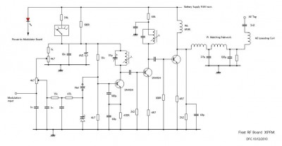

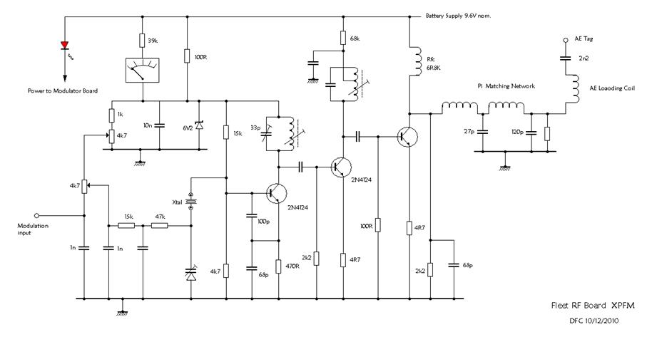

I have found on the NORCIM website a circuit schematic for one of the Fleet systems. That shows a 39K resistor between +ve and the meter. Based on my rudimentary electronics that seems to give the right sort of current. The schematic shows the –ve side of the meter going onto various other components which are part of the transmitter circuit. Do I need these or can I go straight to –ve from the meter without risking damaging it?

Many transmitters used the meter to display the RF output of the transmitter rather than the battery state. I think that Fleet circuit is doing that.
If you're using the same meter to monitor your battery then I think a 39K won't be enough.

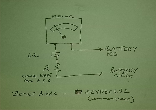

you might be better off using a 6v2 zener so you get an expanded scale reading.
I use this circuit regularly and its perfect for a 2s
Circuit courtesy of Phil

In the Fleet diagram the 100 ohm resistor and the 6.2v zener do just that Ron, so 39k resistor current is:
(battery - 6.2) / 39000 so if your battery is by some lucky chance 10.1v :D
its 10.1 - 6.2 which is 3.9v divided by 39000 ohms is 100uA, and its a 100uA FSD meter.
The meter full scale deflection (FSD) is therefore 10.1 volts and zero deflection 6.2 volts.
39k is good for that particular 100uA meter in the diagram Doug, there was no 'standard' meter so yours might be different.

Ah, so I was wrong about it being an RF meter in the Fleet circuit diagram. I do wonder why they drew the meter and its associated zener/resistor there in the circuit diagram all mixed up with the RF circuitry rather than putting it off to one side to make it easier to understand. I suppose it was because the 6.2V rail was used for other stuff besides being the lower voltage side of the meter connection, but it could still have been laid out more clearly.

Ok I think I’m following this! The 6.2 zener creates the 6.2v rail Martin mentioned. The 100Ω resistor provides the correct current for the zener and the 39KΩ provides the right current for the meter based on the voltage drop created by the zener?
The bits to either side of the zener are parts of the RF circuit?
The diagram was drawn by someone who essentially reverse engineered it from a complete board. I’ve found it very helpful in some ways but not in others. In amongst the meter and LED shown top left there is what I believe to be a DPDT switch although all the pair of terminals are joined at the back so it is effectively a SPDT switch. There are multiple wires connected to this for various different purposes. I’ve been trying to trace them to help me figure out what was happening with the meter. With the answers on this thread I’ve realised I’ve missed something and I think I know what now. :idea:

Does Rons picture show the right layout. From what I've read you would normally have 8.4v, the resistor then the zener with the meter wired + to 8.4v and - to 6.8v. Hope that makes sense, might be easier for me to draw what I'm thinking!
Ignore the above I've worked out that it's me being thick again! :oops:

I was converting my Sprengbrook tonight and when I got to doing the meter, I thought maybe a video...
This isnt limited to retro-transmitters of course but its a question that is frequently asked...
When we run a battery 'flat' its not completely exhausted, but it is down to the minimum that our equipment is happy with to run properly & predictably.
For the common 2S lipo or LiFe that we use a lot in transmitters, the useful voltage range is 8.4v when full, to 6.2v when flat. You could run lithium cells down below 3.1v per cell but utimately this would damage the cells.
So ideally, a battery meter would read from 6.2v to 8.4v across the full travel of its indicator needle.
To do this we use a zener diode and a 'multiplier' resistor in series with the meter. The zener directly determines the low reading, ie 6.2v with a 6.2v zener. For the upper end of the scale, subtract the zener voltage from the desired full scale voltage, say 8.4v - 6.2v = 2.2v
The meters FSD current is usually printed on the rear. In my case its a 100uA movement so using ohms law we can find the value of the multiplier resistor:
R=V/I
R=2.2v/.00001A = 22k ohms.
For the Sprengbrook I decided on a full scale of 10 volts as I've been testing using a PP3 Duracell:
For the upper end of the scale, subtract the zener voltage from the desired full scale voltage, 10v - 6.2v = 3.8v
The meter is (say) a 100uA movement so using ohms law we can find the value of the multiplier resistor:
R=V/I
R=3.8v/.00001A = 38k ohms (nearest 'preferred' value is 39k)
One more example for say a 9.6v NiMh. Fresh off charge these can reach over11 volts, and you wouldnt want to go below 1.1v per cell, ie 8.8 volts. So a scale of 8.8 to 12 would make good use of the meter range. For the low end we use an 8.8v zener (or the nearest standard value). For the upper end of the scale, subtract the zener voltage from the desired full scale voltage, 12v - 8.8v = 3.2v
R=V/I
R=3.2v/.00001A = 32k ohms. Actually 33k is the nearest preferred value.
Just substitute your own preferred upper & lower voltages, and choose a zener voltage and resistor value to suit. Or choose the 'low end' zener and use either a preset pot or a selection of 'test' resistors to set the upper range if you're not sure of the meter FSD current. Start high and reduce the resistor to give FSD at the desired voltage.
Note that the banded end of the zener goes towards the battery positive.
