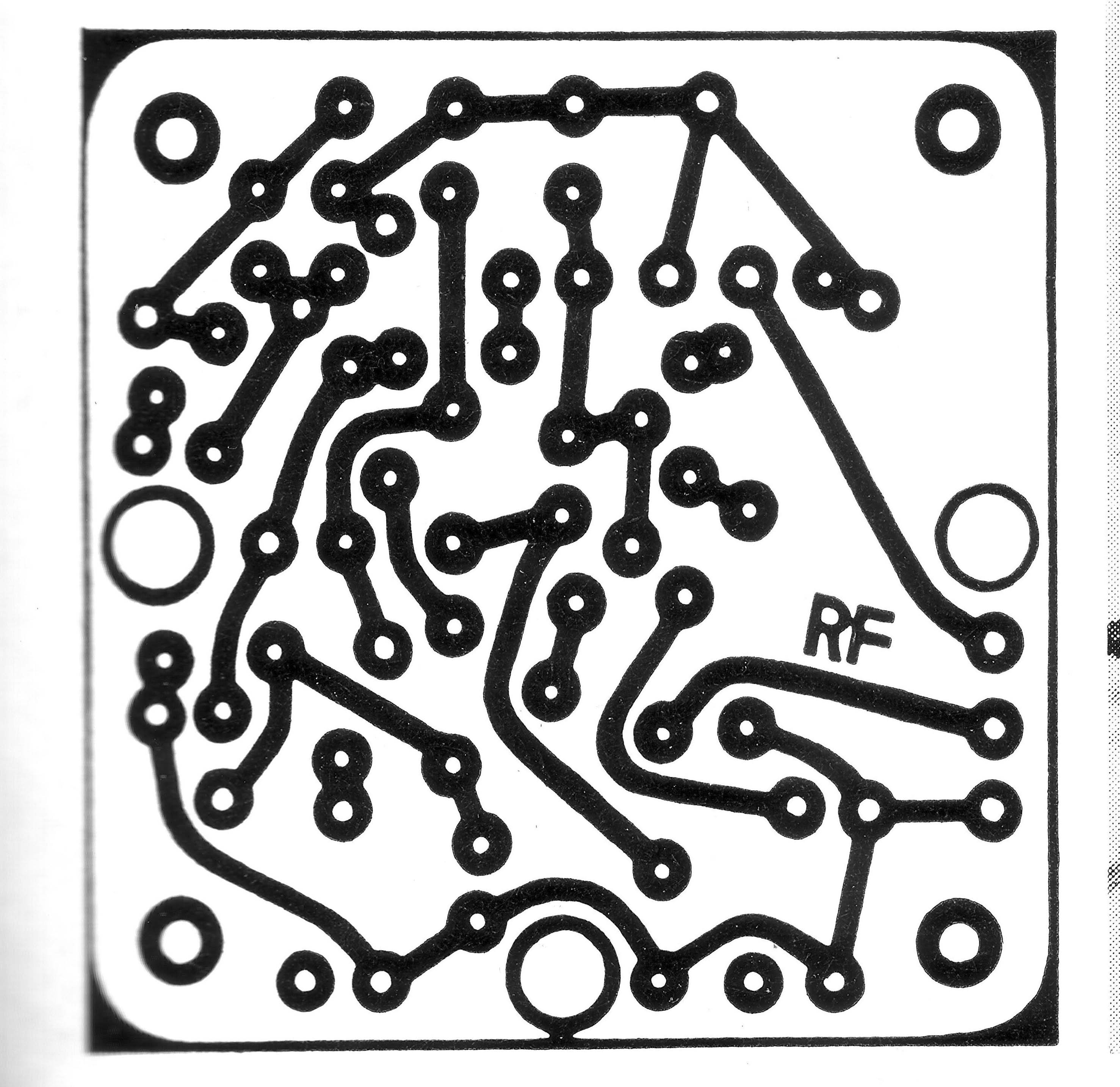

I'm scaling an image of a PCB for manufacture and the only known detail I have is the 4 board fixing screws.
It mounts on the back of a HB stick unit. Anyone Know the centre distances of these holes?
Clive

Which pcb Clive - is it the stick mounted GG pulser from RCM&E?
- Posts: 1059
Re: HB stick units
Here you go Clive . Mounting hole centers (vertical and horizontal) are 1 3/4". I didn't mount mine on the back of the stick unit as shown in the article. As I used and old MacGregor 2 channel single stick case, I just mounted the board to the tx case..

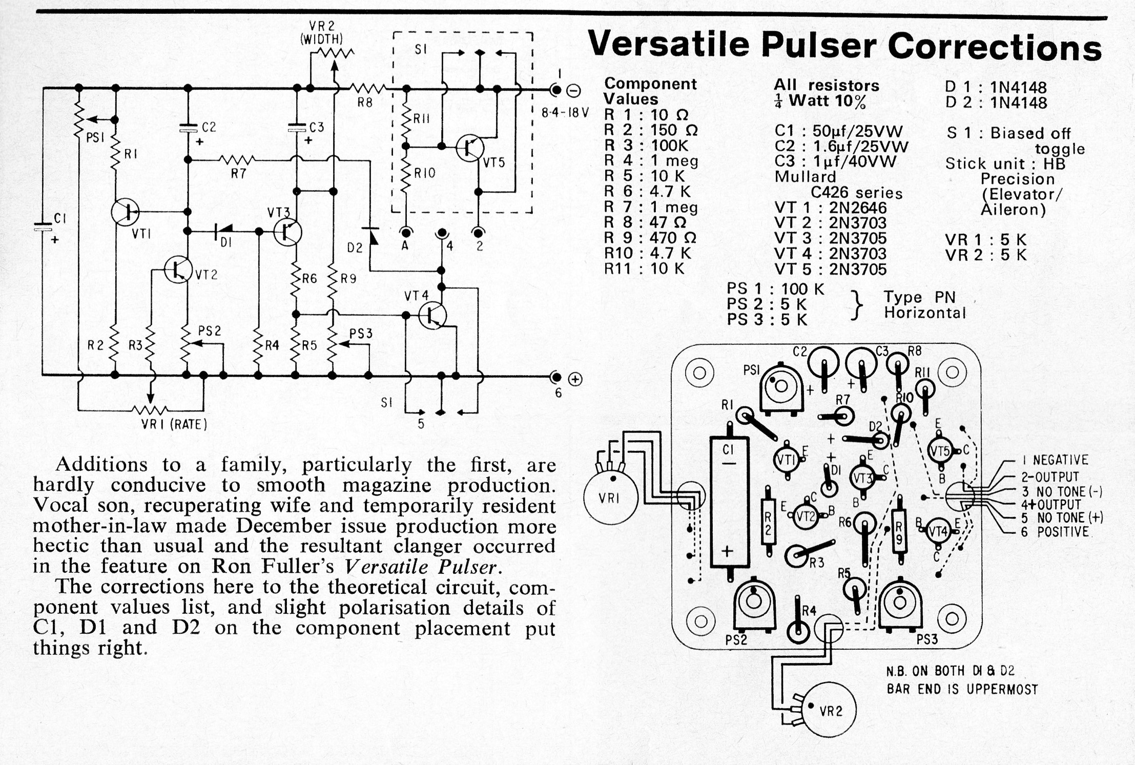

And don't forget they printed some corrections in the Jan RCM&E.

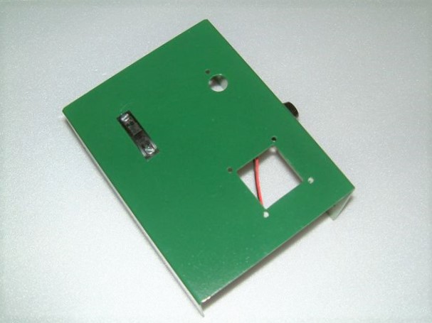

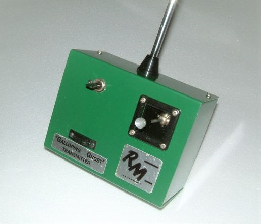

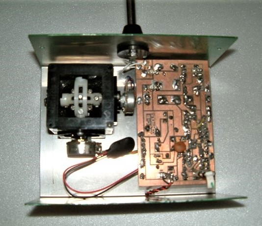

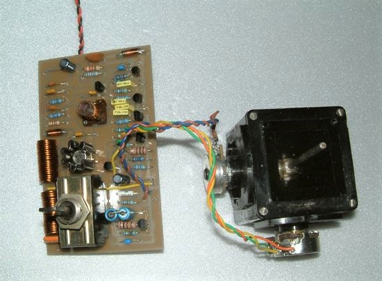

Here's a few pics of the Radio Modeller GG set I built a few years ago.. This one works fine as well..
Case was from Maplins.. good job I bought a few of them
