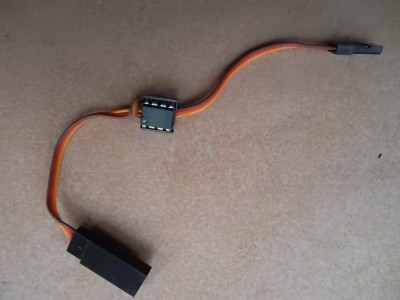

If its still a problem, some years ago I used to make servo-stretchers for the FPV camera lads,
https://www.rcgroups.com/forums/showthr ... e-easy-way
Its 1uS resolution, replaces any out-of-spec pulses with last-known-good and does a bit of filtering for smoothness. Its in pic assembler for the 12F675 which I believe you can do? Here's the hex file.
If not I can do just the chip or a ready-made stretcher.

heres the header for info
; STRETCH.ASM - Servo pulse doubler makes 1-2ms pulse into .5 - 2.5ms pulse
; Pulses outside the 1-2ms range are assumed to be glitches and are replaced with last good pulse value.
; Fuses - WDT enabled, code protect, Power on reset enabled, 4Mhz intRC osc
; Channel input on GPIO3 and output on GPIO4.
; Phil_G, Jan 18th 2008
Attached is a doc with some important notes:

Hi Phil,
this morning, I tried out, if I am able to get one of these things working. It was no problem at all. Programming the PIC12F675 was very easy and the Servo Doubler works great.
