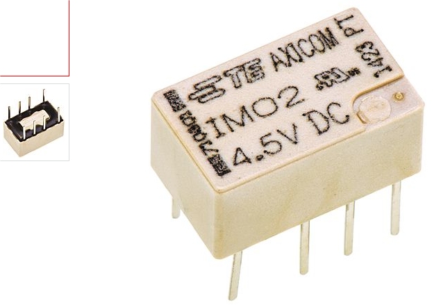

I've made reeds servo drivers using two of these micro-relays:
https://uk.rs-online.com/web/p/products/4227013/
They're really tiny, standard 0.1" spacing and not too expensive.
A pic senses left/neutral/right and switches relayA/neither/relayB respectively.

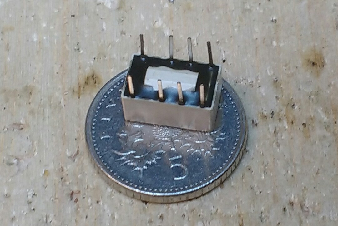

Just to emphasize how tiny these relays are, here's a new 5p coin:
I had wondered about doing a PCB for the reed servo board but never got around to it.
It would be two of these relays, two npn trannies and a pic. The relay coil needs 30mA which
is too much for a pic output, I pondered (but didnt try) two outputs paralleled per relay instead of
transistors, which would make a PCB even simpler... and yes, its pretty much the same pic
code as the range-test indicator thingy. If you're averse to pics then an attiny85 would do the
same job...
Re the LEDs, they're only 0.2" ultras but at night can be easily seen a mile away Ron
