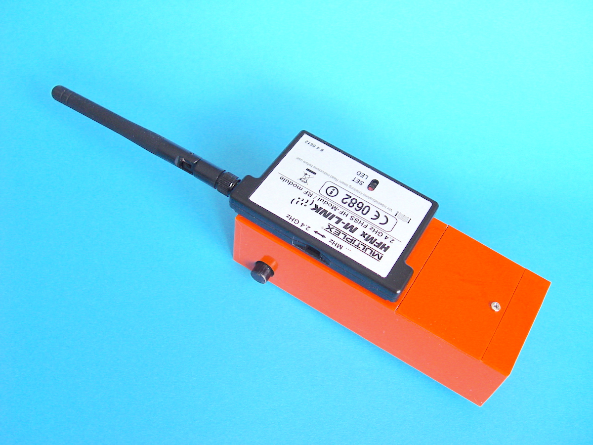

I have given up on the RM003. I have replaced it with a Multiplex M-Link module I had laying around, a bit bulky and not quite what I intended, but at least I can now fly the Tomboy on Saturday at the VRA meet.
Max.
Bruno, if you have a Tx that the RM003 fits into, could you bring it on Saturday so we can test it before I discard it?Cheers,
Max.
