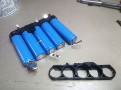

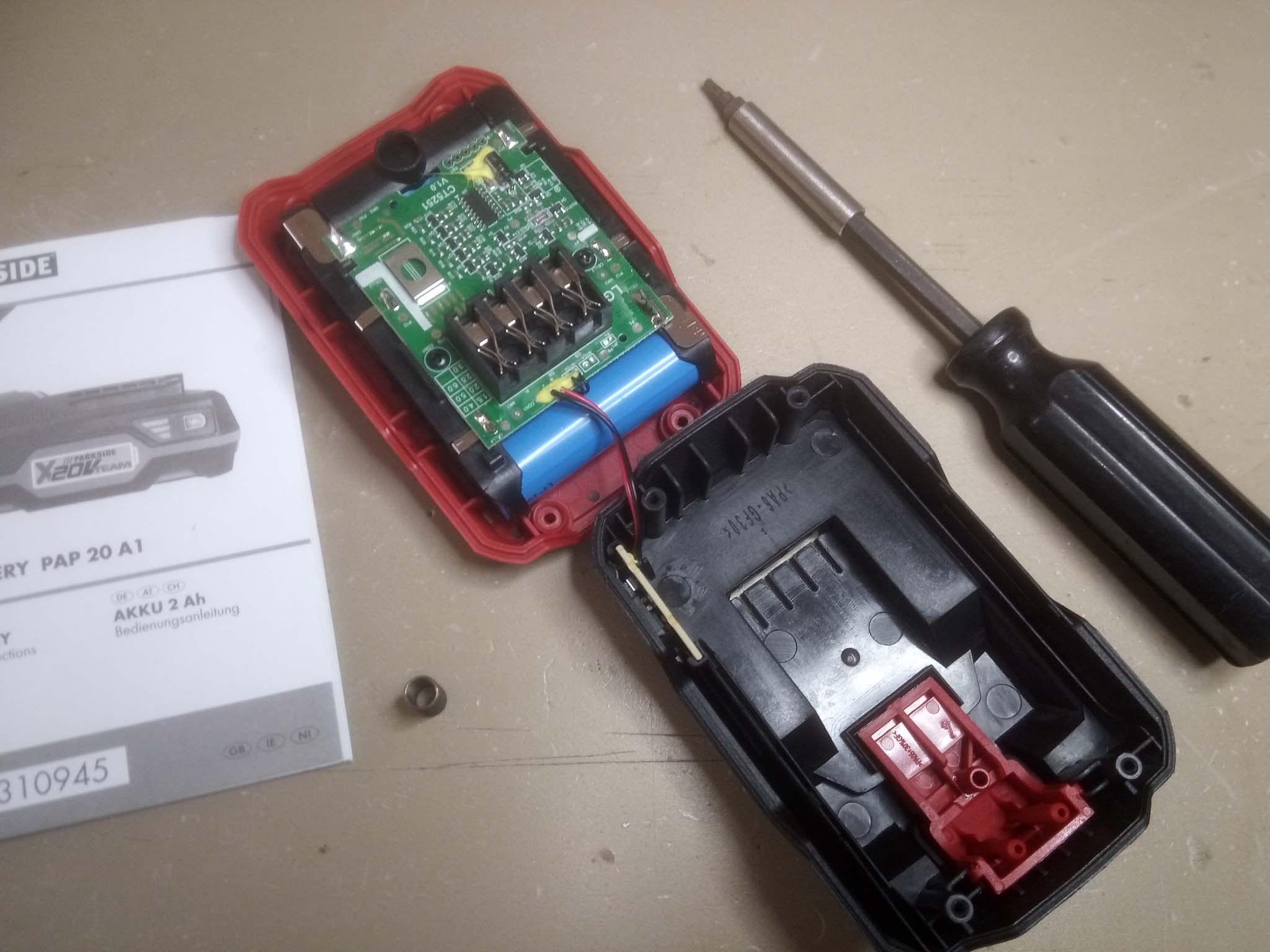

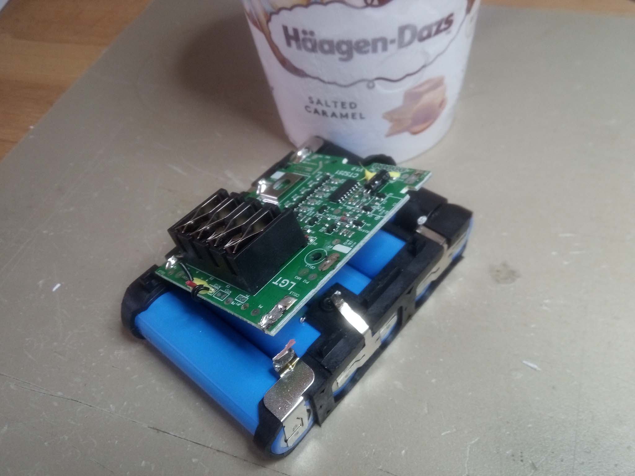

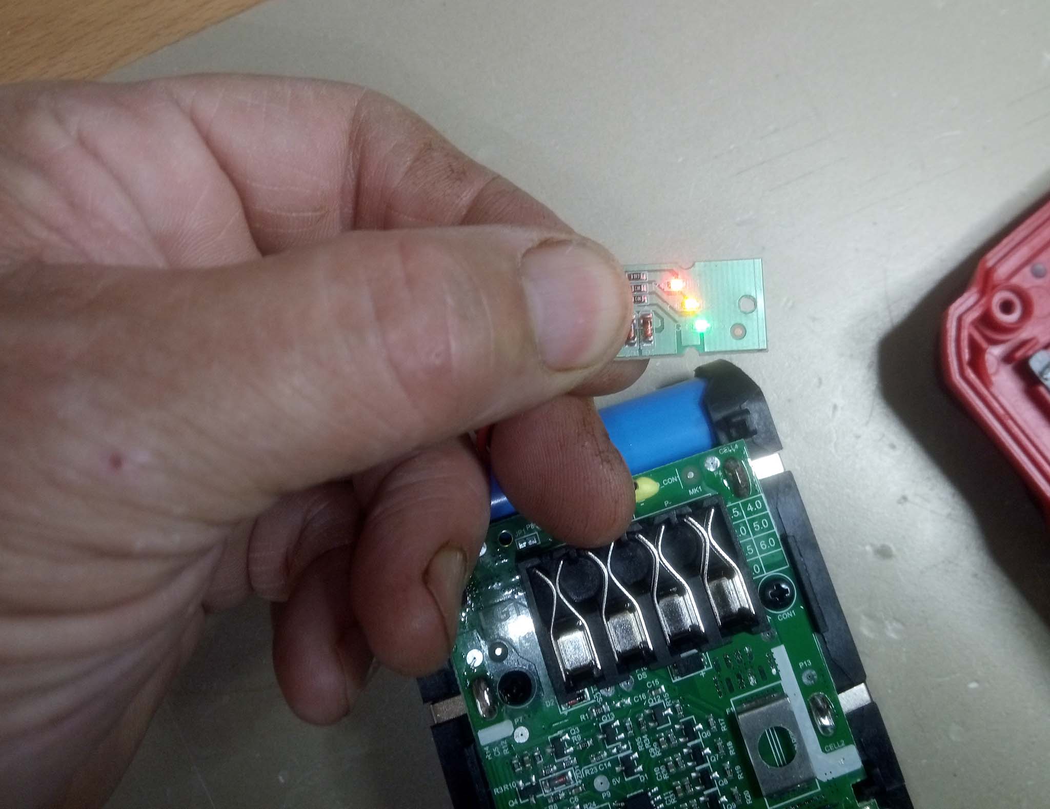

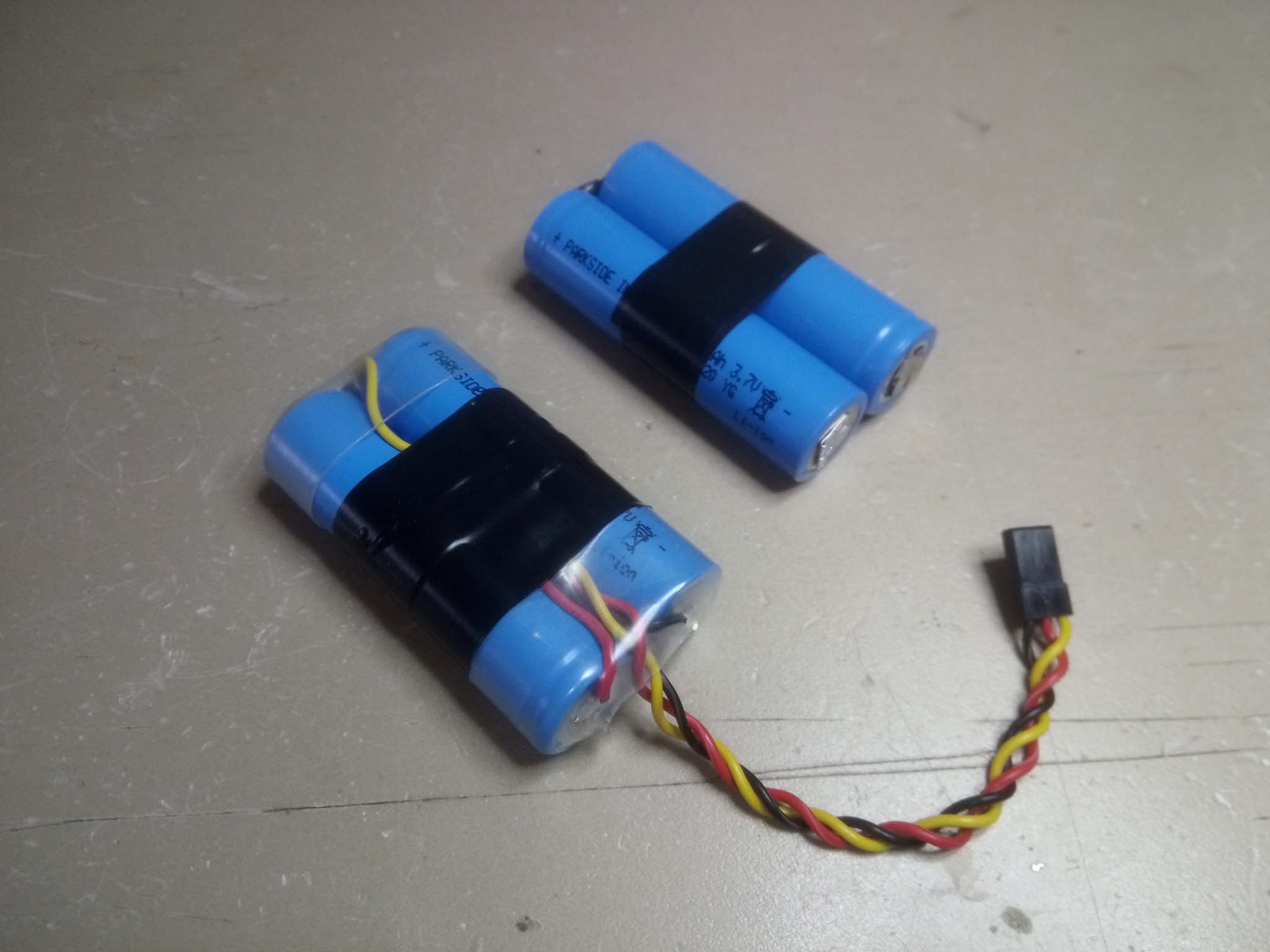

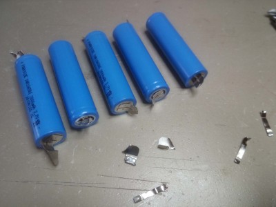

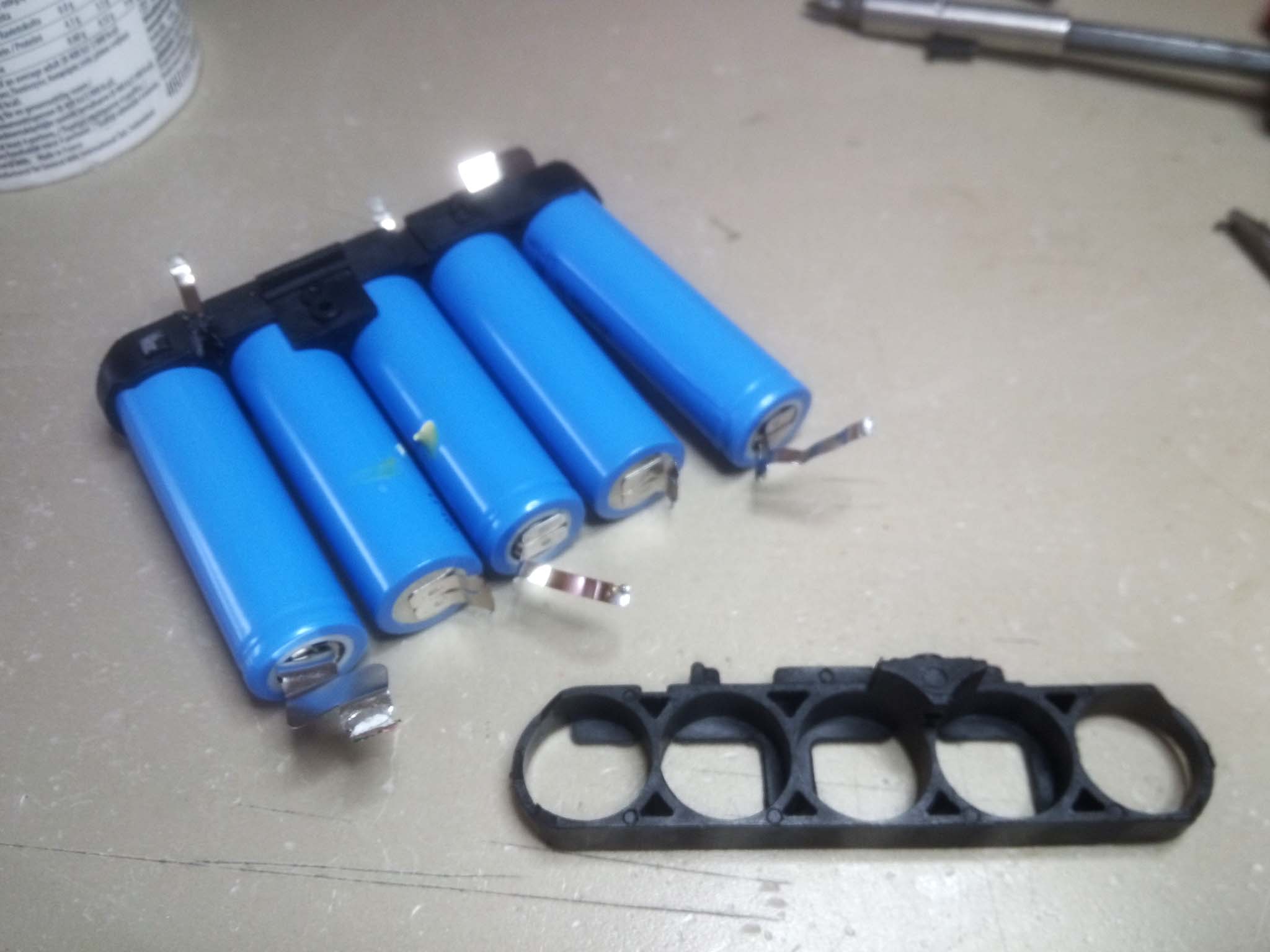

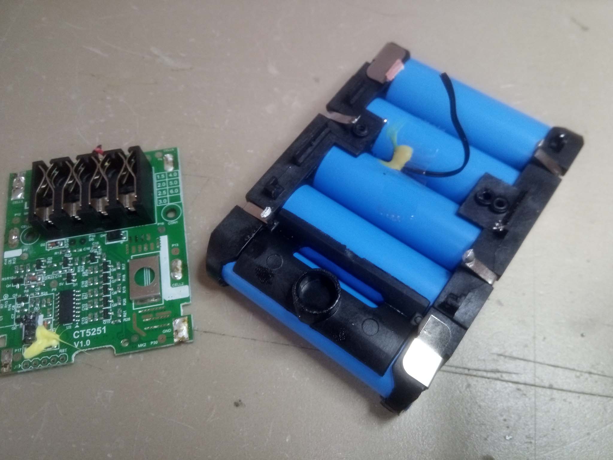

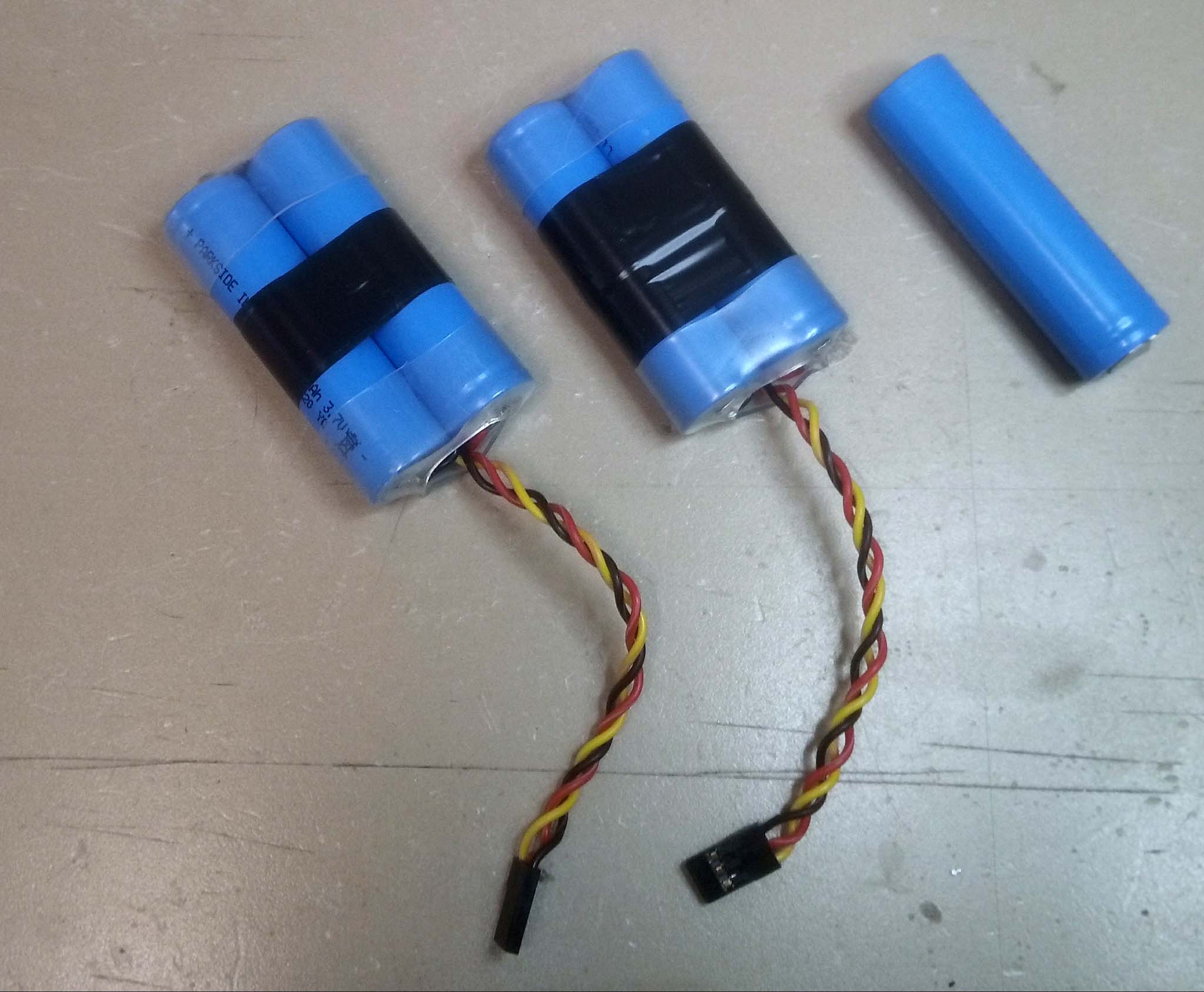

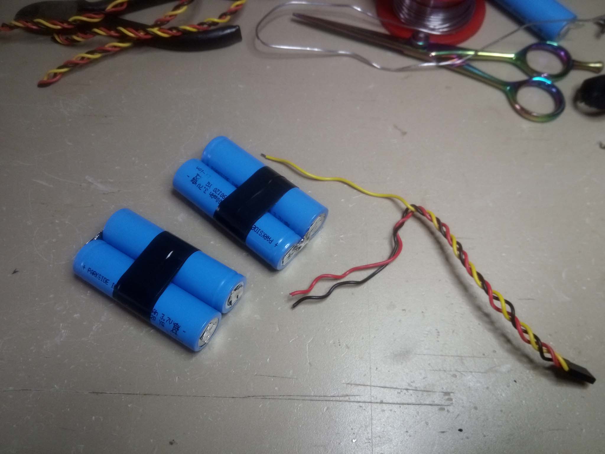

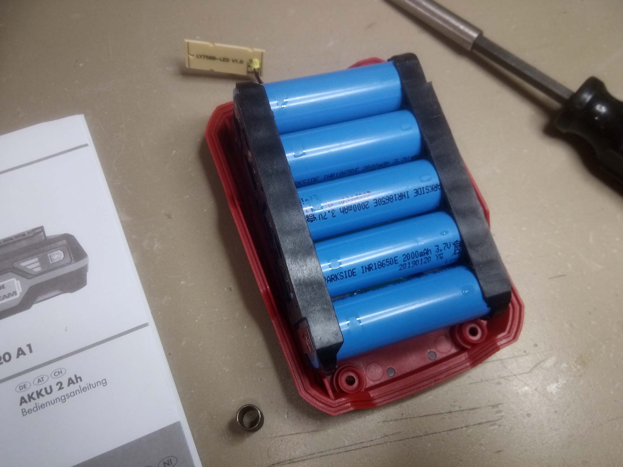

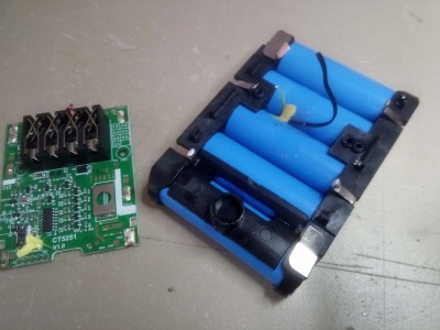

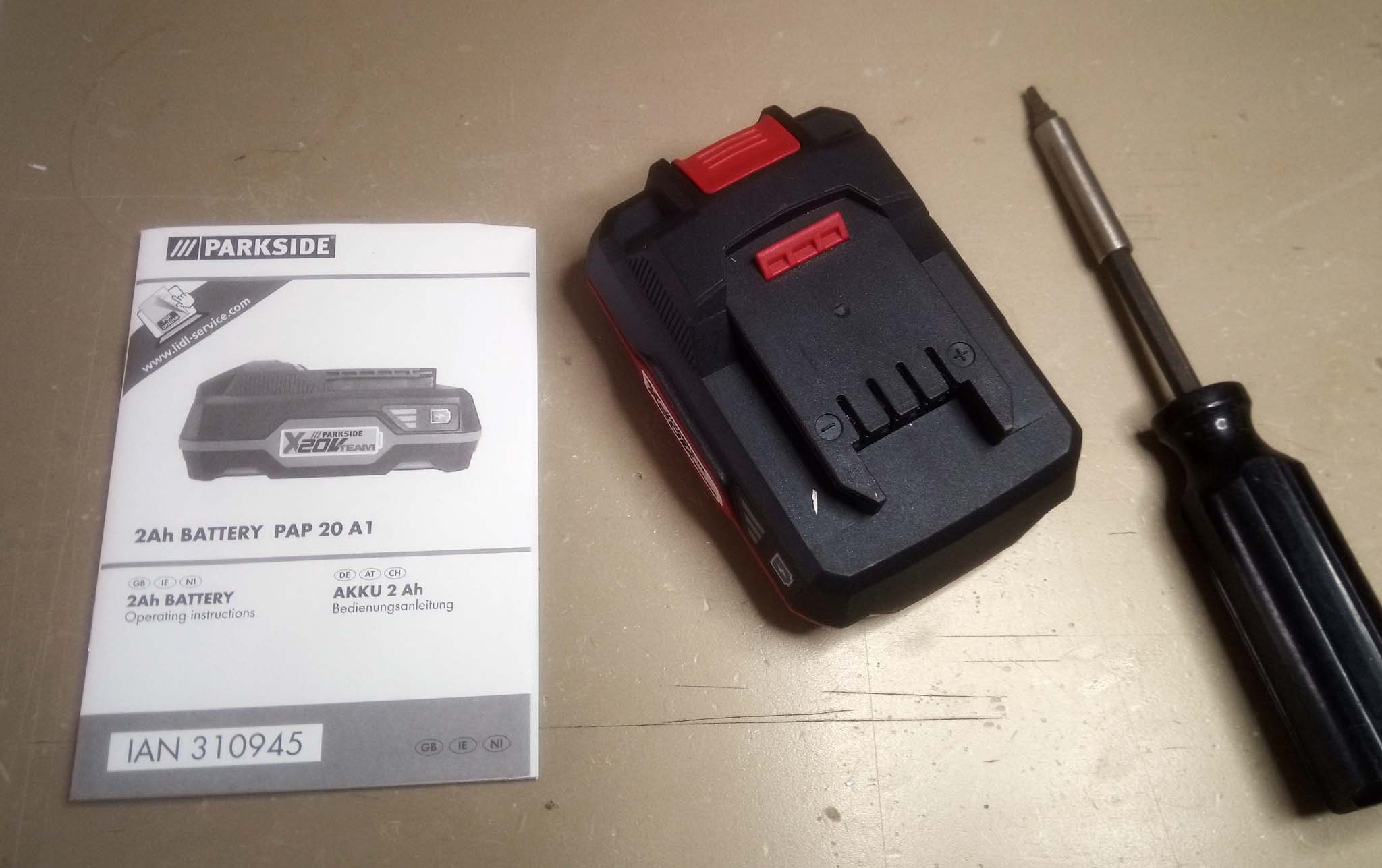

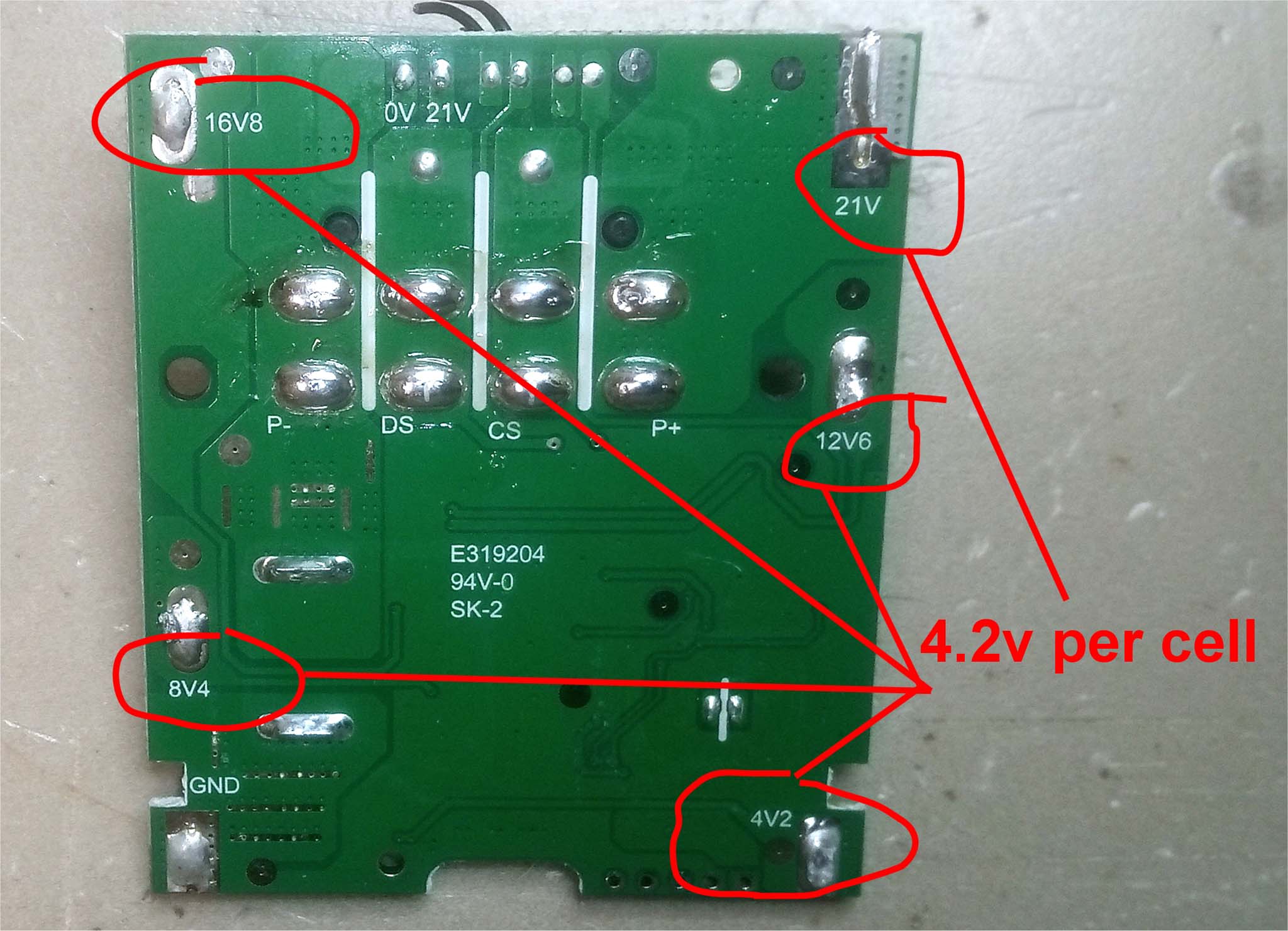

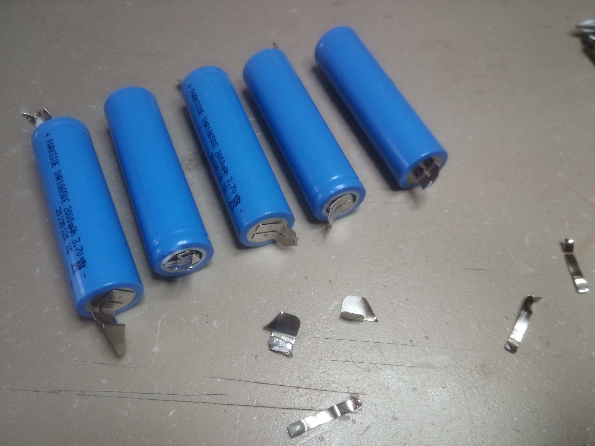

I've always wondered about the safety aspect of plastic-cased transmitters living indoors with their internal LiPo batteries. I'm a huge fan of the much-safer metal-cased, cylindrical 18650 size cells, and LIDL have a "Parkside" 2Ah, 21v Li-ion drill battery on offer for £12 at the moment. Its a 5S pack of good quality cells, ideal for making 2S tranny power packs. Its not difficult to dismantle the pack, harvest the cells then reassemble them into a couple of 2S batteries - and a spare
They're 4.2v charge so can be treated just like the usual 2S LiPo, and I've wired mine with a centre-tap, not to be truly authentic to the bad old days but to allow balance charging. You'll need a stardrive as apparently there are "no user serviceable parts inside". Wrong!

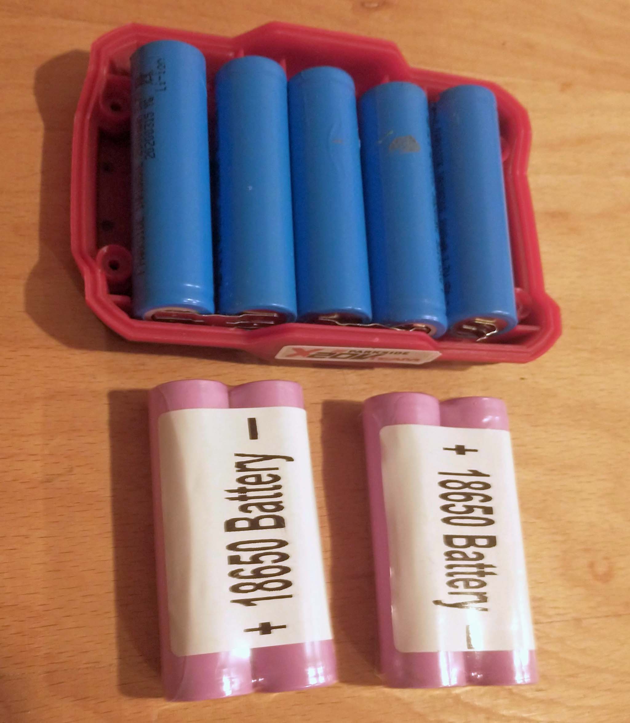

For the true(?) Yorkshire men who don't want to part with their hard earned reddies, I've "re-purposed" many 18650's from cordless vacuums & laptop batteries that have suddenly failed, normally due to one dud cell. I always cycle every cell (after dis-assembly) at about 1A which gives plenty of margin over our uses in a Tx.
I then routinely monitor their capacity, as I do with all my packs (LiPo & Nimh). Doing this, I've not (yet) had a failure in service!

This is what happens when you can't be bothered looking for stuff you think you may have. I needed some 18650 cells for my new NRF tx.. Couldn't remember if I had any left so went to Lidl and bought the drill pack Phil recommended. Stripped them down then went looking for some heat shrink and guess what I found... Some 18650's I bought at the start of lockdown... Still at least I still have some spares in stock..
