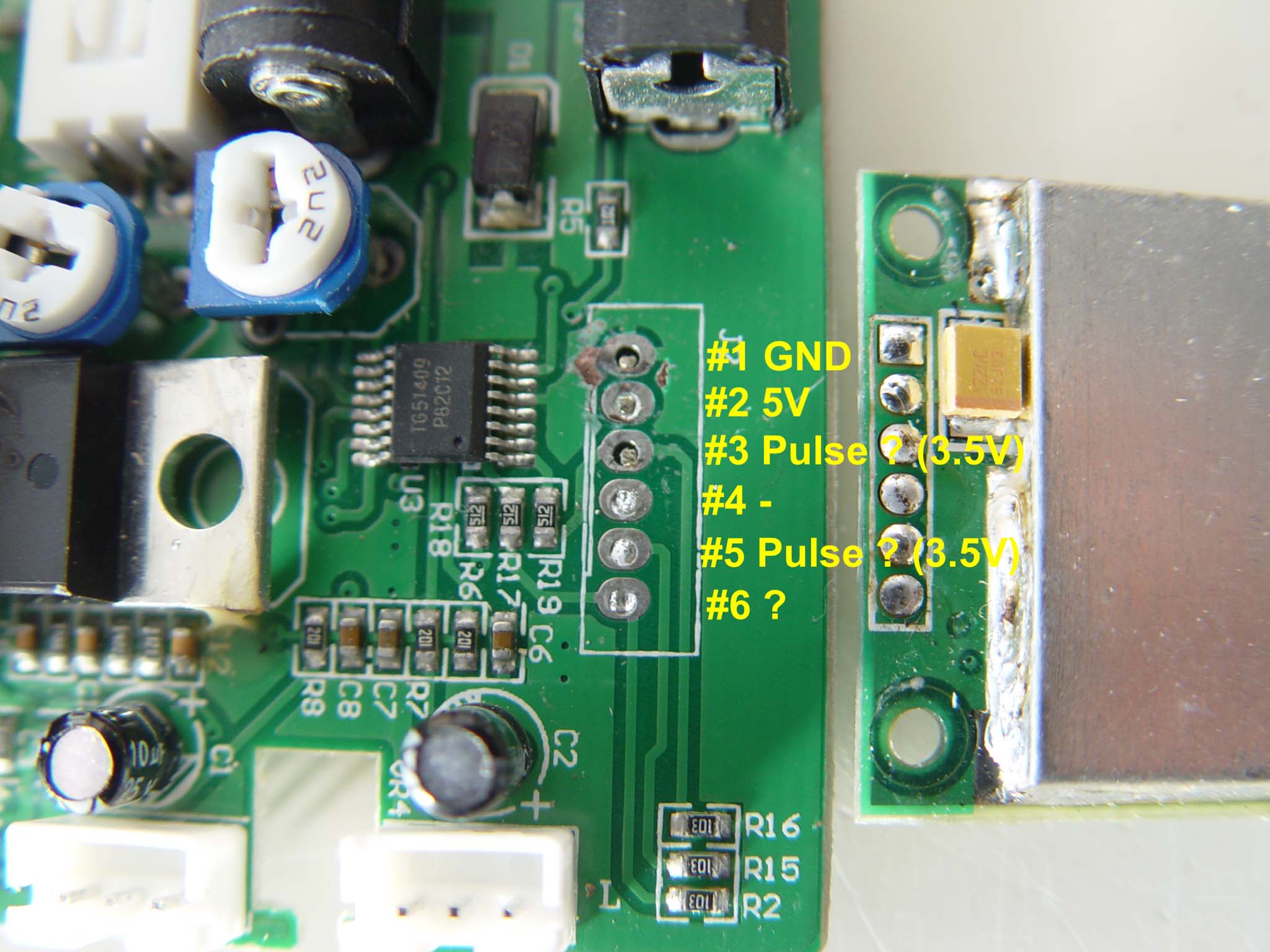

It does Phil, at least it is also a "tin box" but it has only 6 connecting pins opposite the antenna connection. But before I dislodged it from the main board, I powered it up, and measured the voltage of the pins. The top two are the same, 0V and 5V, but the next one measured about 3.5V, which I guess is the bind connection. How is it normally connected, via a button to GND? The other 3 pins all measured 0V. Luckily, the main board did not get destroyed, so I will be able to measure which one the ppm is connected to with the pulse analyser.

Measured the voltages again, with the HF board removed this time. It appears that the #5 pin also measures 3.5V
I tried to wring a ppm from the main board as well, no sign of anything I am afraid. Also checked if depressing the bind button showed any change to the voltages, or to the resistance to gnd, again nothing. This is not good :roll: :cry:
Max.
Edit: I can detect connections to the processor on the main board for pins #3, #4 and #6, all the pins that do not show a voltage, whatever that information means.

MaxZ wrote: 28 Jan 2020, 20:21Edit: I can detect connections to the processor on the main board for pins #3, #5 and #6,

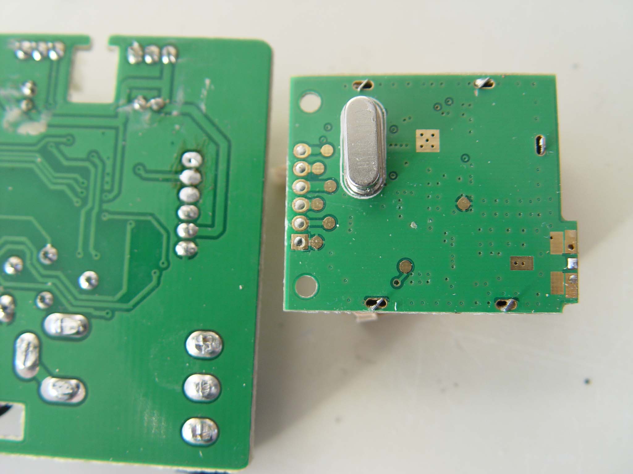

I have to correct that to #3, #4 and #6, measured voltages are on the picture below (0 if nothing shown)
I did not think it necessary to connect the pots while testing for a pulse before, but today I salvaged them from the donor Tx, and connected them. It did indeed make a difference, now I am seeing some pulses on #3 and #5. However, these are very erratic, sometimes only one channel, sometimes more (up to 4). Moving the pots does not result in anything noticeable.
From studying the pcb, I can conclude that #1 is definitely GND, #2 most likely 5V supply, and #4 seems completely isolated. And #3, #5 and #6 are connected to the processor.

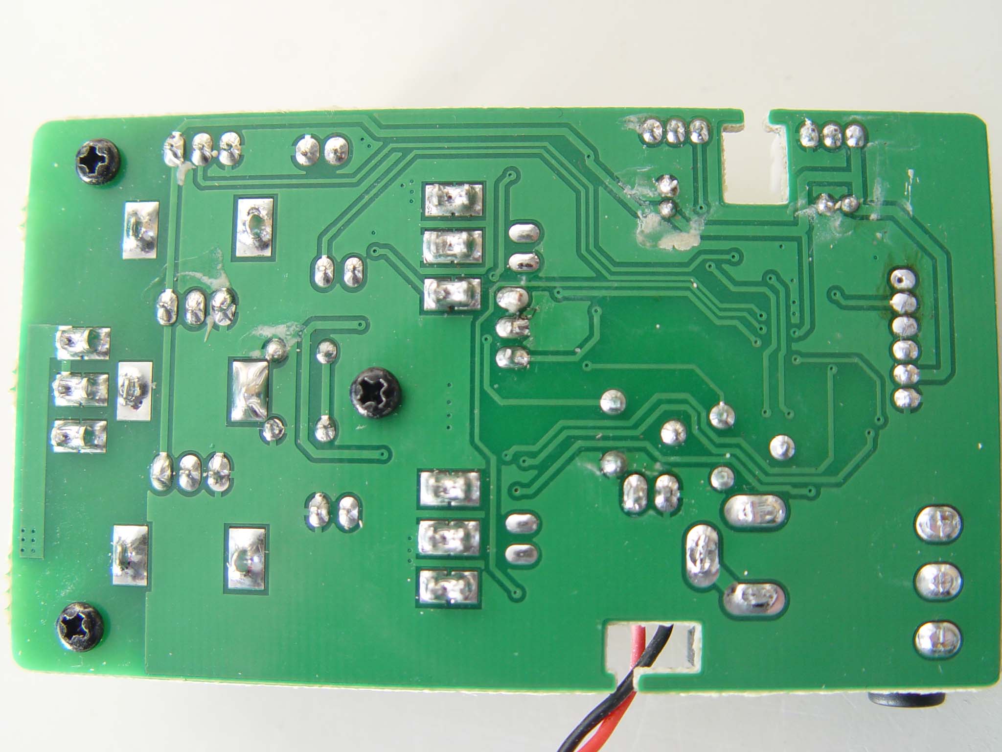

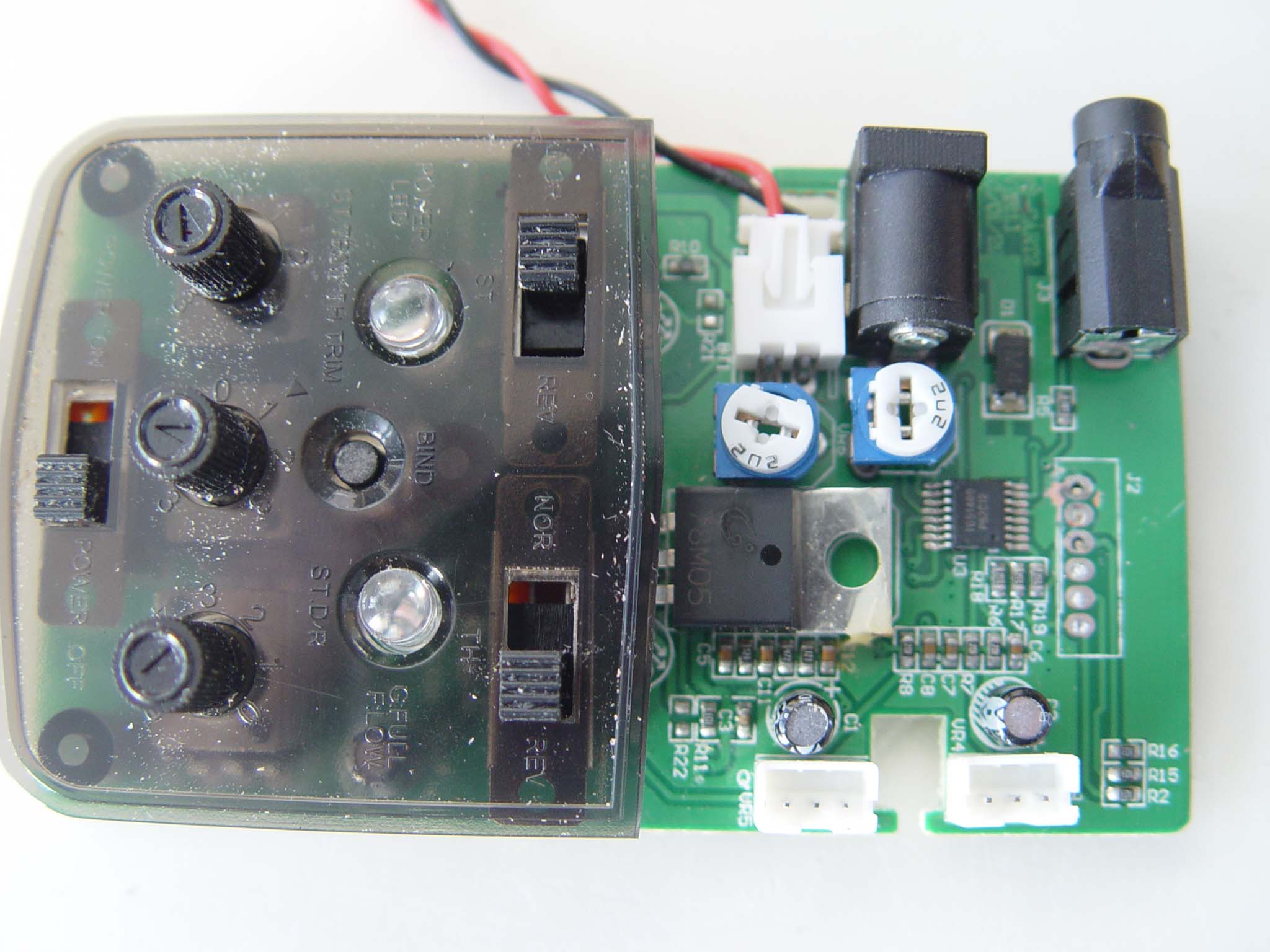

Fwiw, overviews of the main board:
Details of the module connections:
Max.

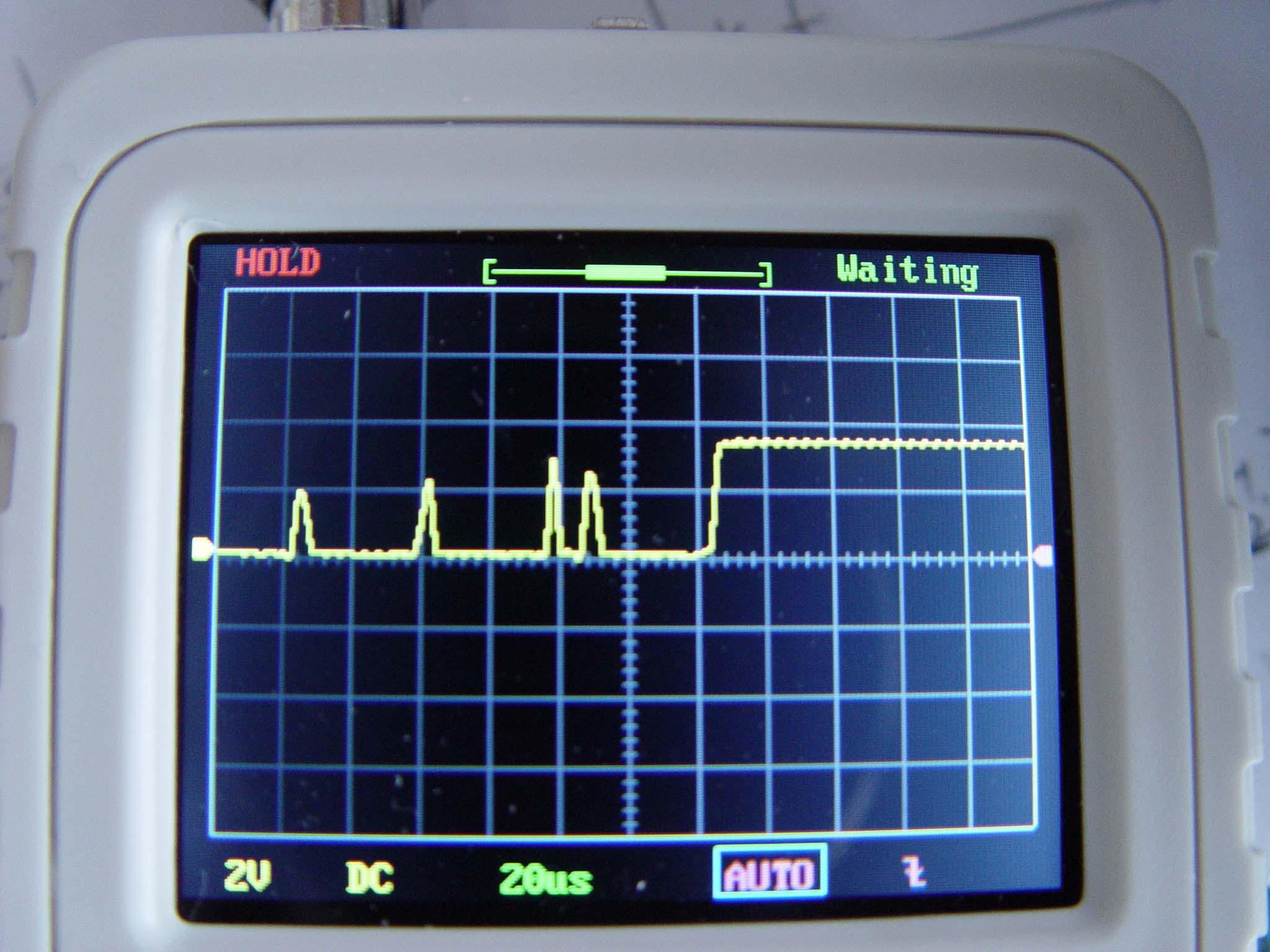

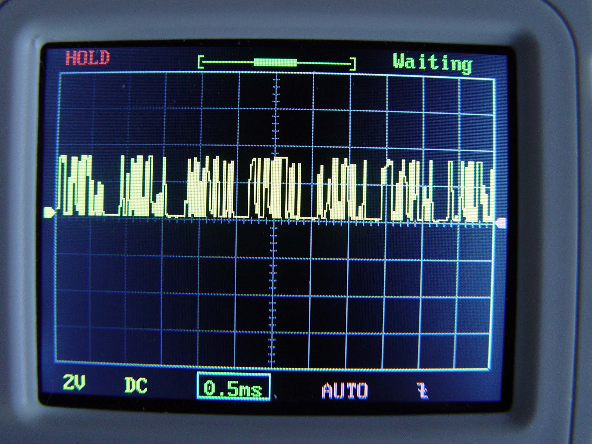

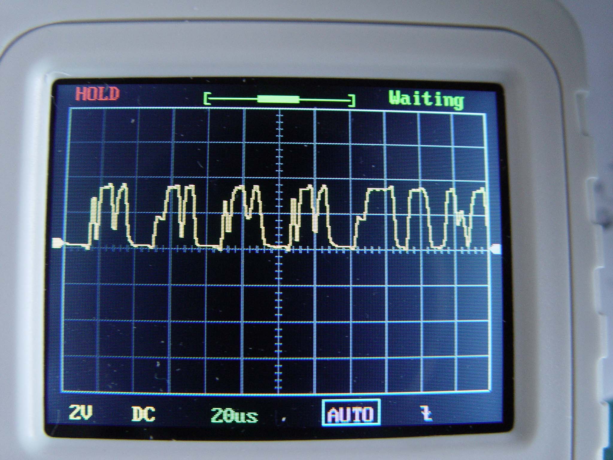

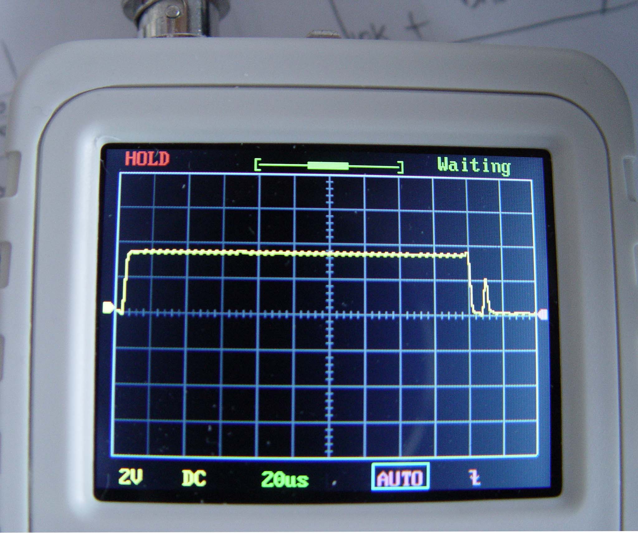

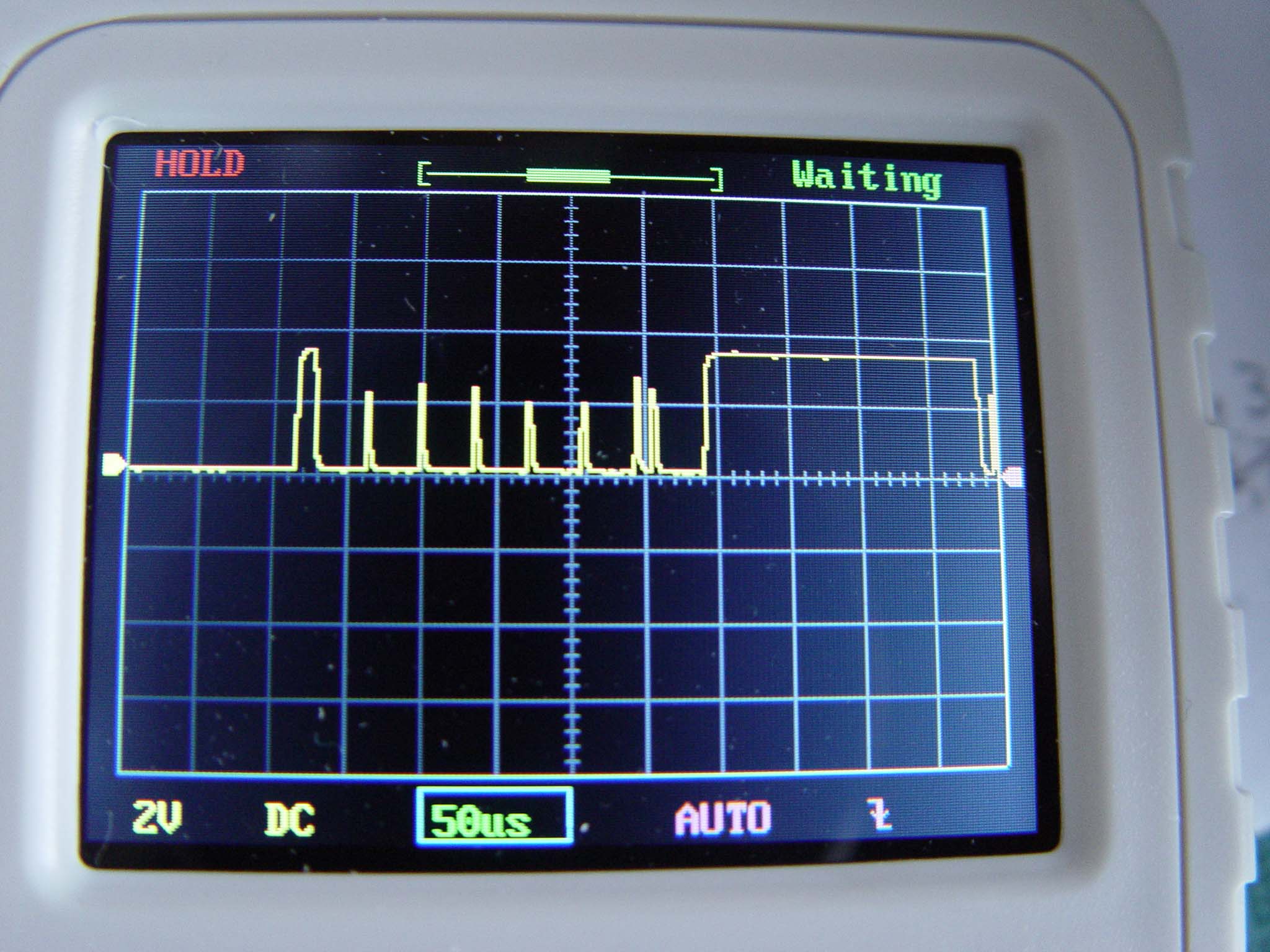

I have a small scope, so I captured the pulses on pins #3 and #5:
#3:
#5:
It does not look like a standard ppm stream to me, maybe serial communication?
#5 is closest, but the pulse width is way too short, and there is this long High.
None of them showed any difference while moving a stick pot.
All not very promising :(
Max.

Phil_G wrote: 31 Jan 2020, 12:29......if thats a full frame......
#3: full frame 0.9 ms, burst 0.7 ms
#5: full frame 0.9 ms, burst 0.25 ms (excluding the prolonged high pulse)
Viewed at a wider timescale, it looks to me like not all bursts are the same, so it could be serial data transmission. I cannot detect a beginning and end of a packet though (not sure if that terminology is correct).
Max.

The resolution of your oscilloscope is not high enough to determine what type of signal it is. Many modules use SPI to communicate with the 2.4GHz chipset or if there is some logic in the rf section, then a protocol based on s-bus is popular with many Chinese sets.
Have you thought of getting a cheap logic analyser? The Saleae clones are under €10 from China and the software is free and quite intuitive. Below is a link to the seller I bought mine from, but on the Dutch eBay site
https://www.ebay.nl/itm/USB-SALEAE-24M- ... Sw89Fc57Bb
It software has an Analyzer and Protocol Decoder, so you can automatically detect if it's asynchronous serial, I2C, SPI etc and can "auto-select" the baud rate for serial.
