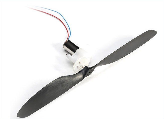

Alternatively I bought some of these £3 sets from Banggood:
Coreless Motor, Gearbox, prop set
You can buy a set of 5 for only £14, how do they do it?
For small motors I like brushed as they allow you to piddle about with supercaps and make simple controllers with one tiny fet.

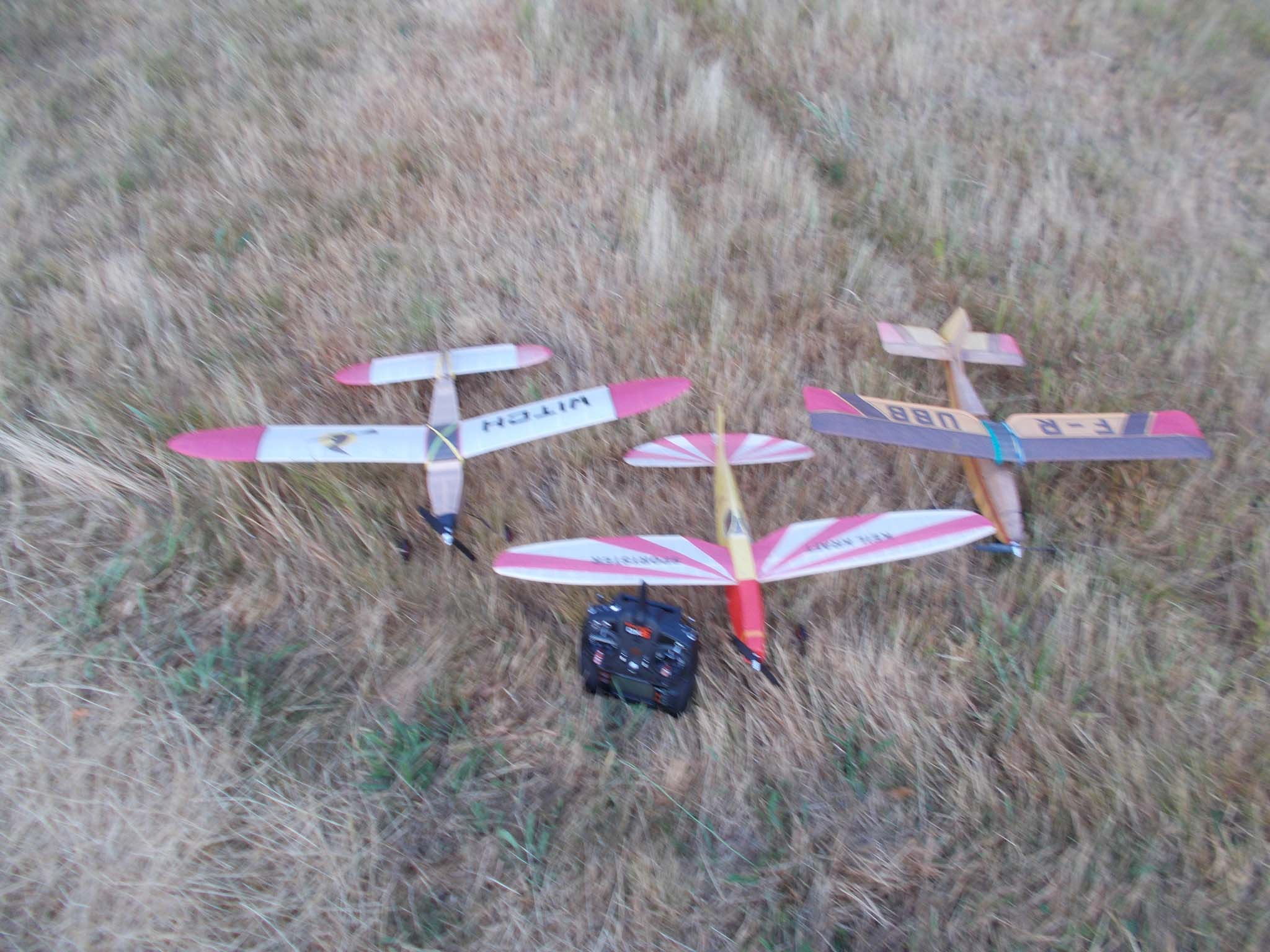

I have several of these 18 mm diameter motors https://www.brchobbies.co.uk/brc_en/bl- ... 200kv.html in small models/rubber conversions, amongst them the three shown in the photo and they perform very well. A bit higher kv than you are quoting but work OK on 2S and 7 x 3.5" props.jackdaw wrote: ↑25 Jan 2019, 11:26 Hi all,

Just noticed the pic, is that a Rubberdub ? I finished the laser parts for that a while back (shameless plug ) !
I had a converted from rubber f/f version with a banded on cox peewee as a kid - not a good idea to fill the tank I was capable of running after it then tho

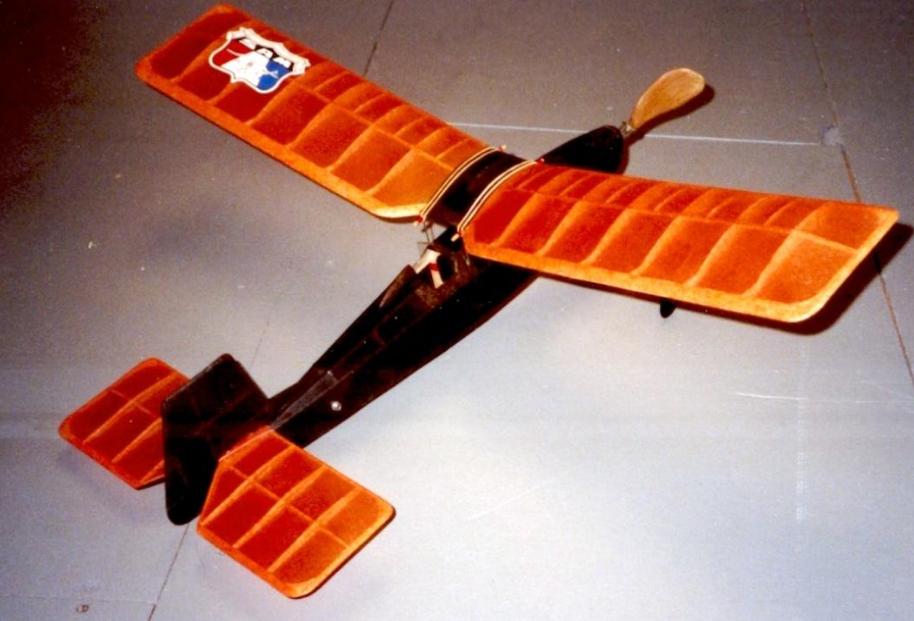

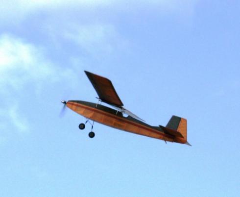

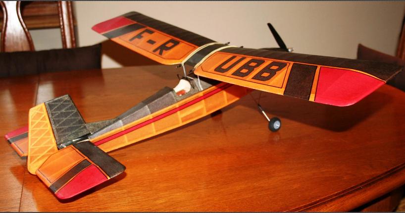

Yep Neil, it is a Rubberdub, makes a great park flyer with R/AMT/T control, 1811 motor and 2S 320 lipo. Second one I have had, the first was this "as per" rubber powered F/F one. Interestingly enough the Rubberdub was used in very early electric F/F experiments with the Micromax motor by Aeromodeller.Igull wrote: ↑02 Feb 2019, 21:05 Just noticed the pic, is that a Rubberdub ? I finished the laser parts for that a while back (shameless plug ) !

Highly recommended and would be a great rudder/throttle model.

Really nicely built example there !!!
Probably one of the very few rubber models I built that ever flew 'properly'.
