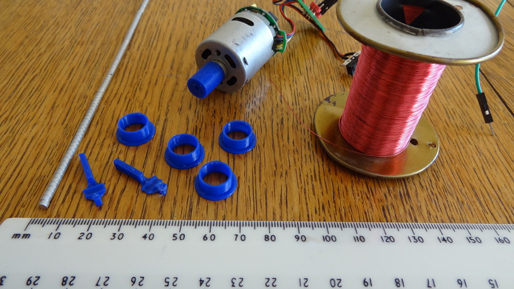

To wind the coil I used some old enamelled copper wire from a spool I've had for about forty years! There are no markings on the spool, but measuring the diameter with a micrometer, it's about 0.22 mm which I think makes it 34 SWG or 31 AWG. If and when I need to buy a new spool, I would get something slightly thinner to get more turns on the bobbin and produce a higher resistance.
I 3D-printed a mandrel to fit a small DC motor and hold/spin the bobbin for winding the coil - much easier and neater than winding by hand.

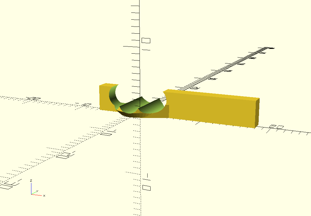

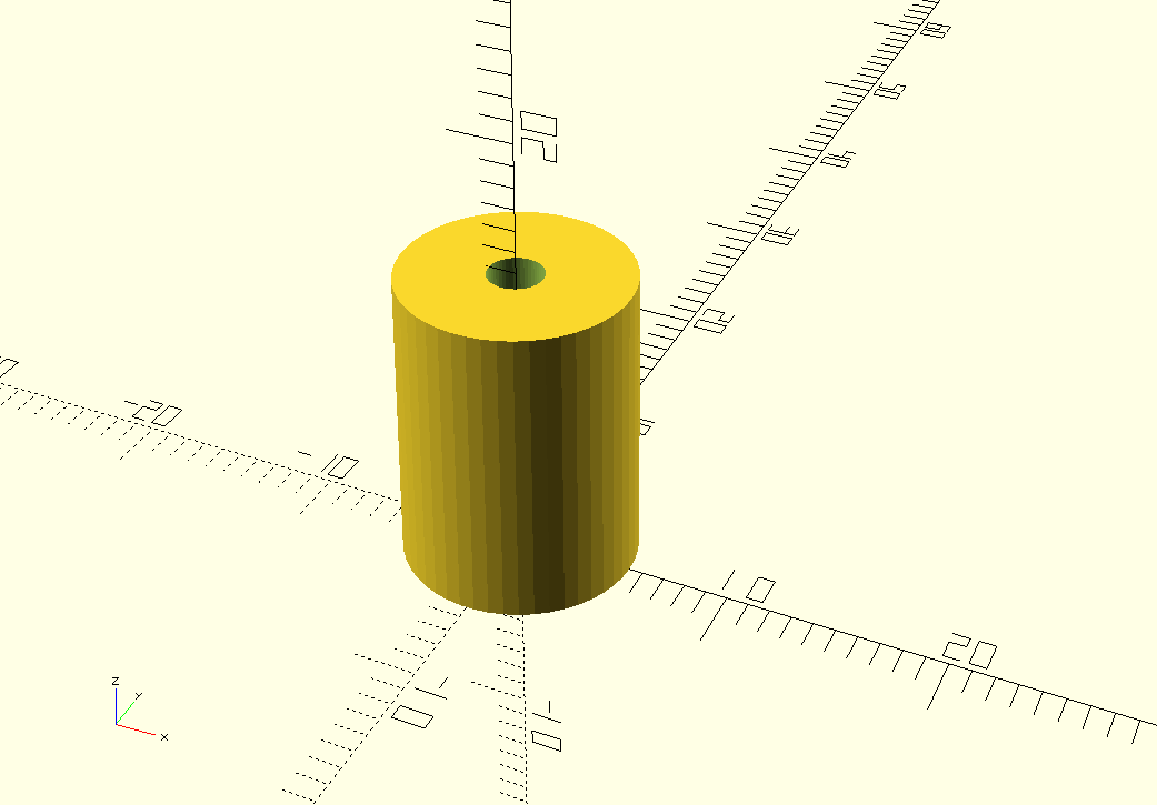

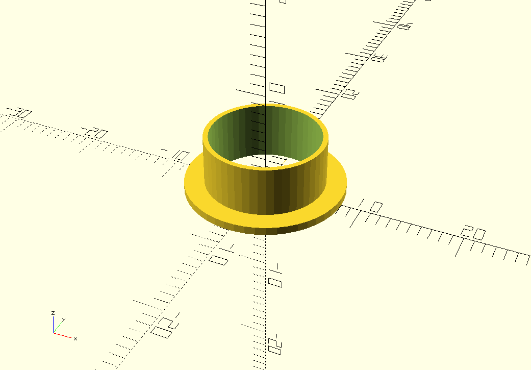

Here's the bobbin-half in OpenSCAD
click for larger view
Here's the OpenSCAD 'code'. You can see how easy it is to change the diameter and length to make different-sized bobbins.

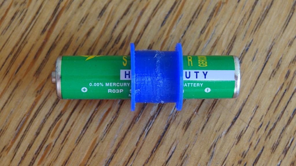

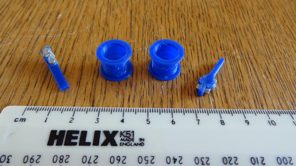

Gluing the bobbin halves together with a drop of cyano. By coincidence, an AAA battery is a nice sliding fit to hold the halves in alignment while gluing. Don't use too much glue though, or you'll never get the bobbin off the battery!
Click for larger view.

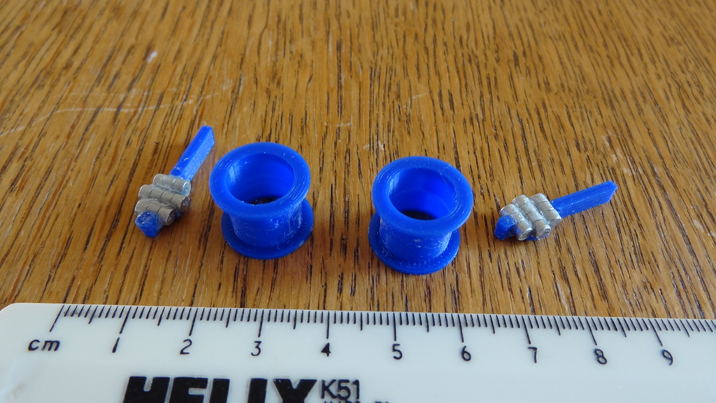

A couple of views of the assembled bobbins and the magnets glued into their little holders. The 'handles' of the frying-pan-shaped holders will eventually be glued into the control surfaces: rudder, elevator or whatever.
Click for larger views.
