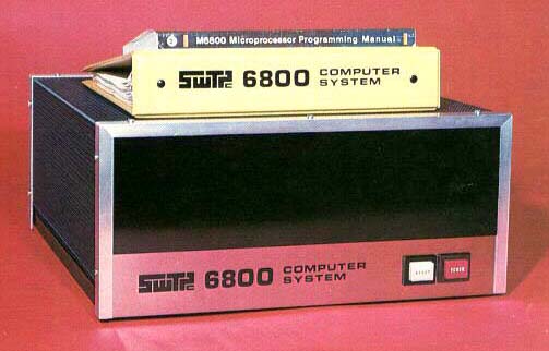

I've a couple of these old boards spare, and I'm tempted to make a SWTPC 6800 clone from one, I have all the bits and a copy of SWTBUG...
