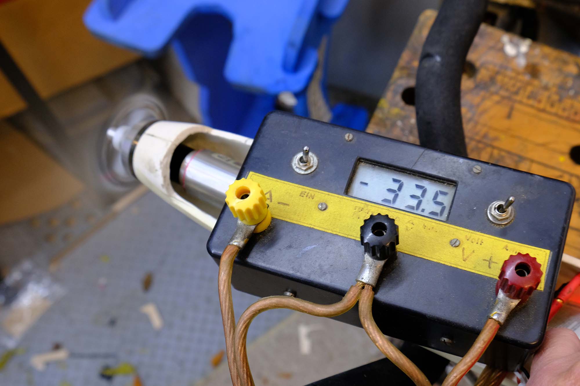

12/ 6 seemed to cause a current drop to about 20A so need to look at that again with a freshly charged battery.
Tried an AeroNaut 12x7 with a fresh battery and current was initially high thirties and dropped to a steady state of 33.5 Amps.

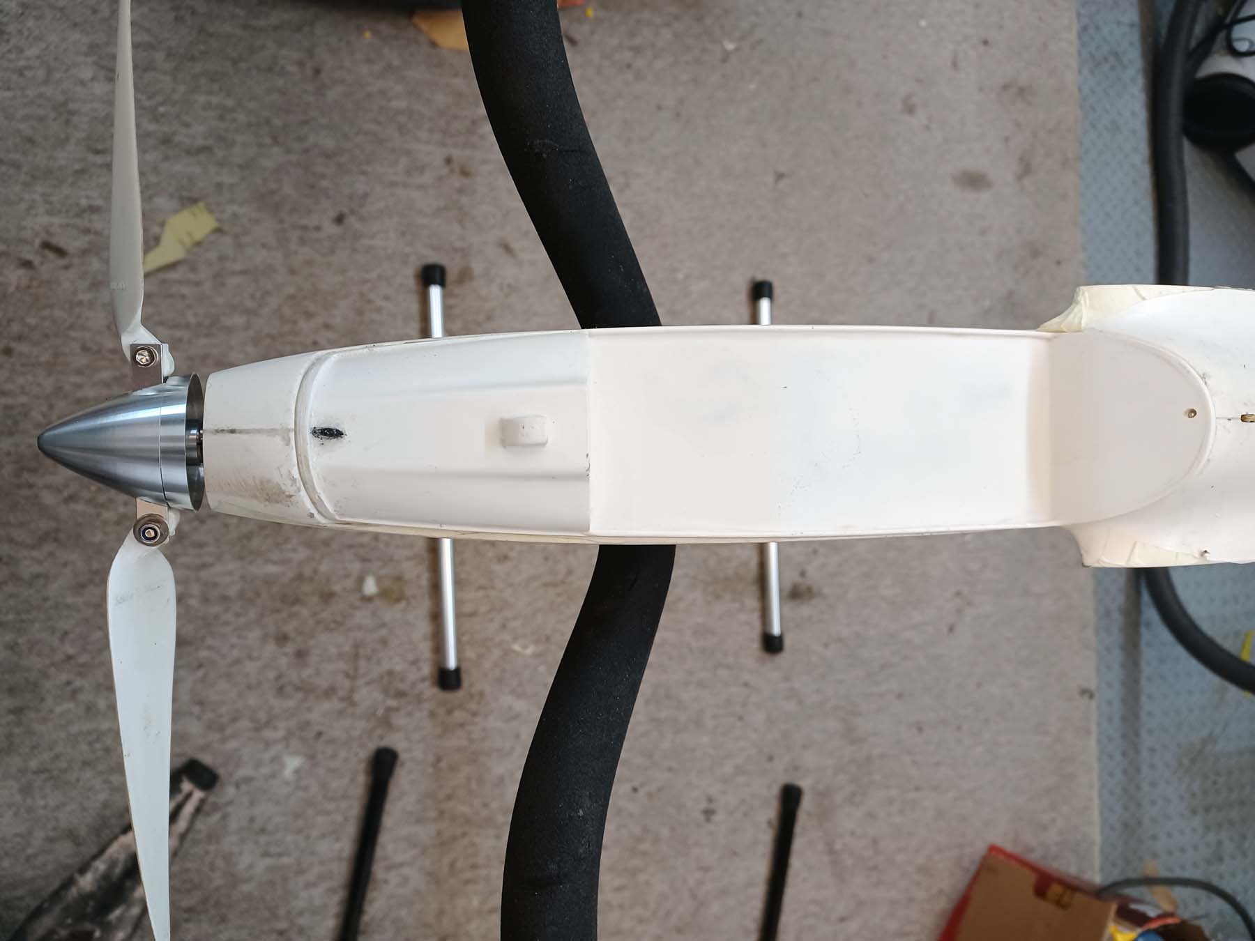

A bit more progress on the fuz today saw the epoxy glass Canopy frame fitted
Spinner is set a bit forward as I am waiting for some countersunk M2.5 screws to arrive to replace the cap heads

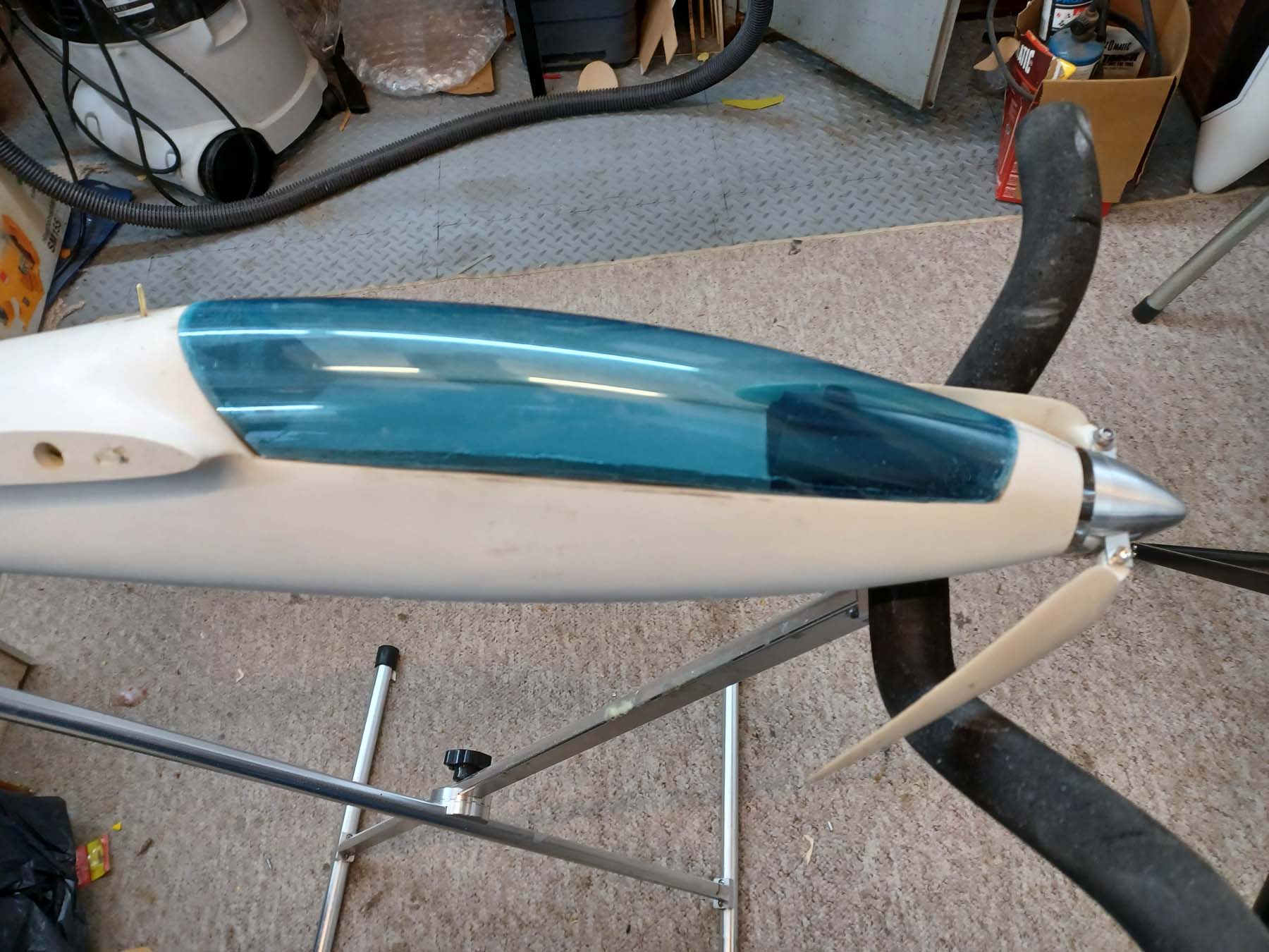

Painted copy frame and bonded canopy in place using pva

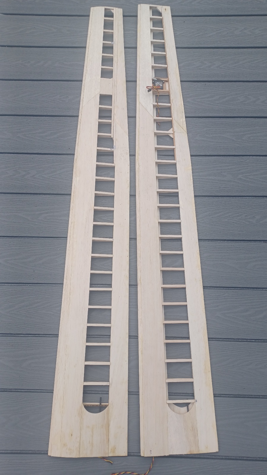

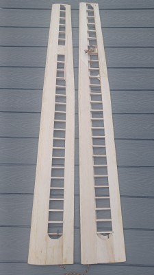

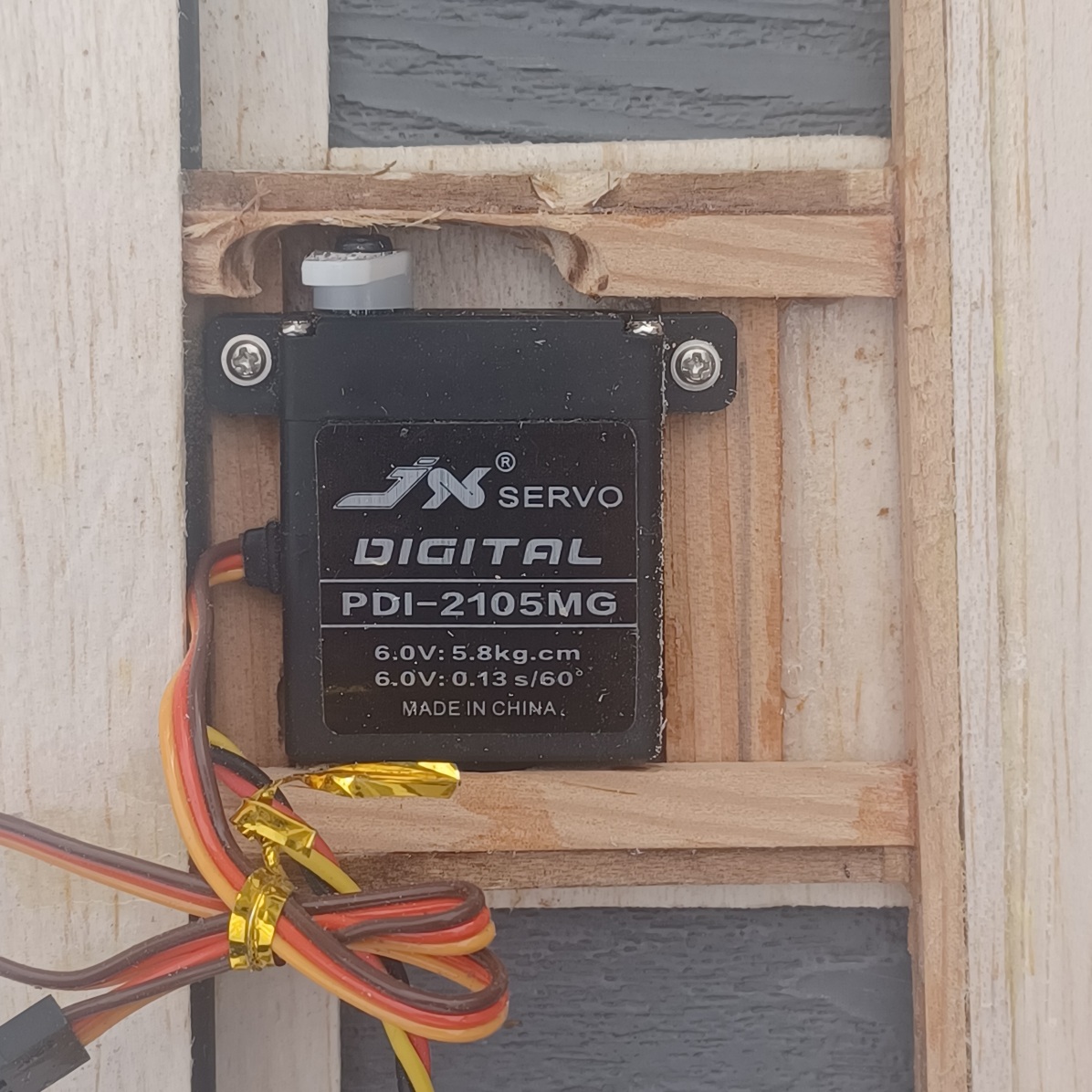

Finally got round to restarting this project this week after a very long lay off.
Wings are finished build, servos installed with just (!) some sanding, cutting aileronsout & fitting tips etc to be done.
Found some great little digitalwing servos 5.2 kg JX digital for around £15 each delivered.
They worked ok for a couple of hours on my servo tester and appear similar quality/clones of the Hitecs at a fractio
Just need to find the other bits now which are in a safe place!!

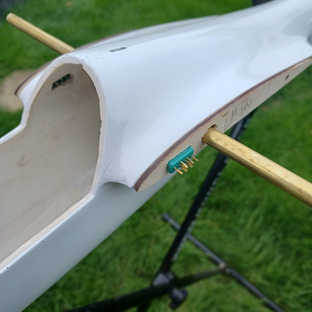

Found my stash of bits so root ribs and MPX aileron plugs being trial fitted to fus.
