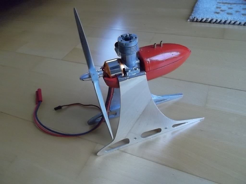

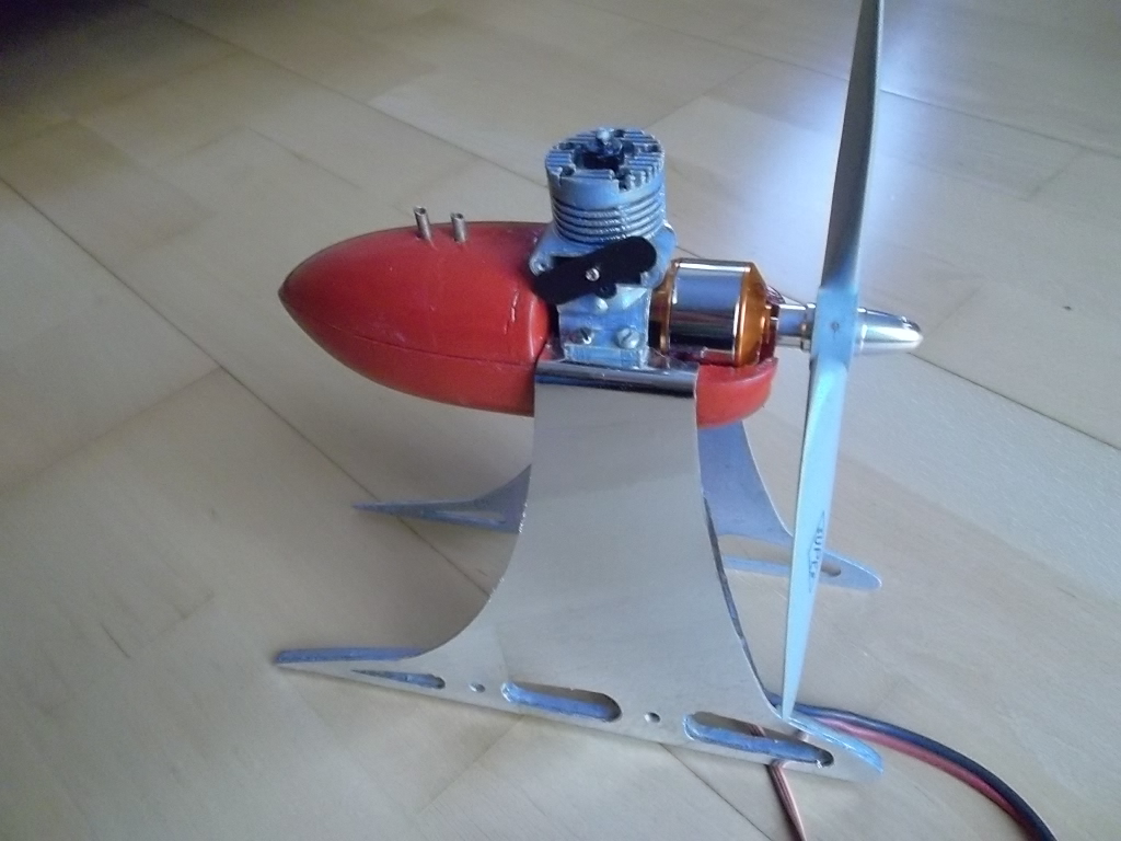

A picture of my reworked power pod for the Graupner Cirrus, Cumulus, K8b might be of interest for you.
I reworked it to look more like the real IC equiped power pod from the old days.
Flight test already done. Works great
I will improve other power pods in the future.
On 3S it climbs like powered by an old 2.5ccm OS, when using half power like my old Cirrus using an OS Pet. Frank

- Posts: 811
Re: Power pod for gliders
Most realistic Frank, nicely done
It appears that the e-motor (2212?) firewall mounts onto the dummy i.c.engine, such that the integral motor assembly can be removed by undoing the beam mounting bolts. Have I got that right?
- Posts: 396
Yes Wayne that´s right, the e-motor is mounted to the dummy OS10 crankcase and the whole assembly is screwed to the alu beams and the fairing which hosts the ESC instead of the fuel tank.
It was the old version of the original Graupner power pod kit. It was on my first Cirrus almost 50 years ago.

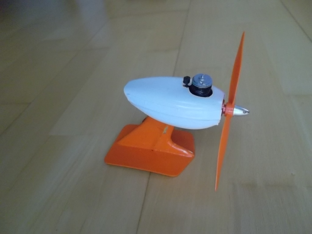

Here is my next reworked power pod for smaller gliders, it uses a Cox PeeWee dummy and the 1306 e-motor mounted to it.
I use it on my Hegi Spassvogel. It will fit other small gliders as well. Frank
