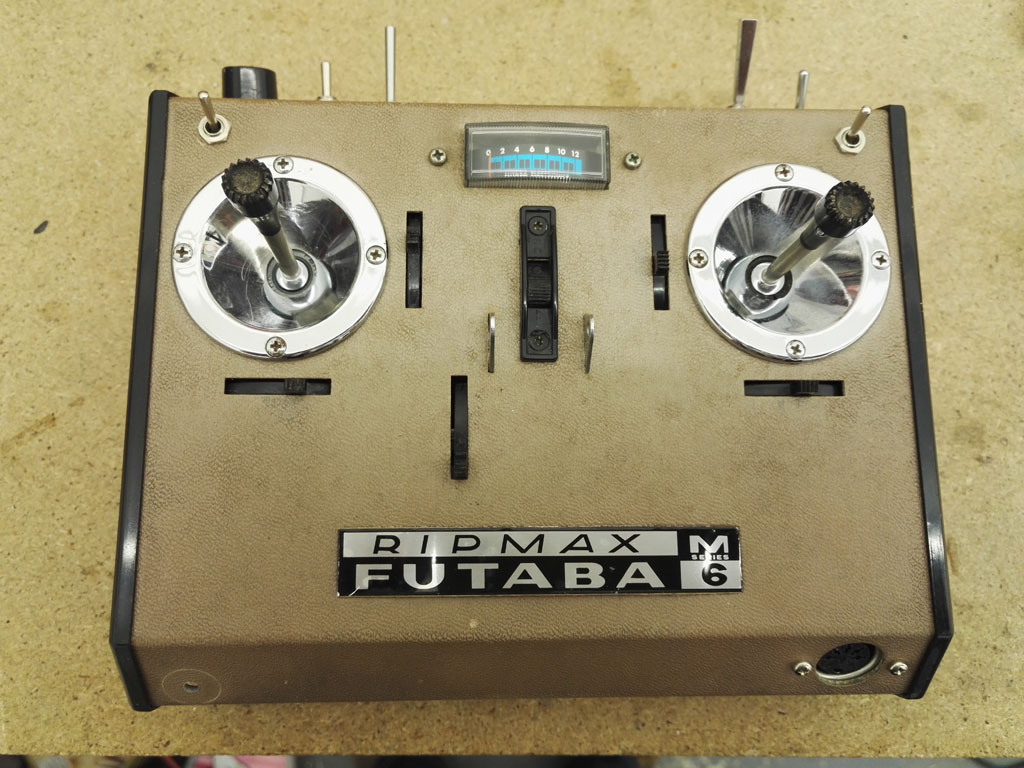

As Phil has kindly said, I have been developing the encoder over the last two years to the point that it can do pretty much the same as many mid range transmitters from a few years ago, something similar to a first generation Spektrum DX7 or DX8, but it has single channel compound and sequential emulation in addition. As there has been some interest, I hope to sell ready made and tested boards to make it feasible for non electronic enthusiasts to convert a set, but when I'm finished I will also release the circuits and code for those who like to do a bit of DIY electronics.
The encoder firmware is complete (except for a few minor mods so it can display up to 13.5V so it will work with 35MHz modules) and I've been busy for the last six months writing the user manual, a quick start manual and a construction manual. Shaun Garrity has kindly offered to proof read the manuals, but as he's a busy man I don't expect them to be read for a month or two, which will give me a chance to finalise the "production" circuit boards.
If you are interested in what it can do (and what it can't do), I've uploaded the draft user manual to my website so you can have a look. But bear in mind that it is a draft document and that my grammar is not the best - that's why Shaun is going to help out!
http://www.cavaya.co.uk/download/Encode ... .3.21a.pdf
The hardware is based on an Arduino Nano. In the end, the meagre resources of the Nano has been the limiting factor, I have so many ideas of other things I'd like to include but can't because I've run out of flash memory. When you start, 32K of flash seems enormous, but it isn't long before it's all used up. And every single byte of EEPROM has been used. I've already started on a MK2 version based on a STM32, but I'm back on a steep learning curve with that processor, so don't hold your breath :)
I have converted a Skyleader SLX and Futaba M6 for myself, I gave Phil and Shaun a Futaba M6 each last year at Ponty and have done other Futaba, Skyleader and an OS Cougar conversion for friends. I started a Micron PL-7D conversion before Christmas, but other projects such as 3D printing OS Pixie cases, my own single channel encoder, converting a Graupner Grundig Variophon reed/tone set and building a few planes have got in the way.
