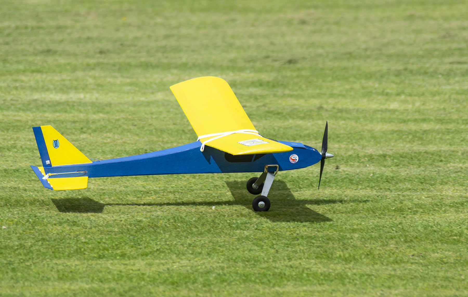

Just received some piccies from my pal Derek, of the Outlaw in action yesterday.
It wasn't that hard a landing, honest and my other two clubmates who had both showed me pictures of their Outlaws, flying from the field in the 70's were delighted to see that my 2023 Outlaw had the same retractable undercarriage. :)
