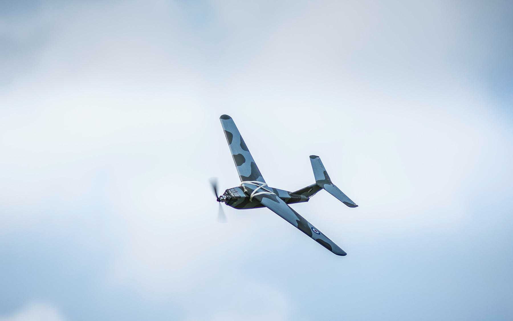

I built mine last year. It is one of my most flown models presently.
It was built according to the plan and flew right away, no trimming, no changes required.
Everything was spot on.
