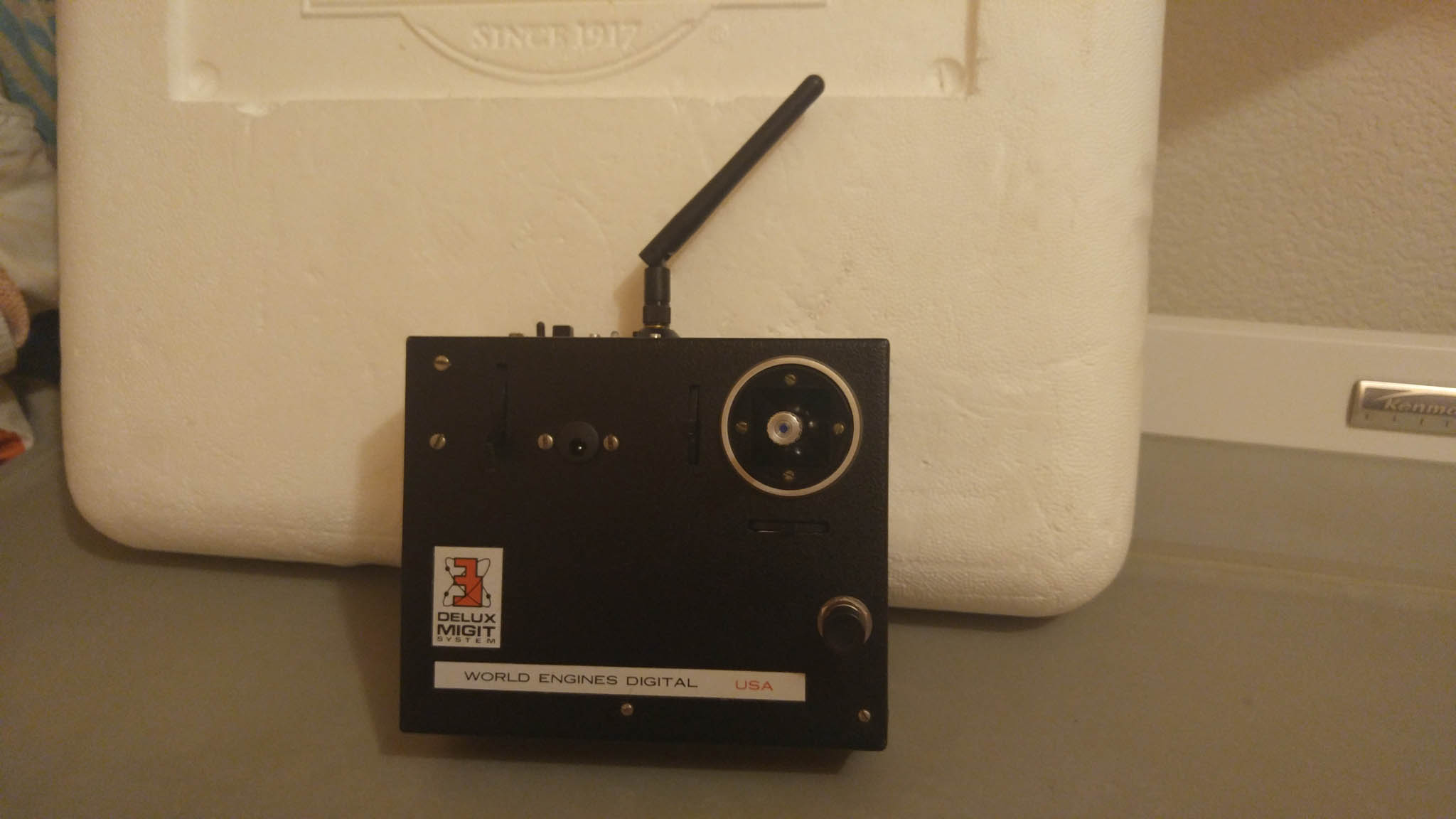

Hey Phil! Just completed converting a vintage World Engines 3 channel Digit Midget transmitter with one of your nicely done prewired 3 channel DigiSpark propo encoder boards and an FrSky DHT transmitter module. It turned out to be a rather enjoyable project. The information that you provide in supporting these efforts is always invaluable and greatly appreciated. Thinking that this radio will go great with a Sterling Mambo that I still have in a box. Again a rather enjoyable and rewarding experience.
