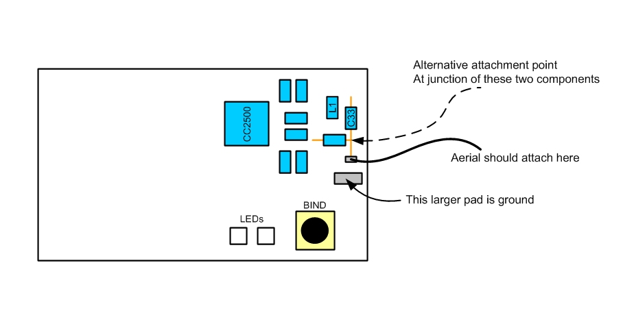

What I did was to first clean off all the 'goo' by warming it and gently picking at it. The pcb land to which the aerial should have been soldered appeared to be missing - probably came a way with the aerial - leaving nowhere to resolder a new aerial.
To find the aerial input I set the tx module to low power, set the tx to sweep, got the rx linked up & a servo sweeping, then moved the tx well out of range, way beyond where the rx stopped working (still with no rx aerial).
I then took a 30mm pin, pushed it through some 1/4 square balsa, and under a bench magnifier and with the rx powered up and holding the balsa, touched the point all around the original aerial position. Next to the missing aerial connection I found that at the junction of two SMT components, touching the pin gave an instant link, removing it dropped the link.
I switched off, soldered a 33mm length of servo wire to the junction of the two components, & switched the rx back on again. Got an instant link, and a low-power range test proved all was back to normal. Checked the solder was a good mechanical joint and applied a good blob of evo-stick to support it. Did a range test on full tx power and ran out of space at half a mile, with rx still working fine at that range. I'm not suggesting all breakages can be as easily fixed but this worked for me. Wish I'd taken photos, too late now but next time I will.

Mike gave me one of these receivers in his solar plane, with the warning that he'd tried to fix the antenna, but that the range was now poor.
I've flown with it few times - never very far away, but today I did a proper check and the range was indeed very bad.
I've just taken a look at it and not only was the antenna attached to the wrong place but the capacitor C33 is missing from the board - that's the one above the connection point in Phil's diagram. Any idea what sort of value C33 should be? I do have a mixture of surface mount capacitors, and a capacitance meter so I could try to find one about the right size and value and solder it in place.
Posts: 603
Re: Repost: V8R4 receiver - detached aerial fix
39pf Martin, its in series with the aerial, so if its missing there will be only minimal coupling.

I soldered in a capacitor and added a new antenna, but the range was still well down - either I botched the repair or there is something else amiss with that receiver. I swapped it out for another V8R4 and have consigned the dodgy one to bench testing only duties - I should probably have thrown it in the bin, but I've not done that just yet! :D
