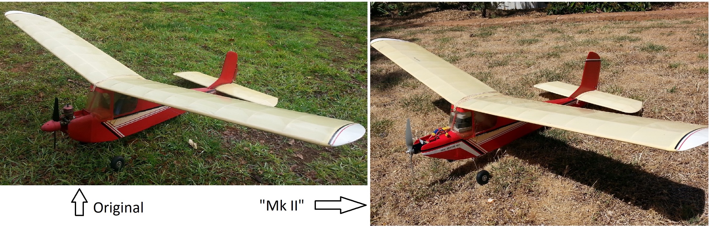

In my quest for a quick (?) model to test my Mule dual frequency Tx with, I retrieved my old Veron Deacon from storage. The more I examined it, the more "minor fixes" I decided to do while I was setting it up for the Mule Tx on 36Mhz - all to make the Deacon 'even better' (there's no helping some people!?!).
Here are some pics of my progress thus far:
Original OS S/C radio installation. The Deacon flew with this R/C and diesel
for over 20 years.
The original very tired Aussie Taipan 1.5cc diesel has been removed and replaced with a Graupner S400 motor+gearbox with Rhondo brushed ESC soldered to the back of the motor.
The new radio installation with the original beside for comparison. The trays are interchangeable and are mounted from the bottom of the model i.e. the radio tray is upside down.
and no, it hasn't been a quick test bed conversion!?!
S/C Veron Deacon

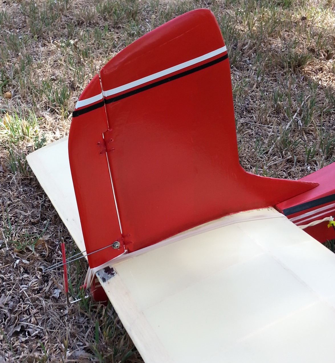

If you're thinking of making a new rudder, FWIW, a couple of pics of my installation in another model....... I mounted the servo to drive a torque-rod and use the old s/c type linkage for controlling the rudder. It is very simple to do, "looks the part" from the outside and means that you can remove the tailplane easily without having to disconnect anything.....

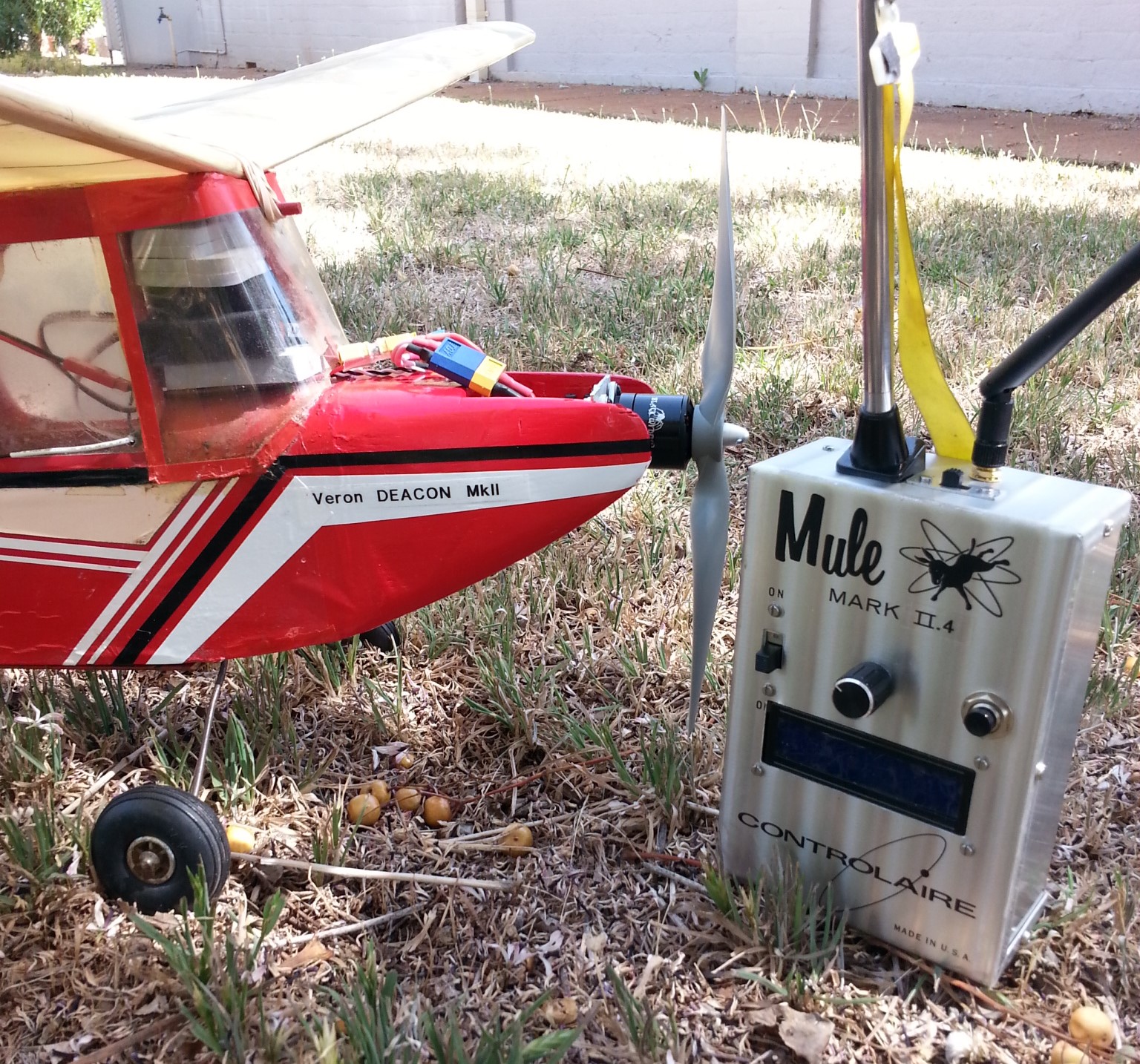

The changes: I retro-fitted a ZTW 2216 "Black Widow" out-runner with built in ESC (another HK bargain bin purchase ) - driving a 10x4.7 e- prop on a 3s 1350mah pack, it has considerable boogie, significantly more than what the Deacon has ever flown with previously

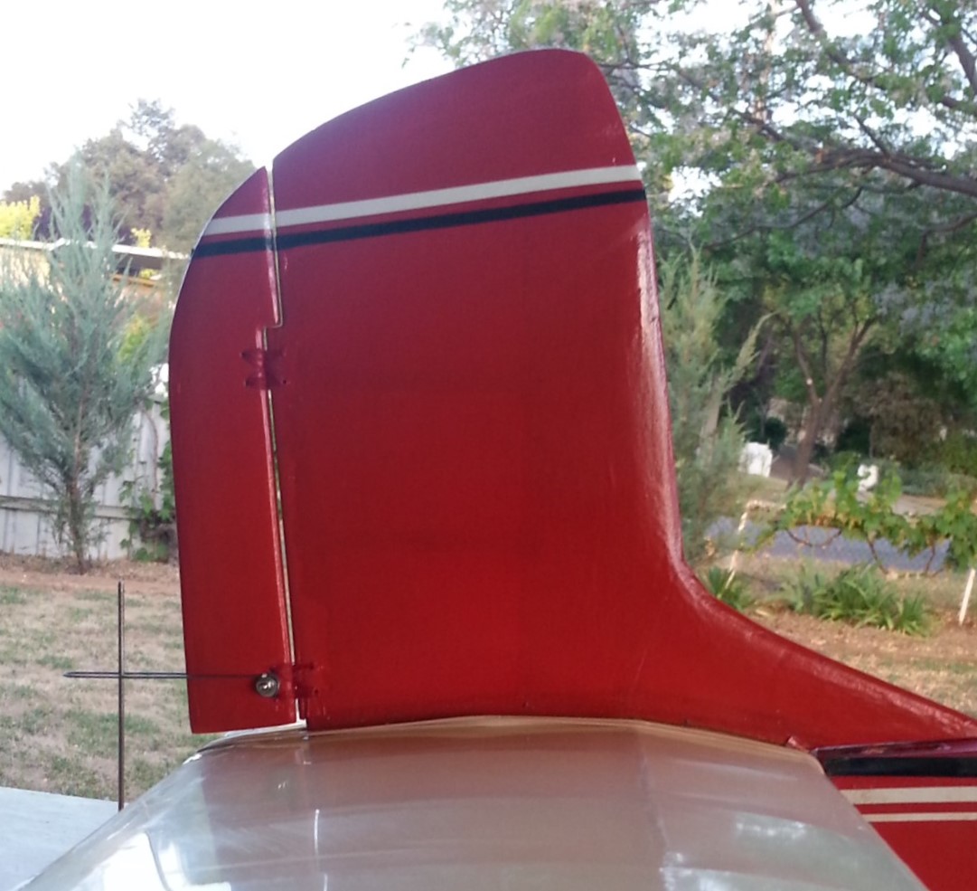

Rudder torque rod:
I stretched the fine vertically about 28mm and increased the rudder size by almost twice. The control horn has been replaced by the "traditional" S/C yoke to complete the illusion of using an escapement. Radio installation:
To eliminate the lead from the nose, I moved all the RC components as far forward as possible. The ZTW motor has a built in ESC, the motor battery now fits immediately behind and under the motor, the Rx is in the front of the "cockpit" and the rudder servo is hard up against the forward fuselage former. Since the ESC doesn't have a BEC, I made a small in-line adapter to supply a UBEC directly from the motor battery. Alternatively, I could have hooked the UBEC to the balance lead.
With the slightly enlarged fin, the nose looked really short so it was lengthened about 35mm, which also allowed more room for the motor battery. Fuel soakage was a problem with the engine bearers, so they were shortened back to sound material. A ply plate was then added to replace the removed bearers & join onto the remaining shortened bearers. Like a new (old) actress, it's had both nose & butt work done

Very similar to Paul's suggestion, I replaced the original push rod which was mandated by the OS servo output configuration, with a torque rod driven by a 9g servo. Rather than the yoke style connection to the servo that Paul used, I used a setup I'd used previously with a brass tube mounted inside a rubber tube which is in turn attached to the servo output arm - the torque rod has a wire end bent at 90 degrees that slides into the brass tube, the torque rod's rotational axis aligning with the axis of the servo's output shaft. Since the wire can slide in the brass tube, any small mis-alignments are automatically accommodated. I'm confident I can couple this arrangement to the OS servo output disc, such that I can go back to using the original OS Minitron radio installation if I wish. Rudder & Fin:PaulJ wrote: ↑01 Oct 2018, 08:55 If you're thinking of making a new rudder, FWIW, ....... I mounted the servo to drive a torque-rod and use the old s/c type linkage for controlling the rudder. It is very simple to do, "looks the part" from the outside and means that you can remove the tailplane easily without having to disconnect anything.....
