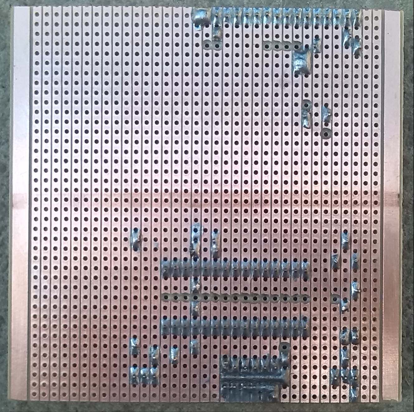

I have found a couple of photos of the vero layout but I've not been able to recover anything from Wayback or from my own backups.

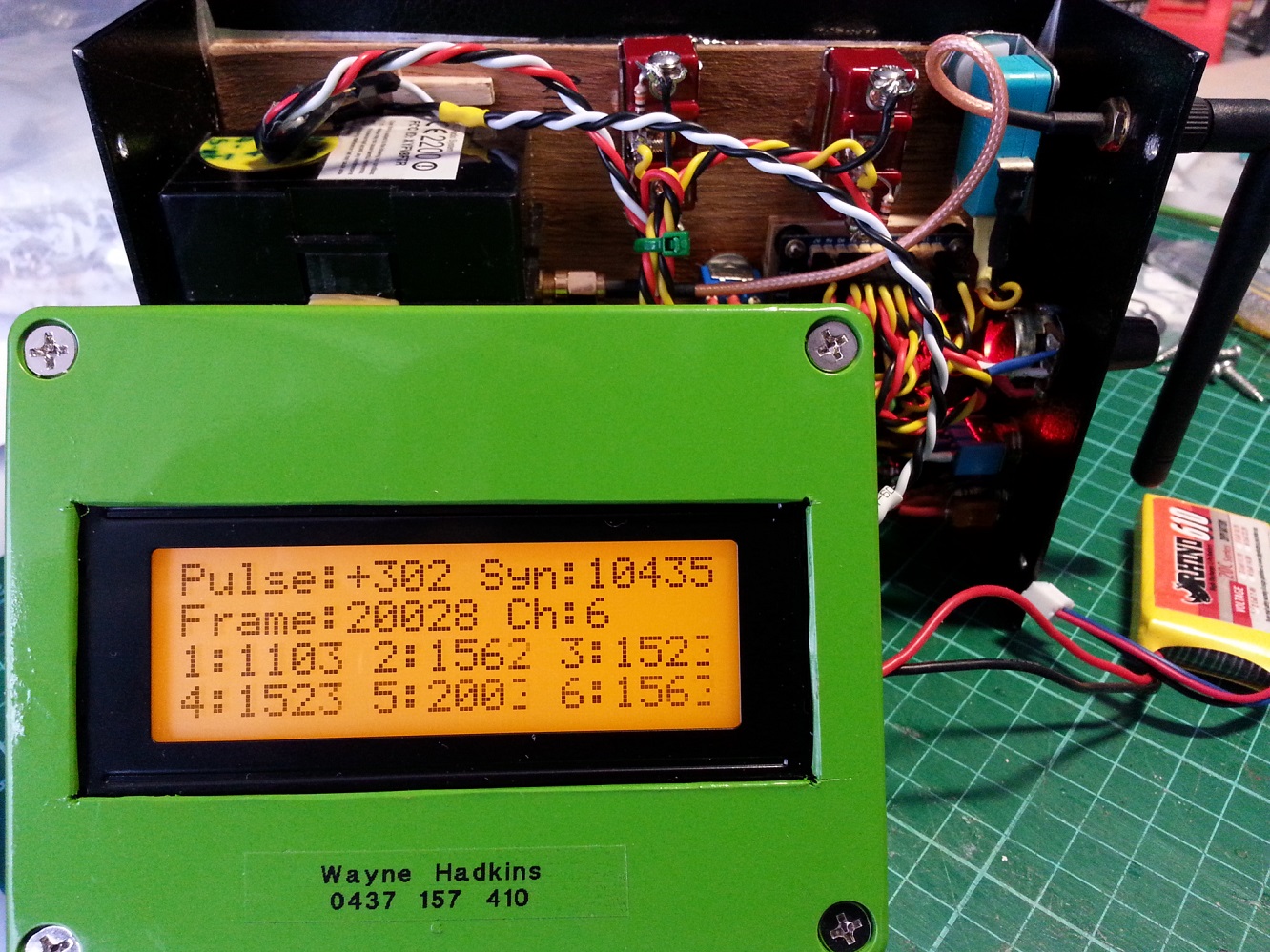

I find it very hard to photograph back-lit displays, so I have to turn the white-balance right down,
hence the dark photo. Honestly, its clear as a bell in practise!

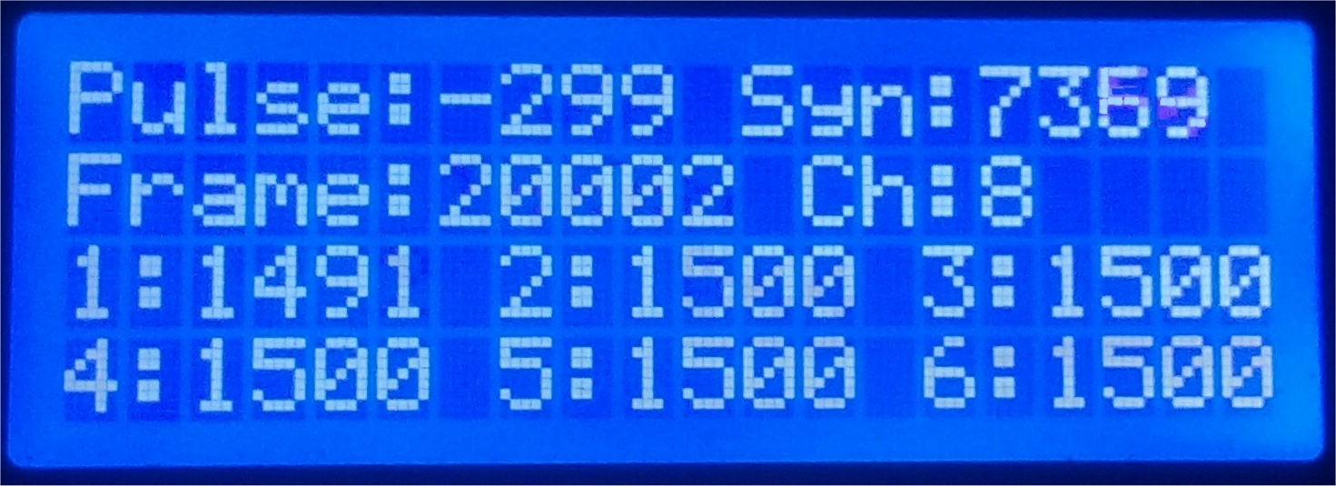

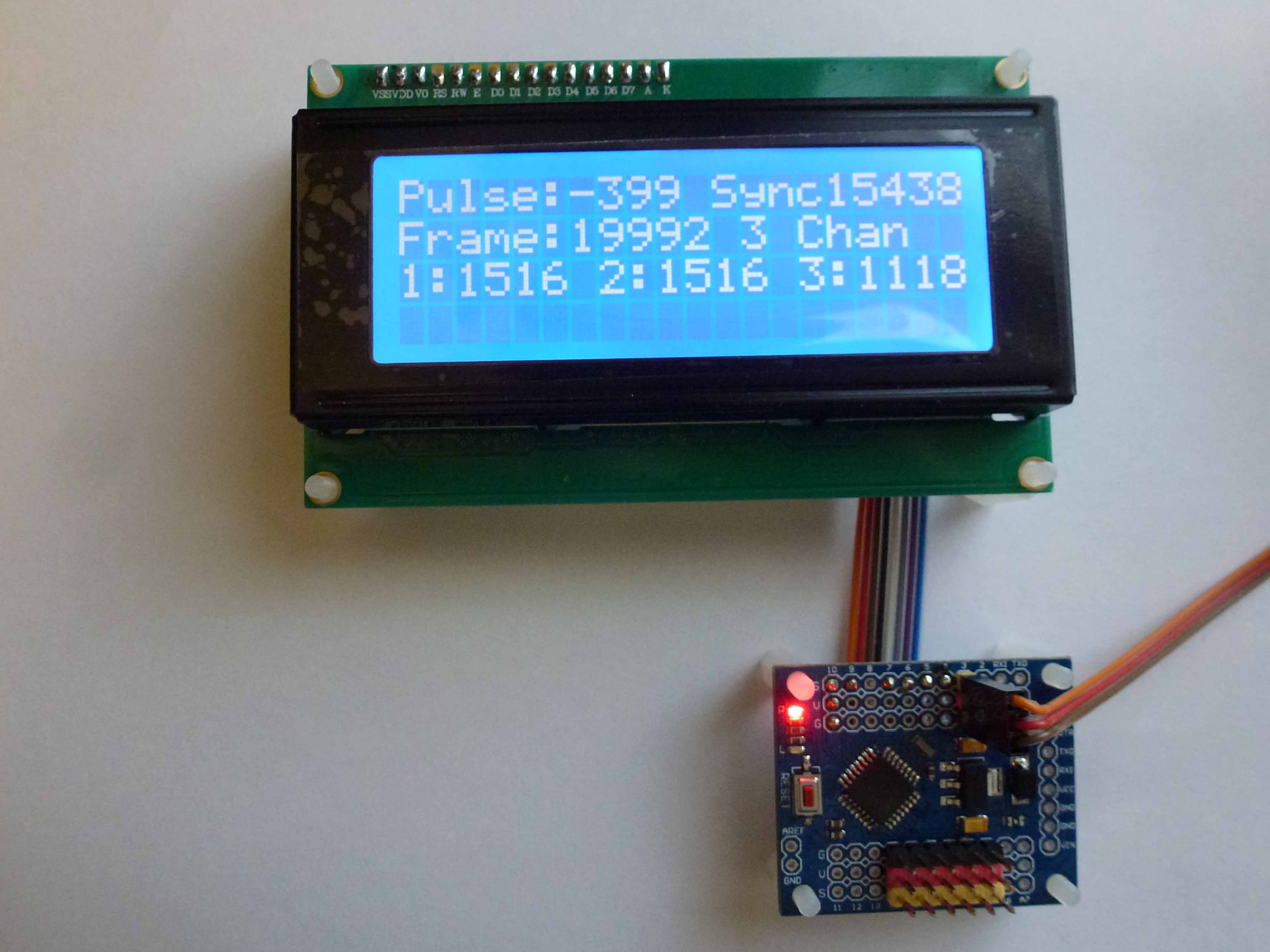

Here it shows a 20ms frame carrying 8 channels, using negative-going pulses of 300uS duration. The first 6 channel values are shown, 1500uS being 'neutral' of course. All values are shown in microseconds:

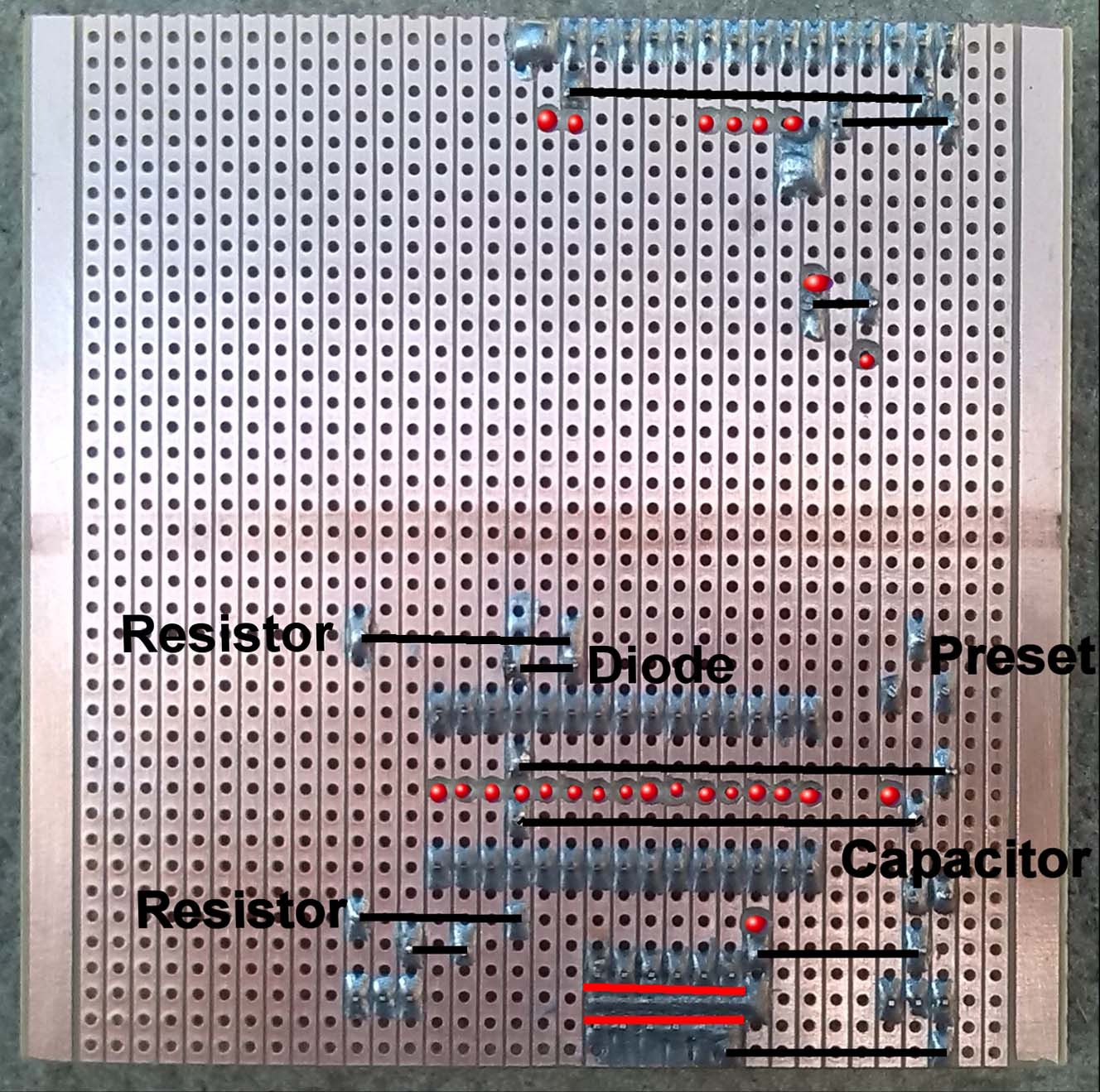

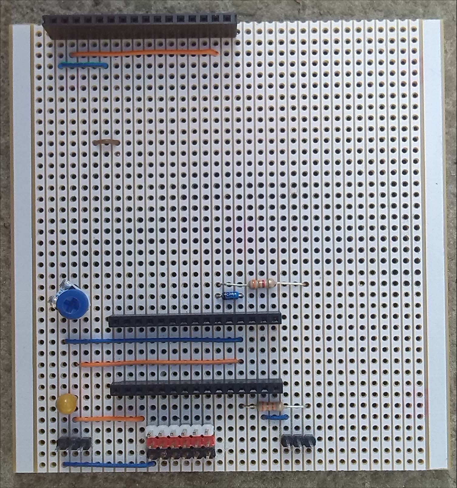

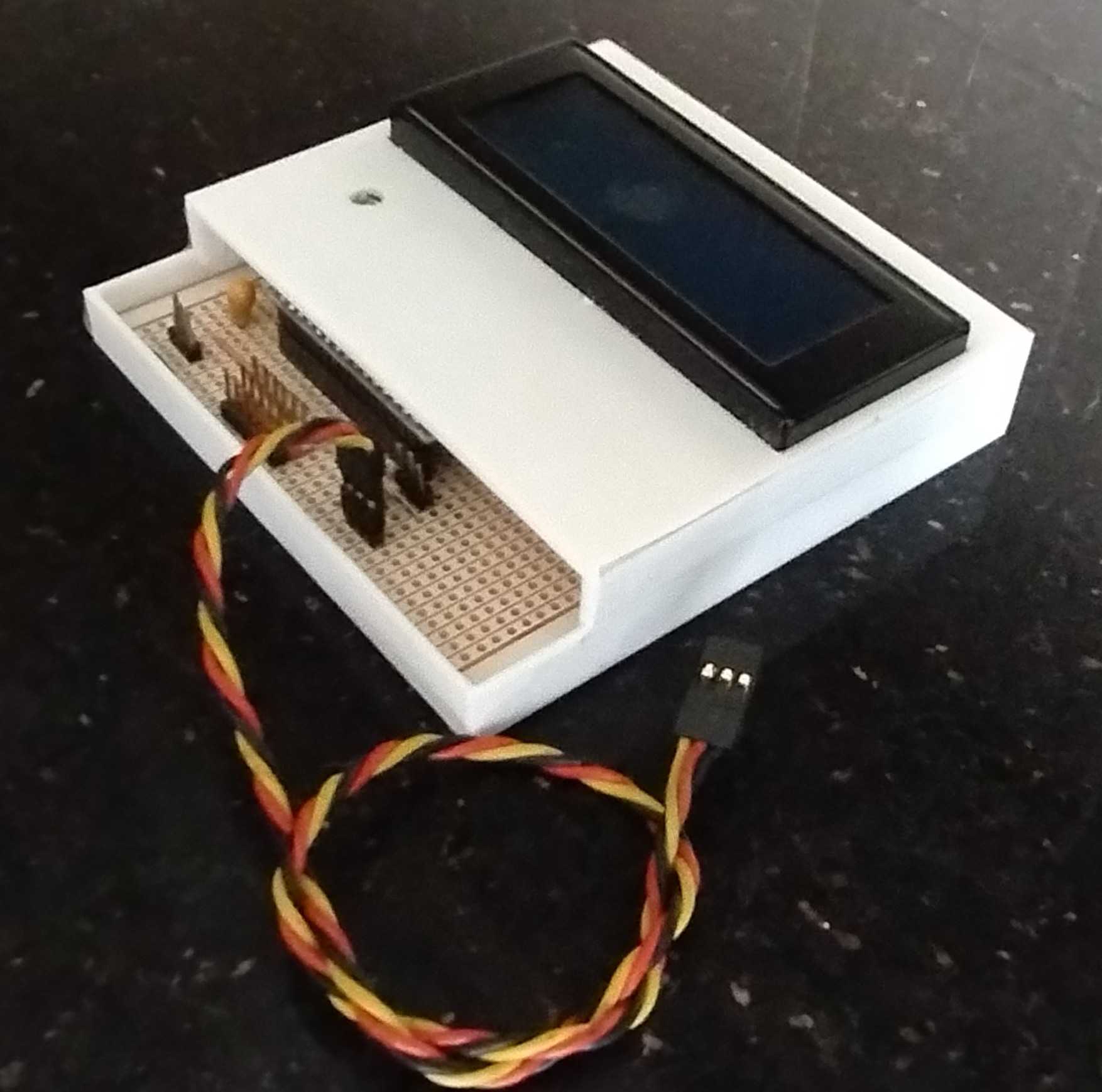

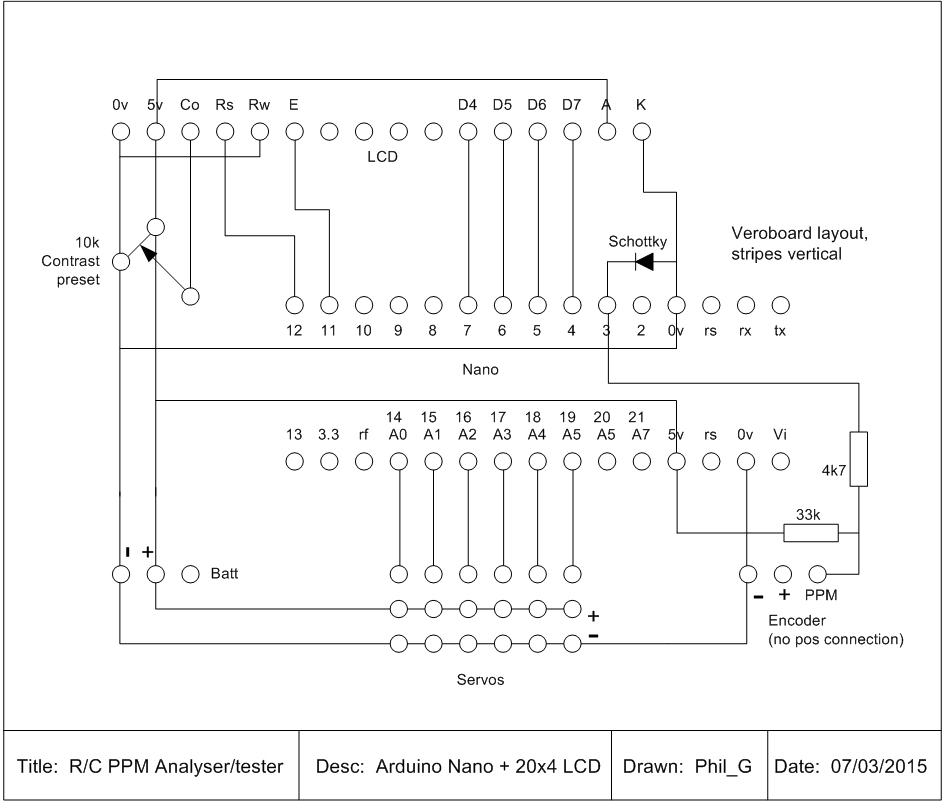

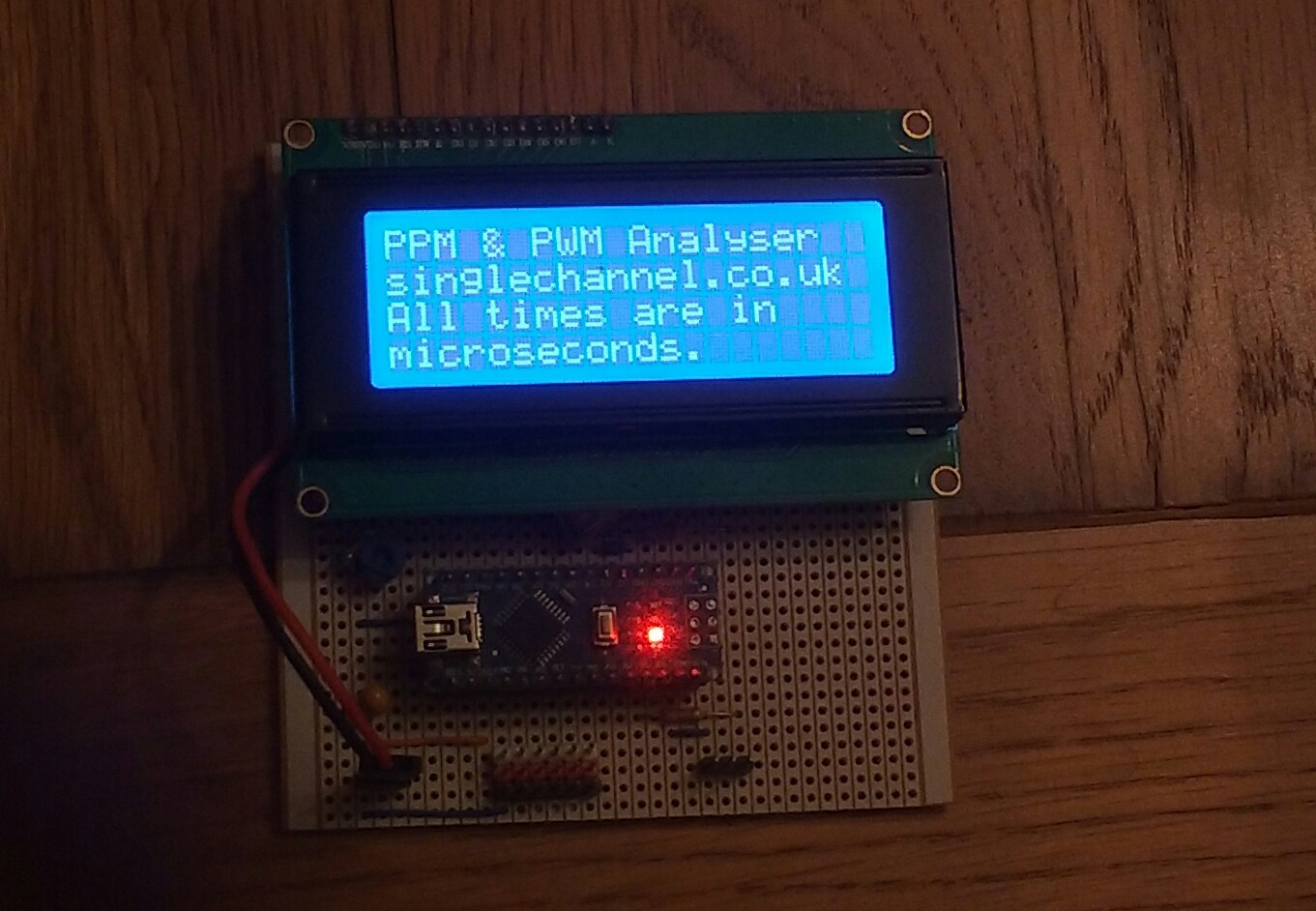

There is very little to it, just a slab of vero, a 4-line by 20-character LCD display from ebay, a Nano and a few headers. I haven't done a detailed vero layout but its very easy to recreate from this drawing, I've aligned as many connections as poss but there are some cuts and bridges to make. The hardest part is the servo block which is 'against the grain' as you can see in the vero photos. Track cuts have to be made between the servo block holes, or you could use a small vero strip mounted at 90 degrees to the mainboard, carrying the pos & neg to the servo block:

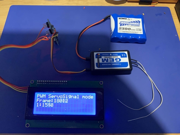

Also I forgot to mention that it measures PWM servo pulses too, ie from a receiver channel output:
Here's the diagram which is also a suggested layout: NOTE the weird orientation of the contrast preset pot - see 'top' photo.

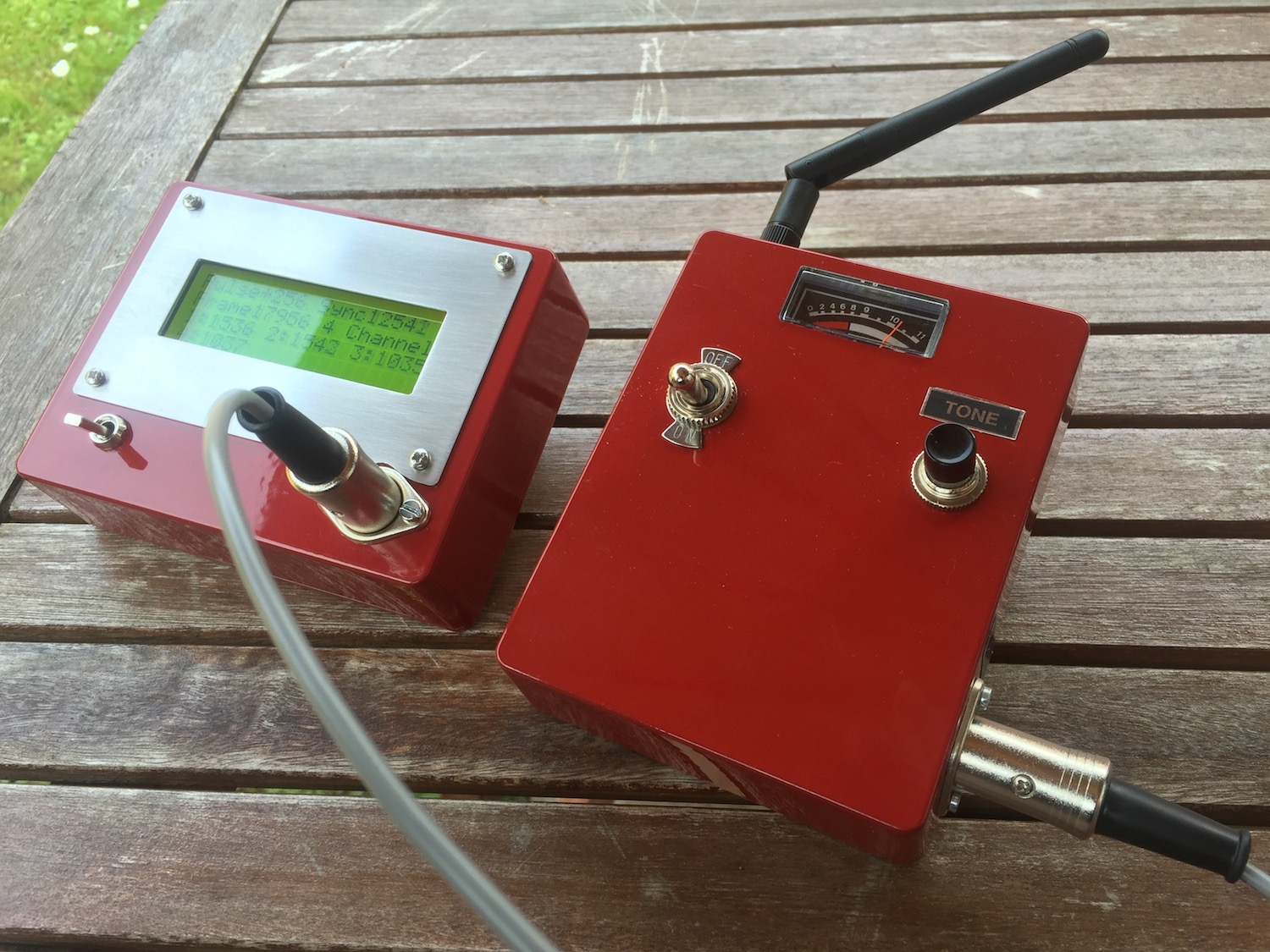

and here's Ron's S/C transmitter connected to the PPM tester...

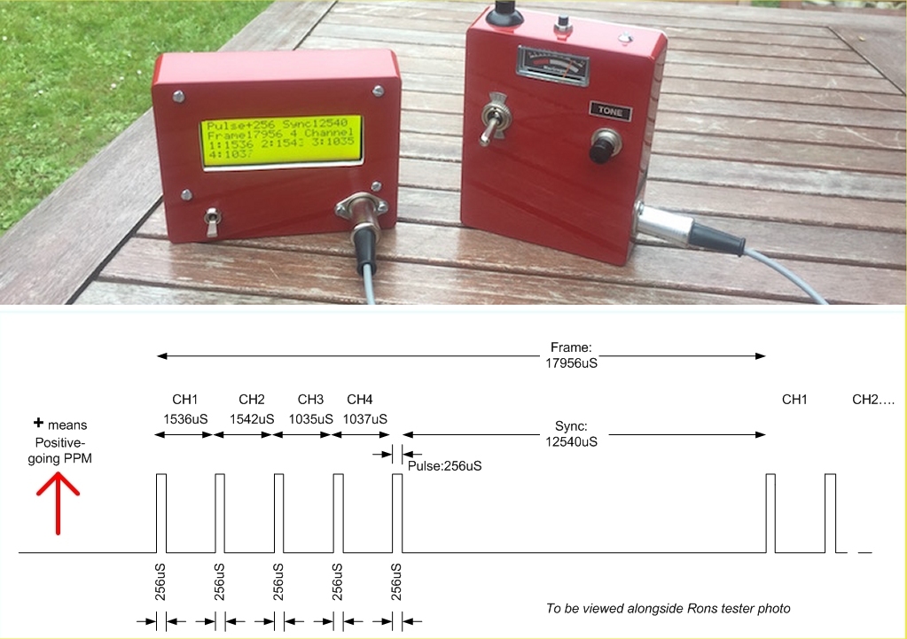

...and an explanatory diagram showing how the numbers relate to the PPM stream:

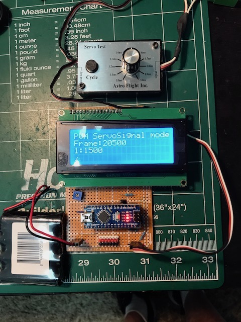

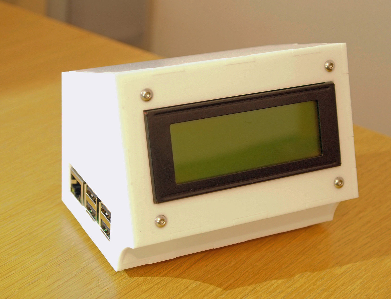

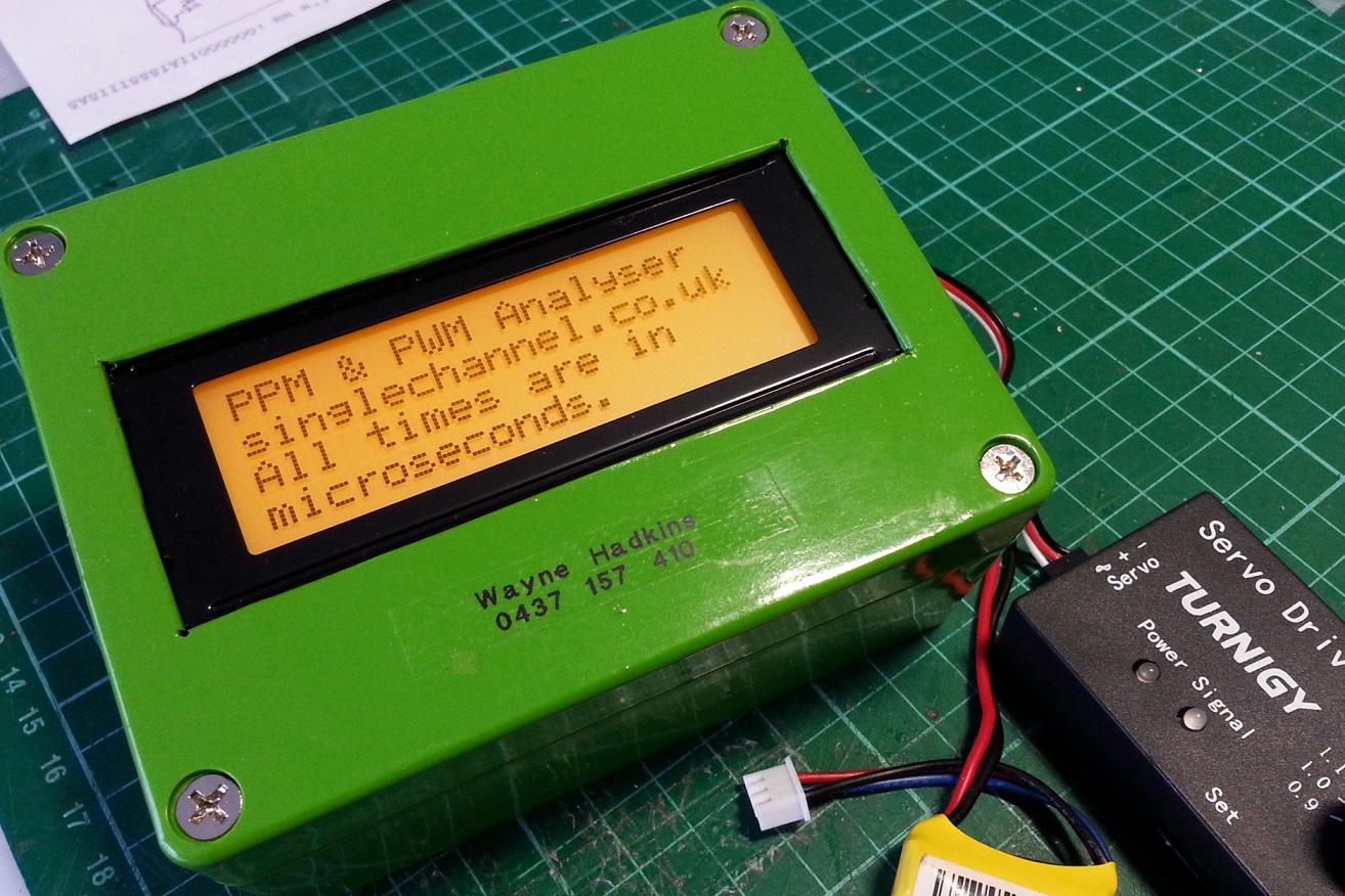

Here's a photo of my finished tester connected to a tranny.
This is a fantastic project thats very easy to build and super useful.

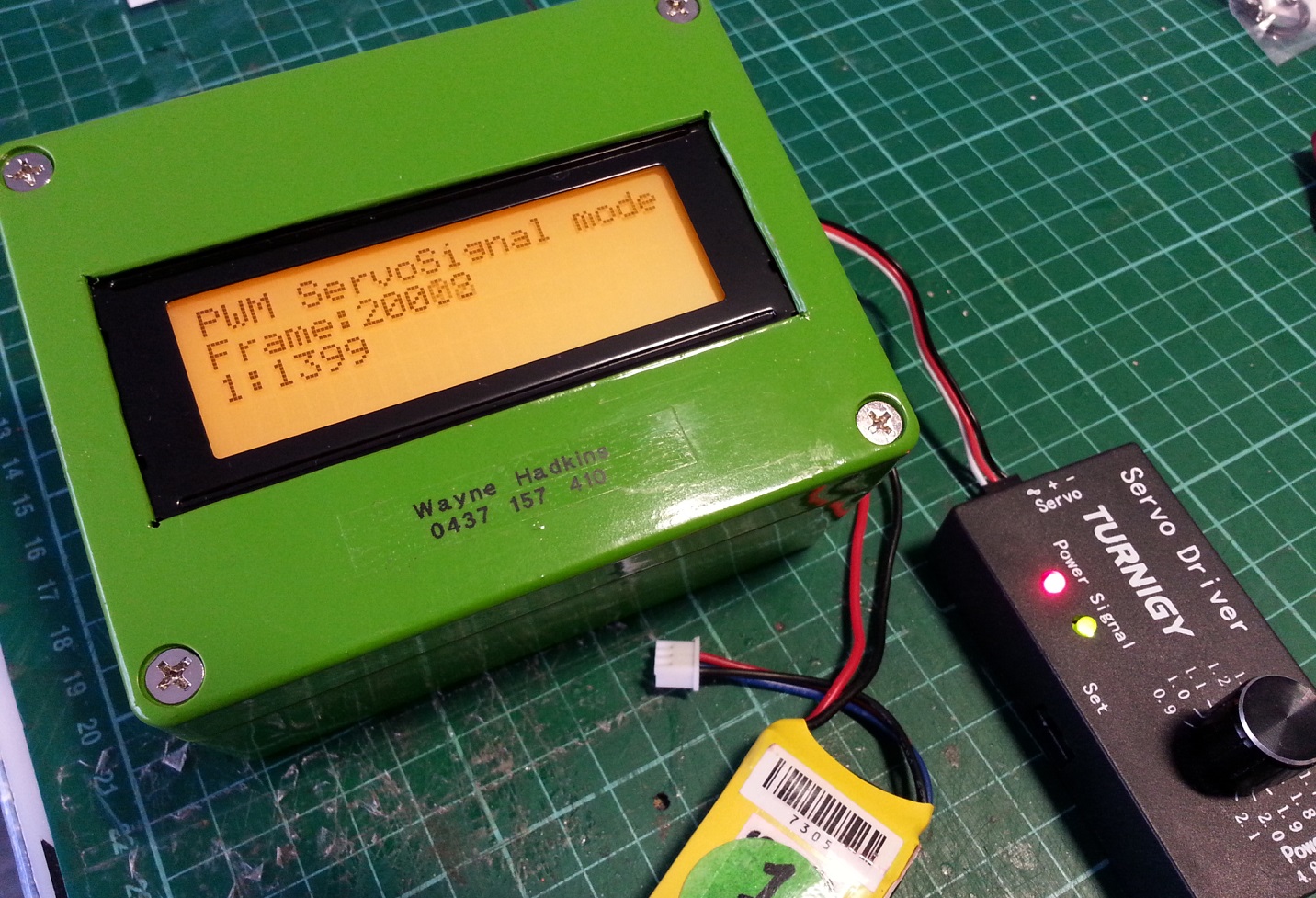

This is the one I built....
1 1/2 yrs on and it is still unboxed but still used to check my projects.
Ade
Ade

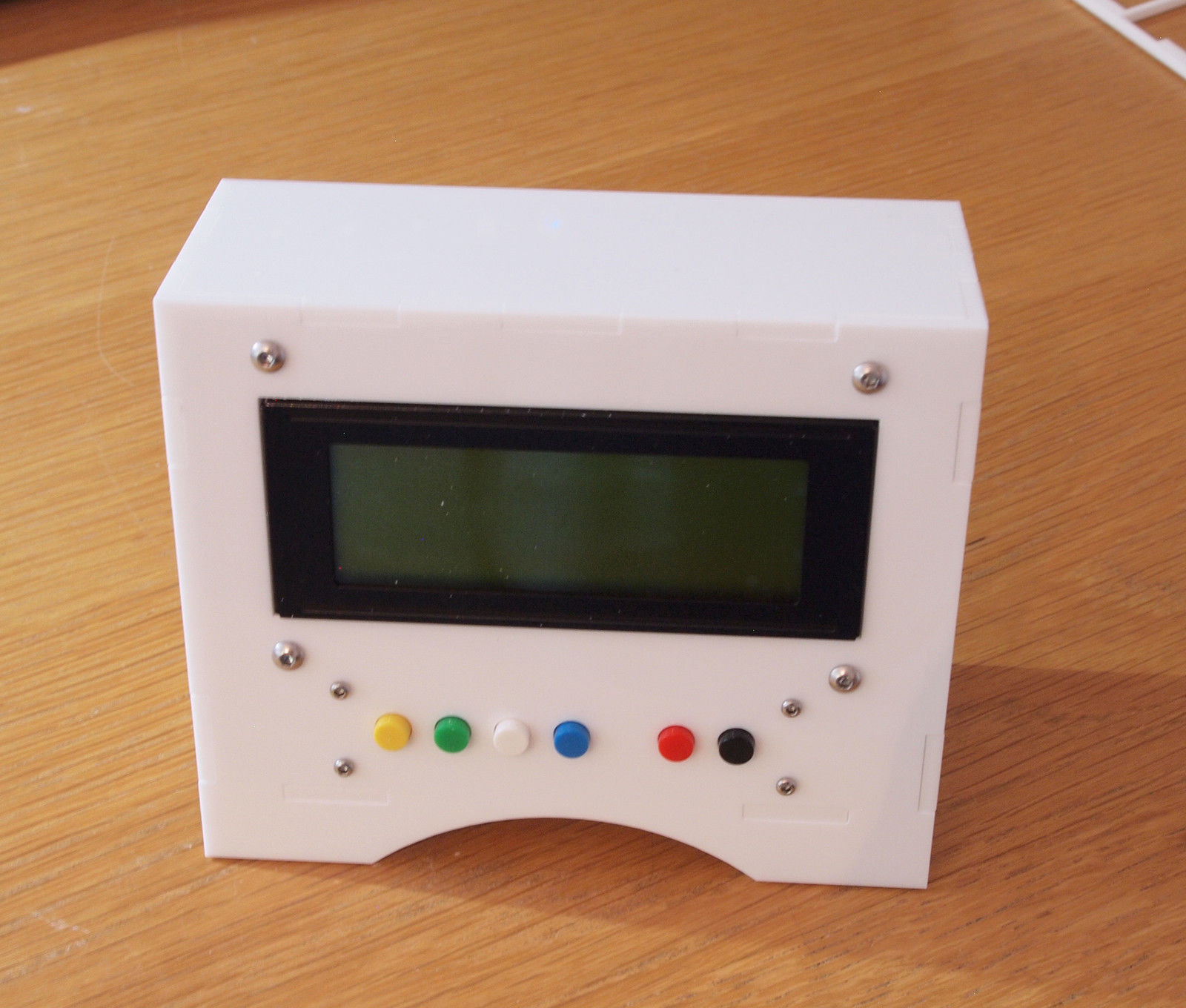

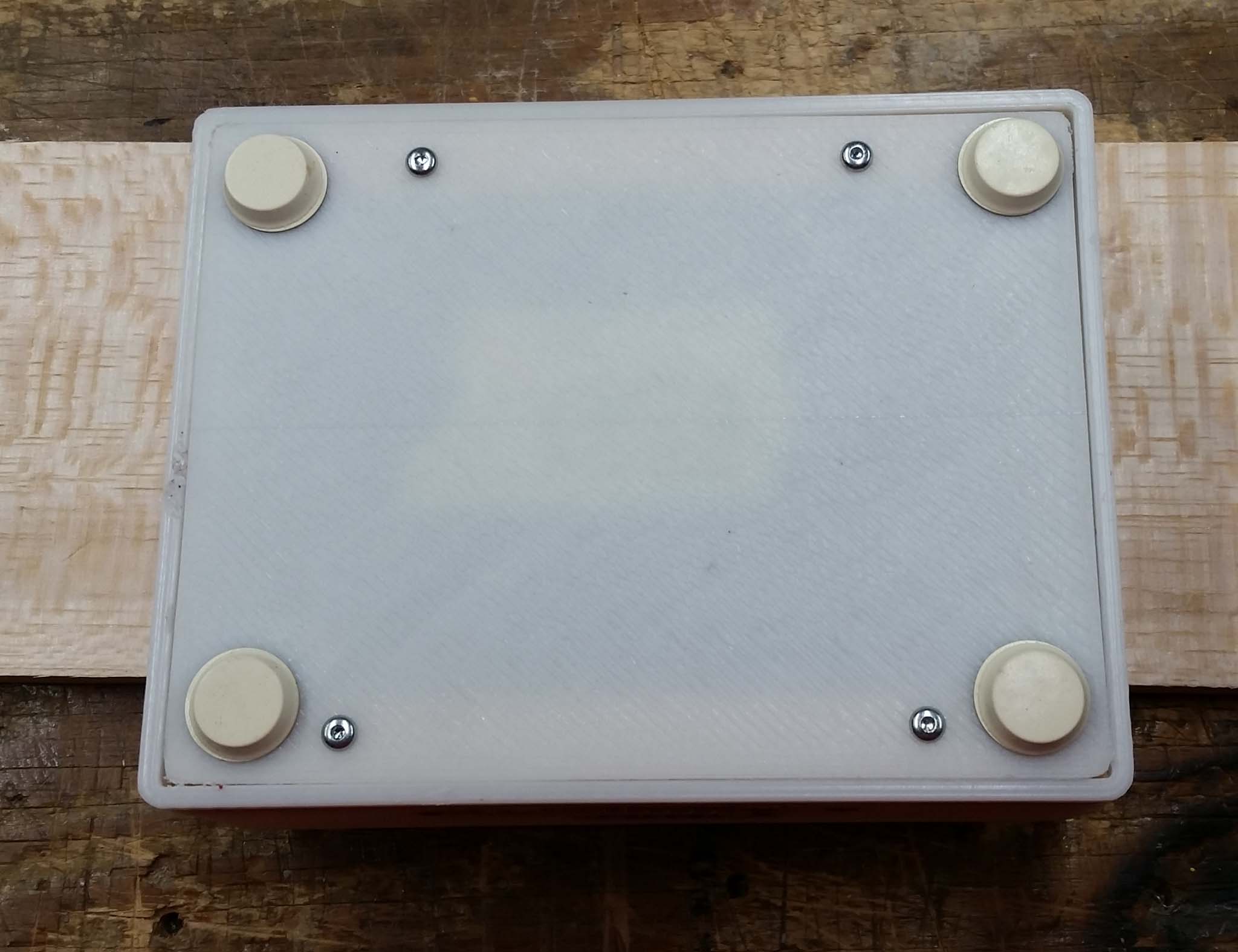

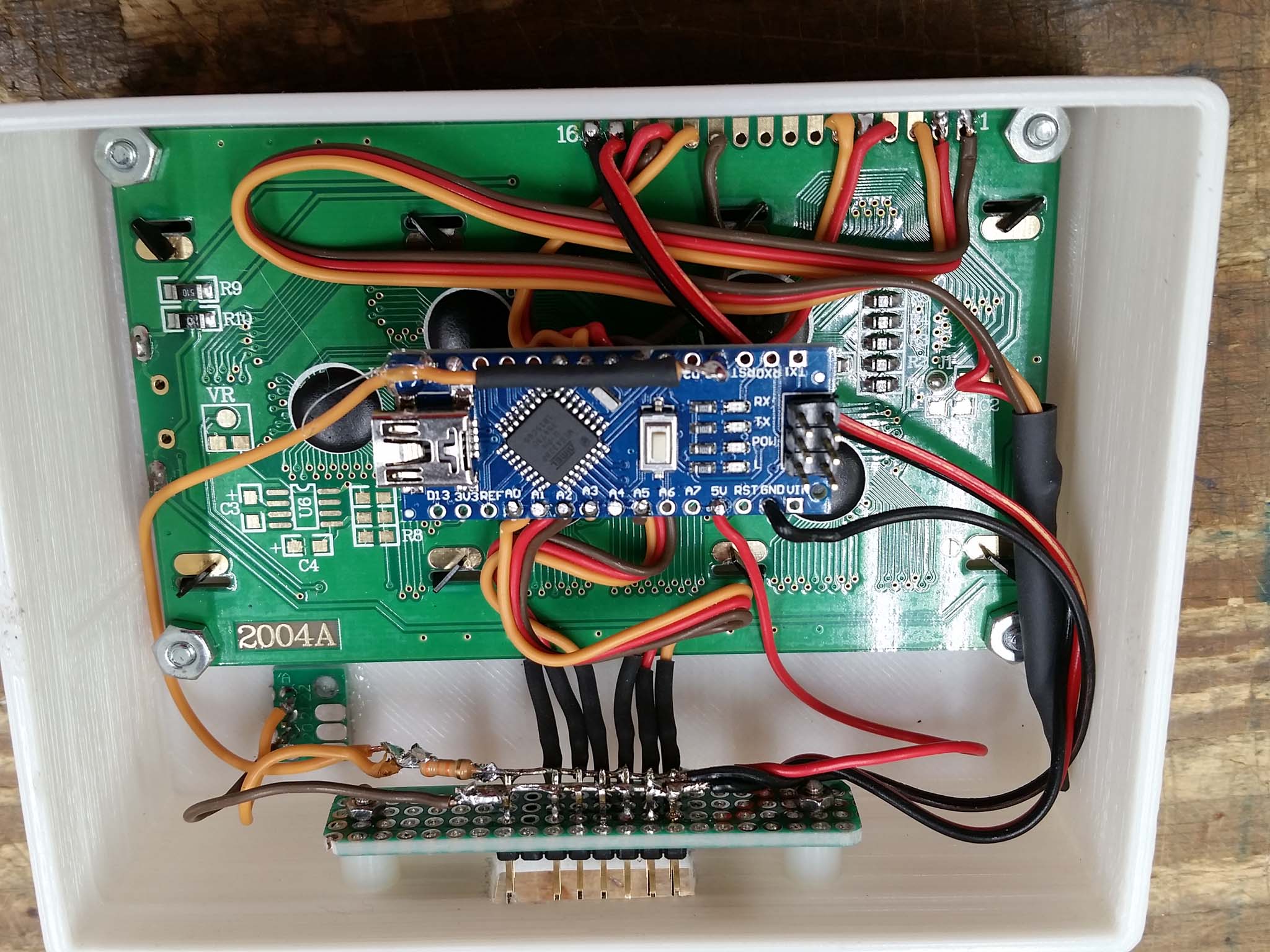

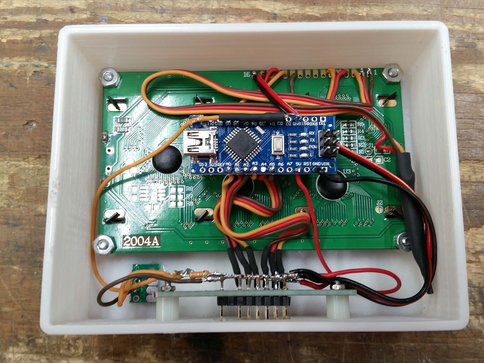

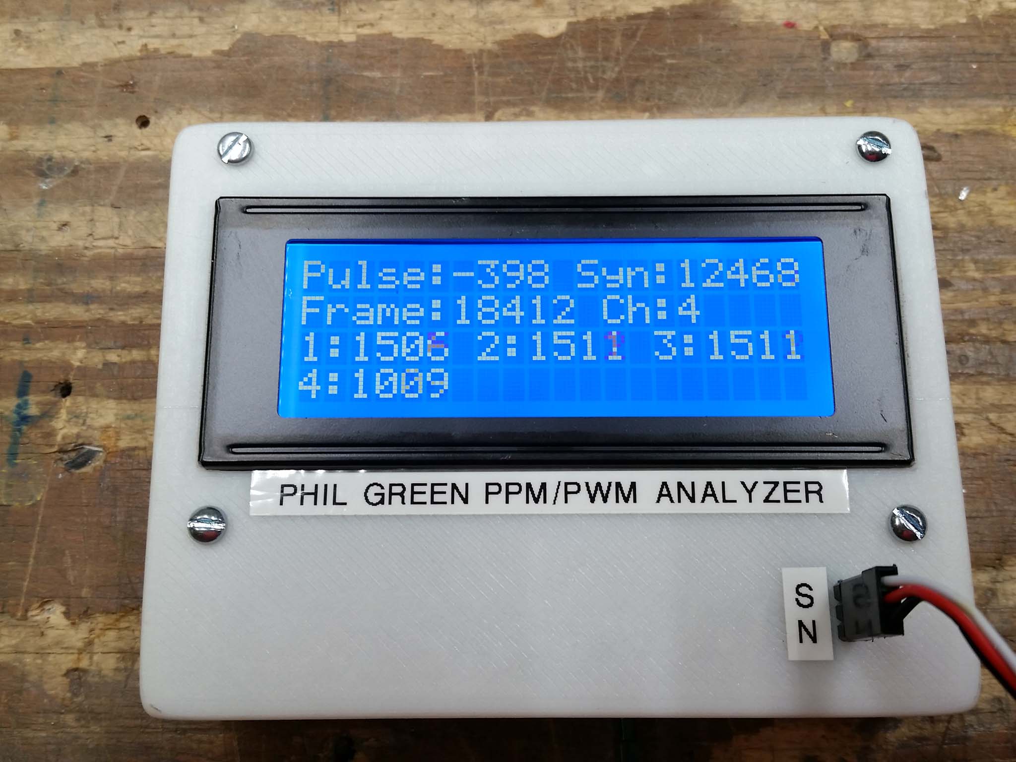

Here's my build of the analyser. Basically wired it point to point. A real test of my 67 year old eyes! I designed and 3D printed the 110x85x40 case for it. If anyone is interested I can email the .stl file to them. The LCD opening was a bit tight and a few strokes with sandpaper got it in. The servo header opening requires cutting out manually.
I altered Phil's sketch to show the "Americanized" spelling of "analyser" to "analyzer" and to allow the splash screen to be displayed for 2 1/2 seconds. This allows an easier read for me anyhow.
Thanks Phil!
Thanks Phil!
