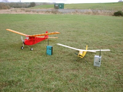

I have both a Tomboy Senior (48") and a Poppet, both rudder-only:
They both fly great, both very stable & responsive, the Poppet is easier to transport, but flying-wise they're very similar and both ideal S/C models. Of the two I think the Poppet has the edge on cuteness.
I would suggest that neither needs an elevator, rudder & quick-blip throttle is a lovely relaxing way to fly.
Tongue-in-cheek, I'd say that any comp that necessitates an elevator on a Tomboy needs its rules corrected! Only joshing, dont take any notice of me
Power- the Tomboy 48 has a Blue-Wonder 1400kv on a 8x3.8 slowfly and a 3S 1000mAH which gives about 90w max, the Poppet has an 1810 with a 5x3 on a 2S 500mAH which is about 40w max. Both have plenty of power and cruise nicely at half throttle. I took the Poppet to the last Old Warden 'Mayfly' and had a great time with Paul J & Mark D, it was a brilliant day.
