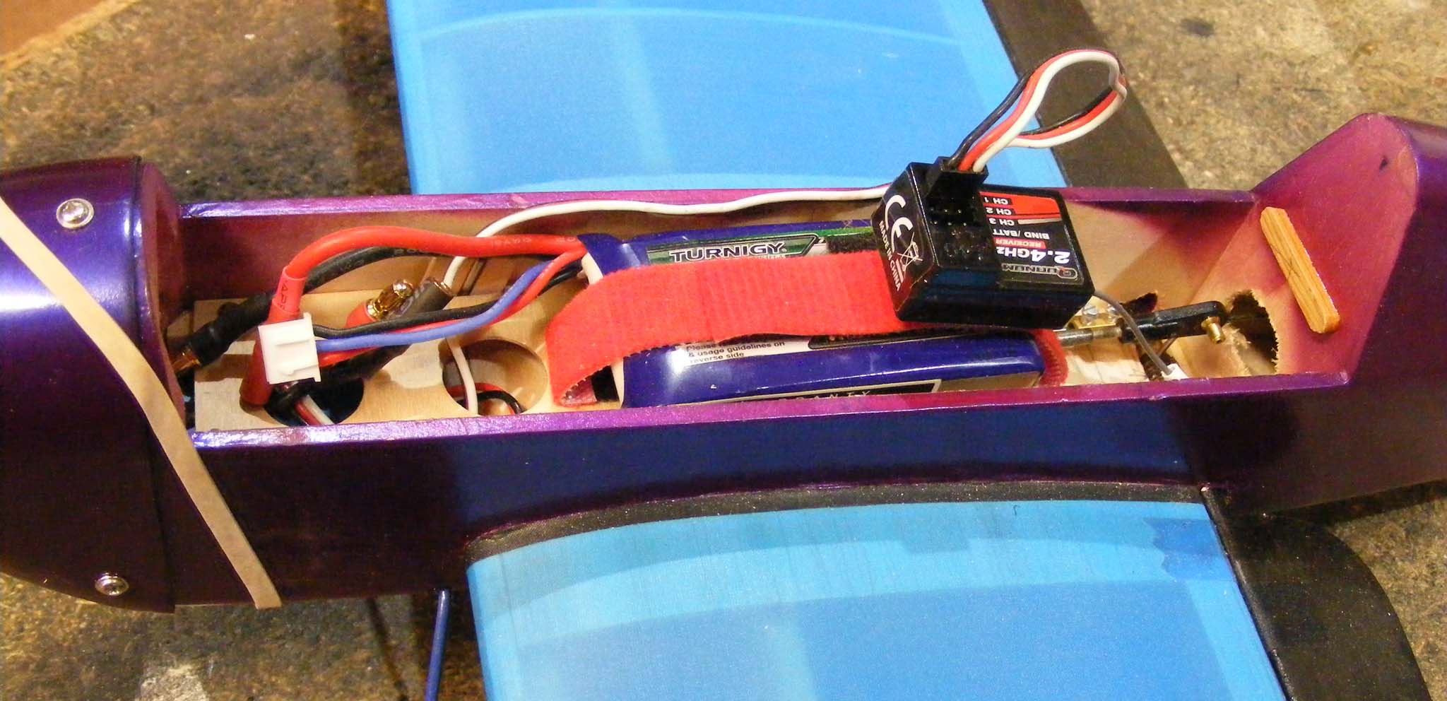

Blue Pants (ozone) with a few minor fuz mods for battery/timer stowage and access makes a brill ecl stunter and seems an ideal size for all round performance using about 150 to 200W.
Having been impressed flying one of Den's 'Trainer' models with experimental RC throttle built into the handle, I recently completed and maidened a Mercury Marvin, using a pistol grip Tx in the left hand for complete throttle control. Bell motor, 2S 1300LiPo. Tx/Rx combo here:
https://hobbyking.com/en_us/quanum-2-4g ... tore=en_us
Urgent mods now for more outer tip weight and rudder offset - I can't run backwards like I used to :shock:
P.S. I built Marvin in a wave of nostalgia but consider it a bit too small to be an easy ecl aircraft.
