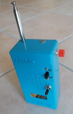

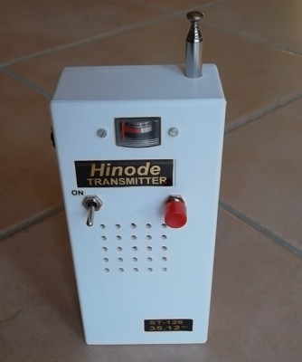

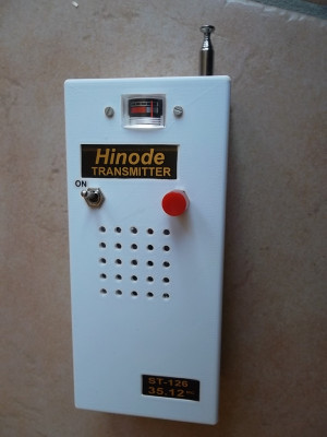

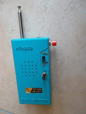

The two Hinode transmitters are finished and test-flown.
The white one is a S/C transmitter offering compound mode with kick-up elevator and quick blip throttle or sequential mode. Also it has low voltage alert and inactivity buzzer.
The heart is a Digispark Attiny85, HF comes from a 35MHz modul, power is a 9V style Lipo.
Test flown in a Schollboy, no problems. The other Hinode replica has the sequential mode or compound mode with kick-up elevator as well, but uses a progressiv throttle on the rocker switch. Inactivity buzzer and low voltage alert.
The heart is a Digispark Attiny85 as well with P5 activated using Phil´s Fuse Programmer.
HF is a 35MHz modul and power is a 9V style Lipo also.
Test flown in the Schoolboy as well, no problems either. Both cases were 3D-printed.
Thanks everybody for the help and inspiration.

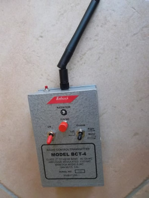

The Babcock transmitter is also ready and testflown.
It uses Mike_K´s S/C encoder on an Arduino pro mini. The Rocker switch offers additional bang-bang rudder.
HF is an Orange 2.4GHz module.
The case is 3D-printed.
Testflown in a Tomboy. No problems. Thanks everybody for the help and inspiration.
