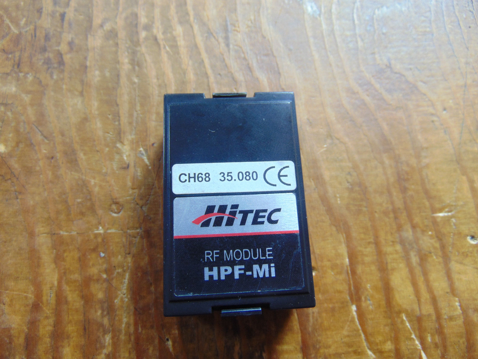

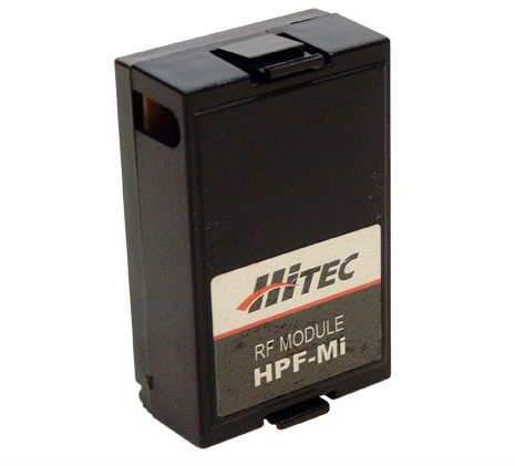

The Hitec HPF-Mi is a 35mhz RF module in the 'Futaba style' which is ideal for the conversion of 27mhz sets like my KO DigiAce:

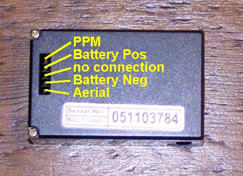

Connections:
The connections use the standard Futaba pinout, battery pos, battery neg, PPM and the aerial.
The aerial wire is kept short and is run directly to the aerial base, keeping it as far away as
possible from any other wiring:

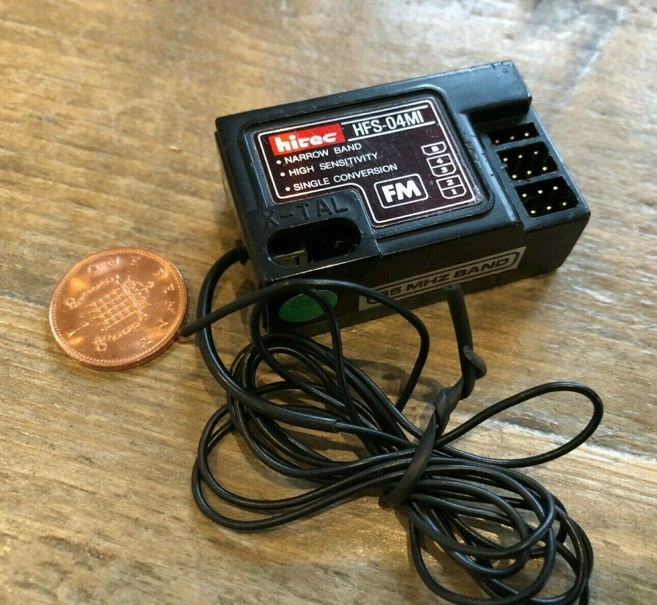

Not at all critical, genuine Hitec receivers are fine...
Be aware that the Hitec receiver IF is above the tx frequency whereas on most including Futaba its below, hence you must use the appropriate rx crystals - or use a synth receiver.

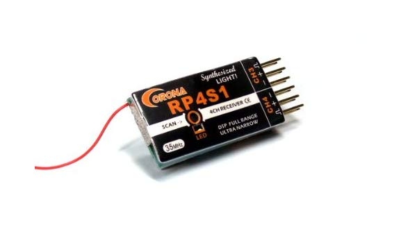

Otherwise, Multiplex IPD, Micron, Corona crystal receivers (R410, R610 etc) and the synthesized RP4S1, RP6S1 etc all work fine with excellent range.
