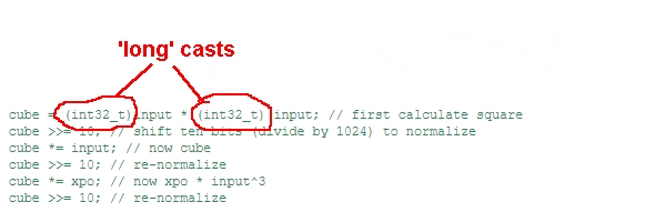

MaxZ wrote: 12 Jun 2019, 08:06Phil, what did you mean by "long casts", too much calculation in a single statement?
No, its not the length of the statement, casts change the 'type' of variable or constant, avrgcc assumes 'int' by default so suffix an 'L' to cast a value as 'long'

Here's a quick example I knocked up that uses the (cube) formula recommended by Mike_K. This is all integer math and uses the range -1024 to +1024 for the input, output, and expo value. You could easily modify the code to use some other range, but 1024 is plenty accurate enough for radio control. If you increase the range then beware exceeding the limits that a (signed) 16-bit integer can hold: -32768 to +32767

  int32_t cube, i; // intermediate values use 32-bits.  input values (16-bits) are cast to 32-bit for calculations.
  cube = (int32_t)input * (int32_t) input; // first calculate square
  cube >>= 10; // shift ten bits (divide by 1024) to normalize
  cube *= input; // now cube
  cube >>= 10; // re-normalize
  cube *= xpo; // now xpo * input^3
  i = (int32_t)input * (int32_t)xpo;
  i >>= 10;
  int32_t output = (int32_t)input - i + cube;
  return (int)output;

Thanks Martin.
As I said in my previous post, it was meant as a exercise but it got too ambitious for me.
I can follow your example though, it seems the trick is to divide it up in steps and to "normalize" by bit shifting after each step. Not the "throw it all in and see what happens" method I was using, likely to exceed the limits of what values a variable can hold.
What is an int32_t variable type, I can't find anything on the Arduino site, or anywhere else for that matter. I am guessing a 32 bit integer (a.k.a. long?), but what does _t mean?
Max.
P.S. Mike and Phil, don't worry, I will not try to invent the wheel again :D
Posts: 781
Re: Exponential control
Yes, int32_t is the same as long for 8-bit Arduinos. An unsigned long is uint32_t. The _t part just means 'type' and the names are consistent so you can have int16_t for a normal int, uint16_t for an unsigned int, and so on. I find it easier than having char, int, long, long long, and so on, with or without unsigned and the names are consistent across different boards. If you just use 'int' then you'll get 16 bits on most Arduinos, but 32 bits on a Due - an int16_t is always 16 bits on all of them.
