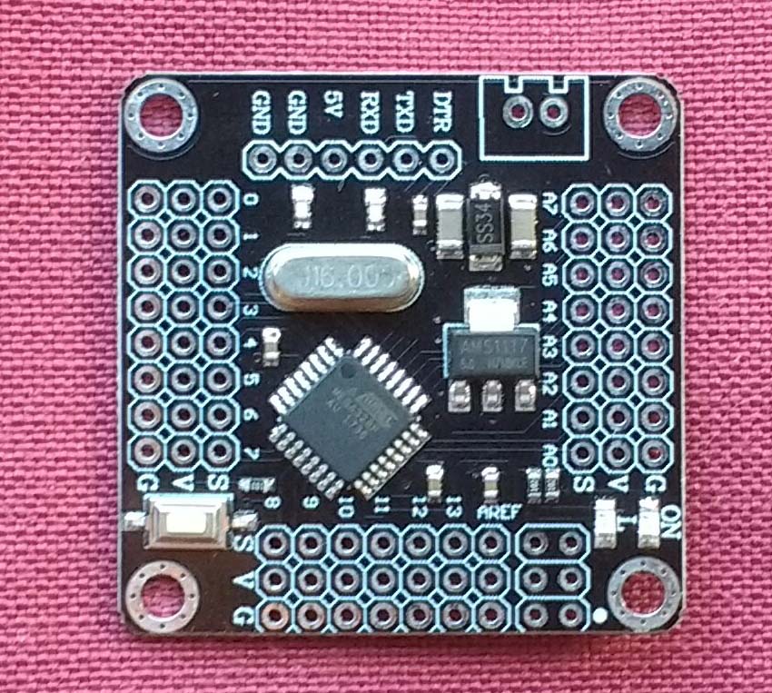

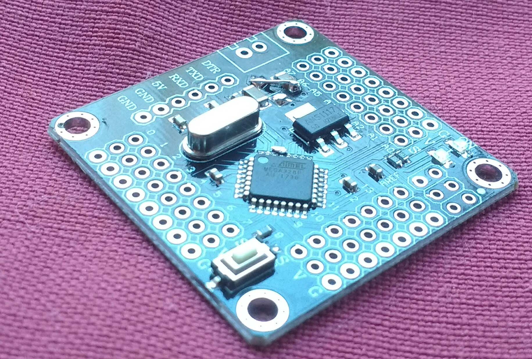

This PCB is the current version of the 'old' DIY-More board which in turn replaced the Deek_Robot board. Whilst any of these boards are brilliant for encoder projects, they are all slightly different and each can be very slightly modified to make a 'brilliant' board 'perfect'
This describes the mods for the 2018 version (this particular board only) recognisable by the 'servo' headers on 3 edges. Here's where I bought mine:
https://www.ebay.co.uk/itm/Pro-Mini-ATm ... 2484056646
There are a few nice additions to this version, for example it has a 16mhz crystal rather than a resonator, so it will be more accurate and more stable than the previous versions which used ceramic resonators. It has a nice 'power input' header, for which an optional connector shell is supplied. The servo headers are the 'sensible' way around (ground round the outside edges, signals on the inside) and it also has an icsp header (see below). Note that the ebay seller has the header pin colours wrong AGAIN! They should be black on the outside, red in the middle and yellow on the inside. The "neg/pos/signal" screen-print on the PCB is correct, G=ground, V=5v, S=signal. DONT copy the pictures!
Click to enlarge: .

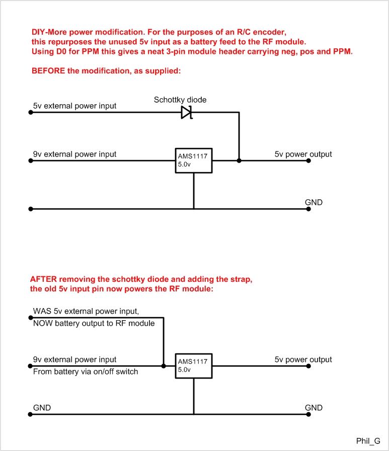

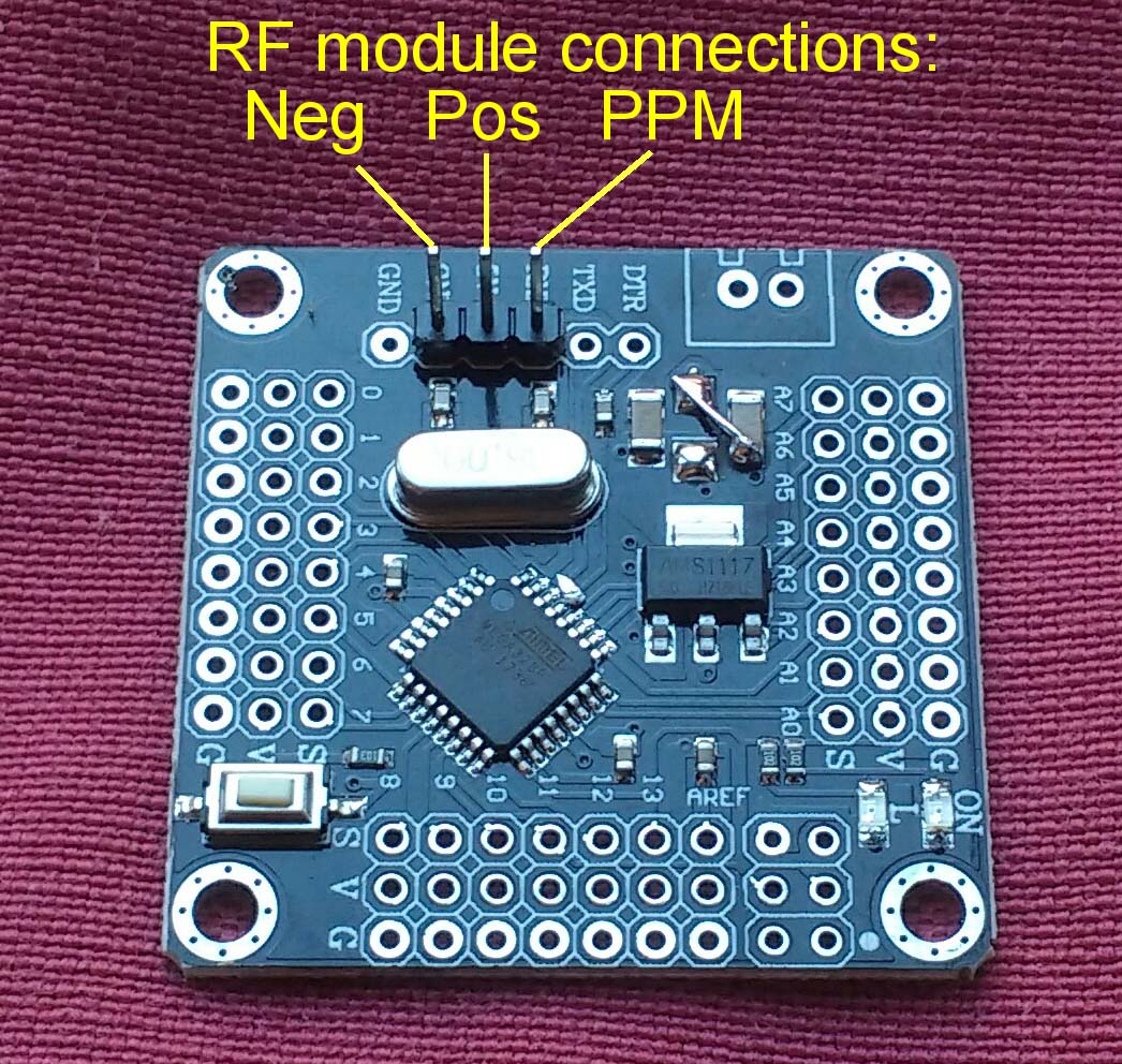

The aim of these mods is to provide a simple 3-pin header for our RF module, carrying neg, battery and PPM, which in the sketch will need to be placed on D0 (also known as RXD). I've traced the layout and found that the 5v input (which we dont need) can easily be isolated by removing the series schottky diode. Here's the board as supplied, note the schottky position above the 5v regulator: .

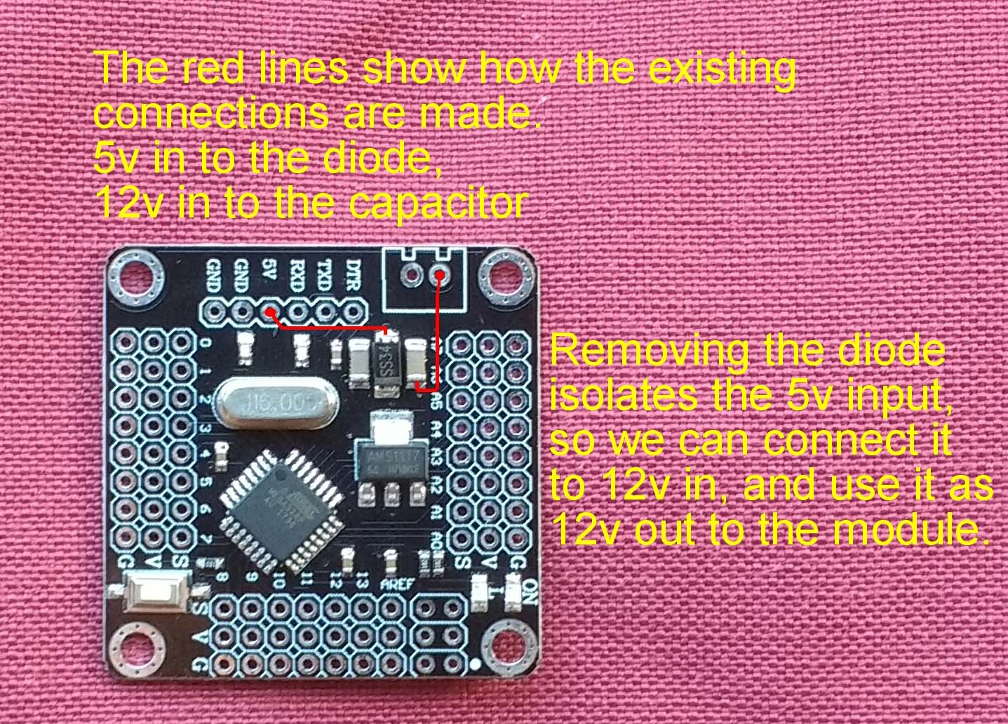

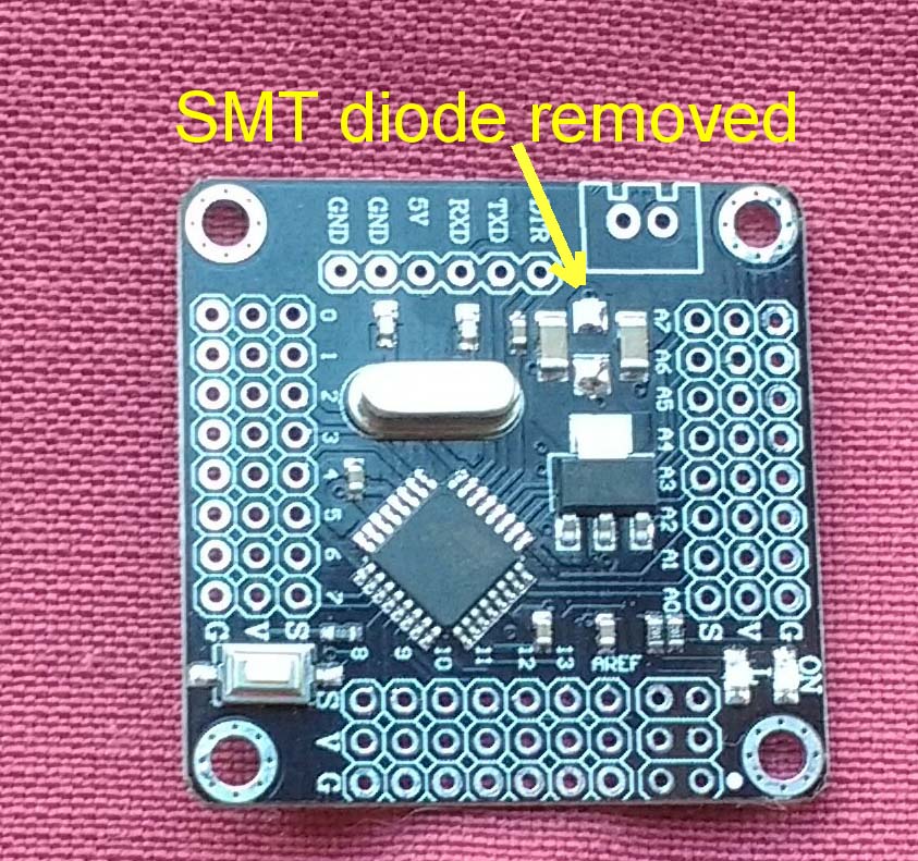

Here are the traces, in red, showing the 5v input going to the diode, and 12v input to a capacitor: .
So first we remove the diode - its much easier to do this before adding the headers! .
Having isolated the 5v input header, we can now use it to provide battery voltage to the RF module.

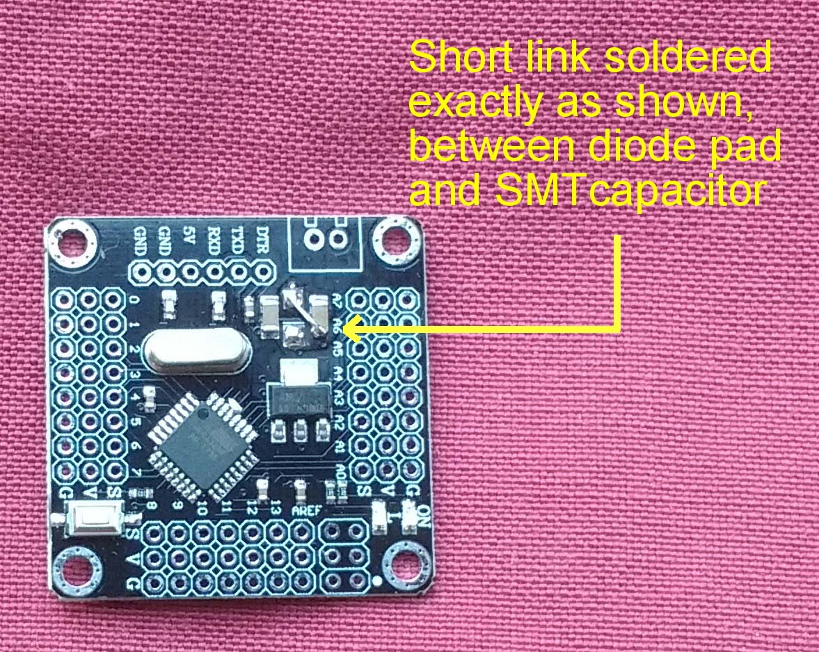

This is done with a short diagonal strap from the upper diode pad to the lower end of the SMT capacitor: .
Heres a closer look: .
Now we have battery voltage on what was the 5v input pin, we can add the RF module header - neg, battery and PPM (RX/D0):

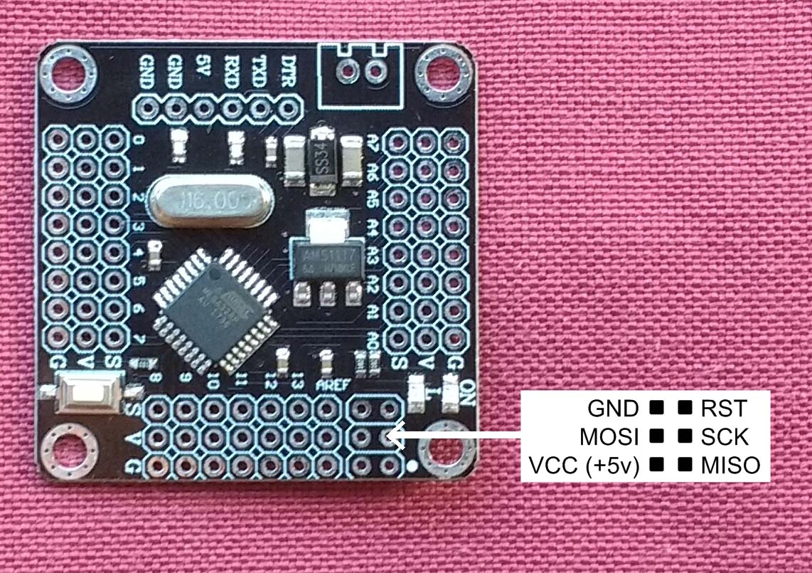

Programming is via a proper ICSP header, you can either solder in the header pins, or do as I did and just temporarily plug in the usbasp whilst programming:
I've tested this before posting and until they inevitably change the boards again, this is gen.
With the mods suggested the new 2018 board is ideal for propo and reeds encoder projects.

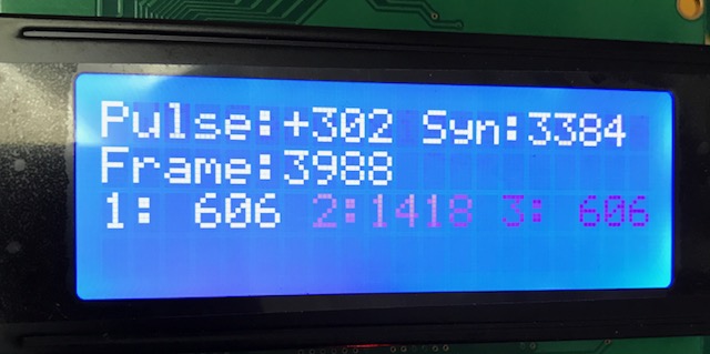

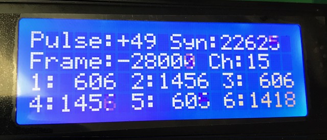

I'm having trouble with this board. Maybe someone can offer some advice. I built two and get the same results.
Confirmed Phil's sketch uploads and works fine on the Nano 'redboard'.
Using Arduino as ISP programmer.
Blink uploads fine.
Modifying Blink confirms its uploading.
Phil's code seems to upload with no errors.
Changed PPM to 0. Same result. Changed it back to 13 and put analyzer on pin 13. Same results.
I get the 2nd screen shown (with Pulse:302). It pulses at about 1 hz. It tries to fill in the channel info and then recycles. I can see it flash the PPM word where Pulse is but it happens too fast to get a photo. Pressing the Reset button sometimes gives me the photo showing 15 channels.
Uploading Blink again works fine. Change speed and it changes. So this tells me the board is getting the sketch. Could there be something in Phil's code that doesn't play well with this board? Has anyone else got one working? Did you do anything different that what Phil says in the other forum?
I also uploaded a 7 second video that seems to play.
More Info: Pressing the Reset button changes between the two modes described above. If its doing the 1hz cycling, a press of Rest switches it to the 15 channel photo. Another press starts the 1 hz cycling again.
I had it in a radio completely hooked up and it did the same thing. I put a Nano redboard in TX to verify everything was hooked up correctly and working.

The tester is confused Scott because I'd guess the board isnt running at 16mhz, so the timing is way out.
The tester has only a small tolerance outside 'conventional' RC timing values and if these are exceeded either way, ie too fast or too slow, it just goes nuts.
In the Arduino menu, make sure the board, processor & speed settings are right then try 'burn bootloader' , followed by a reset and try the 7ch sketch again. This would normally restore 16mhz operation.
Unless, could it be that you bought 3v3 8mhz boards like Jay's by mistake?
There was a similar thread a short while ago, same symptoms for the same reason

Progress!
I was using the 5V setting on the loader instead of 3.3 at 8MHz. Works good now I tried it with a USBASP set to 3.3 and Arduino Uno as ISP programmer. Both seem to work.
