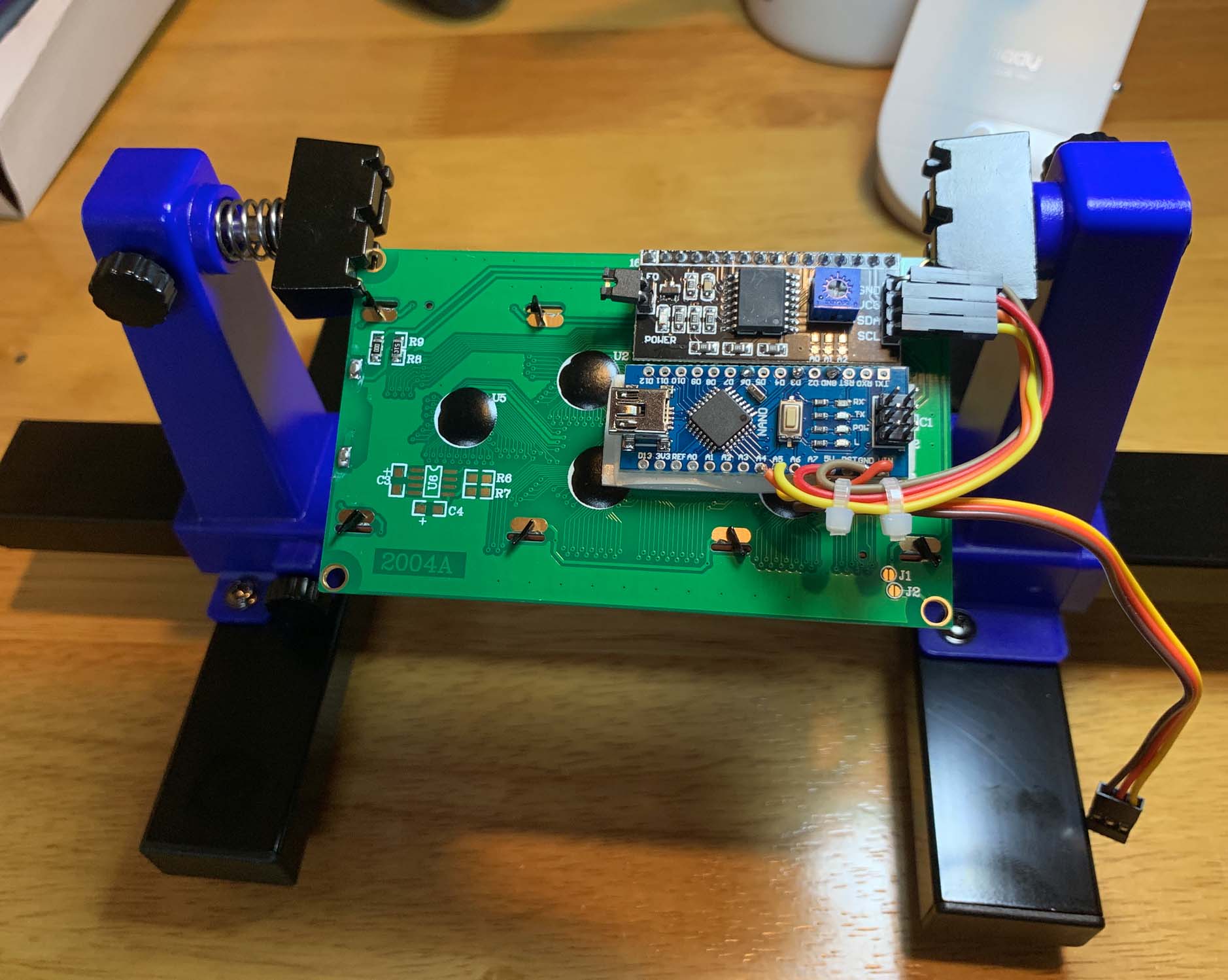

Re: PPM & PWM Tester/Analyser

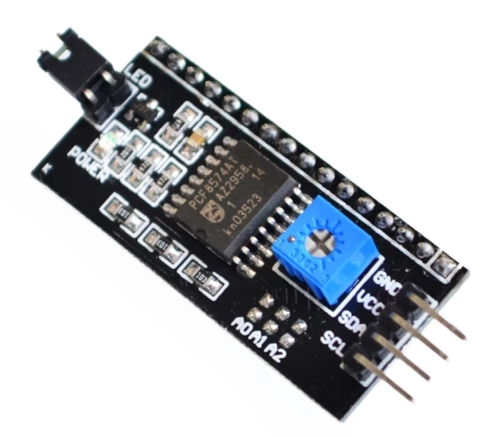

I’ve just built this tester using an i2c 20x4 lcd display. It’s identical to a normal 20x4 display apart from it only uses 4 wires instead of the usual 16, plus the contrast pot is built in. Makes this project much easier to wire up. You can also turn the backlight on or off in the software. May be of some use that feature, possibly as a battery saving system.
Here is a photo of the display working. Not very neat as it was just a quick wire up job to test. Obviously this can be neatened right up.
I had to change the lcd library in the sketch for an i2c version.

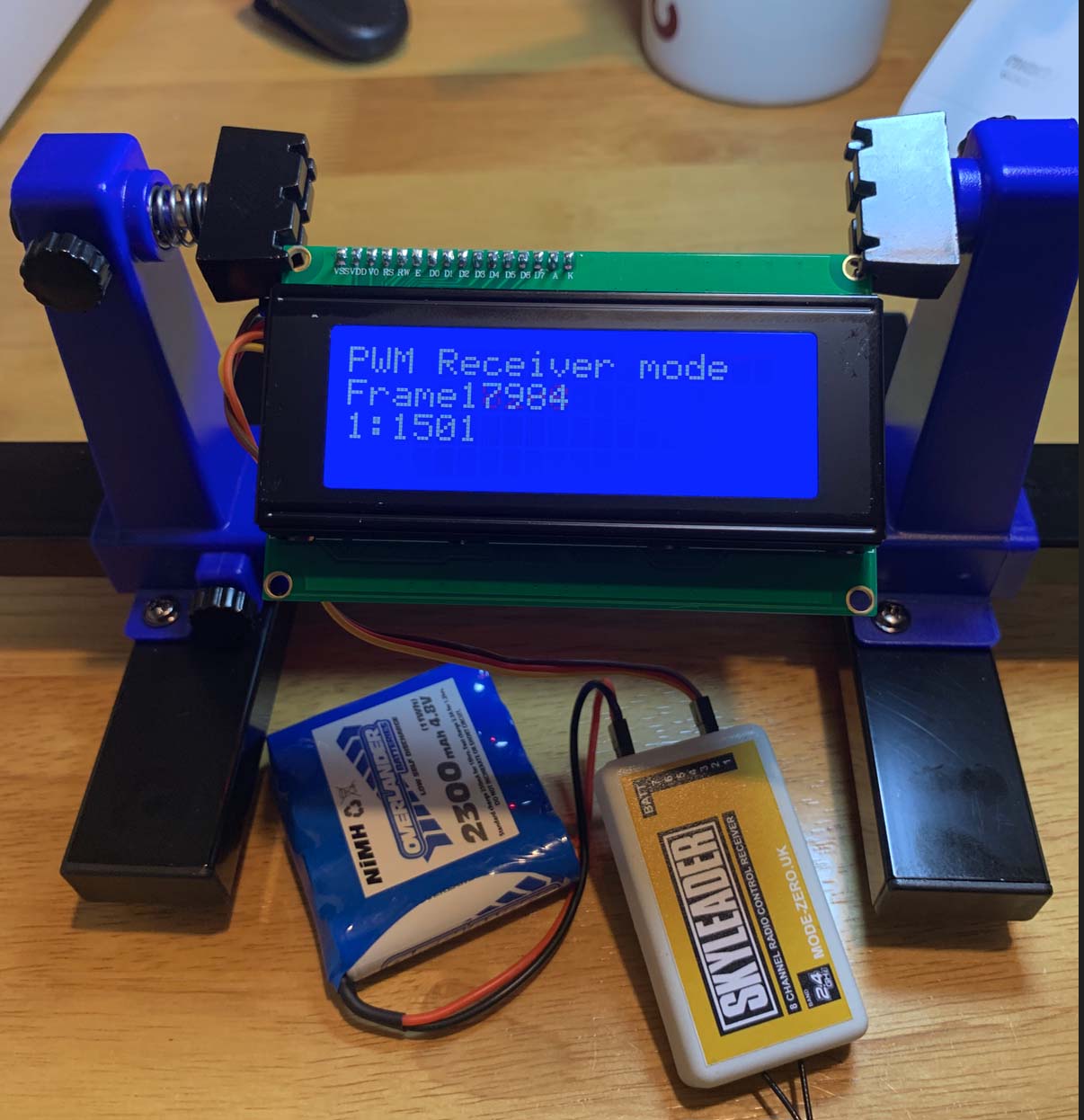

Neatened up the i2c ppm tester, looks a bit better.
Just ordered a new case for it from RS. its 125mmx85mmx25mm Part number PF13-3-9D. Ive used these cases before and they are superb quality, they have slip in end cheeks.bargain at £6.69. They come in all sorts of sizes too.
Its in dark grey and should compliment the blue led display.
I never bother using the servo outputs so they have been omitted.
Mine is self powered so it runs from the encoder or RX battery.
Great little project, and very useful, Thanks Phil :D

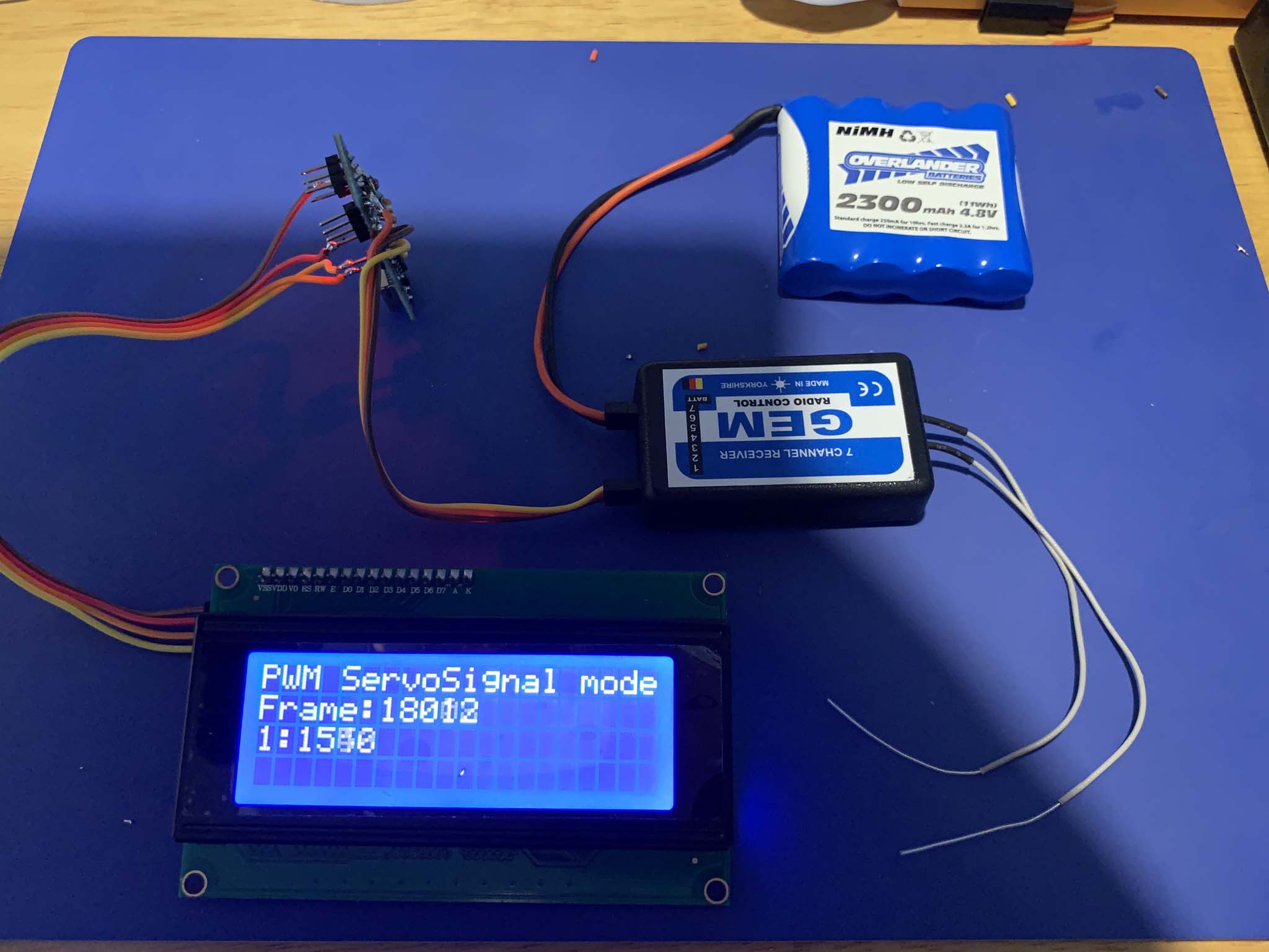

I've done an update for the sketch to use I2c and also multi-screen & servo-output in case of >6 channels.
In case its useful, I have put the sketch here and related documentation here.
