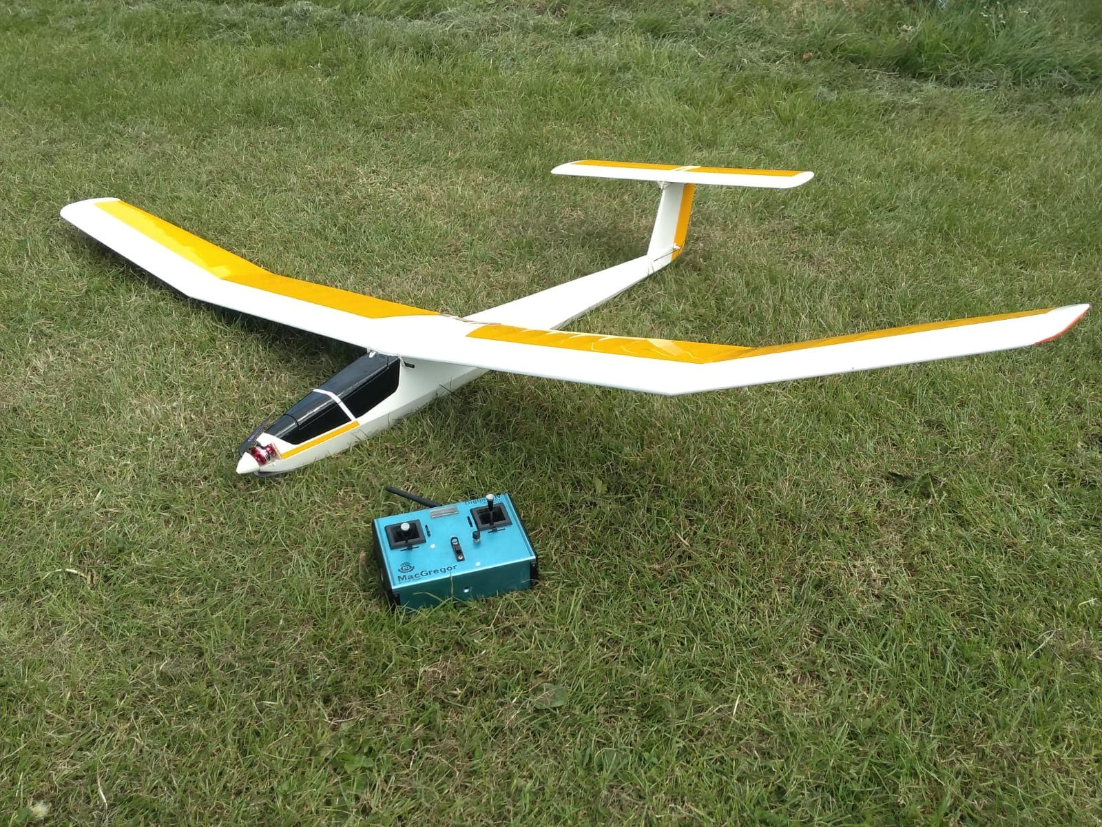

As some time ago our club lost its nice big fields my Li'l T had languished in my model storage area (garage roof) until Lockdown happened. My club has a modest field though not big enough for hi-start or winches although very good for e-soarers.
A quick dust off showed that the Li'l T had suffered only small amounts of hangar rash so a plan was hatched to convert said model into an e-soarer.
The big bits box was thoroughly rummaged through and the following components located;
E-Max 2805 motor
Graupner 6 x 3 folding prop with yoke and spinner
30 Amp speed controller
2 cell 1300 LiPo battery.
The above set up yields a mighty 80 Watts with a freshly charged pack. I have used this set up several times before converting old Speed 400 models with success.
One evenings fiddling with a guess at the down-thrust required along with about 2 degrees right thrust for the new motor mount and the job was done.
The maiden today went brilliantly, CG , incidence and rudder throw were left as original. Reasonable climb performance, perfect for with single channel with decent rudder response both in the glide and under power. Just need to find the programming card for the speed controller so I can set the prop brake.
Just wished I had done this years ago as I really like my Li'l T or rather my Li'l Te ! :D
