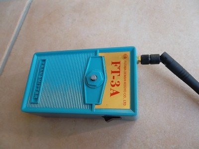

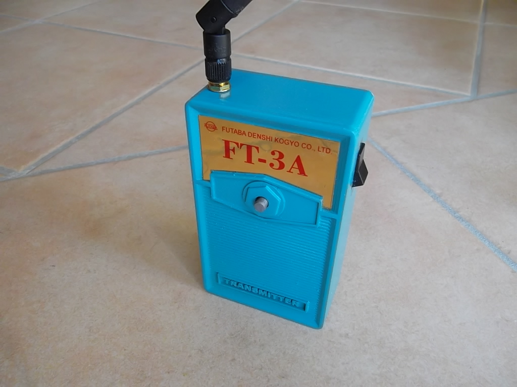

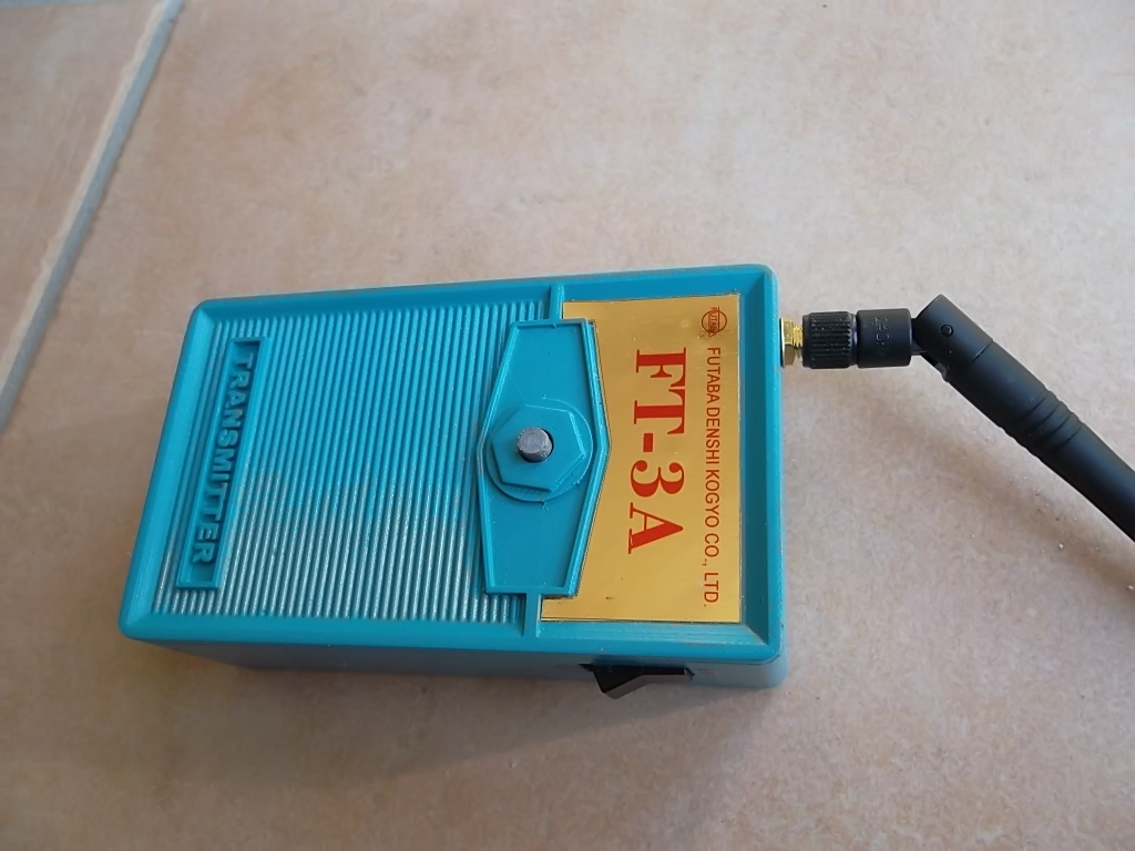

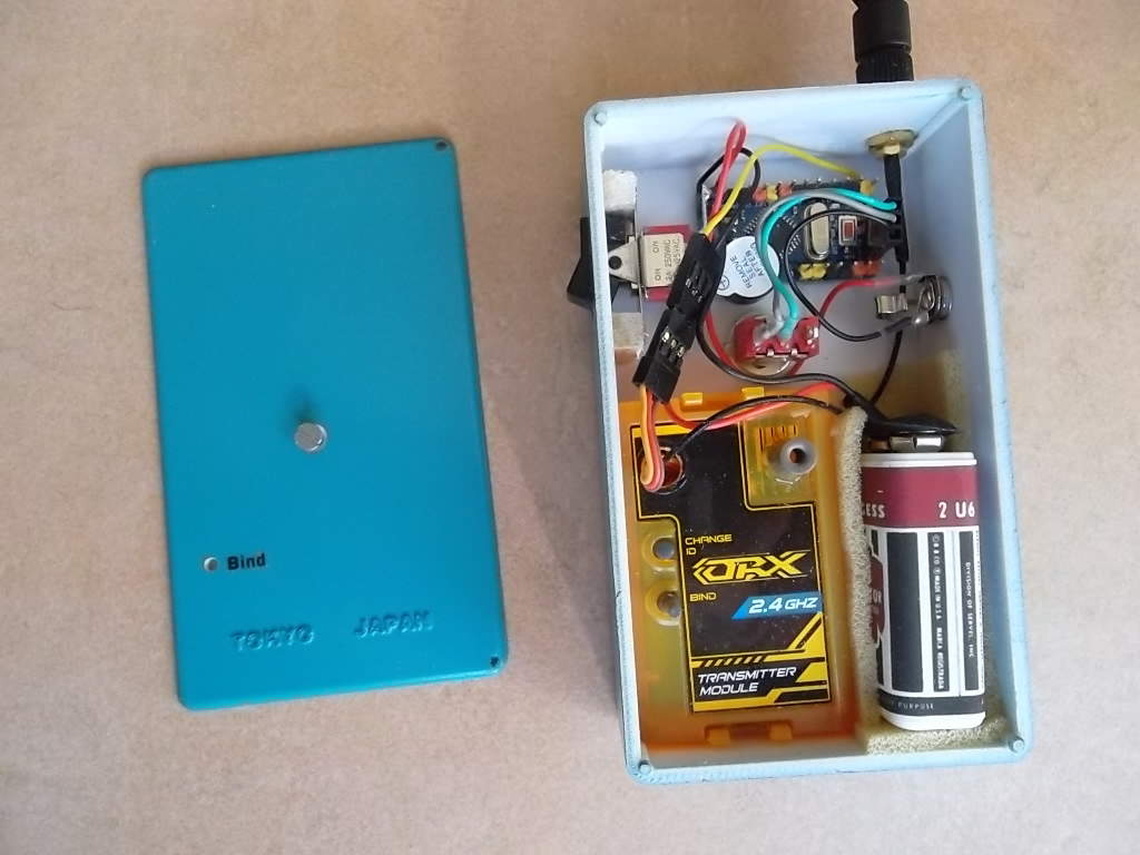

I just finished my next replica transmitter, a Futaba FT-3A. It uses Mikes S/C encoder. I am using also the low voltage alarm by just adding two 10k SMD resistors to the bottom of the arduino.
It works very well, no problems at all. HF is provided by an Orange 2.4G module. Power comes from a PP3 2cell lipo.
The FT-3A case is 3D-printed and looks quite realistic.
Thank you Mike for another great project. Frank

The FT-3A is so realistic that if you hadn't uploaded the OpenSCAD files I would have thought it was an original, great job again.
And I'm pleased you have got the encoder working OK. Are there any alterations or additions you could suggest? I designed it for my own use and have probably included features nobody else wants but left out things people would like!
