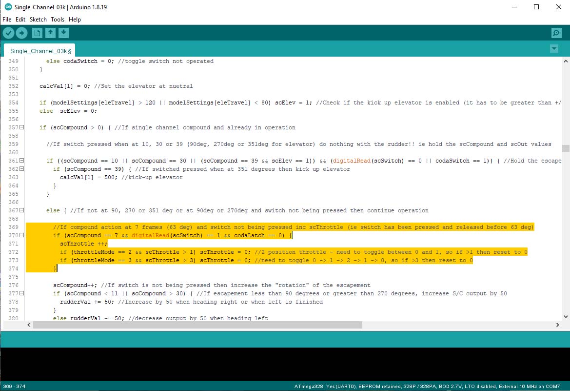

The "quick-blip" throttle control is on line #370:
if (scCompound == 7 && digitalRead(scSwitch) == 1 && codaLatch == 0) {
change the scCompound == 7 to a lower value - eg if (scCompound == 5 && digitalRead(scSwitch) == 1 && codaLatch == 0) {
The "quick-blip" is set a bit later than on a real Elmic escapement, the program splits the rotation into "40 segments", so each segment = 360deg/40 = 9deg per segment and 7*9 = 63deg rotation, the real Elmic has it nearer 45deg if I remember correctly. It was set longer as I had trouble operating the throttle, my thumb just couldn't blip quick enough to change the motor speed.
Also the emulation is slightly slower than Phil_G S/C emulator, this encoder has 40*20mS = 800mS or 0.8secs for a "rotation", I think Phil's is 32*20mS = 640mS or 0.64secs. Doesn't sound like much of a time difference, but I know some struggle to adapt between the two. I think Phil must have timed a fully wound escapement, me an escapement that had wound down a bit!

Hi Mike
Thanks again. I did some experimenting using values of 4, 5 & 6. 5 works perfectely for my thumb! Was flying the Mlls 75 Simplex again yesterday and had the guys asking what all the beeping was all about. I'll be silent now!

Thats great Mike. I'm more than happy to do any testing you need. I did have a go at changing the values in line 361 to 8,24 31 & 32 but it had little effect. With my limited knowledge of coding, I figured more was required but not sure where to go next.
John
