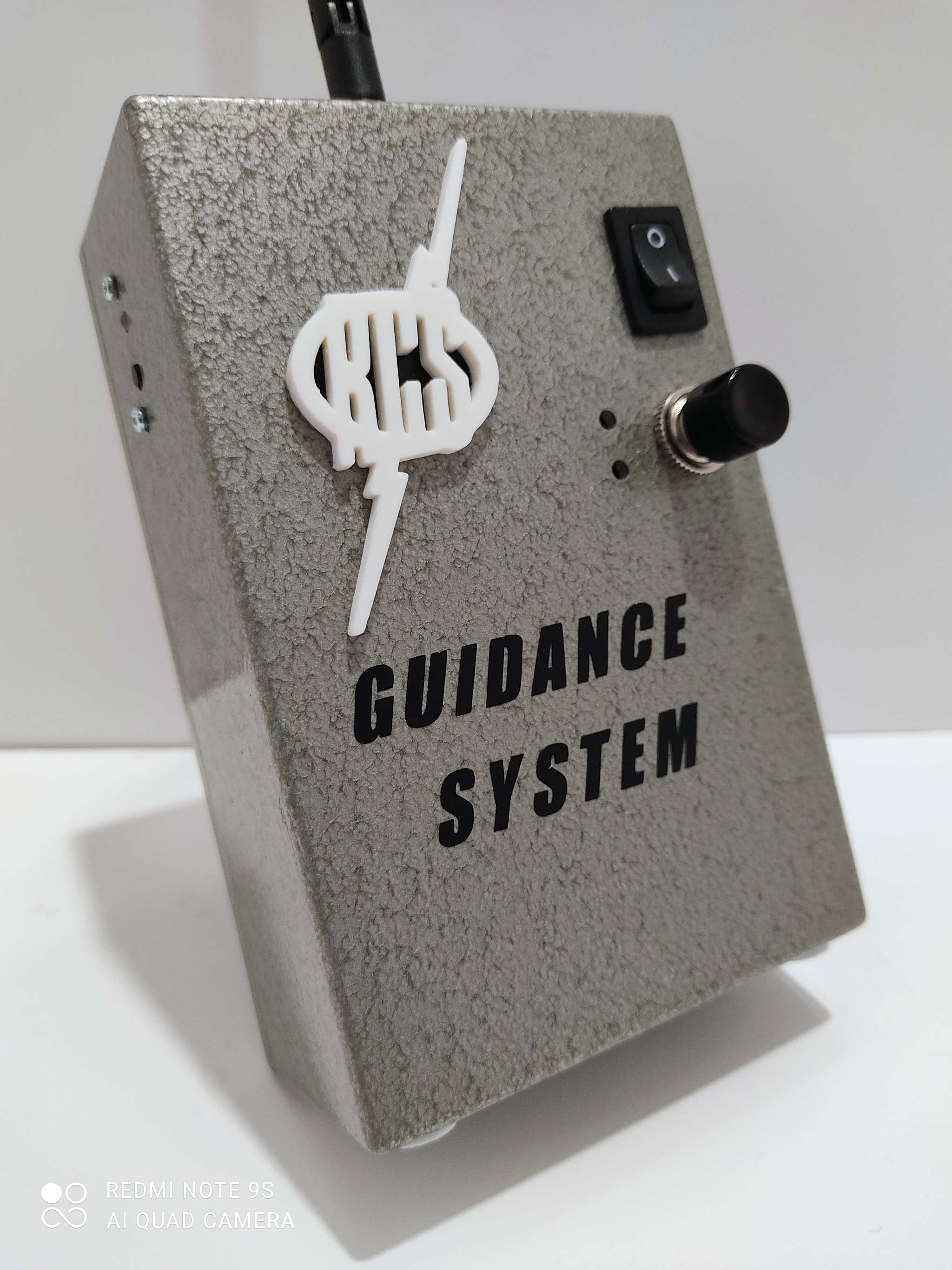

1. RCS Guidance System Transmitter “look-alike”.

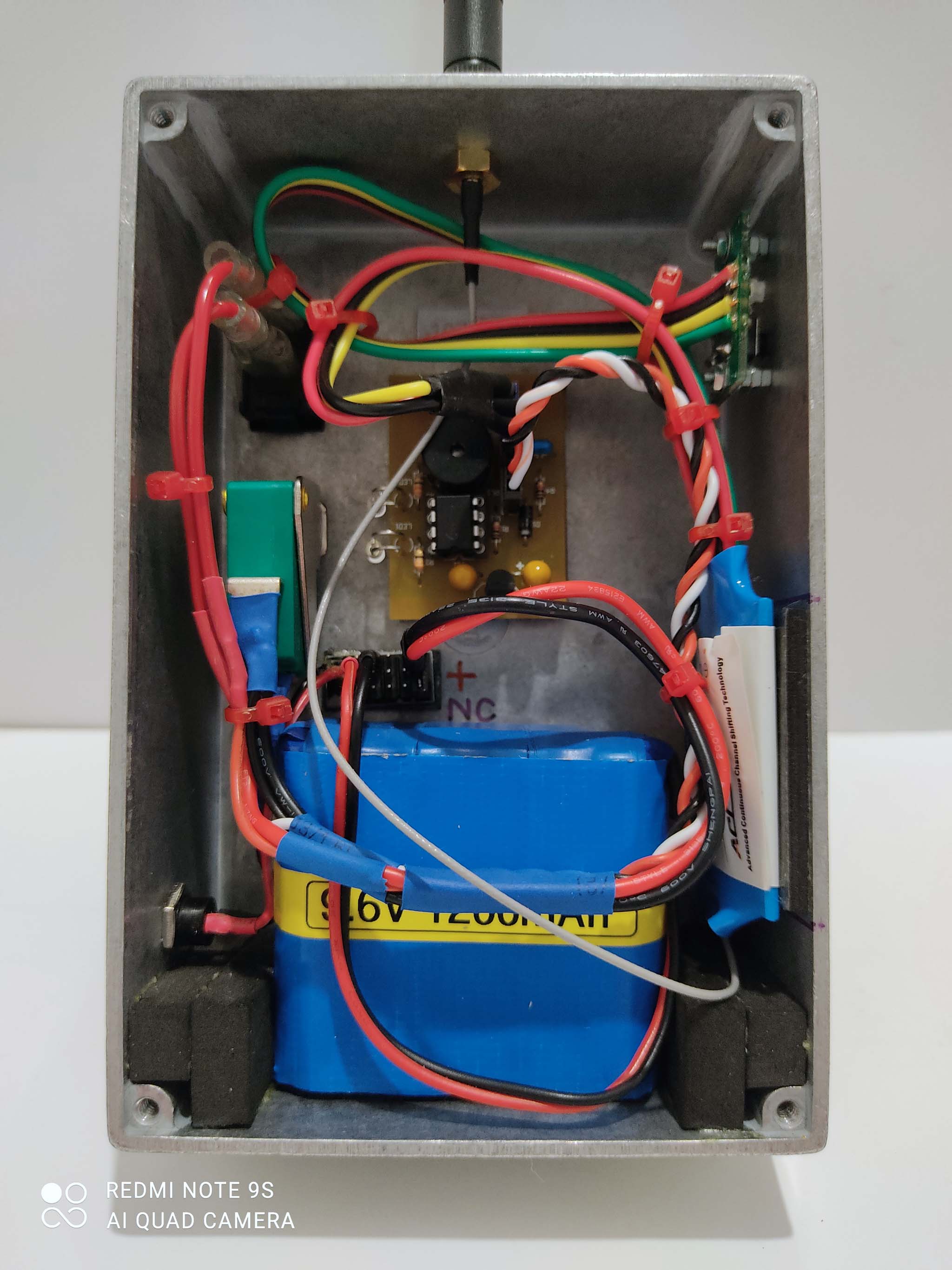

The electronics consist of a PPM Encoder Board and Microswitch Pushbutton / Wiring Harness all kindly supplied by Phil Green, a FrSky V8HT 2.4GHz RF Module and Antenna which I sourced from Ebay, and a 9.6V 1200mAH AA NiMh Battery Pack, plus On-Off switch and Charging Socket. The PPM Encoder Board is mounted so that the Configuration / Tell-Tale LEDs are right next to the Microswitch (as recommended by Phil), and the FrSky Bind Board is mounted in the upper left hand side of the case, with the Bind Switch and LED accessible from outside.
The case is a commercial die-cast aluminium Hammond 1590J enclosure approx. 5 ½” x 3 ½” x 1 ½” (which is quite close in size to the original pressed steel case) which I sprayed with Grey Hammer Finish paint.
The RCS Badge was created originally in 2D (*.SVG format) using Microsoft Excel Insert Shapes, and working from whatever old pictures I could find, then converted online into 3D (*.STL format) using Selva3D, and finally printed on my “toy” Da Vinci Mini 3D Printer, followed by a little sanding here and there. I know it’s not 100% true to the original badge, but looks OK from a distance !
The “Guidance System” lettering is 10mm high Impact Italic Bold font, produced using black self adhesive vinyl on my Cricut Joy vinyl cutter/printer.
Receiver used is a FrSky V8FR-II, and everything works as it should, thanks to Phil’s Encoder. 1 press for Right Rudder, 2 for Left, 3 for Up Elevator, and Quick-Blip to toggle Throttle.

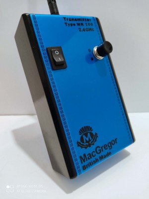

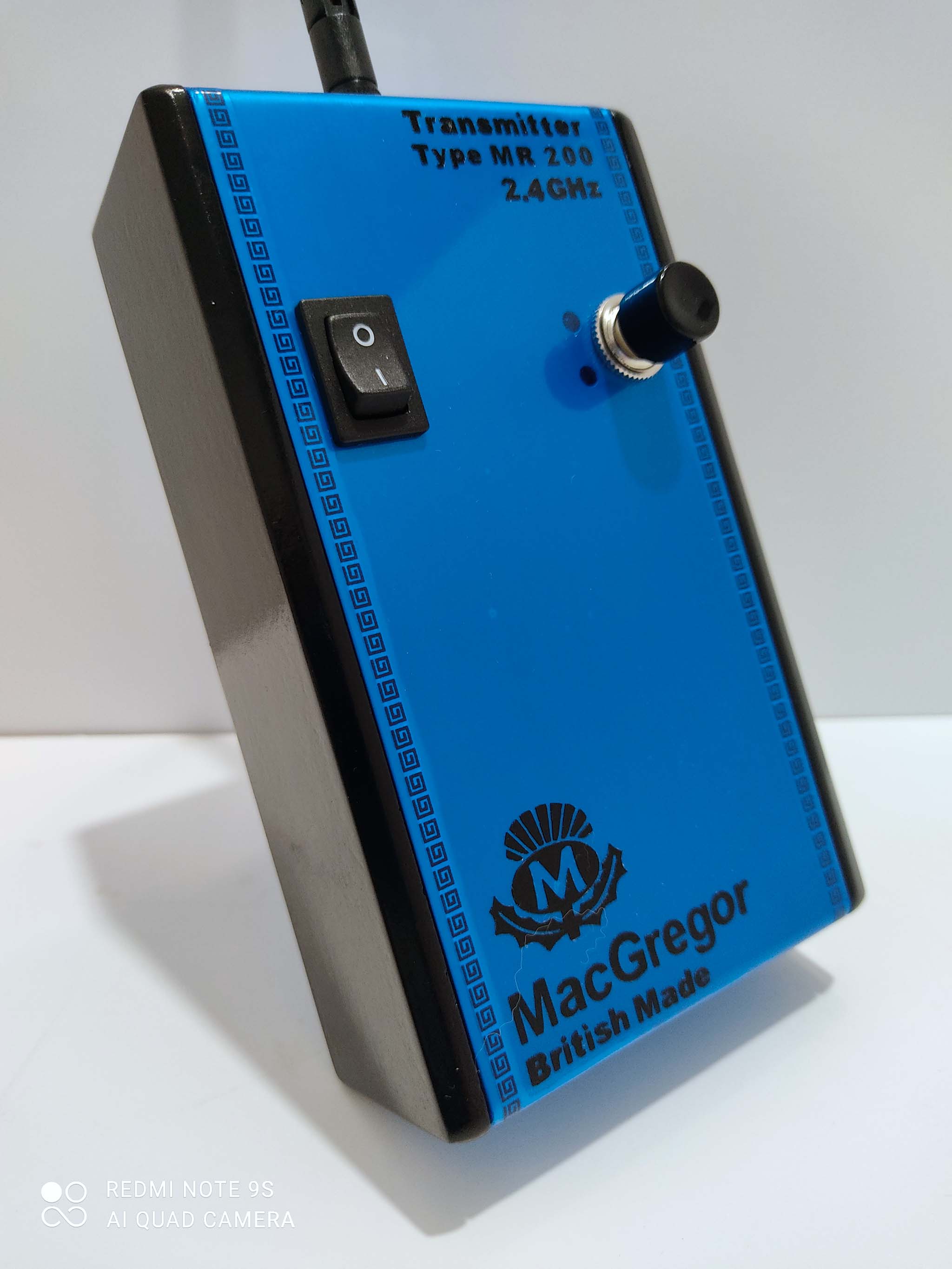

2. MacGregor MR 200 Transmitter “look-alike”.

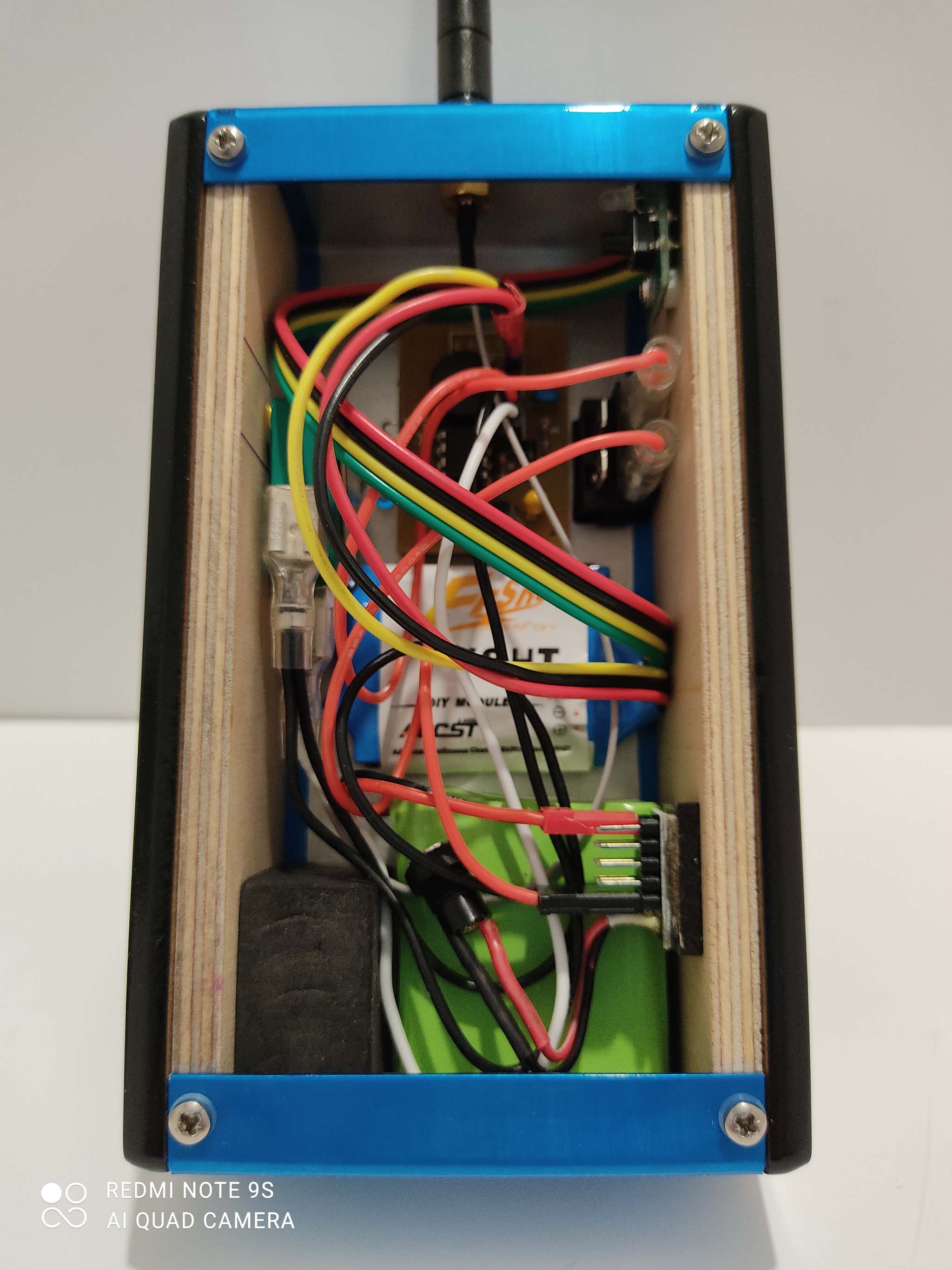

As with the RCS transmitter above, the electronics consist of a PPM Encoder Board and Microswitch Pushbutton / Wiring Harness all kindly supplied by Phil Green, a FrSky V8HT 2.4GHz RF Module which I sourced from Facebook Marketplace, a 2.4GHz Antenna from T9HobbySport, and a 9.6V 600mAH AAA NiMh Battery Pack, plus On-Off switch and internal Charging Socket. The PPM Encoder Board is mounted so that the Configuration / Tell-Tale LEDs are right next to the Microswitch (as recommended by Phil), and the FrSky Bind Board is mounted facing inwards inside the upper left hand side of the case, so you have to remove the back of the case to bind to a Receiver (or to charge the Battery Pack).
The basic case is home-made, and was folded from 1/16” aluminium sheet. After folding, the aluminium was covered in Light Blue Self Adhesive Window Film. The side cheeks are made from ¼” ply (internal cheeks) and ¼” MDF (external cheeks), and were sprayed first with grey primer, then black gloss, then clear lacquer The finished case measures approx. 6” x 3 ½” x 1 ¾” (which is quite close in size to the original).
The lines of “square spirals” running up and down the sides of the case were created with Inkscape, printed on white paper, cut into 8” long strips, and glued to the aluminium with Pritt Stick, before the Light Blue Vinyl covering was applied over the top (with great care !).
The “MacGregor” and associated lettering is Arial Bold font of different sizes. The “MacGregor Thistle” logo was downloaded after searching for MacGregor Industries images online, then scaled to size. All stick-ons were then produced using black self adhesive vinyl on my Cricut Joy vinyl cutter/printer.
Again, Receiver used is a FrSky V8FR-II, and everything works as it should, thanks to Phil’s Encoder. 1 press for Right Rudder, 2 for Left, 3 for Up Elevator, and Quick-Blip to toggle Throttle.
