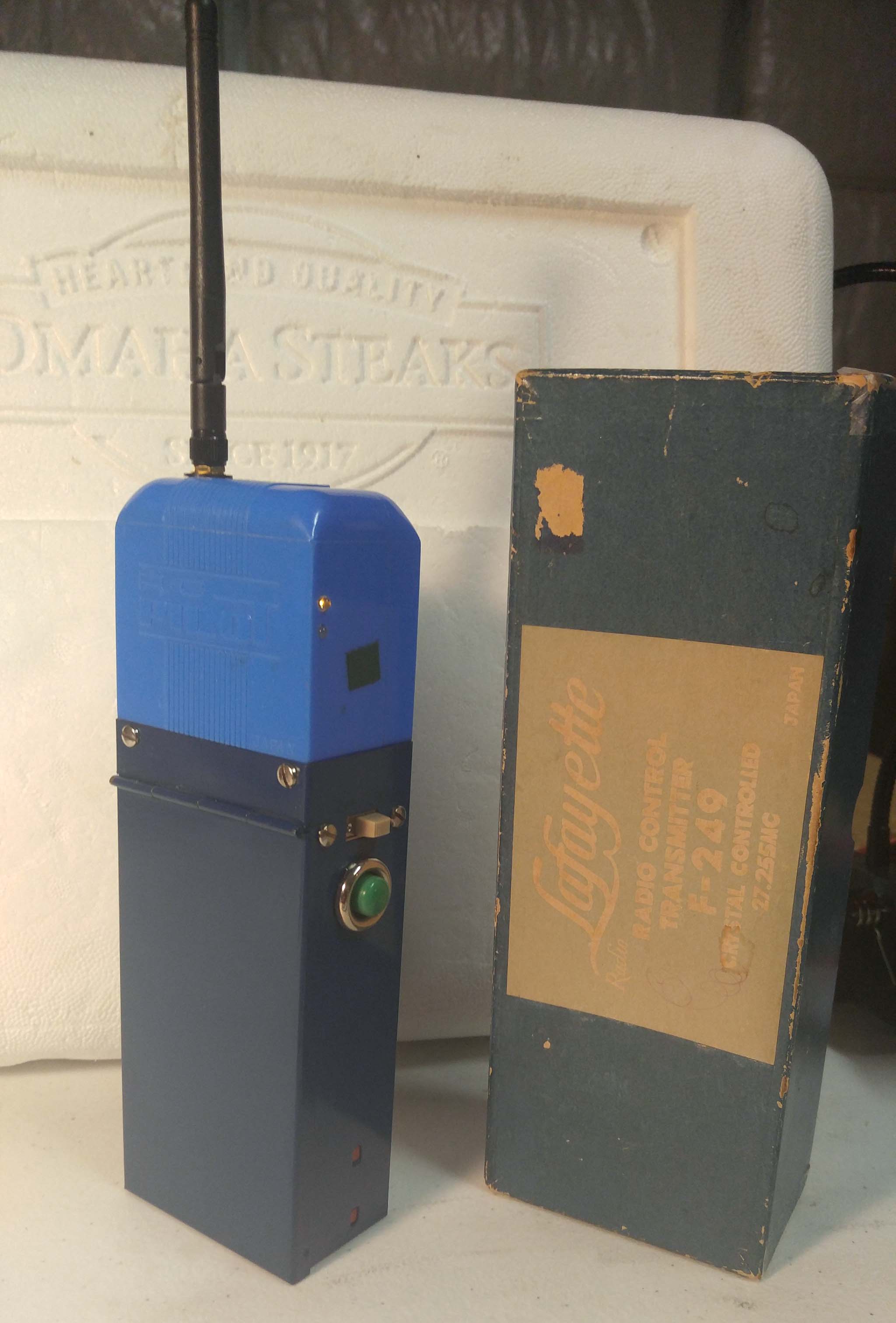

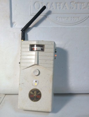

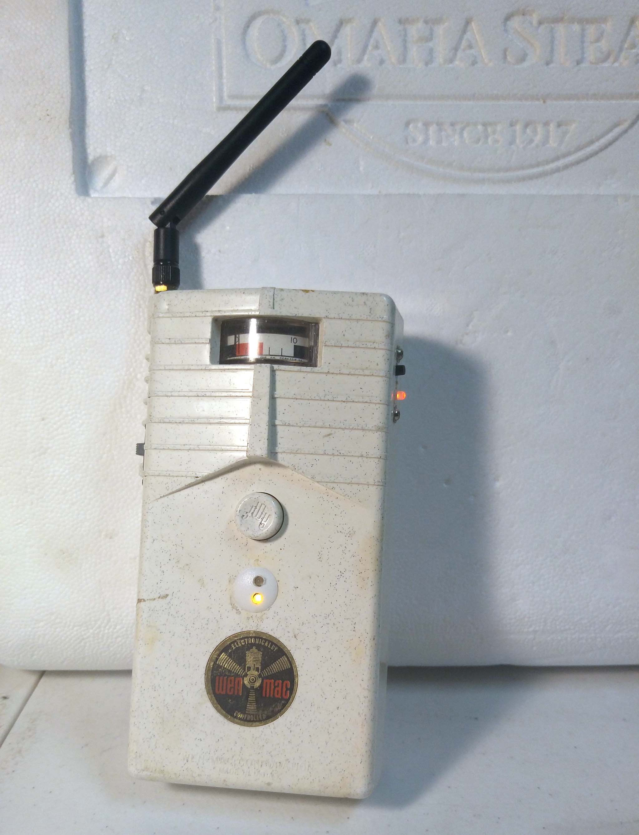

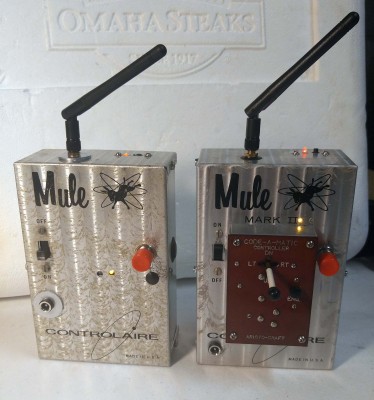

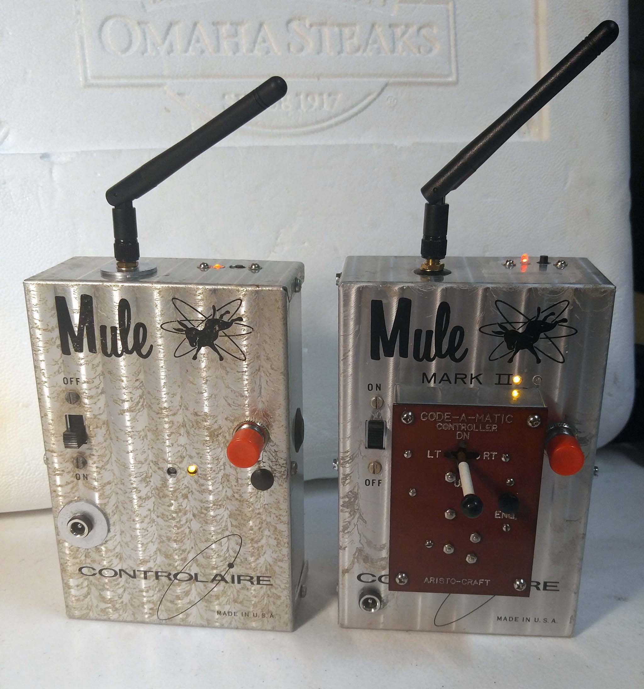

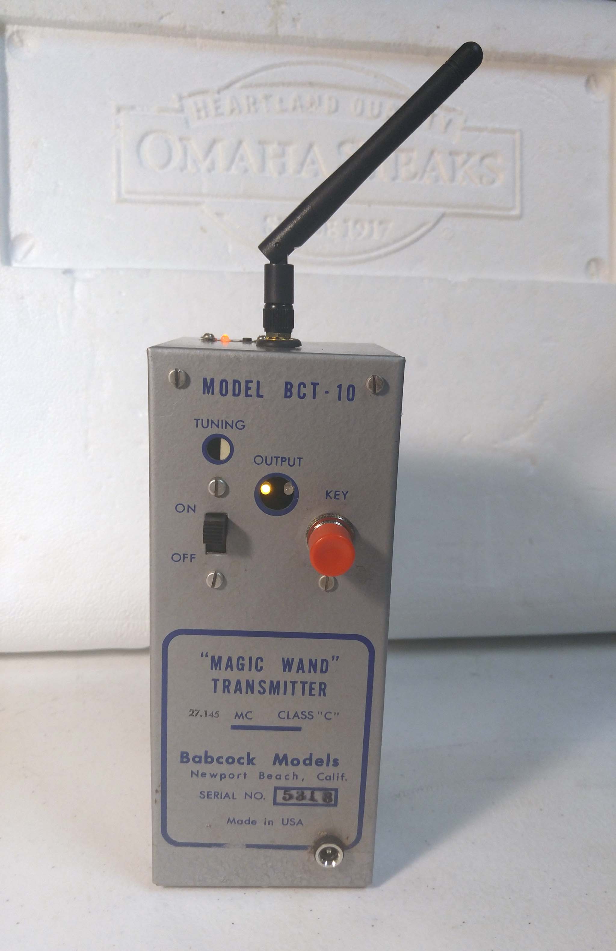

Hey all. After finding copies of the November and December issues of RCM&E I caught the bug for converting there old "button babies" to 2.4GHz , with using modern encoder boards and using servos instead of escapements. These were alot of fun to convert and very satifyed with the results. Thanks for taking a look!

Re: Single Channel Replica Transmitters
Hey Phil. These were taken by my old but reliable LG V10 Android phone. I'm better at building boxes then photo documenting them. Guess this means that I need to convert more transmitters so that I can improve my photo documenting Skills!

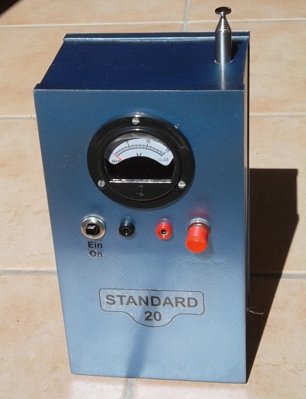

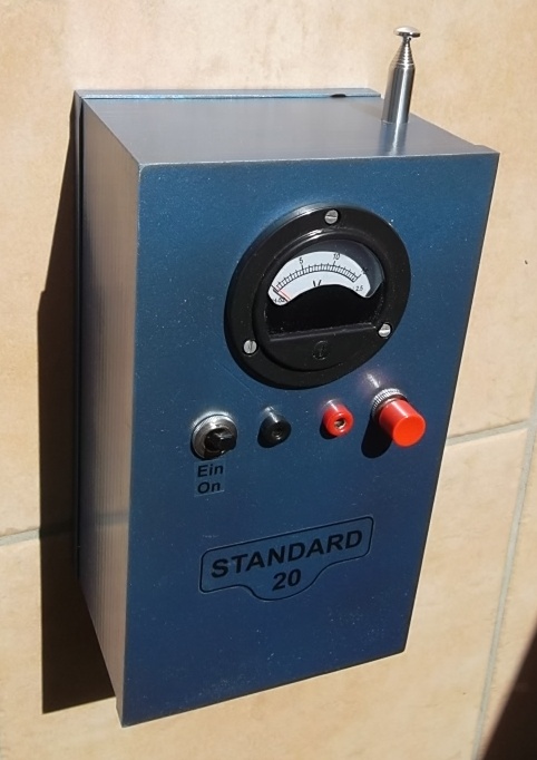

My next S/C replica transmitter is ready.
It´s a Graupner Standard 20 in blue color. They were avalable in black and blue as far as I know.
The meter is an expanded scale voltage meter. It features full S/C emulation with inactivity buzzer and low voltage alert.
The motor led will be fitted later.
The case is 3D-printed in the size of the actual transmitter. Cheers
Edit:
Flighttest passed, no problems.
Edit:

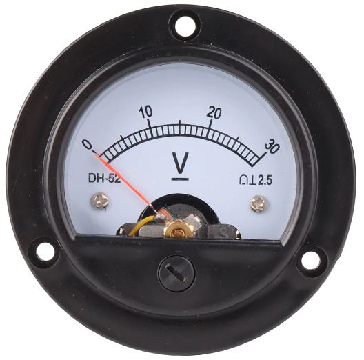

Where did the meter come from, that’s a great vintage looking meter.
- Posts: 393
Thanks Wayne and Ron,
the meter is not vintage at all, it just looks like.
Vintage meters cost a million, so I used this one:
It is available in various voltage ratings
https://de.aliexpress.com/item/40003693 ... hweb201603_ and I used a carefully cut piece of black self adhesive vinyl to cover part of the glas.
The meter is modified to an expanded scale voltmeter using a 6.1V zener diode and a 20k variable resistor.
That makes a very vintage looking meter fo little money.
