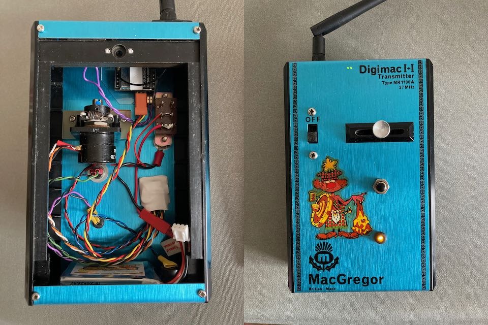

My first R/C set was a Digimac 1+1 back in 1974, duly retrieved from its slumber and armed with Phil_G's encoder and a LemonRx Tx module for my Spektrum Rx's I set to work.
Digimac 1+1
Digimac 1+1
Tx Mount 3D print
Tx Mount 3D print
Two little holes in top at front are for the Tx module LED's, I found a genuine 1970's spring-loaded 'slide to make' switch to match the on/off for bind which is on the top. Another club member kindly 3D printed a mounting for the Tx module.

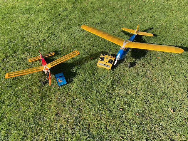

Not having a suitable 'plane, I built a 'Poppet' and had to wait a while before a beautiful calm day dawned in October.
‘Poppet’ using Digimac 1+1 and ‘Hepcat’ using Skyleader with S/C emulation.
Poppet flies very well, can't believe I learnt to fly with the 1+1 in a KK Outlaw. The Hepcat I built a few years back and tried to fly it proportional, I scaled back the initial motor fitted and increased the rudder slightly so it's passably controllable for ROG. Then I was 'gifted' a Skyleader set by a member doing a final workshop clearance. Filled with confidence, armed with a USBASP programmer and a DIYMore board I downloaded Phil_G's 7Ch encoder and set to work. Using the pre-punched holes for some of the knobs and switches perhaps wasn't the best choice, but the Skyleader is now converted and fitted with the S/C controls. Bound to the Hepcat the 'compound' S/C - with suitable rates to manage the enlarged rudder - now commands her in flight as intended...
