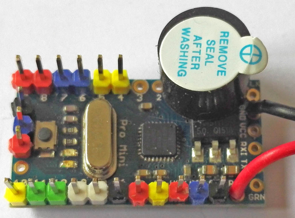

Hi All
I've been working on a single channel encoder based on an Arduino Pro Mini for the past two years, indeed it was completed over a year ago and I've been flying it since then, but it has taken me longer to write a manual for it than it took me to write the code.
The encoder has worked out quite well, but not the manual, it seems 18 pages of gibberish (and I wrote it). I've decided I'm not a natural author and would never earn a living writing manuals. If anybody would care to improve the manual I'd be very grateful :)
I built a number of prototype encoder boards and have 6 that are spare and to the final specification, so if anybody would like one to try out, just PM me.

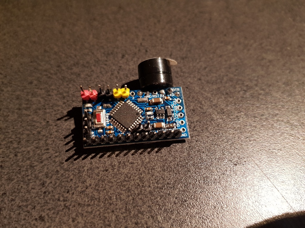

No probs Mike, it only took a few minutes to assemble but I didnt add the buzzer or any headers...
...and its just a vid from my phone so cheating really :D
Re the update, just go into edit as usual (the pencil symbol), click the attachments tab, delete the attachment, add the updated attachment, save.

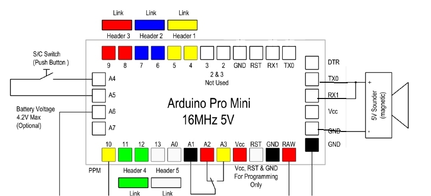

One suggested addition thats not in the doc - if you already have a 'push to ground' button arrangement, then use A5 and ignore A4.

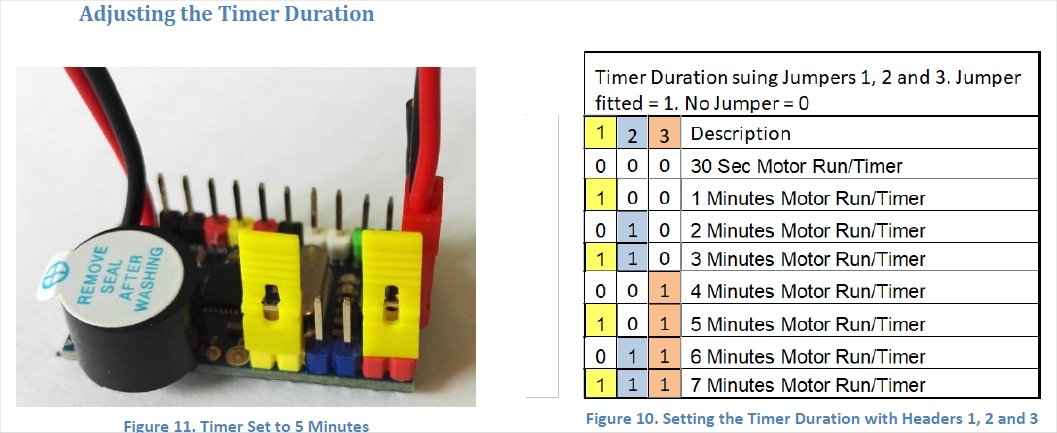

In the motor run table, just a suggestion, maybe swap the red & yellow columns so they match the photo alongside, Yellow-Blue-Red? I know you'd reverse the strict binary progression but that only matters to nerds like us, and then the table and pic would match up. Or take the photo from 'across' the ProMini?
Anyway I added the buzzer and the headers - black is the new green :D
The buzzer could alternatively go on the end if its more convenient, could even 'plug-in' if you have an FTDI header:
