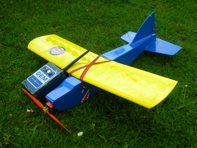

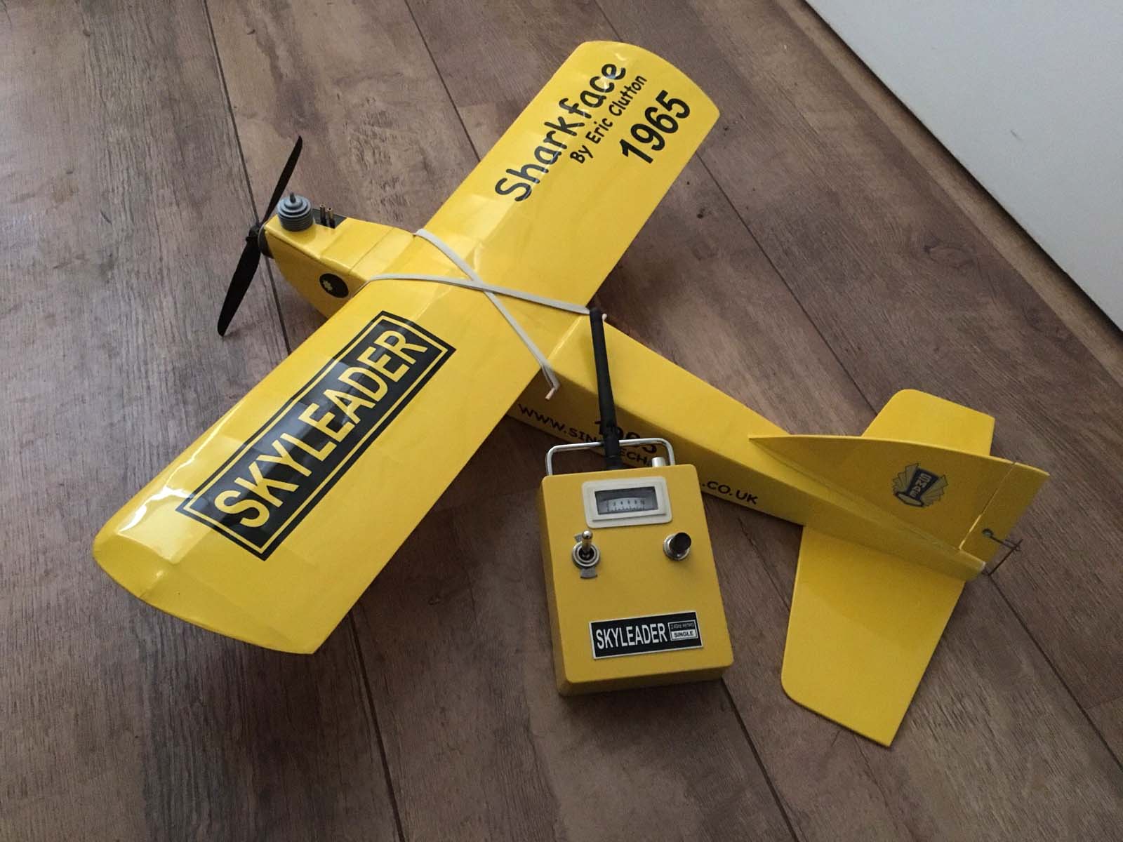

Whilst many S/C models are slow, stable designs based on free-flight principles, many are far from that - fast, aerobatic, highly responsive and a real adrenalin rush! The 'Sharkface' by Eric Clutton is such a model, originally for an .049 Babe Bee glow, at one stage the designer fitted a 1.5cc diesel for a really hair-raising performance! Today, electric motors are so convenient and quiet that they are often chosen over internal combustion engines, and their power delivery can equal or exceed their glow equivalents:

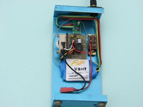

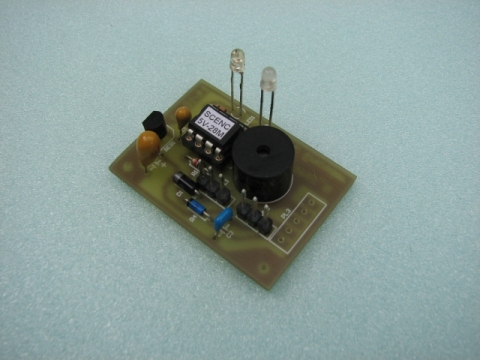

A 2.4g Single-Channel set is based on a purpose built, custom encoder which when coupled to a 2.4g RF
module, a battery and a button, becomes a 'new age' Single Channel set. There are a few alternatives for the encoder itself, mine is generally available ready-built & tested to anyone interested in building a S/C 2.4g tx - see the projects page of www.singlechannel.co.uk and email Phil for details - whilst Martins is a DIY Arduino project. Others have home-brewed their own, remember Dave Kay's 'Oxo tin' tranny at Ponty?
These sets accurately imitate a typical 1960s radio control set, with a few optional bells & whistles. The encoder makes it a simple job to convert any old S/C transmitter to 2.4ghz, and there are several photos of converted sets on the '2.4g Conversions' page.

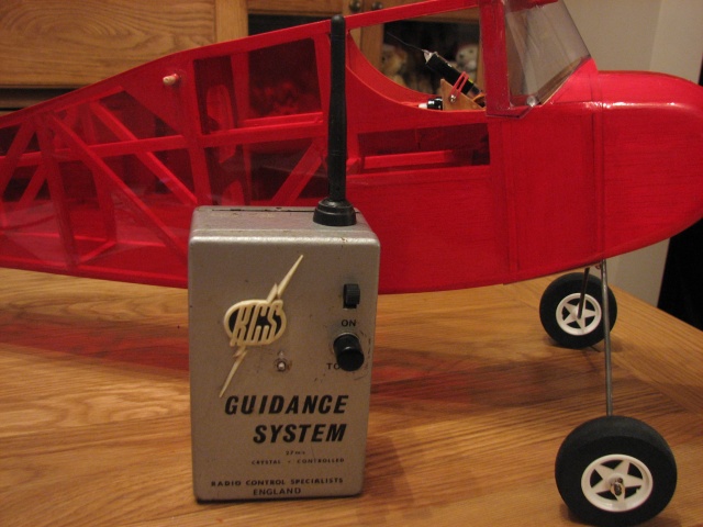

My own prototype was a veroboard-and-maplin-box semi-immitation of an RCS Guidance System and first flew back in 2009. Since then the design has been in constant development and refinement on a commercially produced PCB and over 1000 have been supplied to date, to S/C enthusiasts all over the world.

Its all built on a neat PCB which has connectors for either a DIY hack module or direct insertion into a Futaba compatible module. The PIC firmware is written entirely in assembler and we've been using Frsky DIY, Corona 2.4g DIY and several 'Futaba style' cased modules including Spektrum, OrangeRx and Hitec. In fact the 'Futaba style' module is the preferred method now, as it does not involve any soldering to the module. The encoder can be configured to drive a simulator too, for button bashing practise!

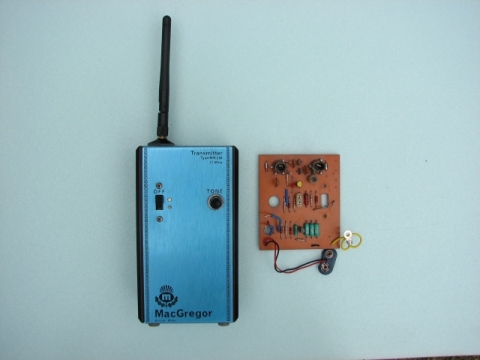

Here is a sequence of photos showing a typical conversion, this example being a Macgregor MR200:

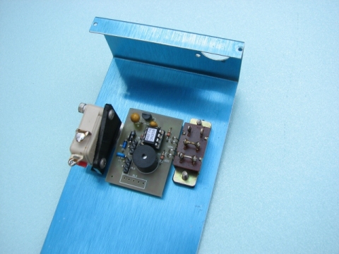

First, the donor transmitter is carefully disassembled, and the 27mhz board saved in case you might want to reverse the process. The button and switch need to be desoldered from the PCB and remounted into the case.

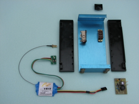

Here, all the parts of the MR200 conversion are laid out - the side cheeks, aerial mount, front panel with its microswitch button and on-off switch, the emulation encoder and the DIY RF module with its bind board attached:
Heres the emulation encoder itself. The LEDs should be made visible, so in this case they are bent around to mount through the front panel:
There are three connectors to the encoder, of which two are used. PL1 takes a standard 3-way servo plug and connects the battery and 'tone' button.
Either PL2 OR PL3 connects the encoder to the RF module. Pl2 is used for DIY ir 'Hack' modules, and PL3 is used to mount the encoder 'piggy-back' style directly onto a Futaba-style RF module. The 'Futaba' method is quite neat as it avoids the wiring between the encoder and module.
The encoder is mounted between the on-off switch and the button, using gyro-tape, which is a very strong double-sided tape. Clean the surfaces first with rubbing alcohol to ensure good adhesion. Ensure that none of the solder-stubs are poking throught the tape and into the metal panel.

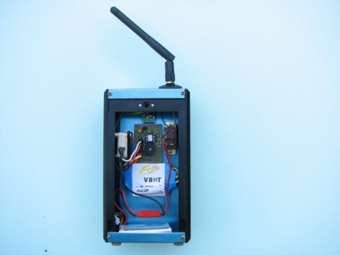

Next, using more gyro tape, we mount the RF module and its bind-board. The back cover of the MR200 is designed to be easily removed, so its no inconvenience to leave the bind button inside the case. We then wire the battery and button connections to a standard servo plug, which then connects to the encoder header PL1. The RF module connects to PL2. PL3 is unused in this example, its an alternative mount which piggy-backs onto a Futaba-style module, thereby avoiding some of the wiring up. The aerial SMA connector has to be slightly countersunk into the black Macgregor aerial mount:
The side-cheeks are refitted, taking care not to strip the PK screws in the soft plastic. A 2S 500mAh lipo sits at the base, connected via a JST:
And heres the completed conversion alongside the original 27mhz board. Result - all the fun of 1960's single-channel flying with none of the old reliability problems, several km range, no interference, no waiting your turn to fly, no running out of escapement turns... just perfect reliability!
