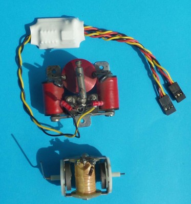

Picture shows the "Baby Twin" with recoder alongside a GG recoder:

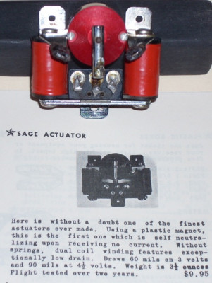

I also acquired a different type of mag actuator, it is well made with no markings and quite a hefty beast at 99 grams (compare to a Adams "Stomper" at 48 grams). I have tried it using the GG recoder ad it seems to work well. Does anyone know who it was made by?
Picture shows it beside an Adams "Stomper":
A lot of mag actuators have resisters or diodes across the coils, are these of any use when using a recoder or should they be removed?

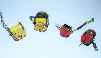

A selection of Adams... Still prefer Tobes with Phils electronics... they are far less trouble and very powerful.

"I also acquired a different type of mag actuator, it is well made with no markings and quite a hefty beast at 99 grams (compare to a Adams "Stomper" at 48 grams). I have tried it using the GG recoder ad it seems to work well. Does anyone know who it was made by?"
I finally found the make of the actuator - Sage:
