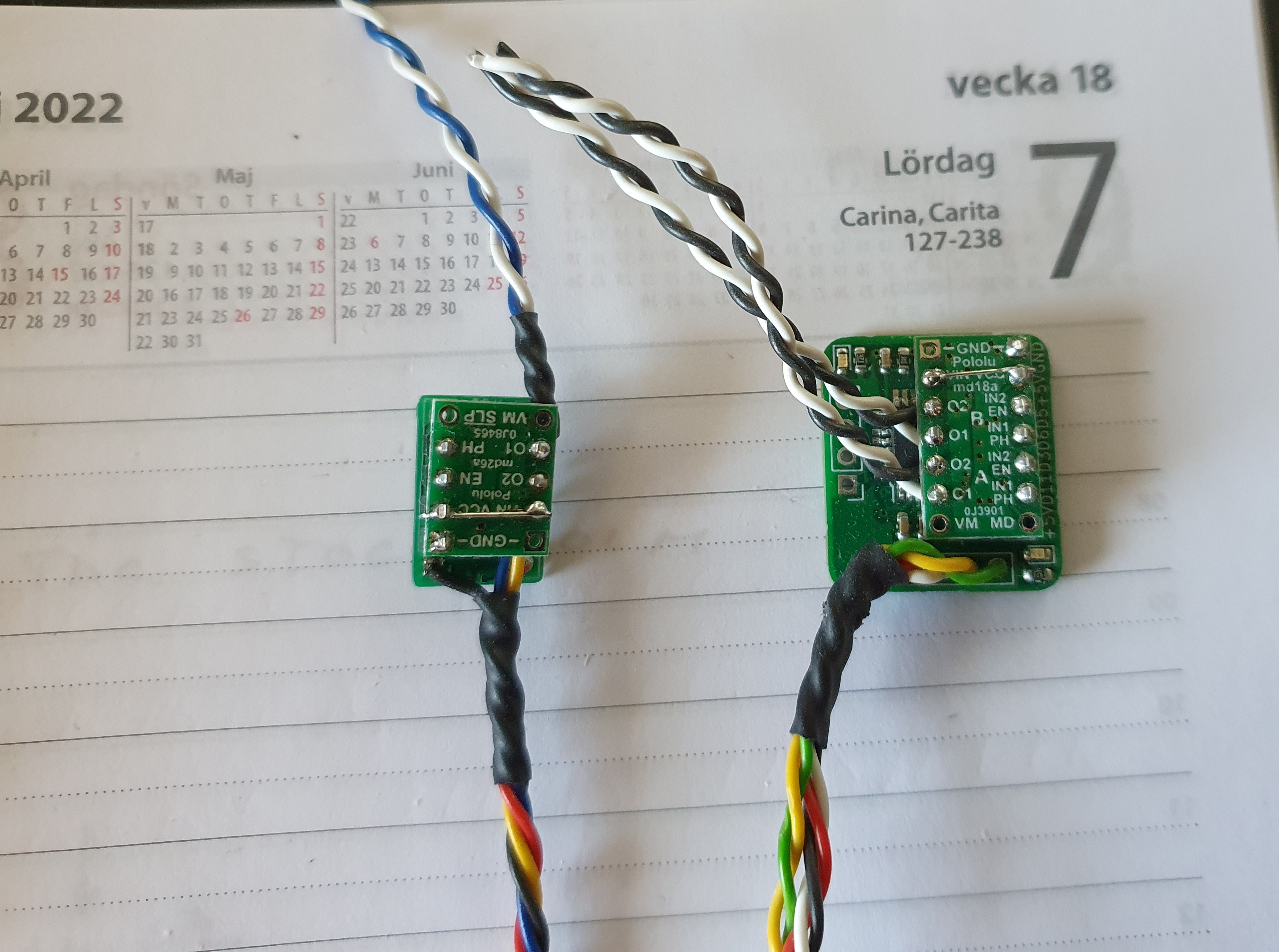

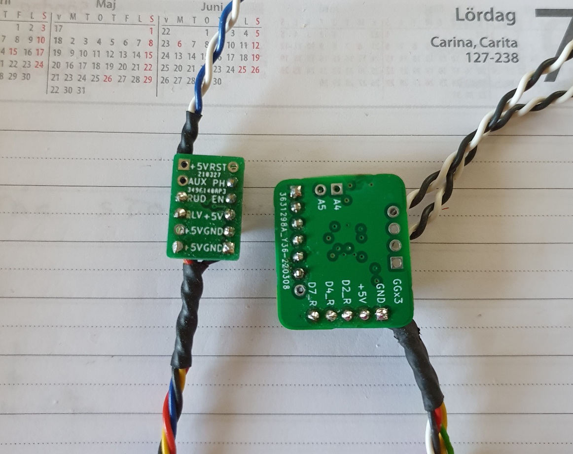

If some of you are in urgent need of a GG recoder like for a Ponte project, I have a few of my own available both in a more conventional version and one more "advance" that can run 2 HR1 ( high rate GG) with variable rates on an AUX channel.
PM me if you need any help.
If you are for a DIY see under Quickie-Ghost with a couple of options.
