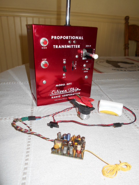

Has low and high rate switch, tone frequency adjustment, rate and width sensitivity adjustments. This one needed new Xtal, electrolytic caps, and battery for the Rx, a rebuilt switcher for the Rand LR-3 , new caps for the Tx and new battery, plus a full tune up and system alignment. Works great now. I'm glad they marked the joystick cutout with Up, Down, Right, and Left or else I would not be able to fly it :lol:

Very nice indeed ;)

That looks brand new! I am so pleased to see original radios restored to working condition using their authentic innards !
