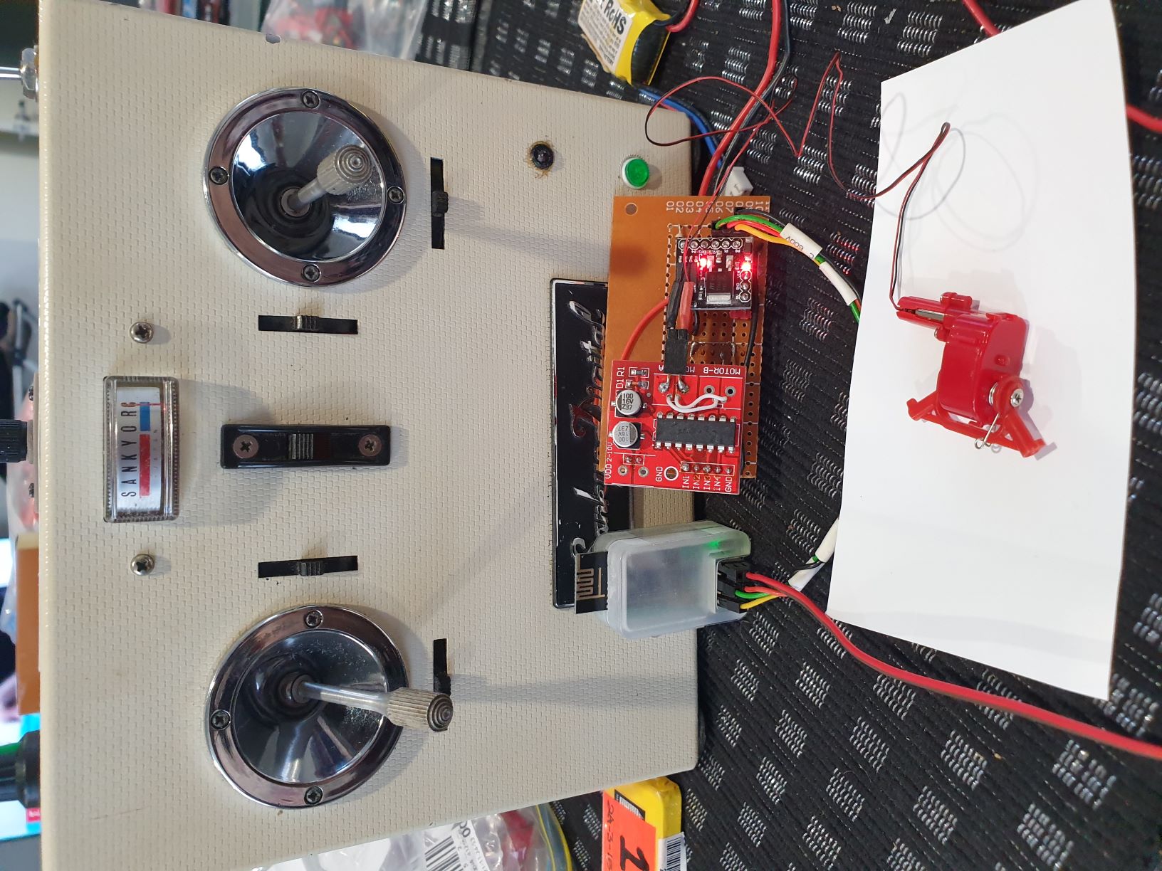

Recently while unpacking all those bits, I re-found the "new actuators" and thought why not?!? So I hooked up my GG driver test board (which uses Martin's code) to one of Tobe's rx's connected to my restored Sankyo Tx (both Tx & Rx use Phil's FHSS code - gotta love this forum!!), then tested it all with an assortment of actuators from my GG box --> Rand LR3, ACE Stomper & twin Stomper, home made Twitcherator, and 2 of my own home-brew actuators. Aileron & elevator decoder inputs were connected as per normal while the motor coasting input was plugged into the throttle channel to make adjustments quickly & easily.
my bench test setup.

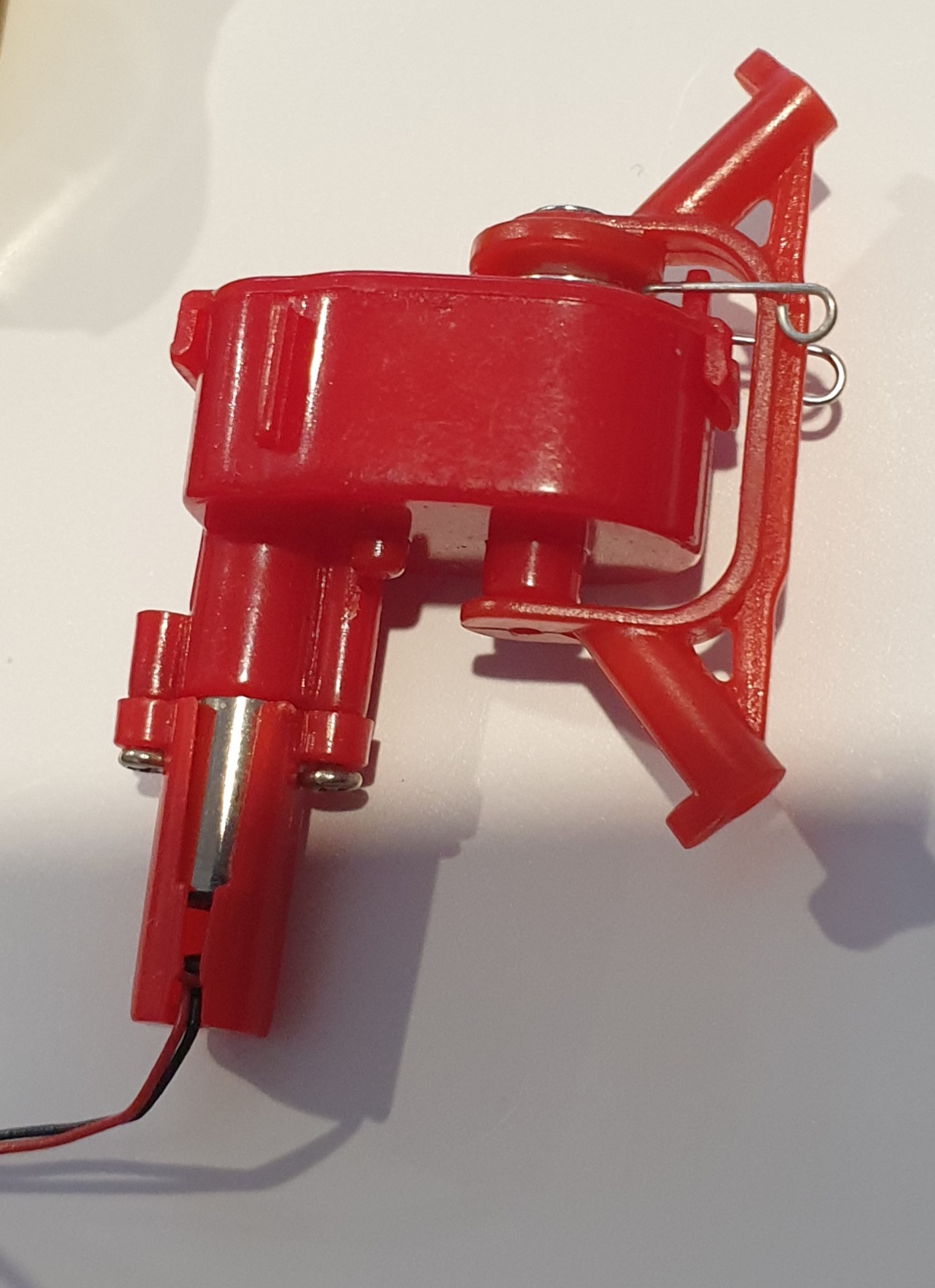

It was interesting to see the best motor coast setting - for this re-purposed actuator unit, 2 clicks off idle on the Tx throttle stick was the best setting. Actuator travel was good while still having a "soft" pulse rate at neutral, good power and no heating of the motor, even after >10 minutes of bench running.
I plan to mount the actuator main body in the tailplane or fin and connect the control surface to the moving arm, making sure not to foul the return spring. I'll publish details as I progress.
