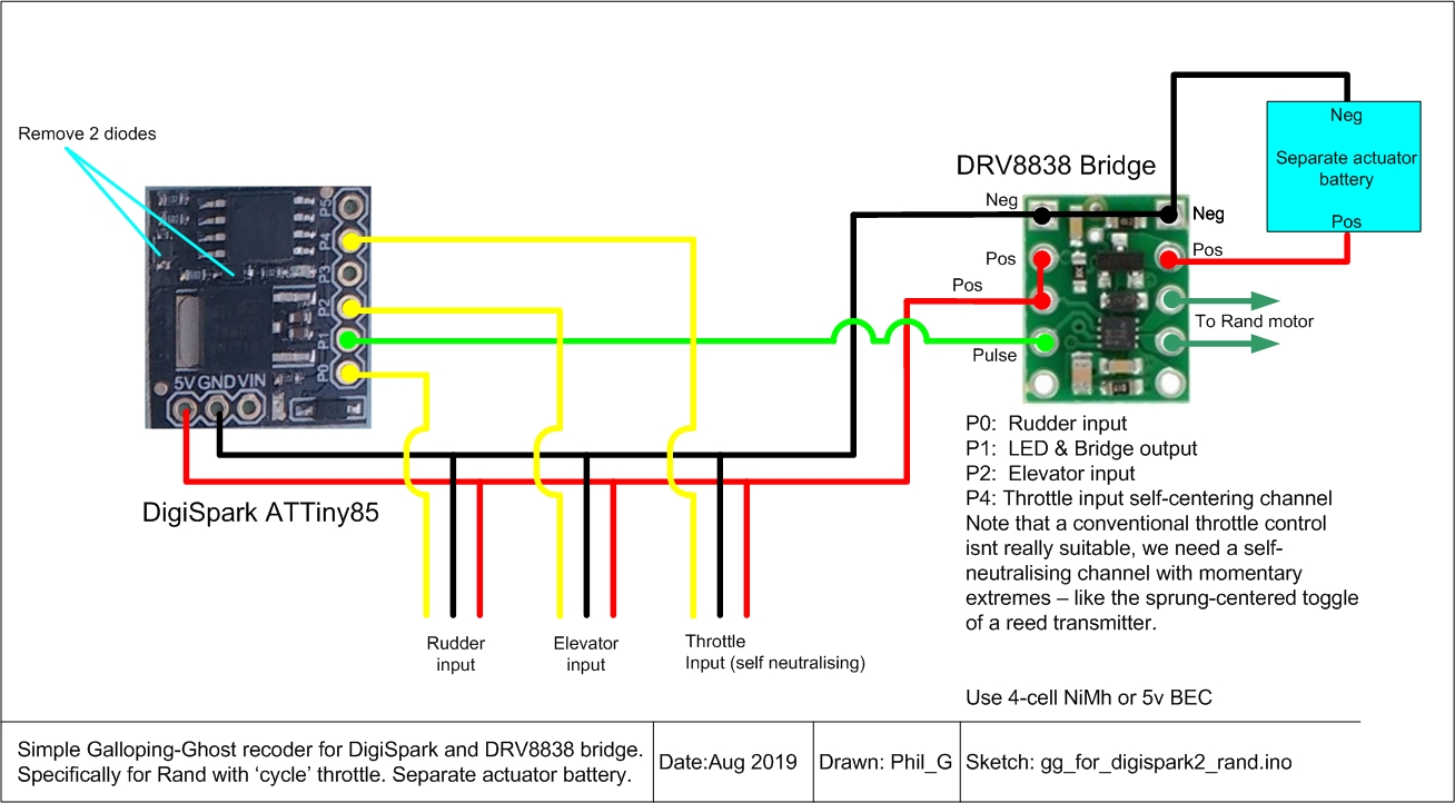

This has been on my mind so instead of going flying its done, & working fine.
The Rudder & elevator functions are unchanged, same mark/space and rate response as always, but now a third channel input controls the bridge as follows:
Channel 3 > 1650uS equivalent of full tone, bridge held one way
Channel 3 neutral (+/- 150uS) normal mark/space and rate operation
Channel 3 < 1350uS equivalent of no tone, bridge held the other way.
Ideally of course you need a sprung-centred channel, or an "up/down" toggle or buttons, otherwise you have to remember to manually centre it.
Connections are rudder P0, elevator P2, throttle P4, and the output is on P1 - so its the same as the existing recoder with just the addition of the P4 throttle input. Note that the throttle input needs to be a self-neutralising function, not a conventional friction 'throttle stick'.
See attachment in 'Files' section viewtopic.php?f=7&t=756#p6001

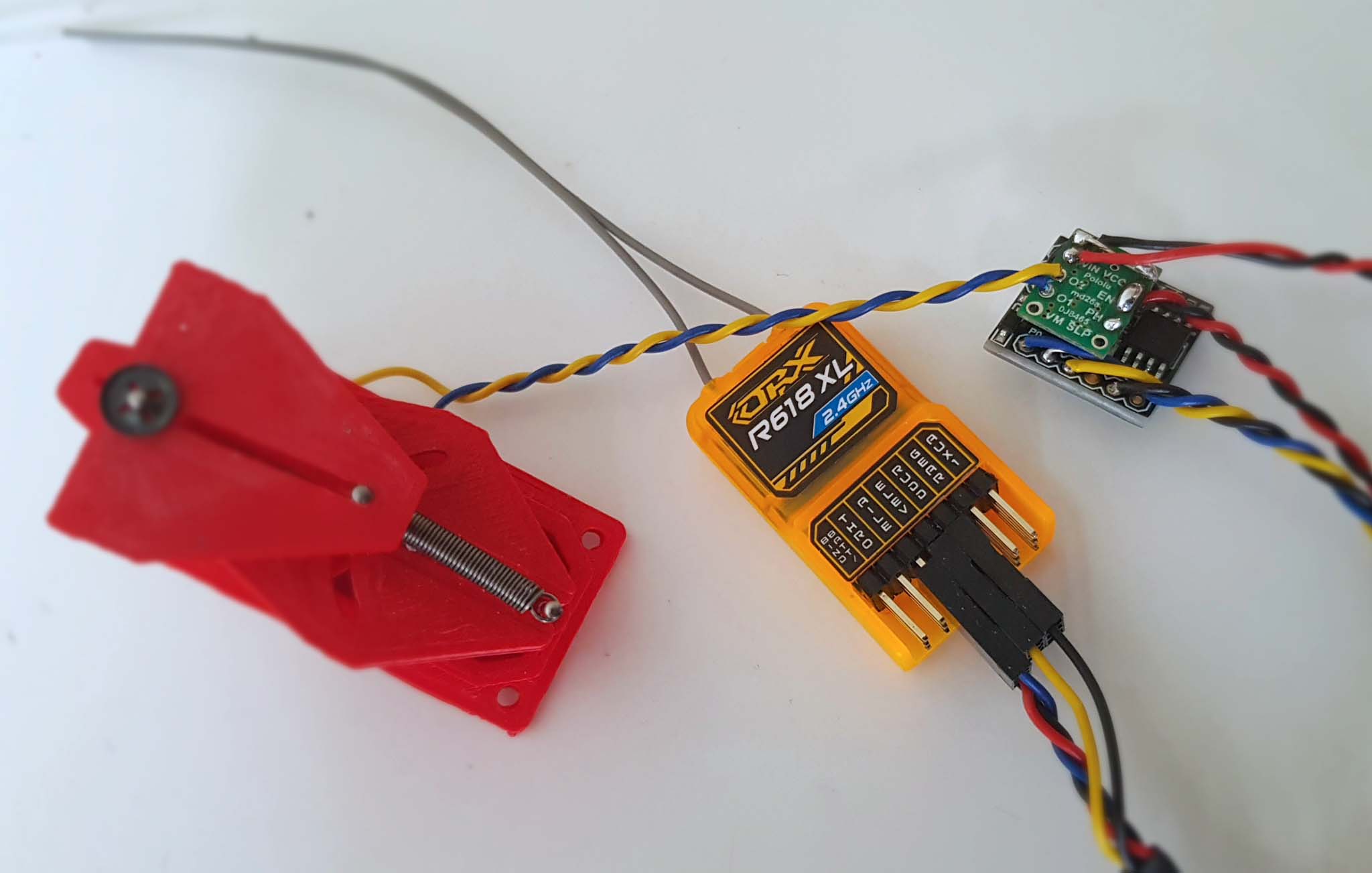

Here is a set up with the Digispark ATTyni85 with cycling throttle which you should clearly see when I'm moving the rudder stick. You will notice also that at one point I disconnect the elevator to highlight the recoder going into rudder only mode, the yellow wire. With this setup there will be up to 9 wires going out from the recoder if the option with separate power supply to the actuator is chosen like it would be running an original Rand LR-3. I have to apologize for not running an original Rand but will as soon I'm able to reach my attic...I'm working in Stockholm but my residence/attic is on the Swedish west coast close to Gothenburg.

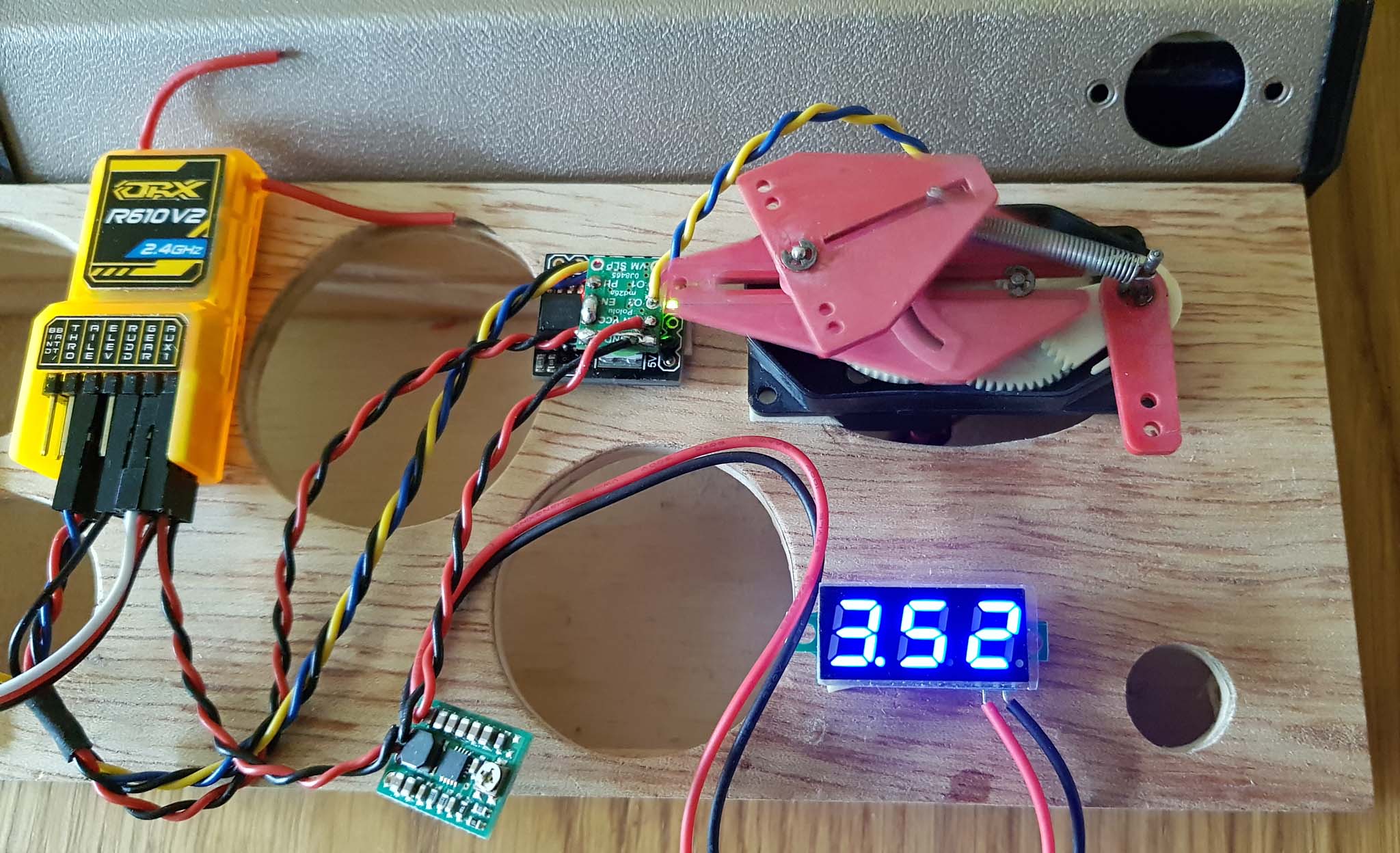

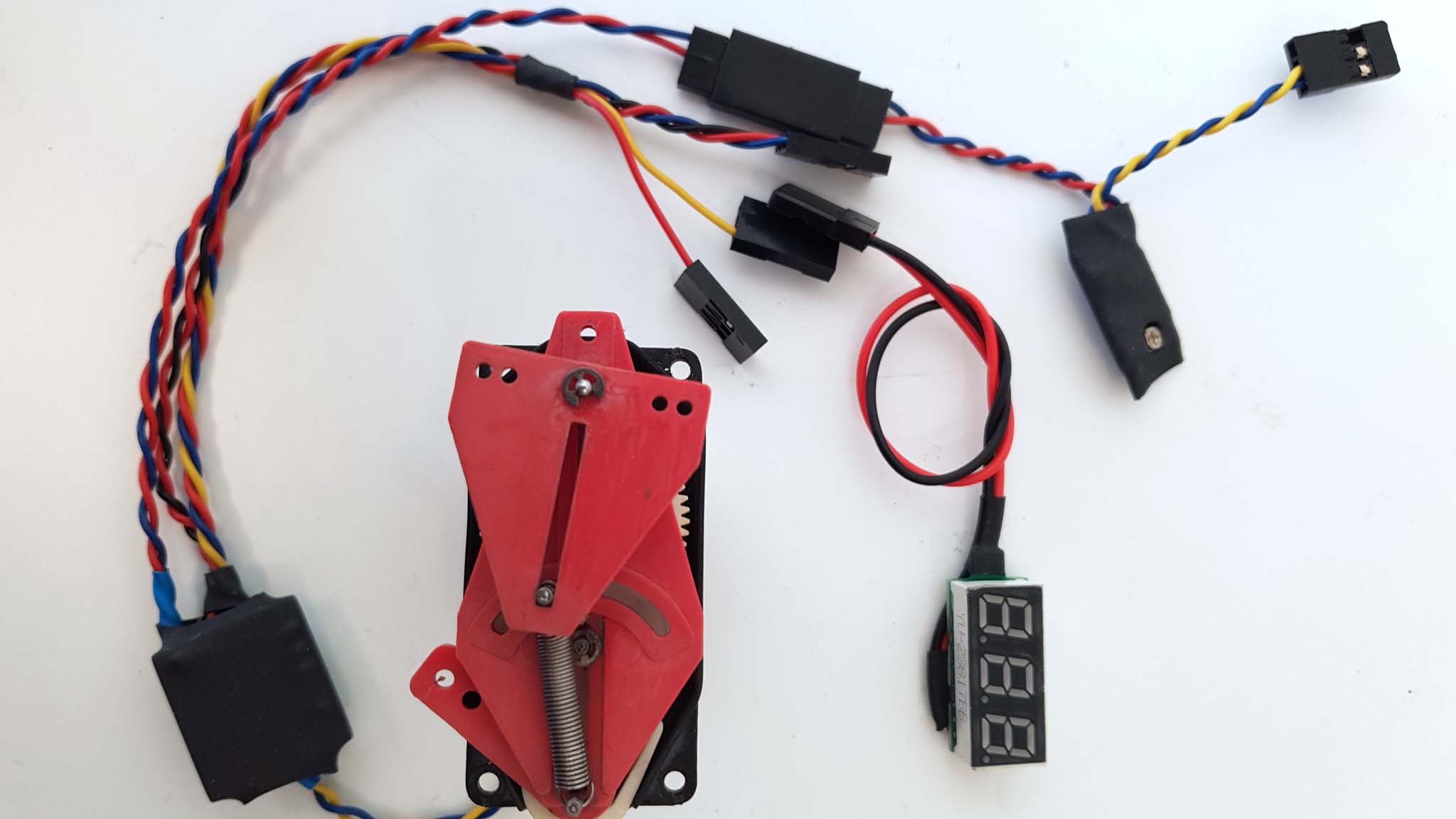

You will see in the picture the complete set up where I supply the right voltage to the actuator via a step down unit from Pololu S7V8A and added a cheap voltage display just to show off , remember here that some Rands are on 2.4 volt and some on 3.6 volt. You will identify which one by looking at the bottom of the actuator where there should be a dot, red for 2.4 volt and black for 3.6 volt. If you by any chance have both kind of actuator you could add a resistor as step down on the 2.4 volt so it can run also on 3.6 volt and you don't have to remember which one was which!

Here is a pic of my set up. You will see the main "board" and a smaller one which is a variable voltage regulator, the small pot is to set the voltage which is checked with the mini voltmeter, with this configuration with this set up it's actually possible to run the full package on 1S as the regulator can also step up the voltage...All leads are connected directly to the receiver which is powered by the regular flight pack.
Very well done Phil as this new recoder brings GG to the highest level.
As voltage regulator I use Pololu S7V8A
