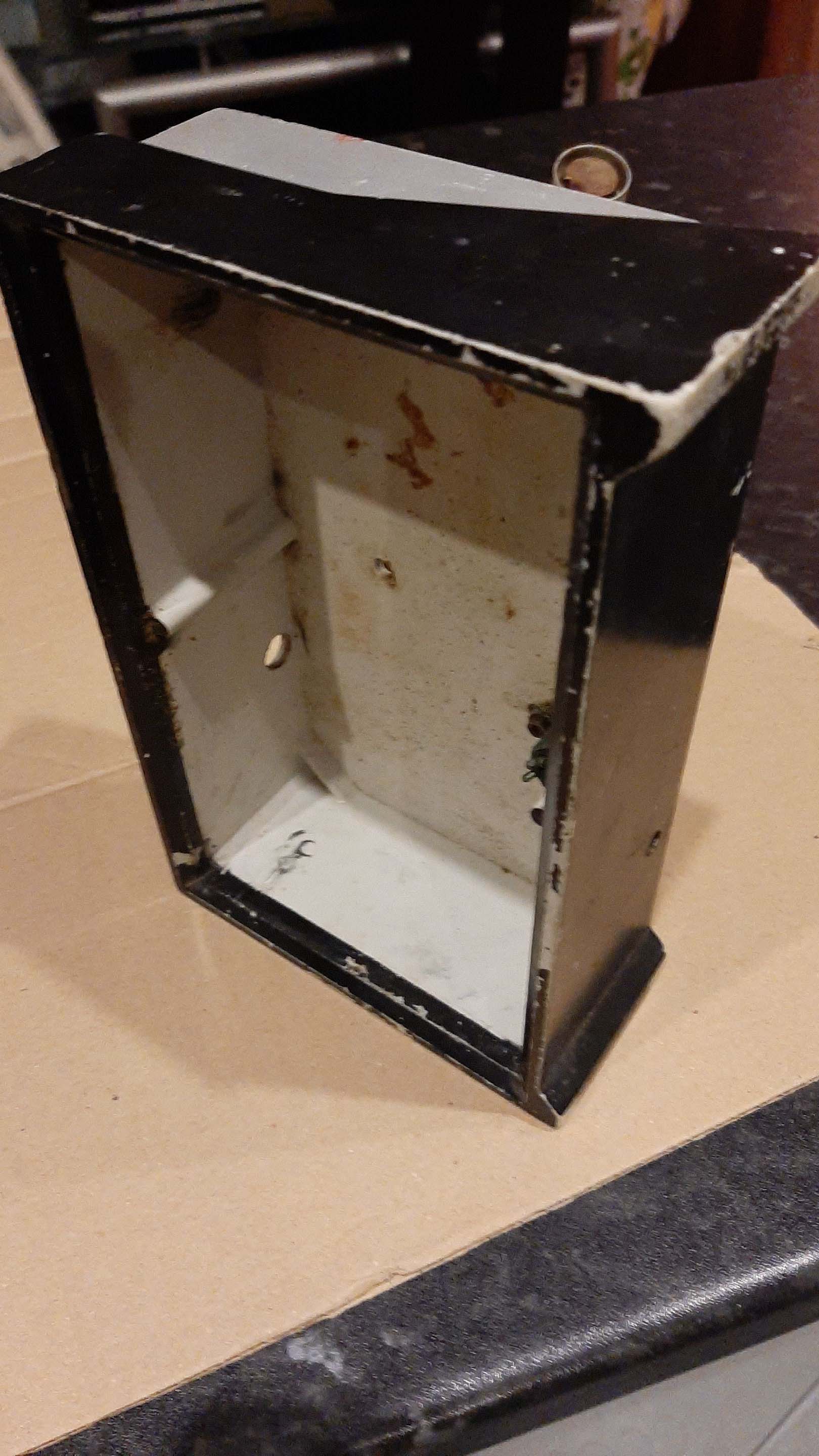

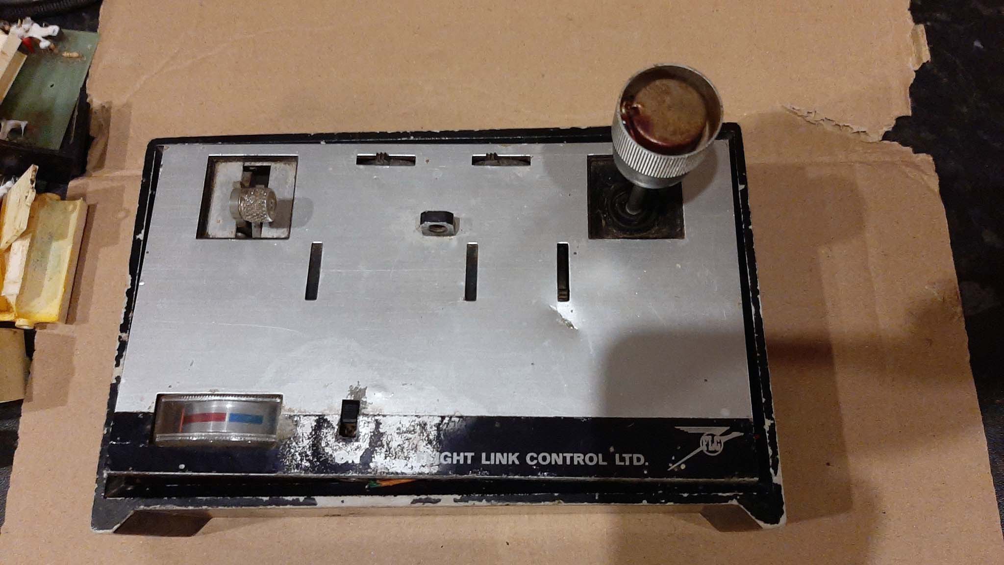

stuart mackay wrote: 21 Oct 2020, 08:22 Here we go, guys, another really long shot!?!
Has anyone got a switch, throttle lever and end cap for a single stick series 4 or Sovereign, trying to resurrect one here and these bits are missing or broken.

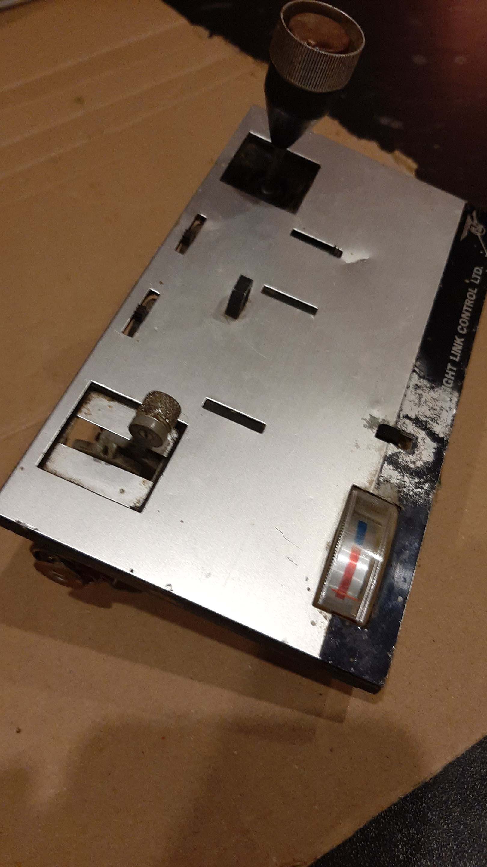

Here it as received :cry: :cry: :cry:

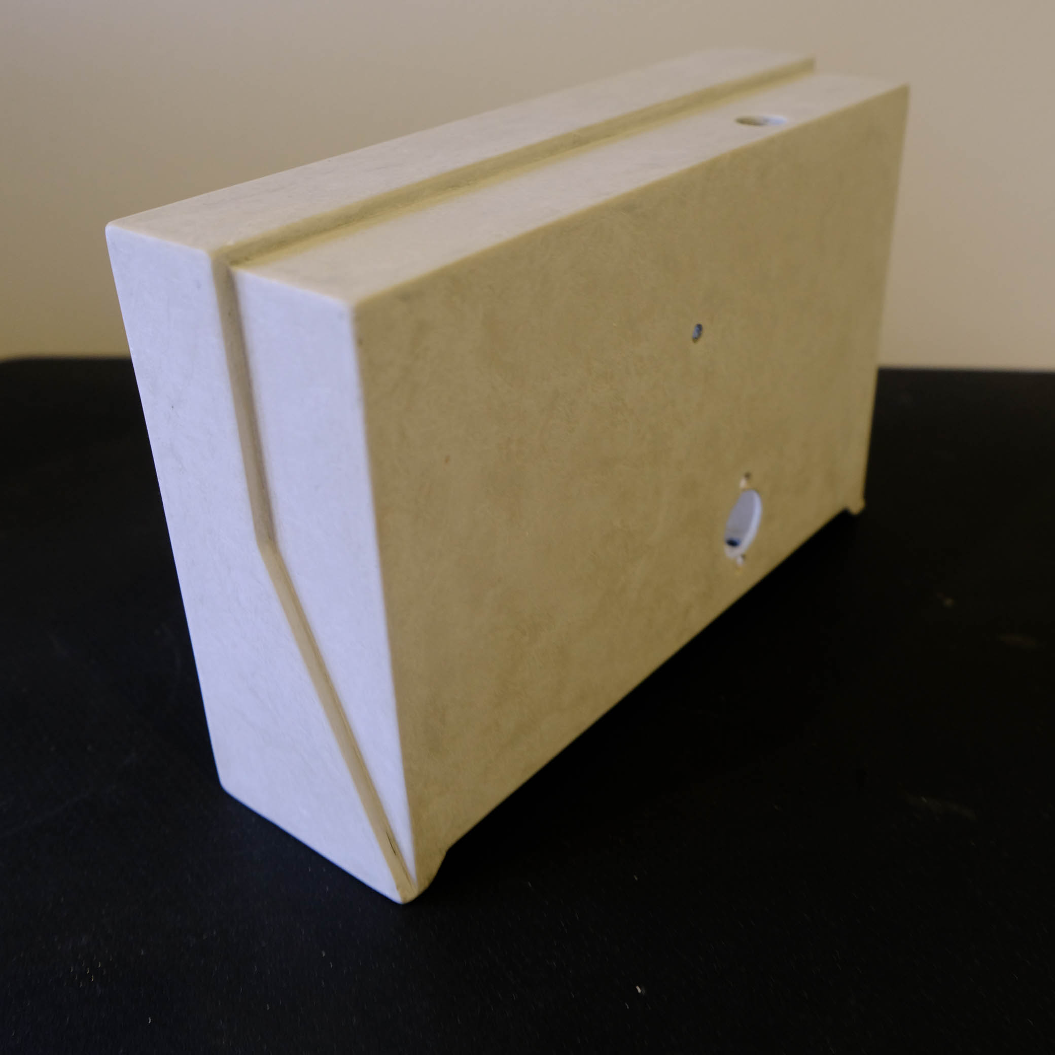

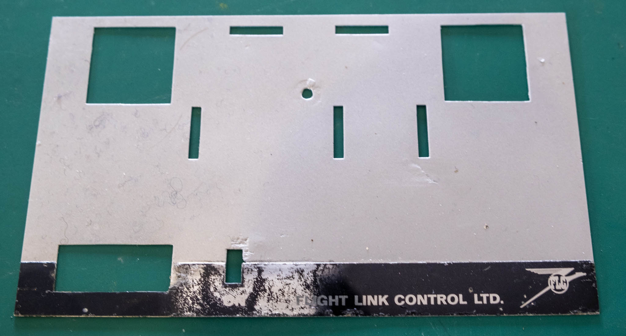

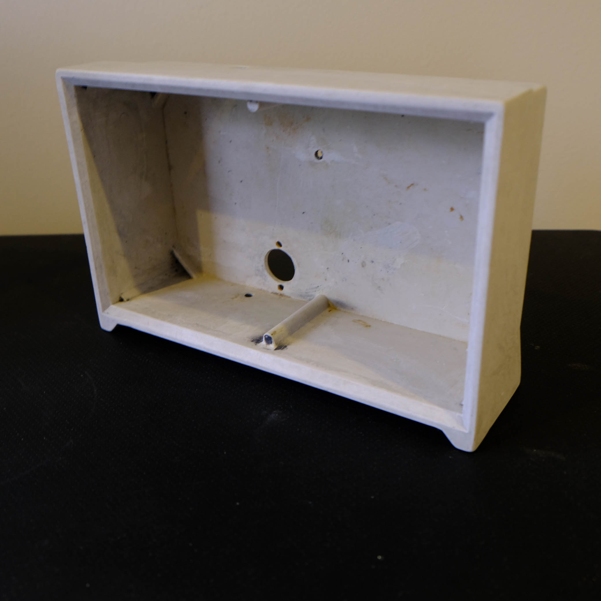

Stripped the case back to its bare resin, so here is a before shot!

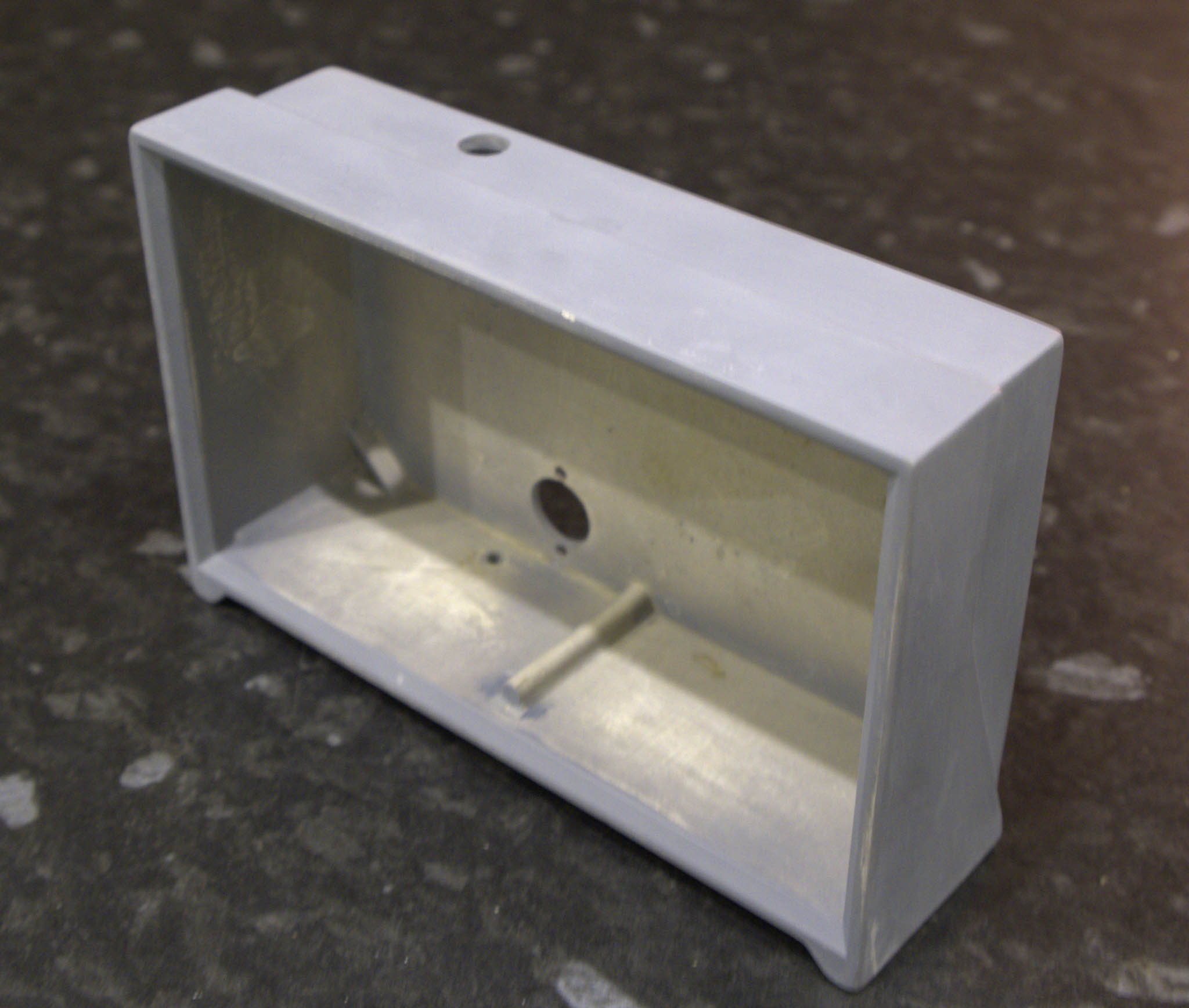

and with a coat of primer, sanded ready for colour coats.

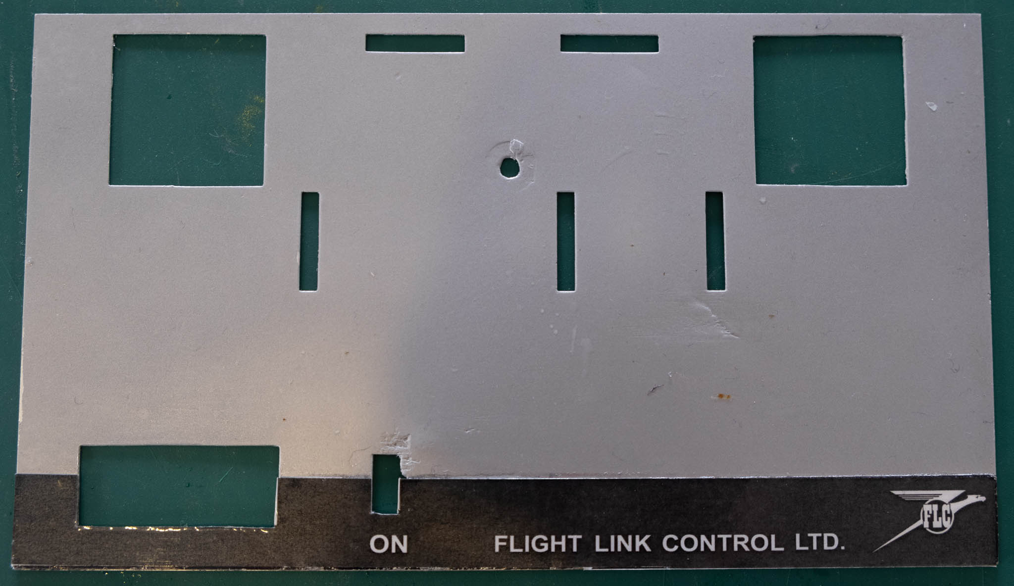

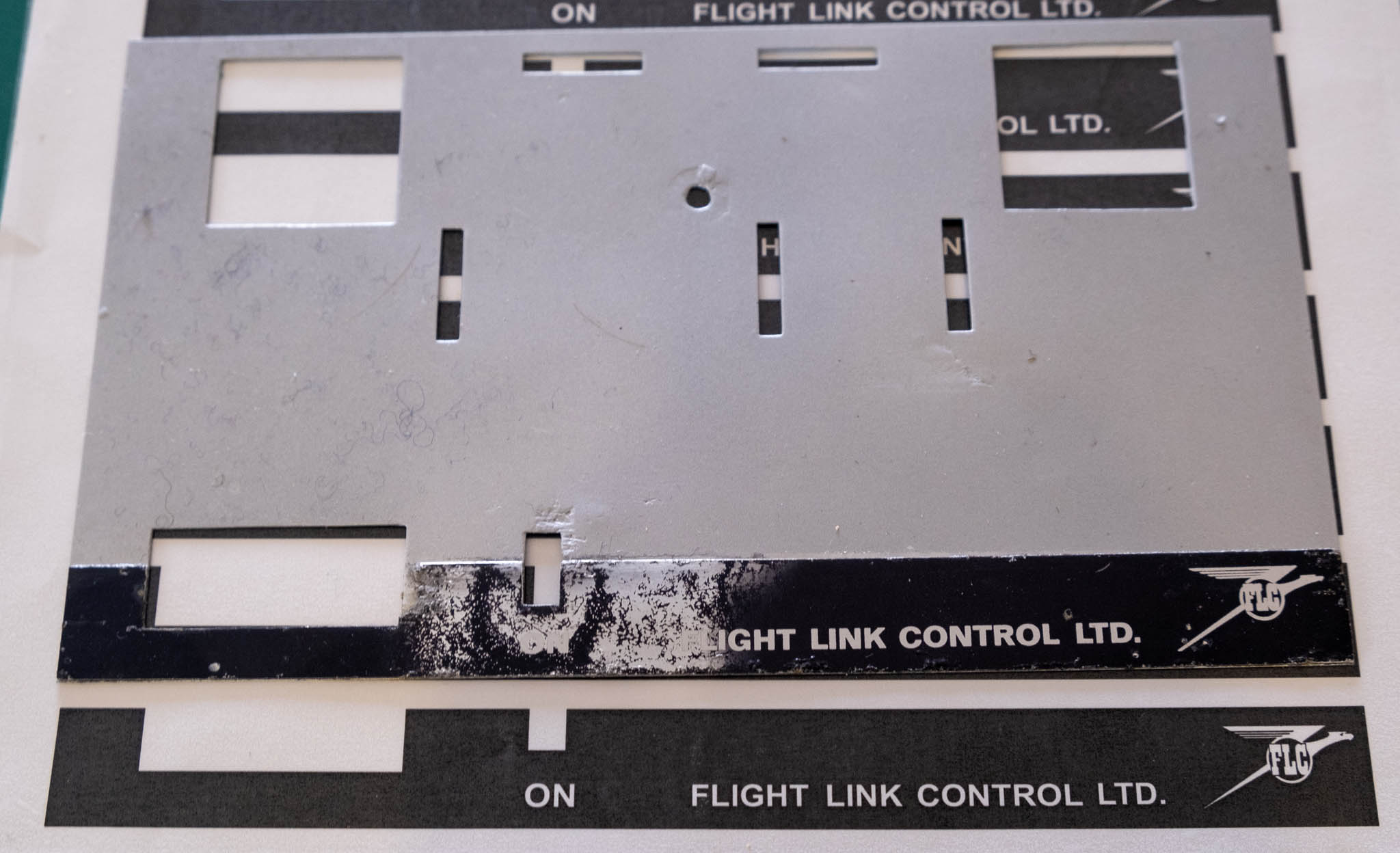

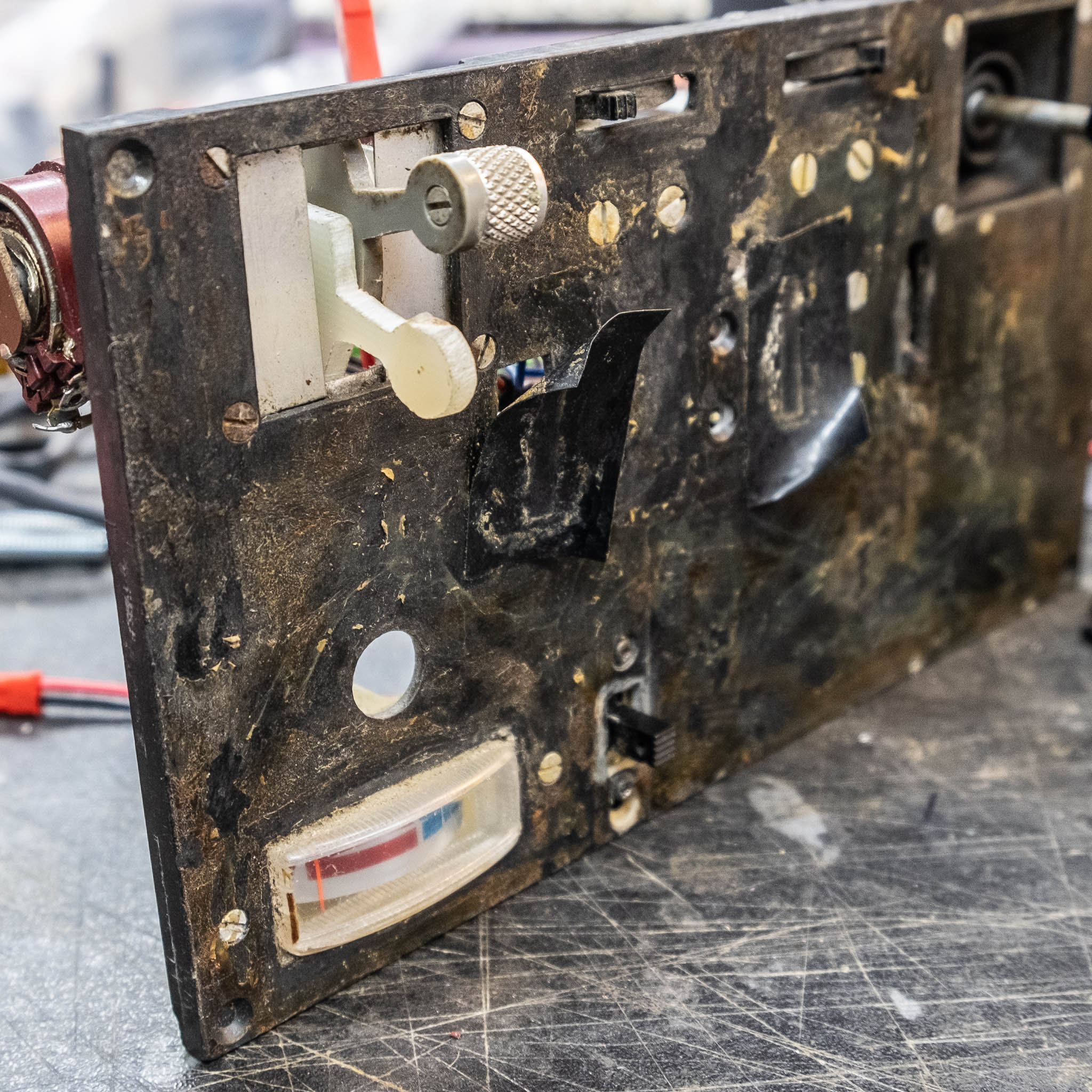

Had a play last night with trying to fix the seized switch which I ended up replacing with a JR/Futaba proprietary slide switch. Also made a replacement throttle arm from 3mm Composite sheet to match the. original one.
I tried to planish the dent in the aluminium facia out, which I managed but trying to replicate the brushed aluminium finish with wire brushes proved elusive, so to conceal this and another couple of corroded areas, I resorted to a rattle can of aluminium paint, whilst not original made a better job of the ,otherwise, pock marked original brushed ali sheet facia plate.
Mike Kitchen came to the rescue (as always!) with a superb scan of his Series 4 lower black sticker, which I was able to get laser printed locally on self adhesive film and then laminated it with some clear fablon to get a better gloss and protect the inked graphics.
Pics below:
Mike K laser printed scans
new label and facia plate
Damaged label
Damaged label
New throttle arm fabricated from Composite sheet
Finished facia ready to install

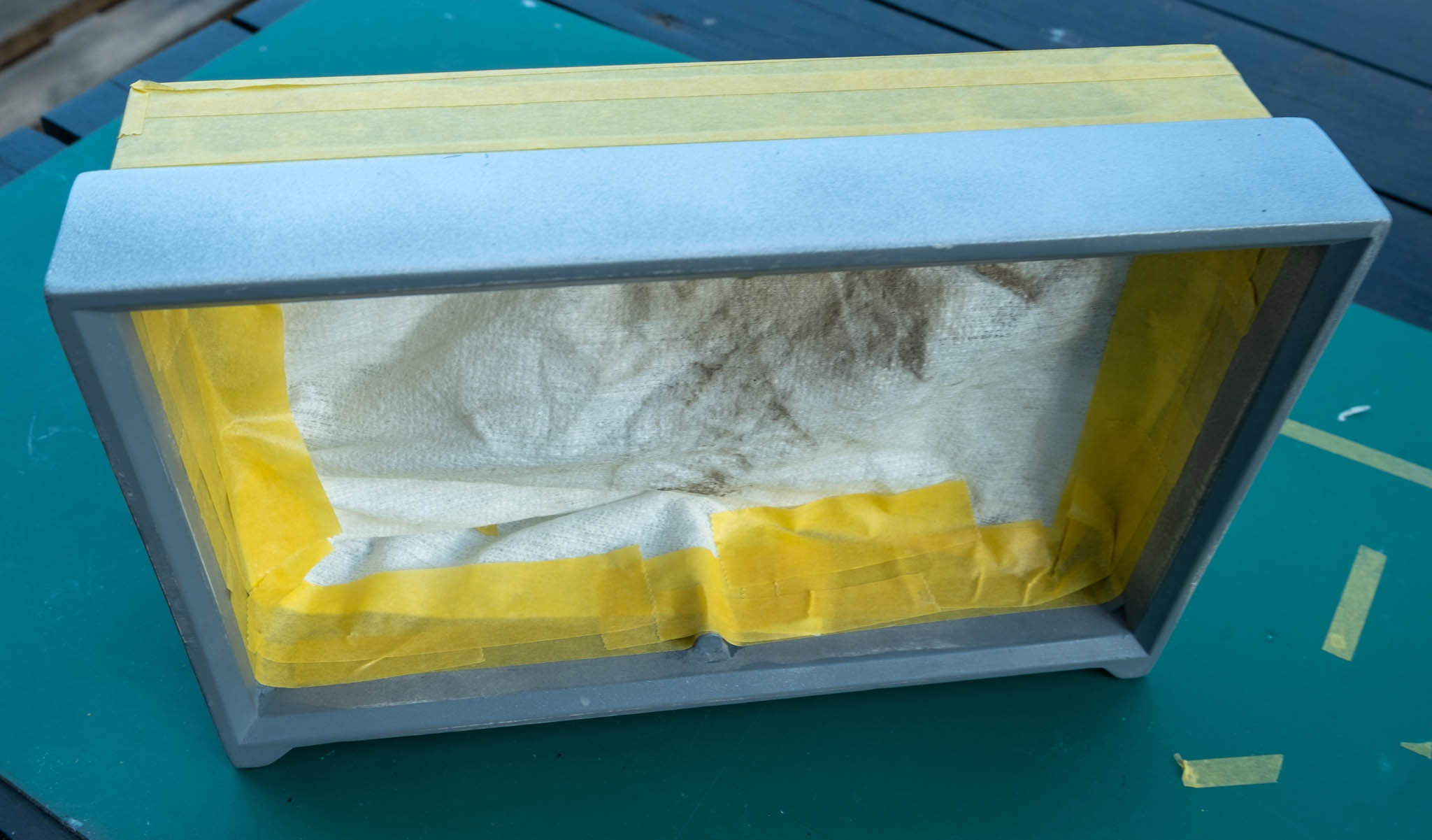

Posts: 615
Re: Flight Link Control Series 4 Restoration
Got the Tamiya masking tape and a rattle can out and here is the result
