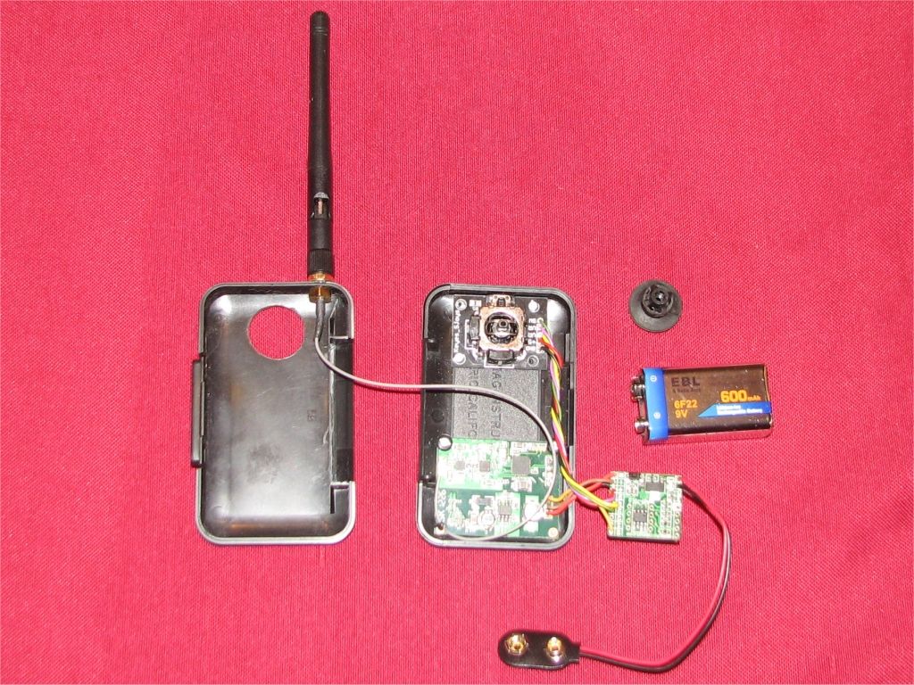

Dont take this at all seriously, its just a bit of fun, its a micro 2ch propo transmitter made as a challenge, an evenings entertainment using only what I had to hand.
The bits I had were a V8HT Frsky RF module, a little plastic case from a Maglite Solitaire torch, a PP3 2S life battery, a PlayStation-style propo joystick with left-right, up-down & press (which I'll use for trim), and an iPC07 PIC processor board (same hardware as the Tiny-6 reeds emulation encoder). The Kraft is just for size reference:
I found the playstation joystick gimbals are strange in that they cover the whole 5v, ie the movement uses the whole pot, not just a quarter of it as usual.
The software is in PIC assembler, just a very simple 2ch, no 'features' other than servo reversing which is set by holding the stick over on power-up, and is saved to flash. I've avoided the need for a schottky by programming the PPM output to emulate an open-drain feed, by outputting a low for a 0, and switching to input for a 1. This allows the Frsky's internal pullup to 3.3v to provide the logic 1 on the PPM line with no fear of overdriving it to 5 volts.
The 2ch encoder is hardware based on an iBoard IPC07 which is just a surface-mount PIC12F675 with an LDO voltage regulator and decoupling, and an ICSP connector. Everything is permanently wired, theres no room for connectors.
I've completely removed the bind board so theres no button and no LEDs. To get bind mode, I stick the two ends of a low value resistor between the end holes, switch on then remove it. I cant imagine having to bind this little novelty set that often, its just a bit of fun - although its obviously a full range tranny with the Frsky V8 module.
It is tiny, and only just went together. I even had to remove the catch that holds the case closed - some black tape will suffice, no-one will know!

Heres the completed set (obviously nothing is ever truly completed...)
