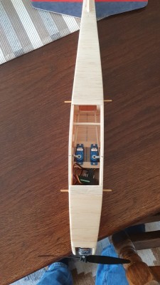

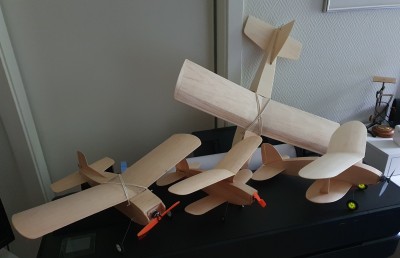

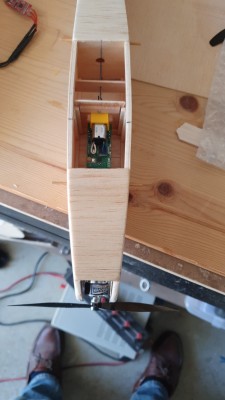

To second Al here are 2 Swedish Gopher.
Why build one when you can build 2...
20" span, 5 oz, and 35 watts behind the propeller, one version of my Gopher is R/O with throttle as the other is a "conventional: 3 channels, both are extremely aerobatic.
Basic balsa frame just doped with a few trims in tissue paper
Thank you Al to have me let take a peak at your drawings.
- ...at the flying field for the maiden, despite good weather completely empty
- Details of the controls in the tail
- Need to design and build a couple of micro/mini servos
- My own brick for R/O

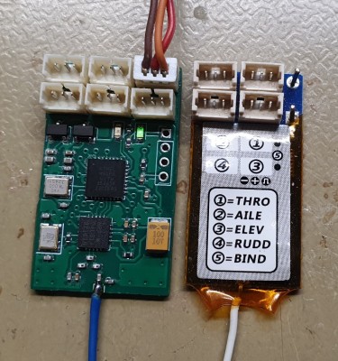

As many of you might already know I have a preference for smaller models so it was time to design a Rx that would replace my commercial Micro Rx and this came out:
6 Channels
Operation voltage down to 1S LiPo as the Atmega88 and the nRF24 is runned at 2,7v but the servos are still supplied with +Batt, to be able to run at 2,7v the crystal is a 8MHz for the Atmega88, the Rx has reverse polarity protection and a couple of LED to show it's working and receiving the packet from the Tx.
Total weight is 3 gr. and size 18x30mm-could had it smaller but I wanted 6 channels and the connectors dictate the size in some how.
Re: From Tobe's skunkworkshop
Posted: 07 Aug 2023, 20:29
by Wayne_H
Wow
Really well done Tobe (again
) , super impressive
Posted: 08 Aug 2023, 08:24
by tiptipflyer
Brilliant, just brilliant Tobe (as always).
Posted: 08 Aug 2023, 12:45
by leccyflyer
Fantastic! Looking forward to seeing some of the models that you equip with these superb little receivers Tobe.

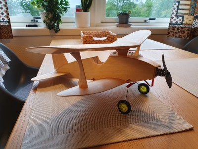

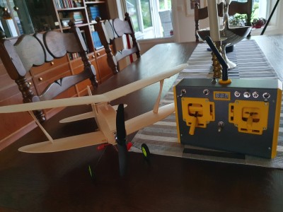

....a few!
...and my latest little biplane weigh-in at 100 gr. Included its batteries
- Wing span is 16"
- The Rx in its place....mini/micro servos are in the pipeline but not ready yet. For comparison the antenna whisker is 30 mm (1 & 1/4")
Posted: 08 Aug 2023, 14:23
by leccyflyer
That bipe is impossibly cute!
