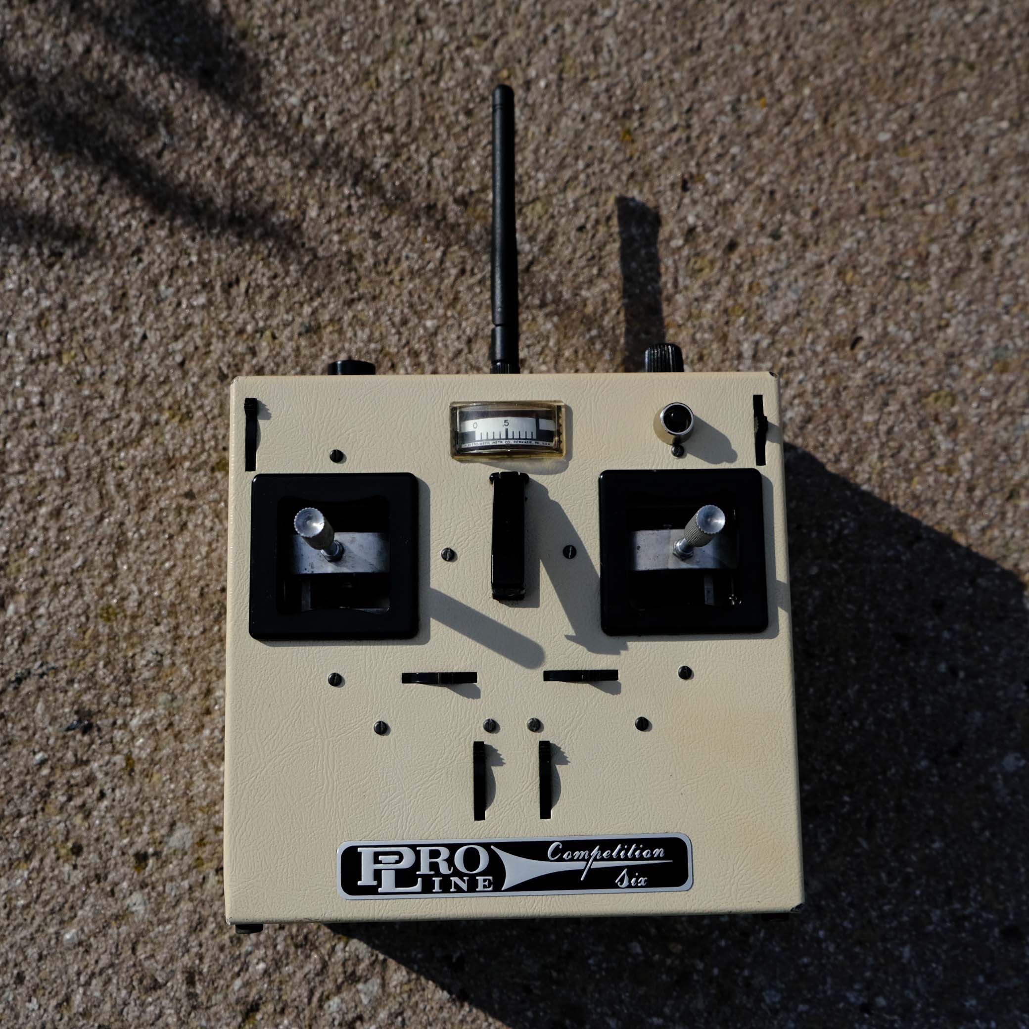

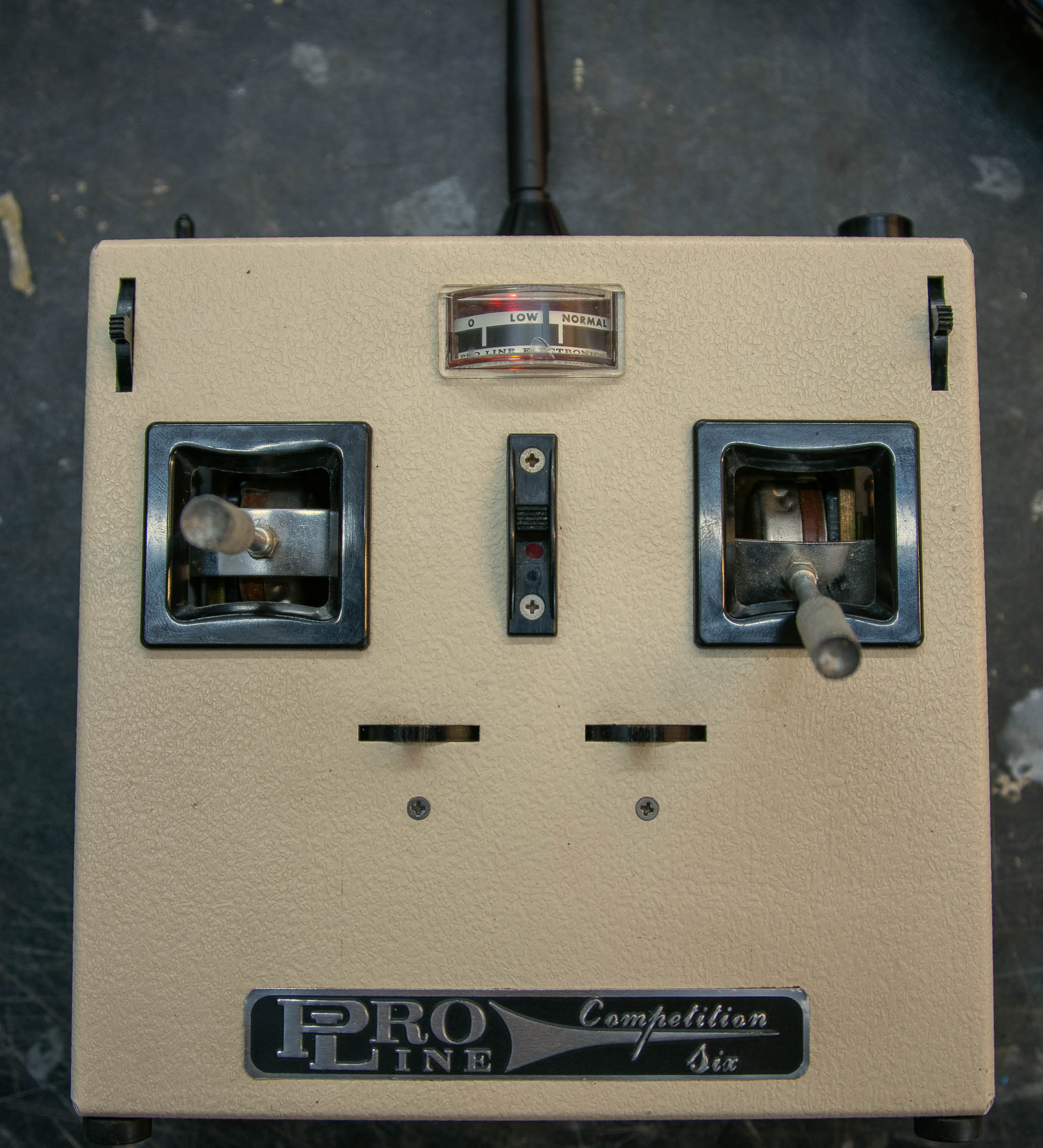

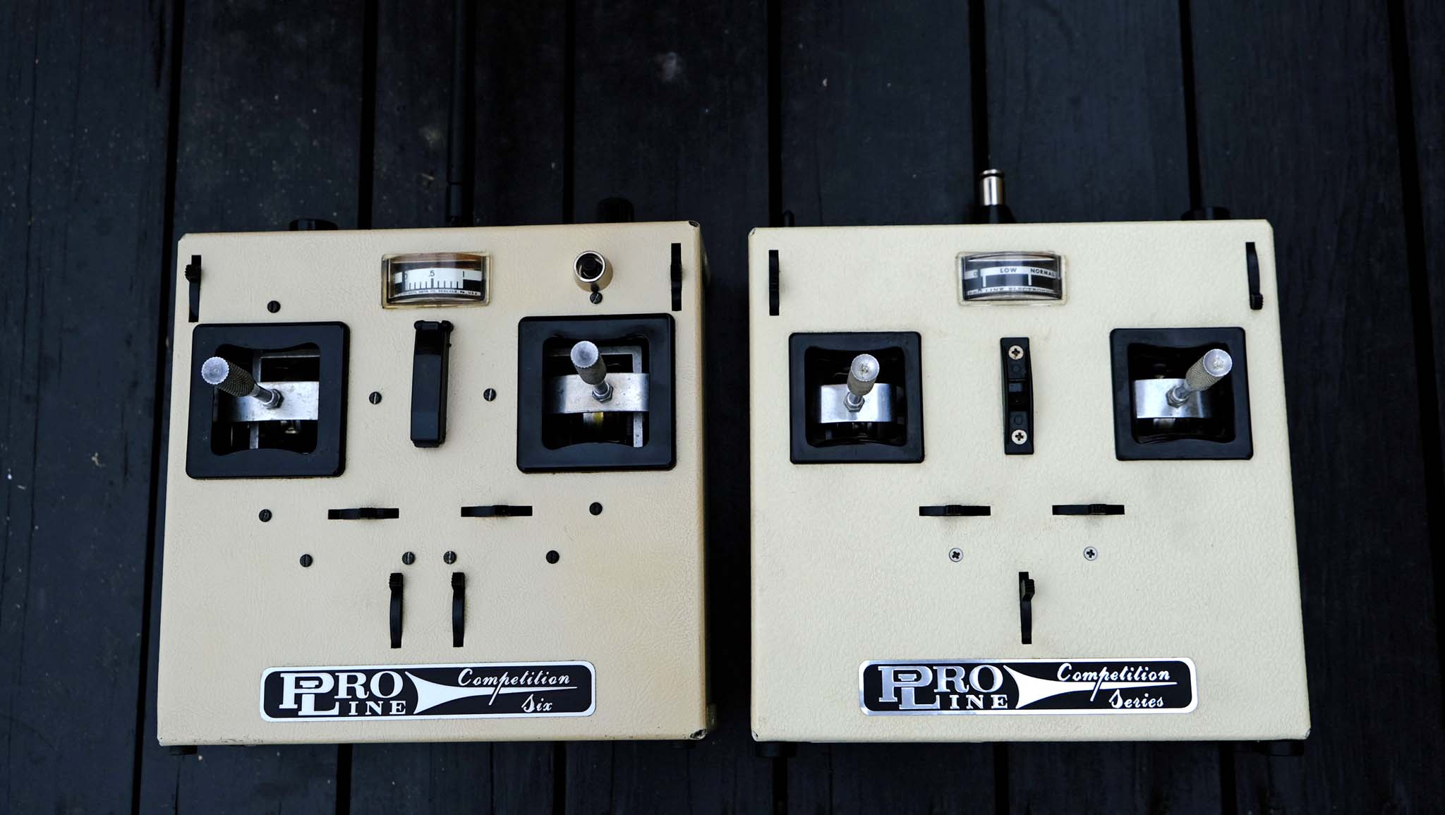

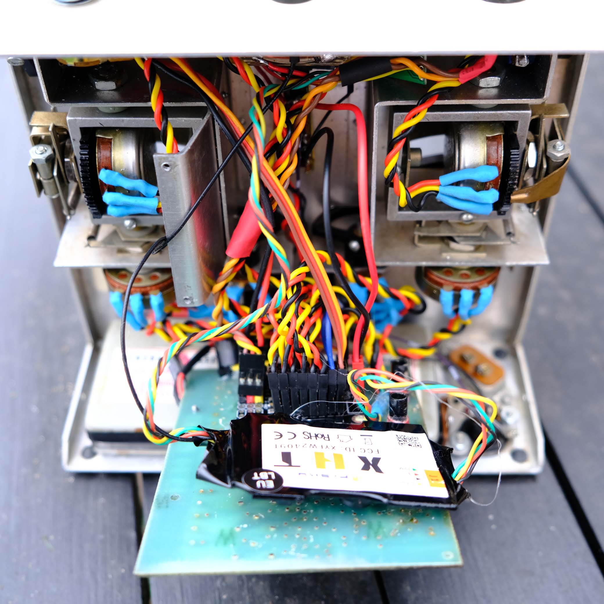

Managed to acquire a couple of Pro-Line Competition Series transmitter, one of which I have converted to 2.4 using Phil's Encoder and FrSky XHT module.

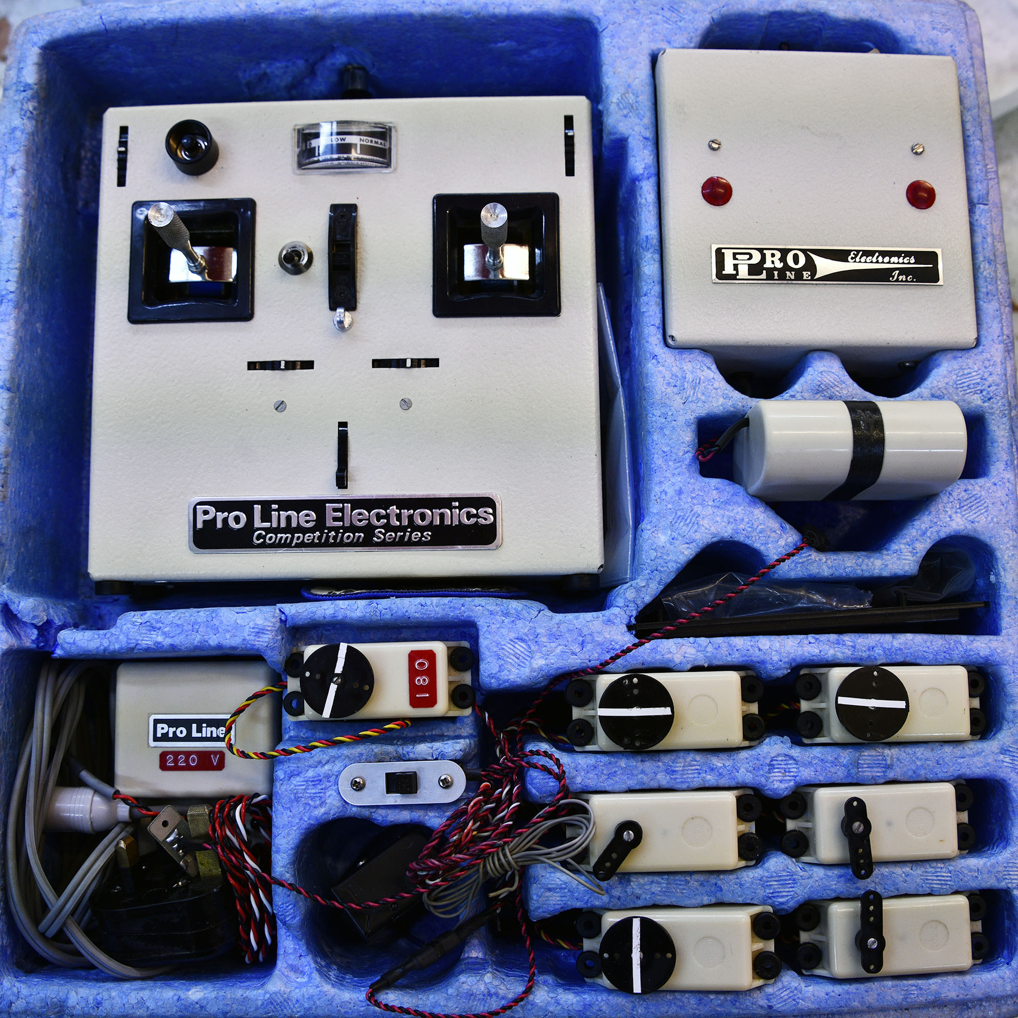

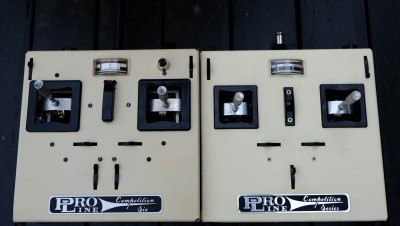

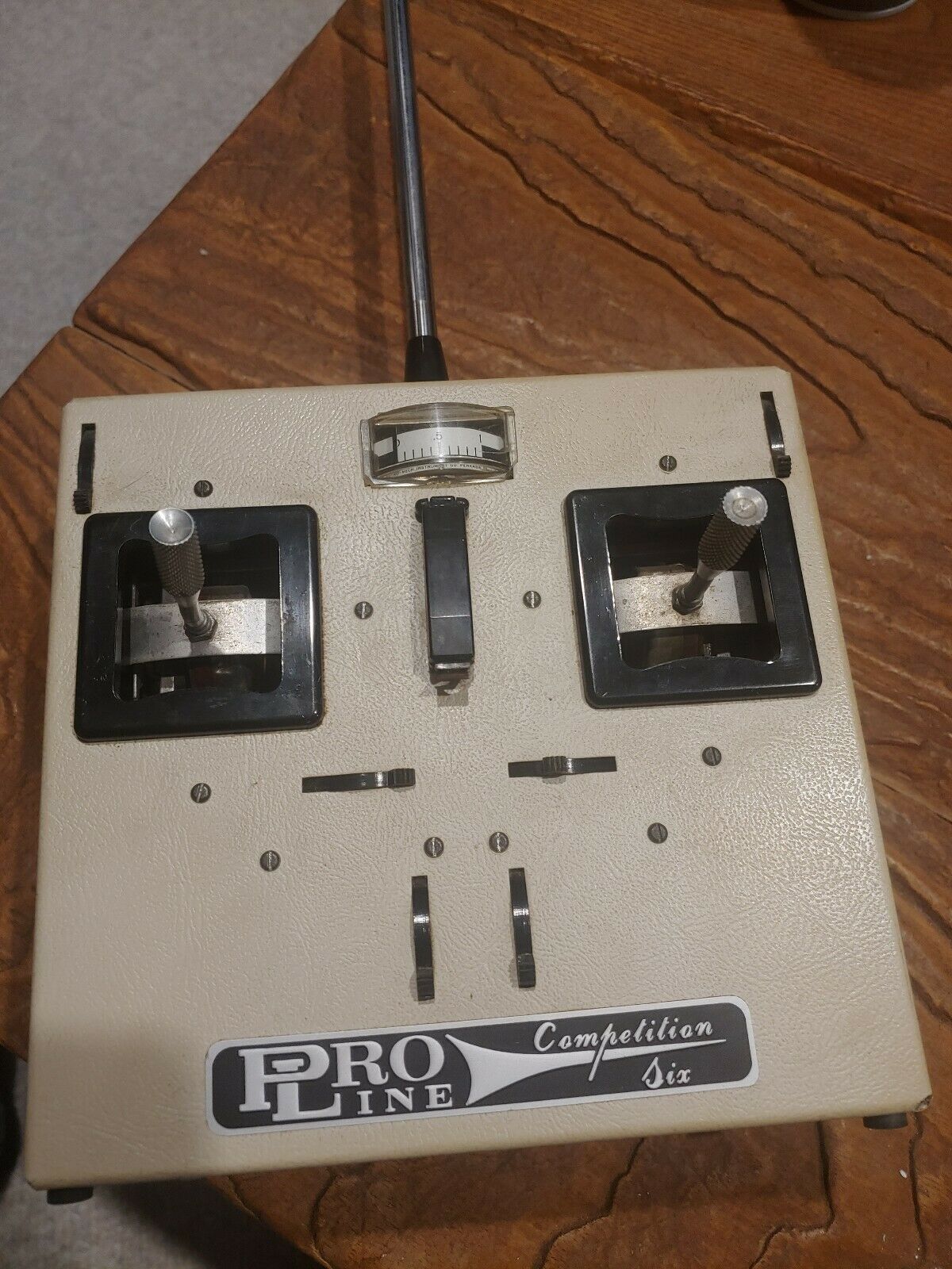

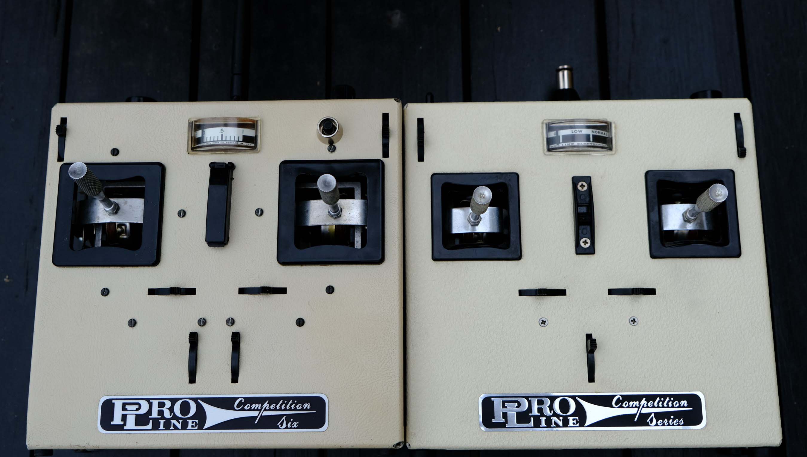

Thought it would be interesting to compare the differences between the Competition Six and the later Competition Series transmitter that I have.
The Competition Six is I believe an early model and there is evidence that it is a pre 73 model.
The Tx had a long (12.5 inch) top mounted aerial, which I felt to be too vulnerable to catching on things when in use and have now replaced with the standard FrSky 2.4 antenna.
The locking switch and meter are identical to those use on early 70s Kraft sets and the control layout has the two propo channels on the lower front face. There is a trainer button on the top left of the case and this is used as a minute minder on the new installation.

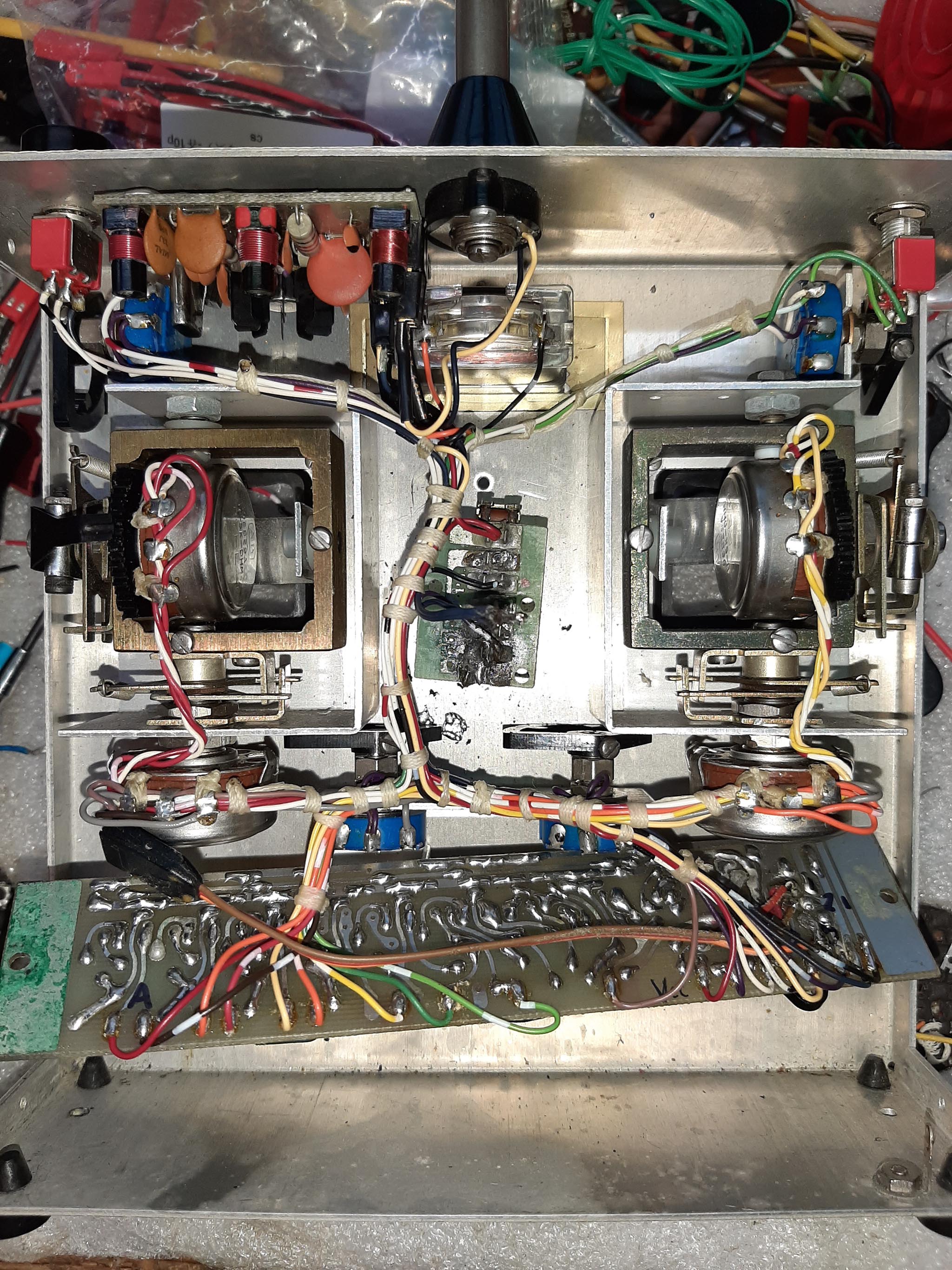

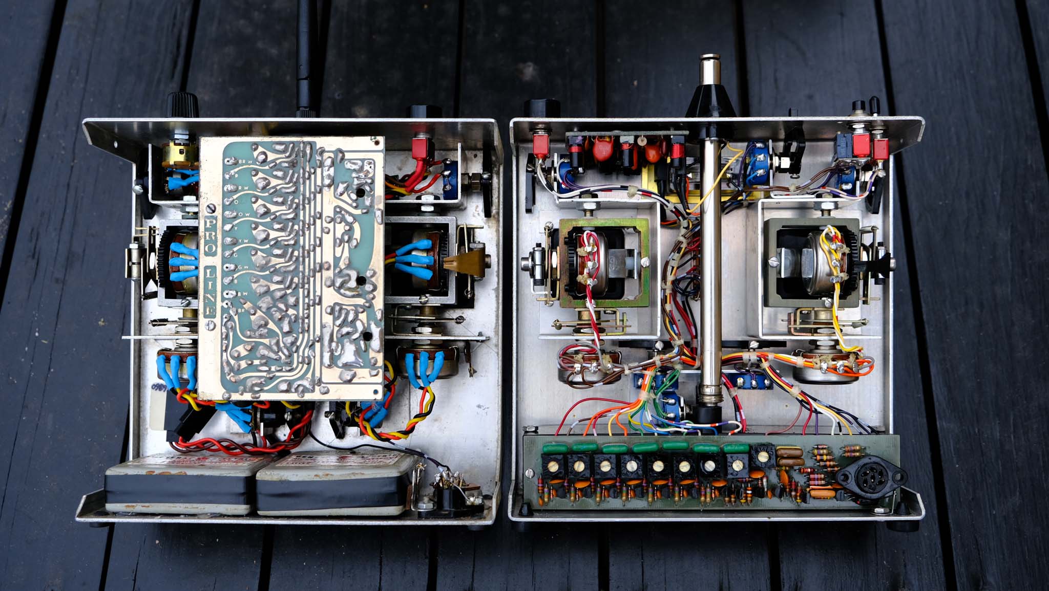

The internals are different with the encoder and RF all mounted on a single PCB, whereas the later tx has a separate RF section mounted next to the retractable aerial on the top face.
The Comp 6 is powered by two separate GE Nicad packs fitted to the lower face, whereas the Competition Series has a battery box for 6 pen cells fitted to lower face in a bespoke moulded box with charging socket fitted to the rear face of the transmitter. The control layout of the comp series has a propo & switched channel as well as a roll button with a trimmer pot fitted to the top left, the trainer button is on the right hand top near where the the RF module is located.
The thickness of the Comp Series is less and the stick bezels are smaller than the Comp 6. The Comp Series is fitted with a Pro-Line meter and a non-locking slide switch.

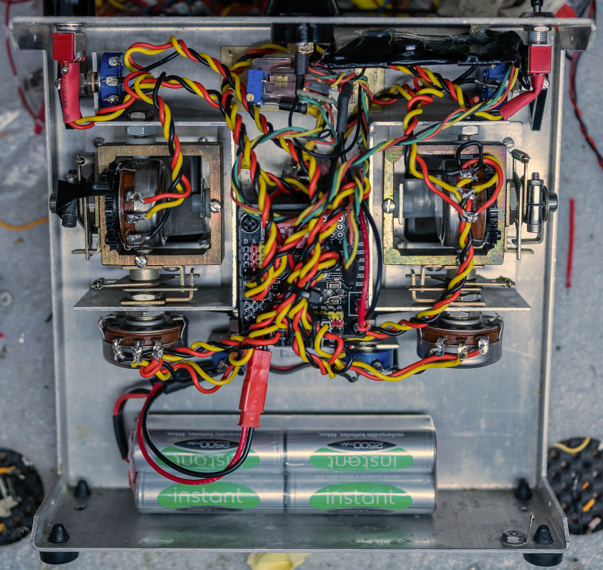

Due to lack of space within the Tx, I stripped the components from the Comp 6 PCB so I could mount the encoder and RF module hidden out of view.

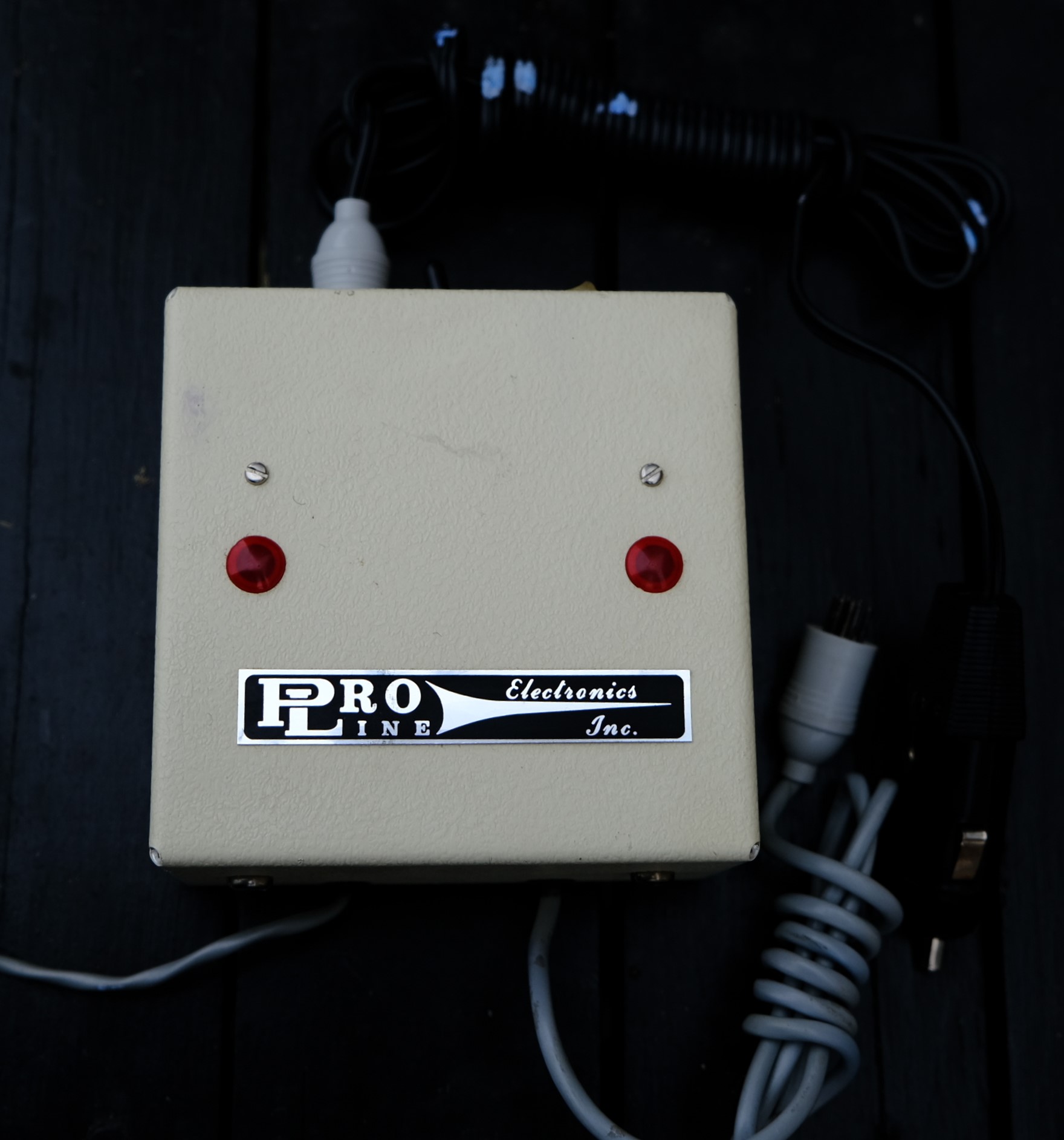

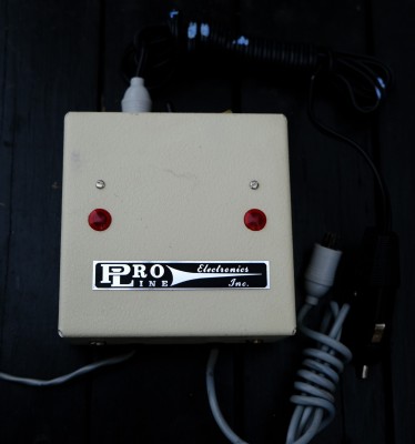

Have attached pics of both transmitters as well as teh 12 V Field charger that cam with boxed Comp Series.

Think so Phil, the stick unit bezels look smaller and there is no visible stick unit fixing screws on the face.
Where was the The RF module and do you remember if it was on the main PCB or mounted remotely like the photos I posted?
I dont know if the AMA label might give a clue to its age?

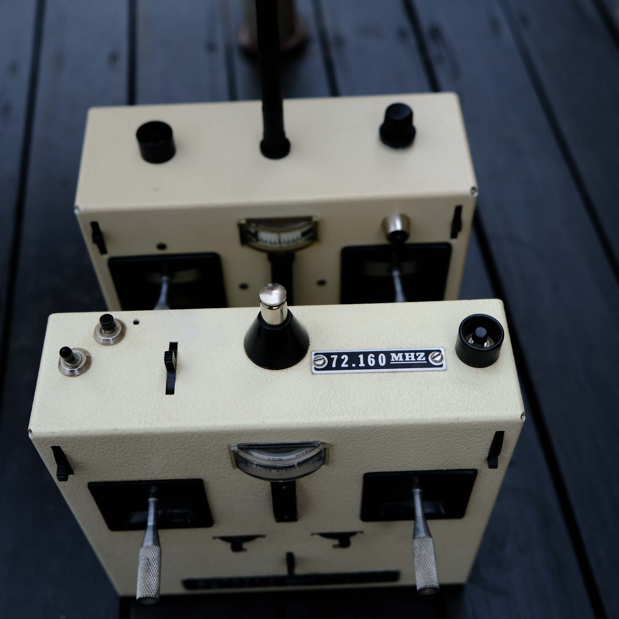

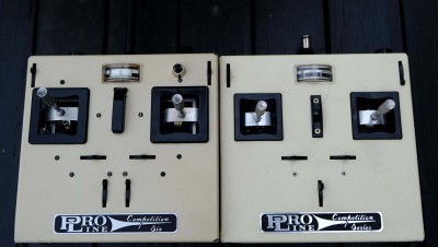

here is a side by side shot of the recently arrived very late model Competition series with the long travel trims (as in Phil's video and a copy that Mike K also has) and the Dunham stick equipped Challenger series.
Both are on 53 Meg and the second photo shows the early and late Competition series and hopefully you will be able to see the variation in control and label placements between them

Another one converted using Phil's encoder with FrSky XHT RF modukle.
This 5 channel Tx was a UK supplied (Crescent Products) on 27 Meg and one of the later models of Competition transmitters but with conventional trim levers and not the 270 degree ones seen in Phil's YouTube video.

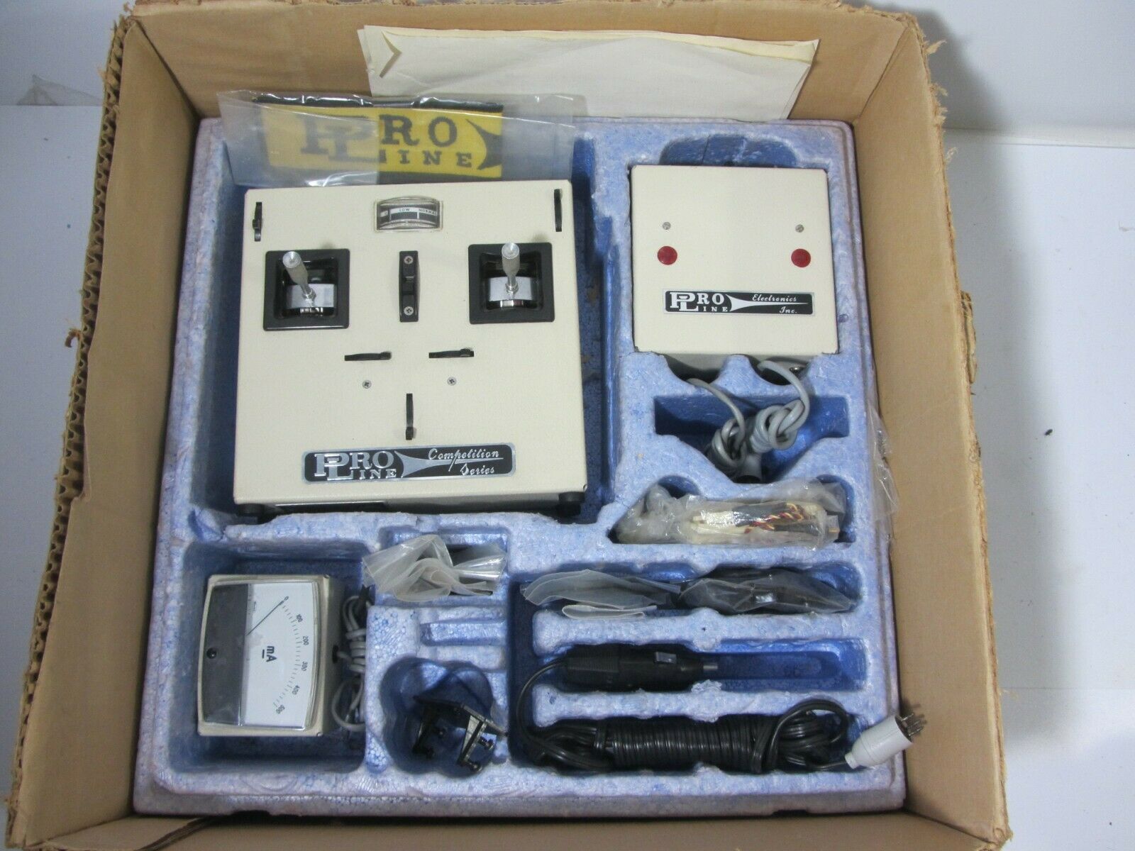

The Pro-Line fascination continues and was lucky to have just acquired a mint, boxed 1976 Competition Series, which with a change of batteries to 2 4.8V AAA Nimh packs to replace the 2/3A Nicads fired up and is working fine on 27.145 MHz.
The set had its original 1976 catalogue and instructions included, I have scanned all of these if anyone would like a high res copy then do get in touch.
