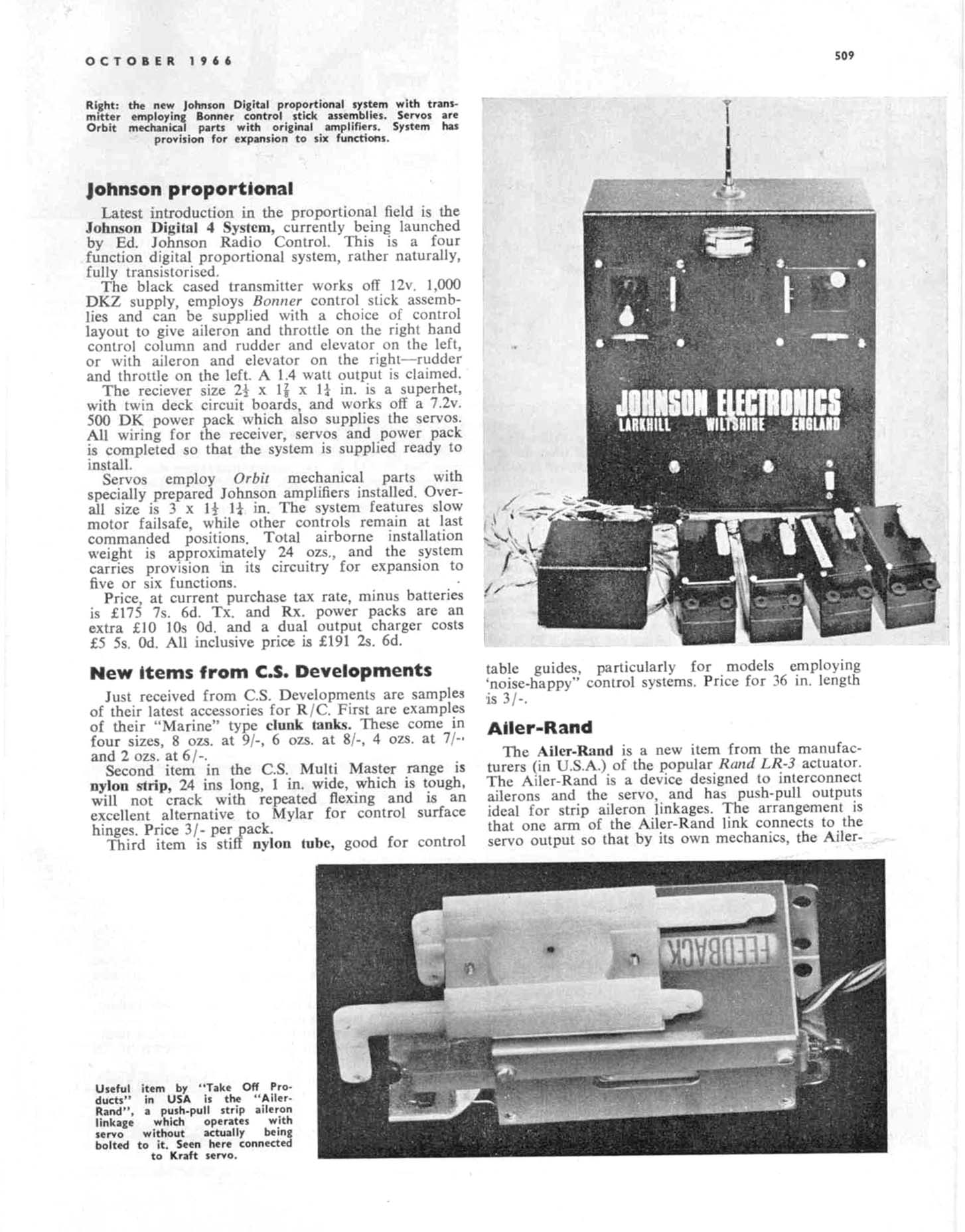

I've seen the adverts and scanned the "commercial developments" introduction for the Johnson proportional, but I've never seen one in the flesh or heard of anybody who's had one, let alone got one. A definite rarity!

Was it an analogue system to be able to have the throttle failsafe back then?
- Posts: 417
Re: Johnson RC

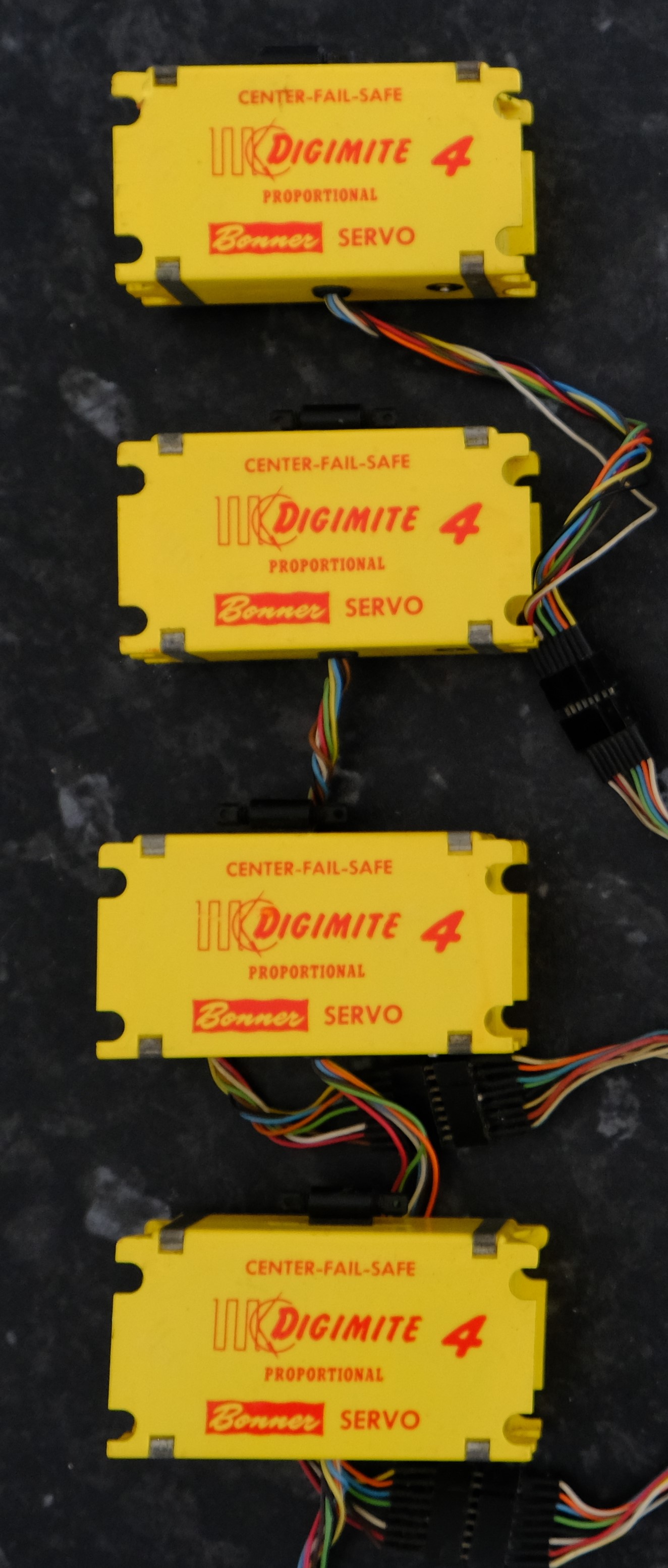

No, it was digital. Quite a lot of early digitals had fail-safe functions. It was actually a feature of the Bonner servos, which came in two varieties - center and end failsafe.
It worked by the receiver having an extra "loss of signal" wire going to the servos. When the servo amp detected this - er, "loss of signal" signal - the servo motor drive would switch from the output transistors to PCB wipers, similar to those found in "reed" servos.
It was pretty effective! The only time my Digimite went into failsafe was when a FlightLink transmitter got between me and my model! (Hence my dislike of FlightLink electronics! ) It recovered as soon as it emerged from the "shadow" of the FlightLink!
However, failsafe was quickly ditched on the grounds of cost and complexity. It wasn't "inherent", as was the case in many analogue systems.
I've never been aware of an early digital system that had a failsafe unless it was using Bonner servos (or maybe the related F&M Magnavacs?). However, I note that that write up of the Johnson system says it uses own design servo amps, so maybe the throttle servo had a pulse omission detector built in?

Thanks Pete!, co-incidentally, I have just been taking some pics of the Bonner Set and I noticed that they had end or centre failsafe exactly as you describe!

So do you think he copied the Bonner electronics to use in the Orbit PS2 servos mentioned in the article?

I suspect that the Johnson throttle amp had its own electronic method. It may even have been a "digital" to analogue converter, so as to provide an automatic failsafe in the absence of a signal. That would have been simpler than having its own built in pulse generator to take over on loss of signal.
