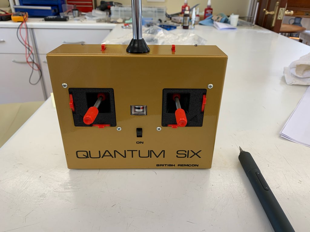

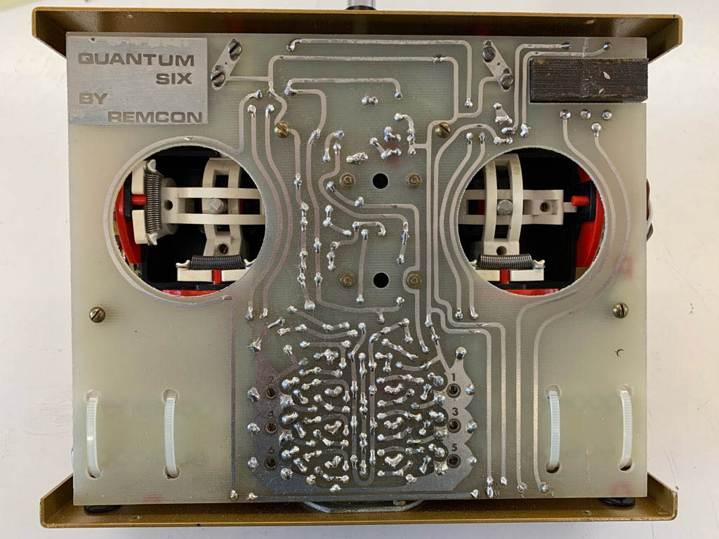

I came home with a large box of parts that together with a Jan/Feb 1969 Radio Modeller mags meant the project was on. Then the first lockdown happened and my daughter and her family who lived in London moved in with us to shield her from Coronavirus. With a full household it was shelved until October when I got started on it. I had a new circuit board and semiconductors and I was going to use new resistors and capacitors as the old ones may not be very good any more.
I got the circuit board built up and applied power for the first time and ..... nothing. It didn't work, drat!! I checked all the components again and everything was right so I was puzzled. I then put it away again and got on with another project of building a Vario Chinook over the latest lockdown when the family stayed at their own home.
Fortunately Pete Christy came riding to the rescue. I sent him the circuit diagram and he talked me through the circuit analysis with my oscilloscope and the fault was found. A dead transistor. But for the help of Pete and with only my rudimentary knowledge the project was stalled, but with his help it now works fine. Thank you Pete!!

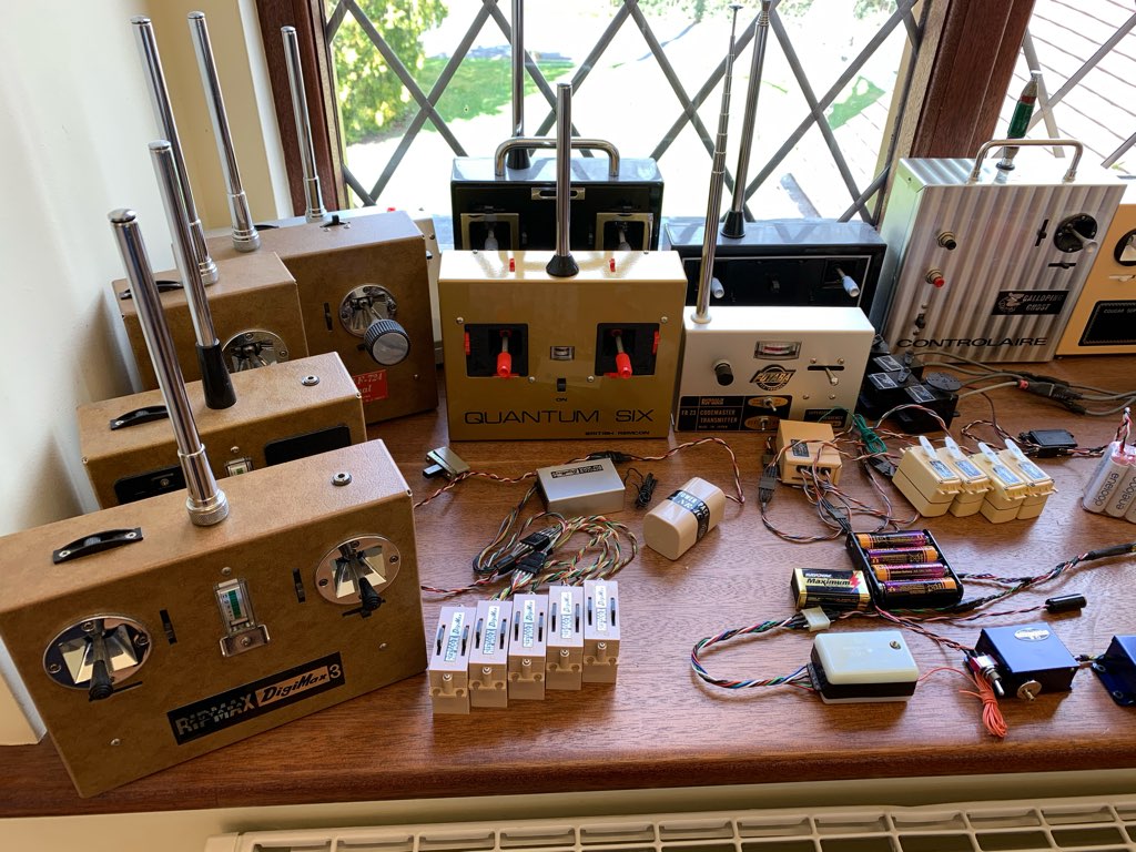

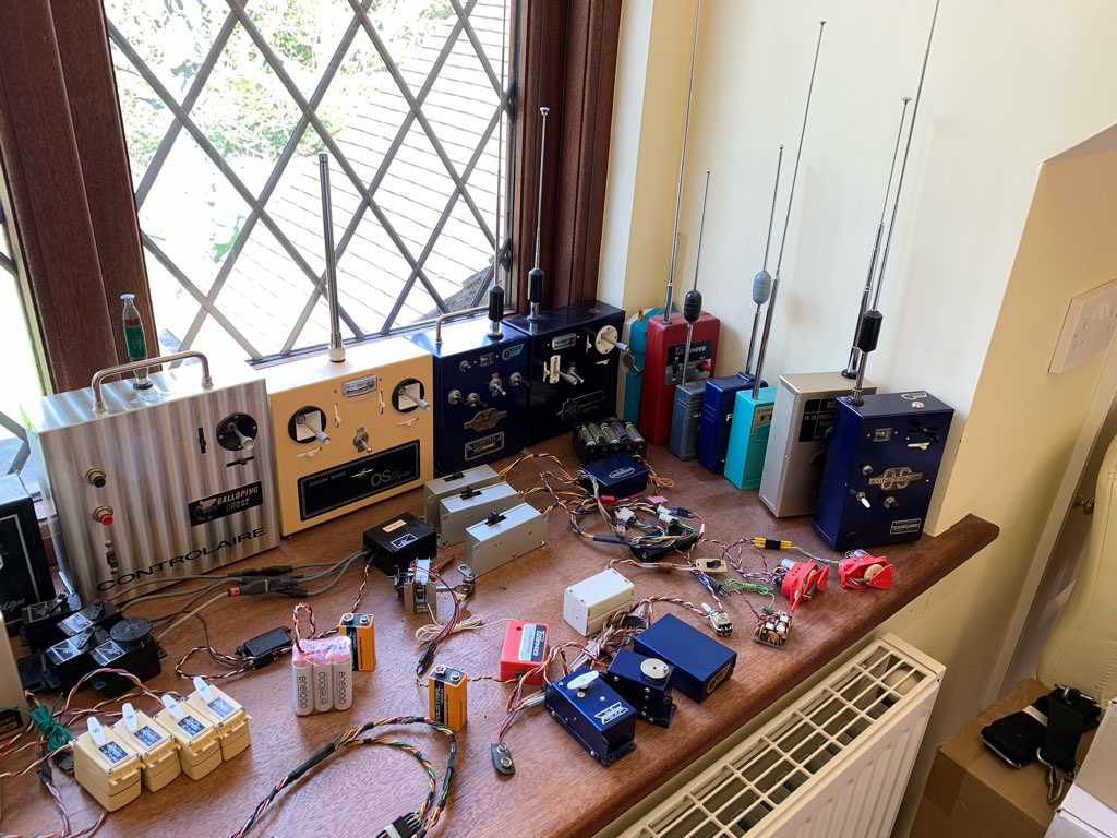

Thanks Mike it all seems to work now. I am not sure how to use the "place in line" box though if you could maybe shed some light on that. I am short of working servos. I collected about 11 used ones at the time but they are all faulty. Three of them move very slowly and the others are dead as a dodo. I have no circuit diagrams of the servo amplifiers either. I do have 4 other working ones that I bought on eBay a long while back so I can make the airborne set work but it will be two servos short of complete. Any suggestions would be very welcome.

Jonathan, mouth-watering shelf selection of great radios you have there!
- Posts: 9
- Joined: 27 Jul 2020, 13:36
Re: Quantum 6 the first new build in decades
Thank you Stuart. I have quite a few more in their boxes and change the display around from time to time. For me it has to look in time warp condition and work. This sometimes means making one set from a number of them to achieve the new look.
