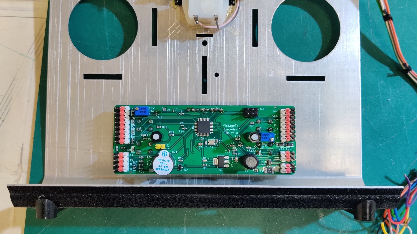

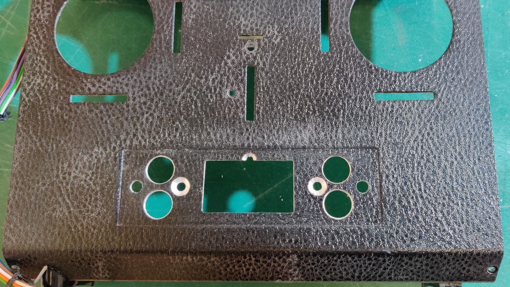

After Shaun and Phil's Retro Flying at Pontefract Mike kindly gave me one of his 10 model memory conversion boards. He also supplied a Digi-Fleet transmitter to convert
The board is one of his smaller GTB encoder boards. I have followed Mike's manual which is very good. Only issue I have found is to make sure the Joystick gain pot RV1 is fully anticlockwise or you will only get half of the stick movement.

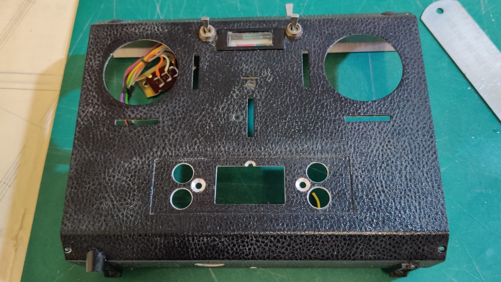

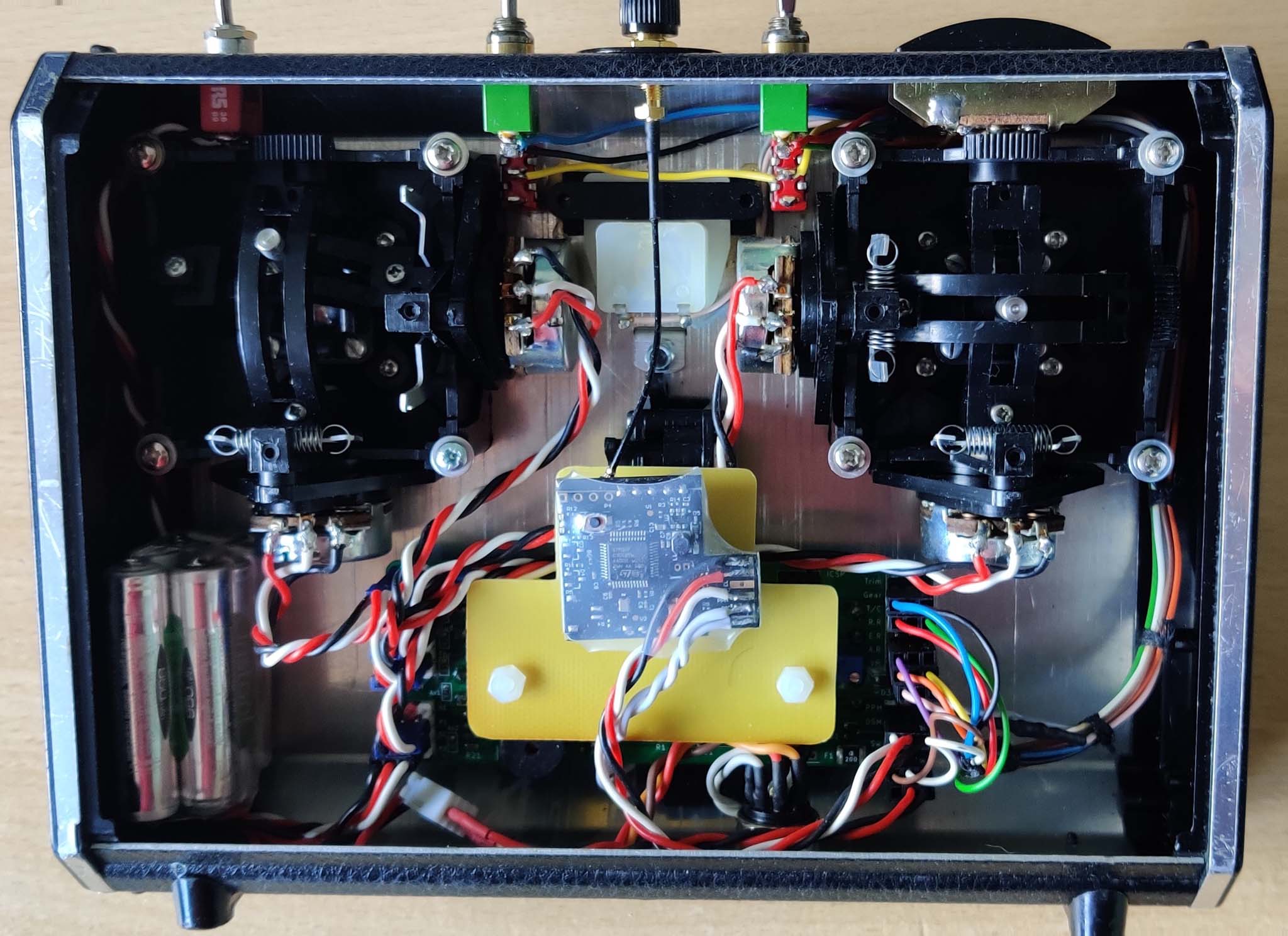

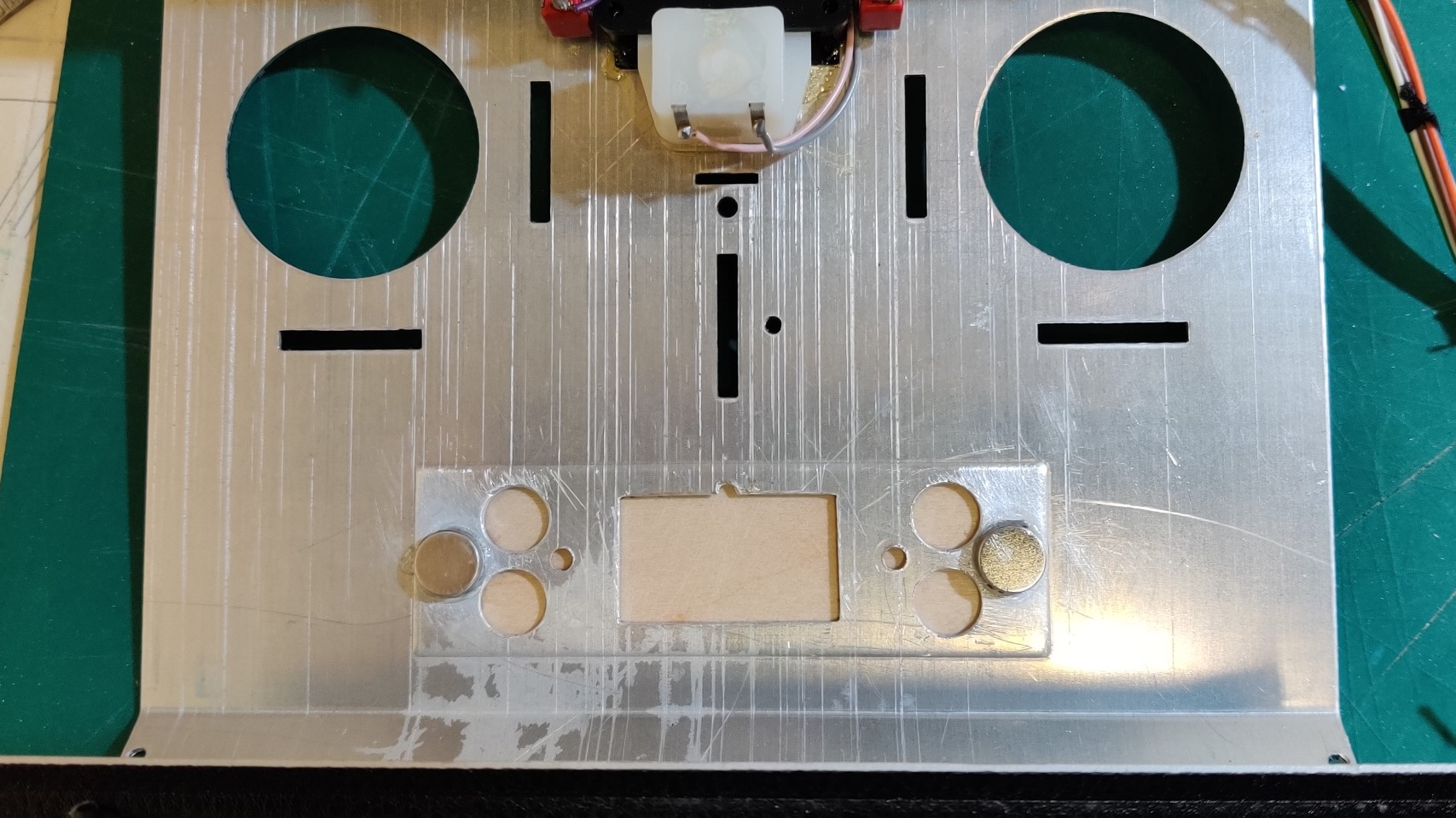

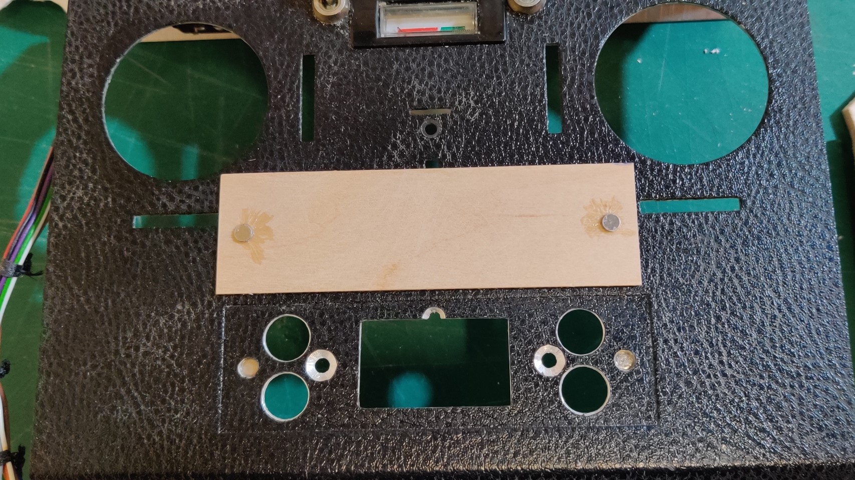

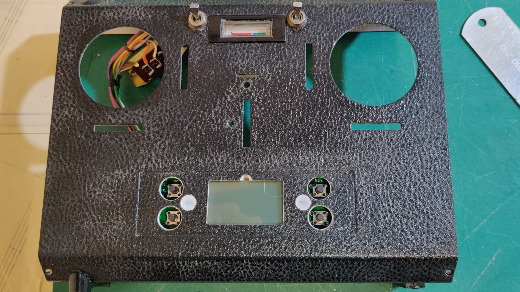

A few pictures of the conversion as follows:

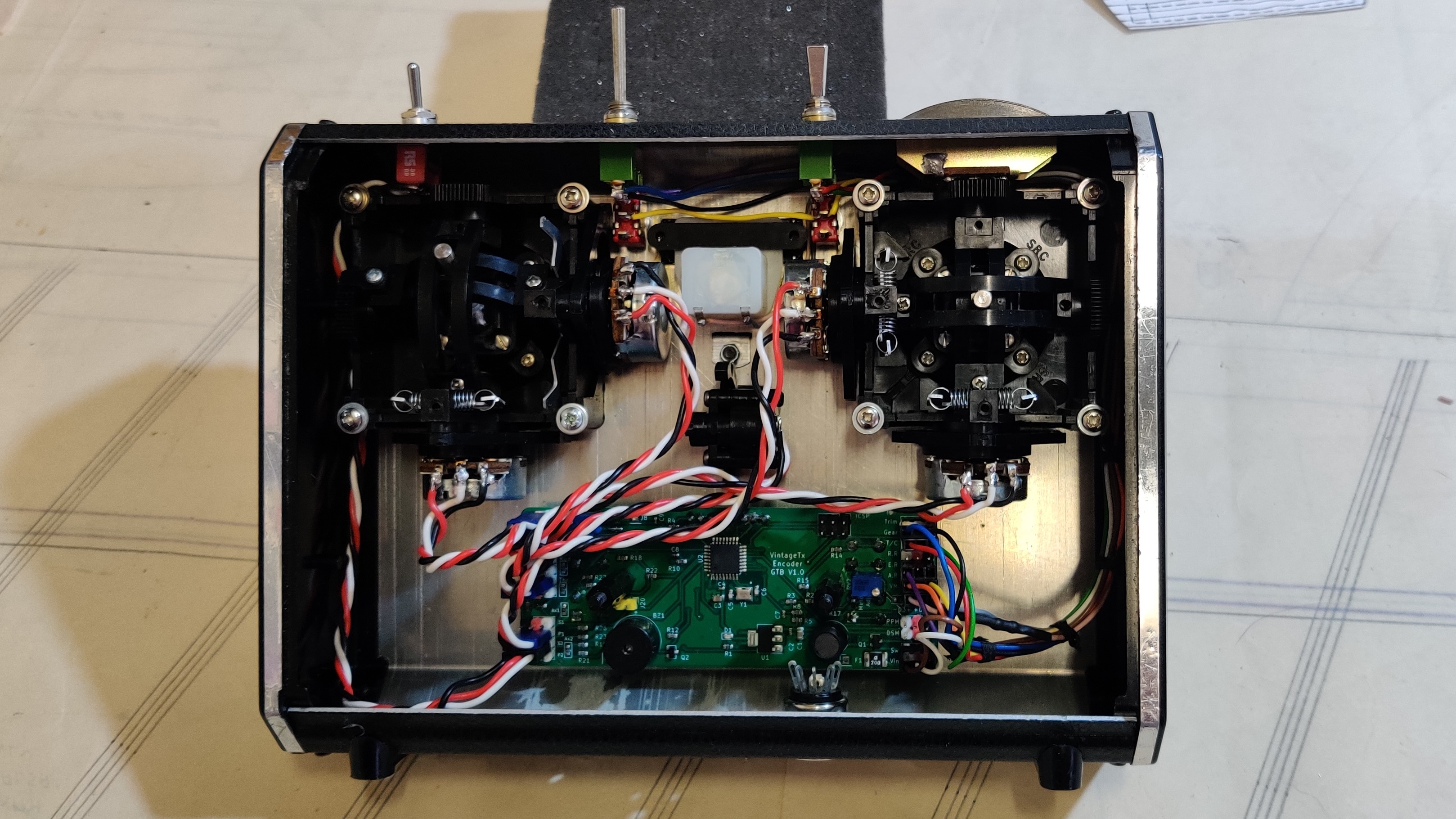

I have reused the existing wiring for the switches and the meter. Looks a lot neater and I only had to crimp some servo connectors on them. I replaced the wiring on the sticks as they were not long enough and also they move a bit when the trims are used so I was not happy using the old wires. It is very tight in the case I had trouble fitting the switches in the top. I had to put the spacers on the outside. Got the meter on the case working but had to add a 10k resistor inline with it. I used the "meter adjust" pot to fine tune it.
Still waiting for a a lemon diy tx module to turn up and a 2s lipo balance socket to I can get the 5-pin DIN plug wired up. I plan to run the 3 wires for balance plug on the 2s lipo and binding to the 5 pin DIN as Mike has done on his. Don't really need to do it as the case is really easy to open.
So far I am happy with the conversion and Mike has done an excellent job. I'll update when I have finished it and tested it out.

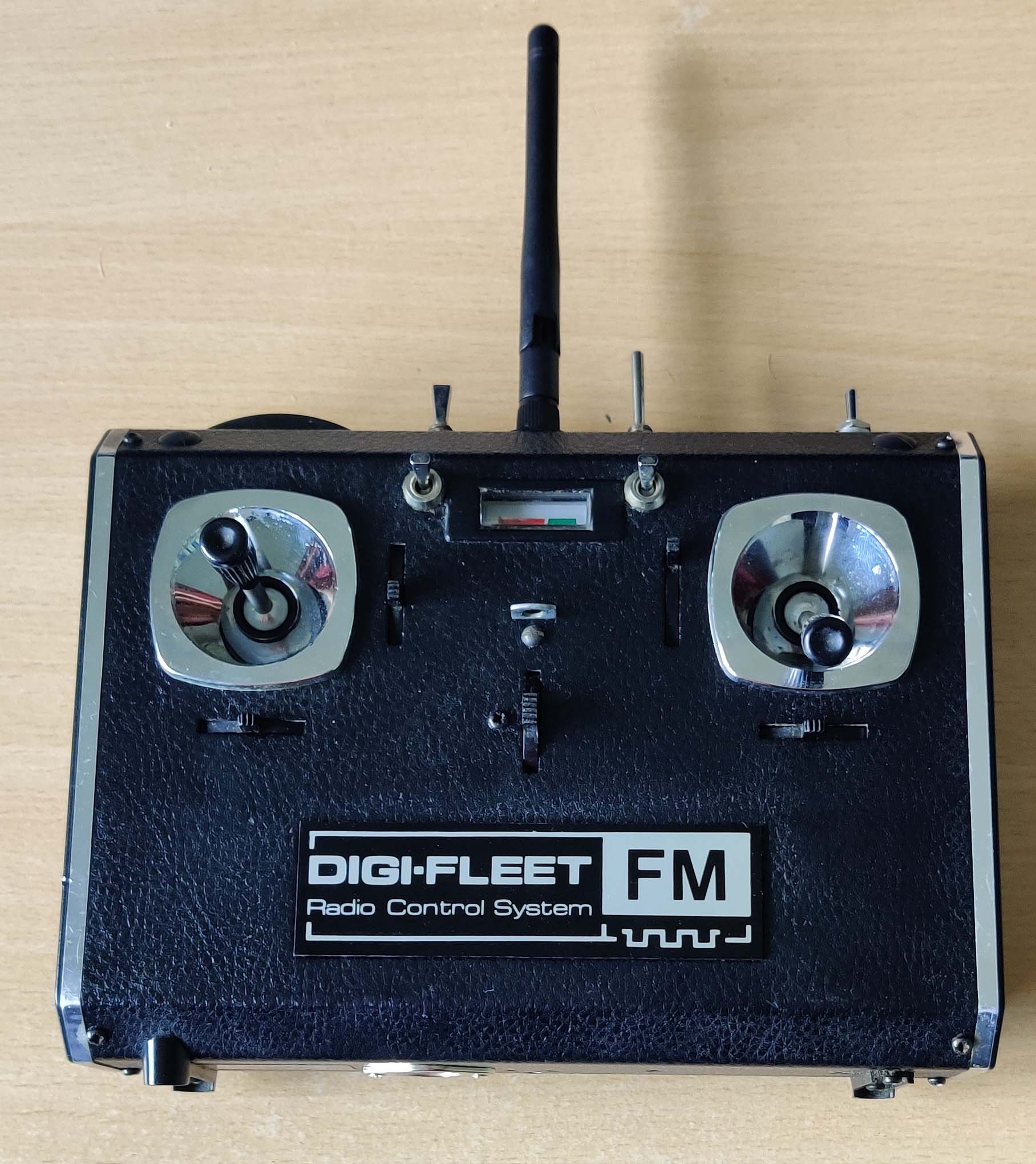

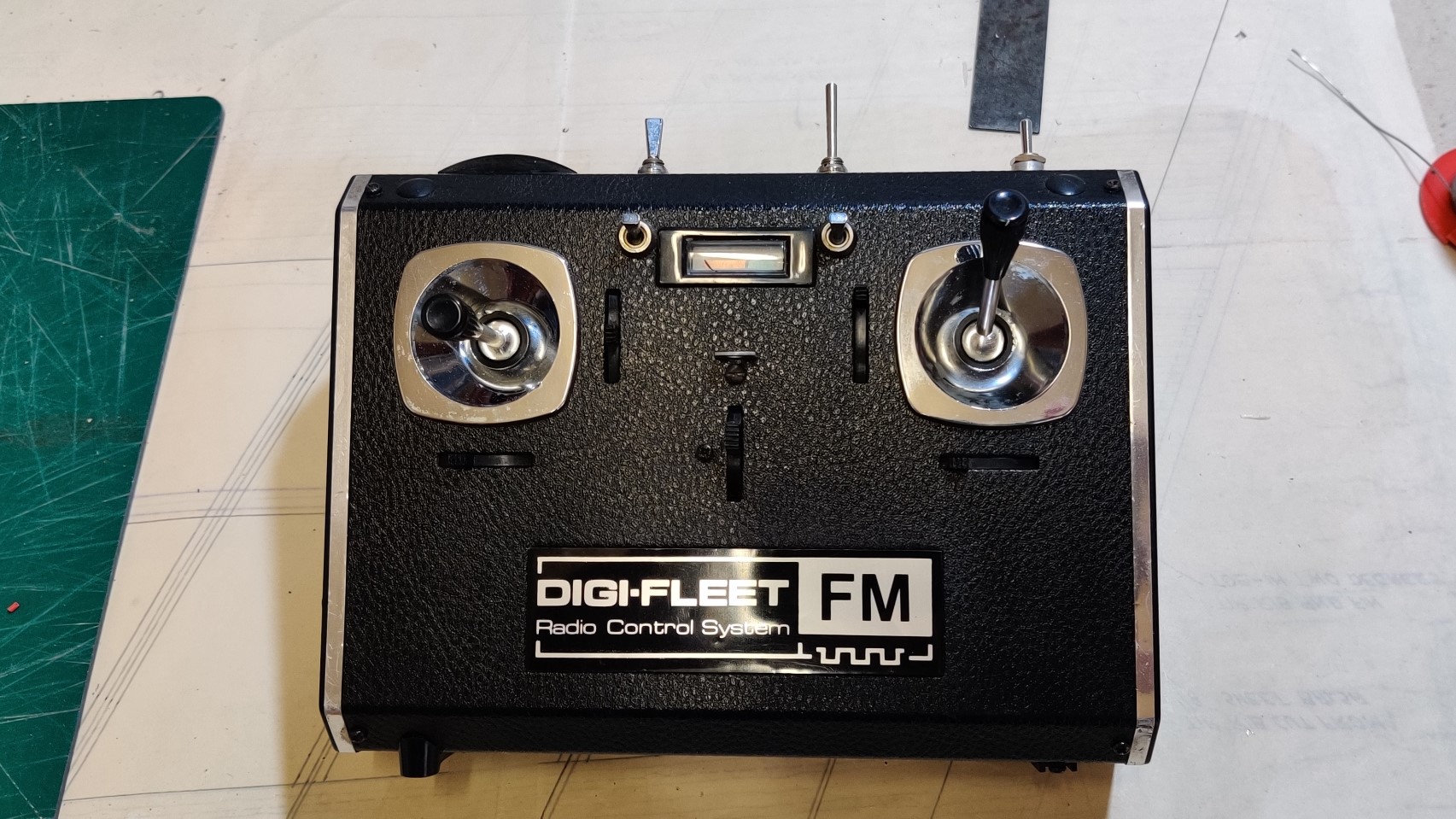

Great job Rob but you've put the throttle stick on the wrong side

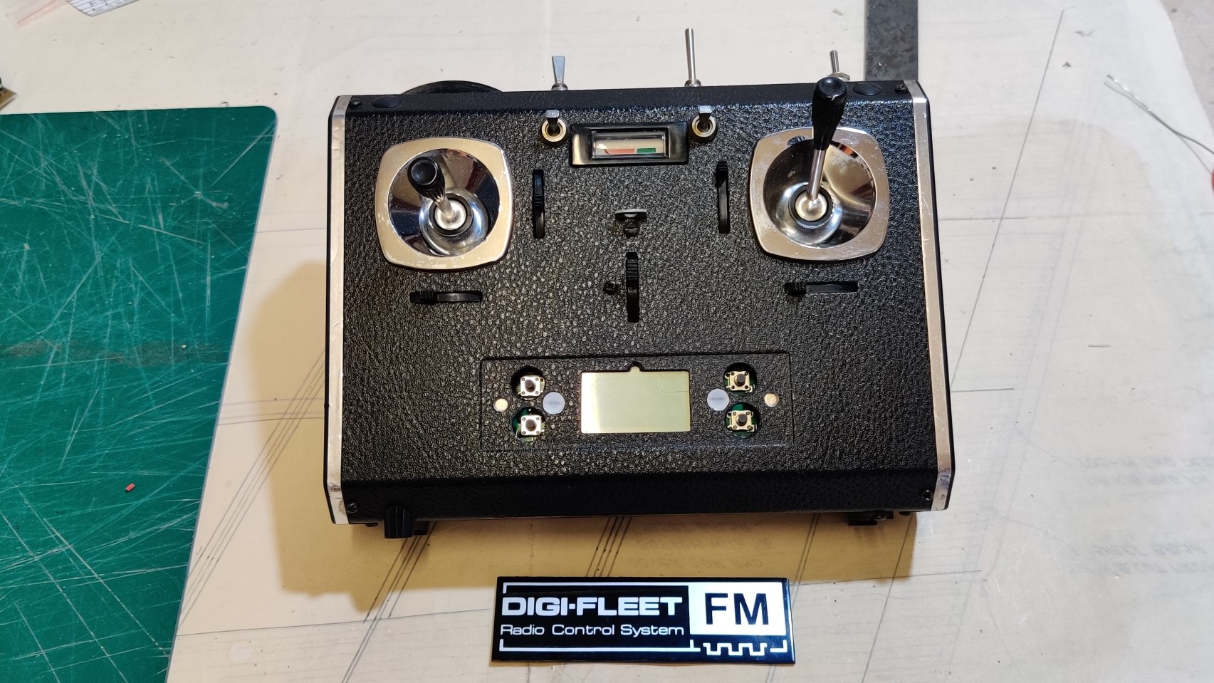

It looks like you're doing a really neat conversion and I'm pleased the Fleet cleaned up as well as it has, the before and after photos look so different! And the wiring is looking very neat and tidy inside, I agree that re-using the original wiring is a good idea if there is no corrosion.
If the Digi-Fleet badge bent slightly when you removed it, I've got a couple of others removed from cases too badly corroded to use, but the badges are good. I need to put in the instructions to use light heat from a heat gun to help lift the badge off.
As you're using mode 1, don't forget to go into the settings and make sure that "mode 1" is selected, otherwise, your throttle and elevator will work in reverse and the "throttle lock" alarm will be going off at every startup or when you change models.

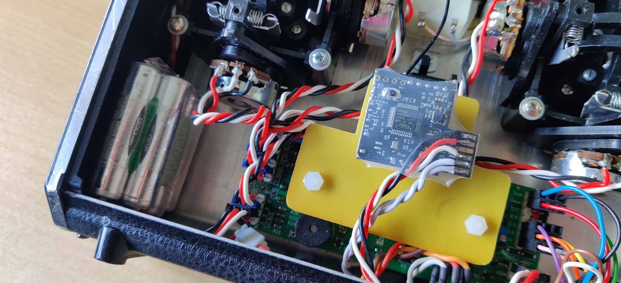

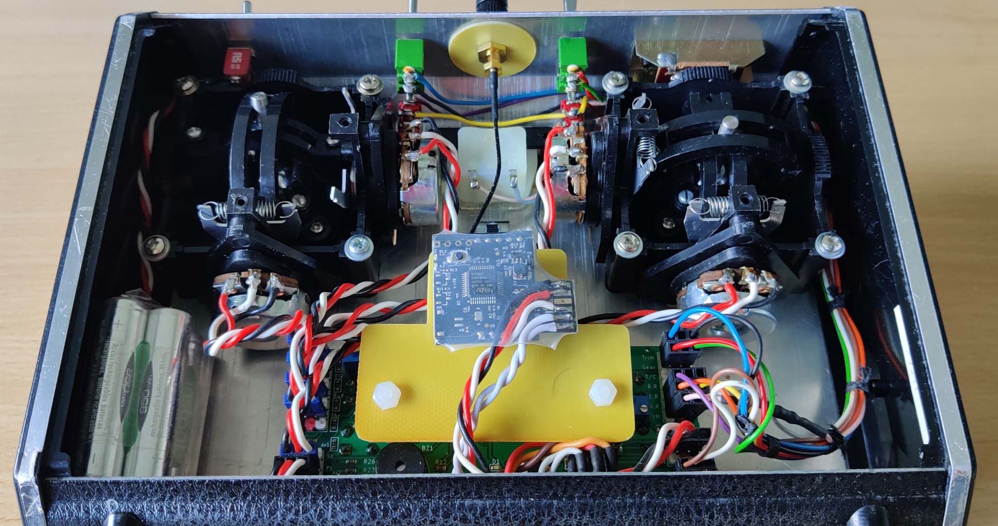

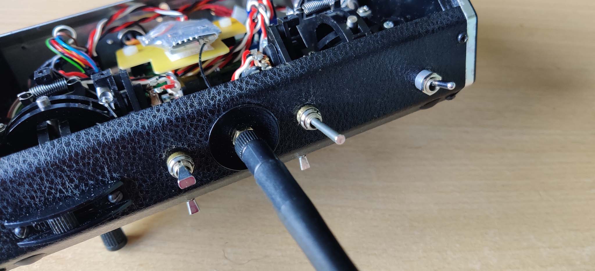

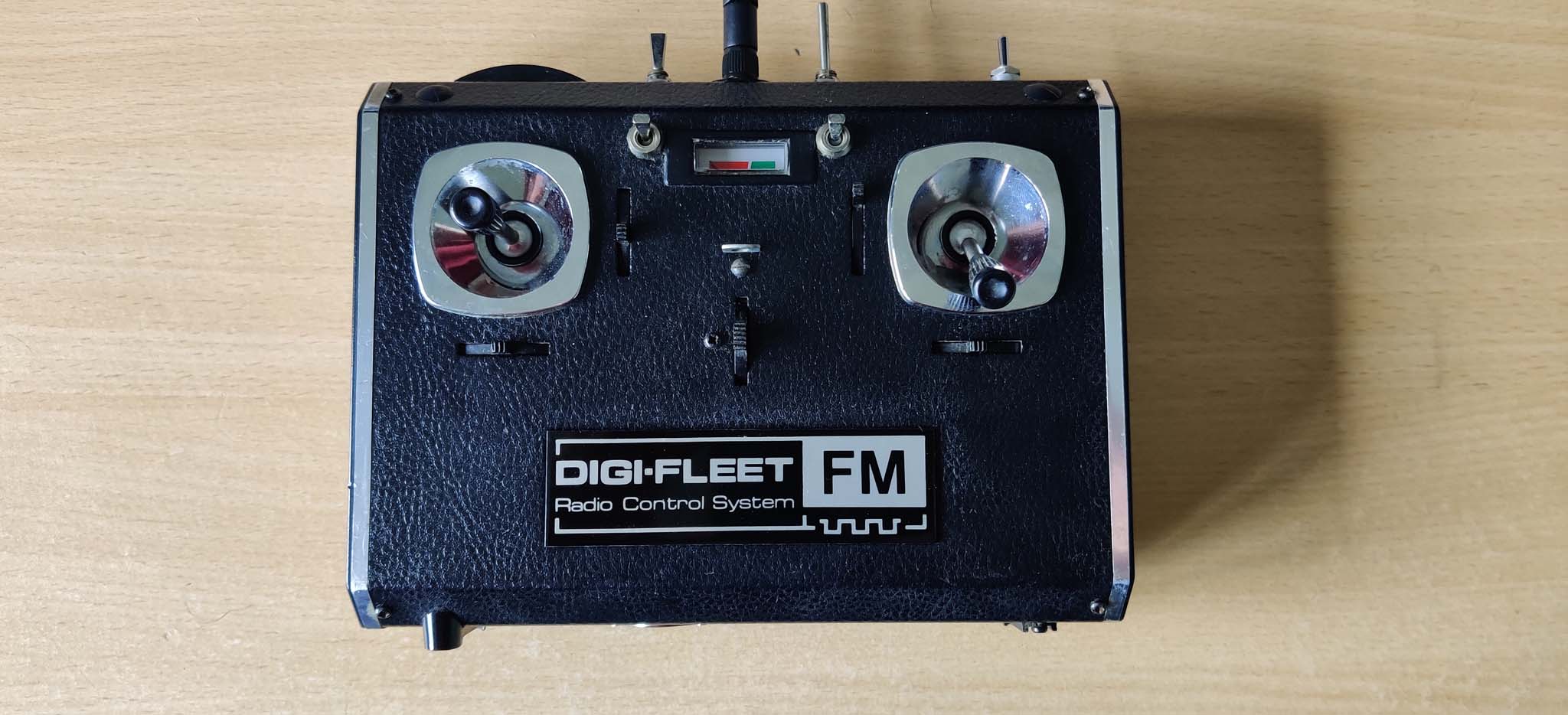

Finally got on and finished the conversion. I cut out the mount for the Lemon TX module from some 1mm epoxy board I had. The antenna mounts were cut from the same epoxy board using a hole saw. I painted the top piece black to match the case. I was going to use a 450mAh 2S lipo but I don't like using them in transmitters. Finally made a 6 cell NiMH pack using some 950mAh Vapex AAA cells which work well.
A few pictures of the completed transmitter.

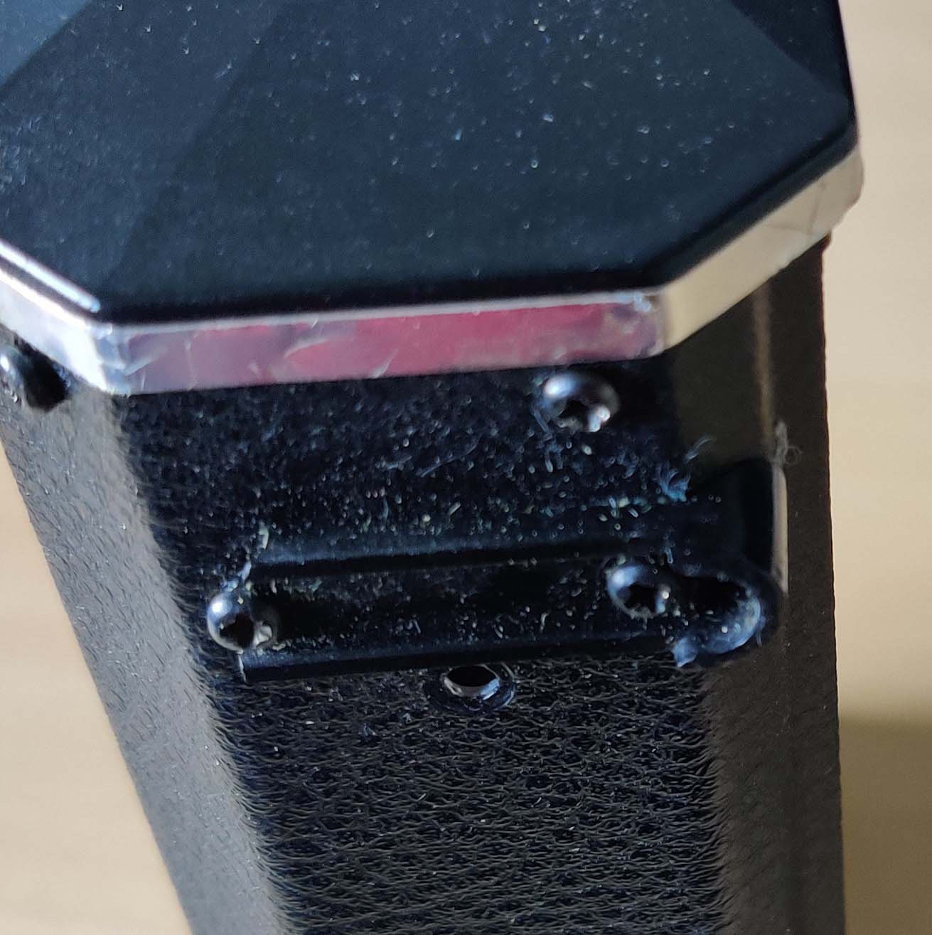

Only problem I have is one of the "feet" on the bottom is broken so it will not stand up.
If anyone has non broken one they can send me it would be much appreciated.
Mike the badge looks fine. I think the light in the photos make it look worse than it is.
Rob.

Cracking job Rob. Just need to get itt flown now.

A lovely neat conversion Rob, thanks for posting the pictures. I think your extended module mount is a better idea than me fitting a longer IPEX to SMA extension lead, it's always best to keep the lead as short as possible. And have you used 14500 Li-Ion batteries? I've bought some with very low capacities, they advertise 1500mAH, but when put on a discharger they only have a hundred or so mAH, so check the true capacity before flying.
Another minor thing I've spotted is that you haven't fitted a link to the LemonRx channel 5 resolution. By default, it has a low resolution on Channel 5 so that it will operate the LemonRx stabilised Rx with a non-computer transmitter conversion. Unfortunately, this encoder uses channel 5 for the second aileron by default and you may prefer more than 32 step resolution on your left aileron!
There are a few easy ways to resolve this (assuming you have two aileron servos and they are individually plugged into the receiver):
1. Use a 6 channel (or more) receiver and use the channel order/assignment menu to move the second aileron to channel 6 (you can change the default output order in the System PPM&Channels menu so that the gear channel is on output 5 and the second aileron on channel 6)
2. But the better solution is to solder a link to the LemonRx DSMP DIY module as per the instruction manual
https://drive.google.com/file/d/1voYsft ... p3ySo/view
Besides that, I think the LemonRx module is a good choice and it's definitely a more reliable module than the OrangeRx DIY hack module as well as being cheaper, more readily available, physically smaller, proper warranty (if you ever need it), and excellent support. Its only real downside is that it will only work on the protocol it was bound to last, so you need to use receivers all of the same types if used with multi-model memory transmitters like this one. I only use DSMP LemonRx receivers which use DSMX 11mS with the module, so you don't have to keep rebinding such as if you used a mixture of other receivers like say an old AR6200 DSM2 22mS receiver. By contrast, the OrangeRx module can change protocol without rebinding by pressing the bind push-button rapidly 3x and it indicates which protocol is selected by flashing the LED.

A really nice conversion. With regard to the broken foot, I bought spares from Derek Olley in 2002 and luckily that included some feet. If you send me your address, or if you prefer email as you may not want to advertise where you live, I will gladly post one to you. My email is jamesiparry@talktalk.net
James
