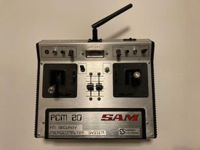

Alongside the Skyleader I was 'gifted' a Simprop PCM with plug-in F3A module.
I was hoping I could retain the module and take the analogue signals at the input of the 8 channel ADC IC to feed a new encoder. Whilst some channels were easily identified Simprop had multiplexed the others. It was quickly apparent that the best option was to use Mike_K's F3A variant of Phil_G's encoder.

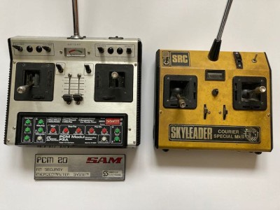

Here is the result, implemented on a DIY More board - awaiting switch labels though. There is a little loss of function compared to the analogue module but possibly only flap->elevator might be missed if the model has flaps. The module (with all knobs...) is still there, glued in place for looks only. The LemonTX module is in the plug-in 35MHz housing on the side.
The trims are electronic and unlike the Skyleader were applied in the F3A module. A little Vero 'daughter board' was made to connect the stick/trim plugs so their wiring didn't have to be changed and the 10k resistors to couple them could be easily accommodated. So the servos can be reversed via the plug - as original - or via the encoder.

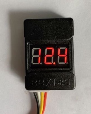

I've made extensive use of, and come to rely on, telemetry for the electric flight-pack. Obviously these conversions don't have that, but I have found a simple, inexpensive, 'Fly-By Audible Telemetry' solution for on-board monitoring...
I was looking to change the battery meter to one like this but that's another story...

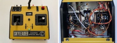

Any chance of sorting the Skyleader link so that it takes us to the Courier rather than the Wee MacGregor
