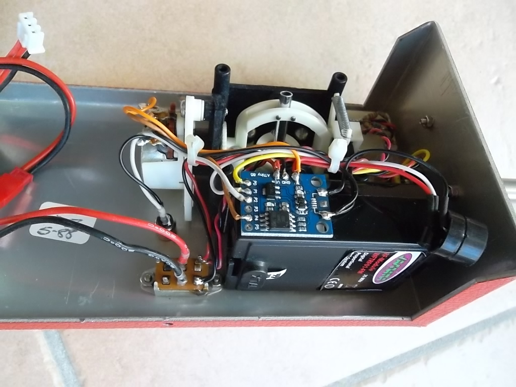

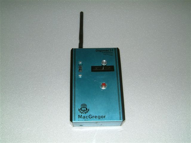

The original Digimac-1 by Macgregor had just a proportional rudder servo and nothing else, no throttle and no rudder trim. Macgregors 1+1 update gave the set a sequenced throttle servo - low, mid, high, mid... repeatedly, changing once per push of the throttle button. Years ago I did a PIC encoder which exactly emulated the Macgregor 1+1 in every way, no extras or refinements - just an accurate emulation.
The Macgregor Digimac 1+1

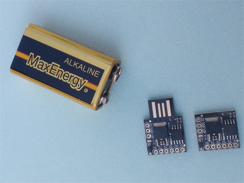

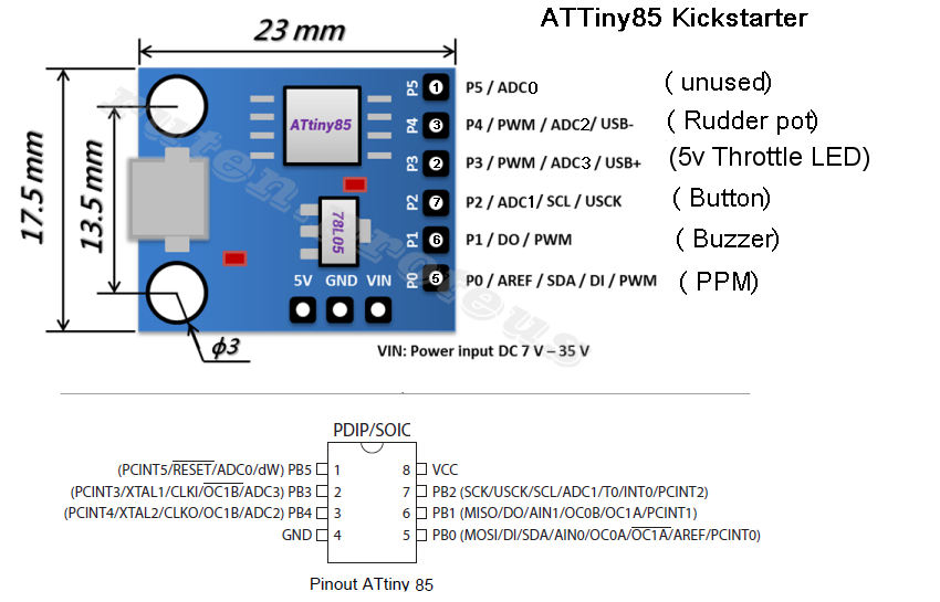

Here is an improved version of the "Digimac 1+1" based on the cheap-as-chips Digispark ATtiny85 board. The Digispark is a tiny 3/4" square Arduino thats really convenient and dead easy to use as the headers have the normal 0.1" spacing. I always remove the redundant USB plug, and also the redundant SMT diodes D1 & D2 which can be removed with your thumbnail (as explained here).
Digispark USB removed...
This emulation adds a few facilities over Macgregors original, all of which are optional but I think should prove useful in practise. Its basically a stripped-down edit of the 7ch encoder, with Franks throttle idea and some "1+1 specific" bells & whistles added: Auto stick calibration, throttle position confirmed by an LED which is off for low, flashing fast for mid (where next speed is high), solid for high throttle, and flashing slow for mid (where next speed is low). There is also a buzzer which pips once for low, twice for mid and three times for high throttle. We have rudder subtrim, by holding the stick over in the required direction whilst dabbing the throttle button. Trim is saved to flash memory. It has a presettable mid-throttle position, so it no longer needs to be exactly 'half' - half throttle sometimes doesnt suit a model, it may be a bit too low or too high to maintain a steady cruising height. IC engines rarely have a linear throttle response, and the half setting might well give 80% power.

Programming the Digispark needs the home-made ICSP adapter, you cant use the USB bootloader as it has a 5 second startup delay (yes, five seconds!). This means that for 5 seconds, your set would be powered up but not sending any PPM to the module. Corona modules default to 500uS channels in the absence of PPM. 500uS is so far outside the usual 1000 to 2000uS range, that this can cause servos to jam against the end stop and even strip gears. In any case a 5-second power-up delay is not acceptable for a transmitter, so ditch the bootloader!
One thing I've noticed with one or two Digispark boards is that the clock frequency (nominally 16mhz) is stable but can be a little bit out. In the datasheet the manufacturer states that the clock is factory calibrated to within 10% but can be further calibrated by the end user to within 1% using an oscillator calibration register.
Out of dozens of Digisparks I've only found a couple that benefited from a 'tweak' of the timing. If yours is badly out, then in setup() I've included an optional OSCCAL setting where this can be compensated - though its a bit trial-&-error. To avoid recalibrating every time its easier to check the elevator channel and adjust OSCCAL in units of say 5, until the elevator is near enough 1500uS.
If you've not yet built a PPM tester then comment out the OSCCAL line, it won't be that far off without it, whereas a 'wrong' or guessed OSCCAL value could be way out. And once you've 'osccaled' a chip, the factory value is gone, overwritten - theres no 'restore factory defaults' :-)

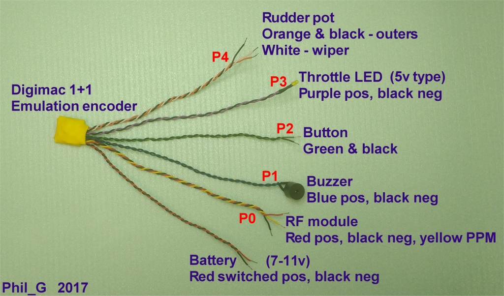

So far I've been sending these encoders out pre-wired with flyleads and shrink-wrapped, but the files are items P20 and P21 on the Archive page of http://www.singlechannel.co.uk if anyone fancies a go. The biggest pain is connecting up a 6 negative wires into one, so it will solder into the solitary 0v hole. Thats stick neg, button neg, LED neg, buzzer neg, battery neg and RF module neg all commoned together into 1 wire, bit of a Medusa-thing going on there but thats the beauty of heatshrink - who would know? :lol: :lol: :lol:
Quite a few pre-wired Digispark encoders have gone out and feedback has been good. I'll do a demo video as soon as I get chance. Oh - one last thing - if you use a 'Frsky V8HT' or a Corona module dont forget the schottky diode in series with the PPM line, banded end to the encoder (BAT42 etc).

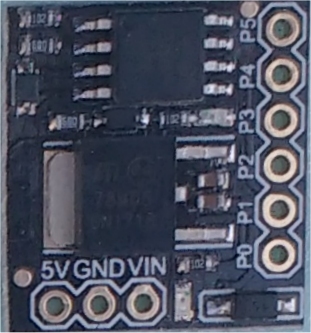

The Digispark board, 3/4 of an inch square!

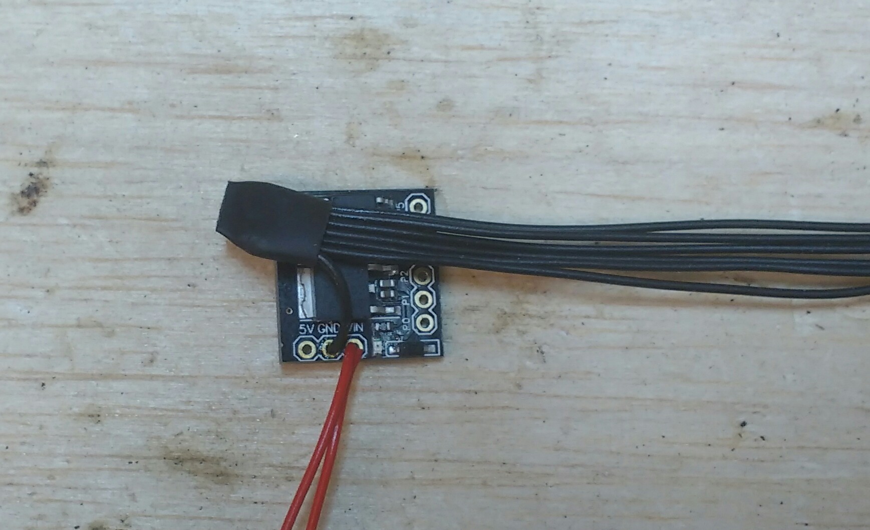

Prewired board as I've been sending out
Connections P0 to P4, P5 usnused

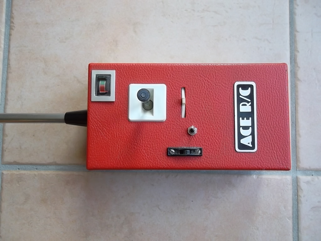

Here is on of my latest conversions, an ACE Pulse Commander. It uses Phil´s latest Digimac MK3 sketch without the trim function, which is not needed here. Flight test happened already flying a Sharkface with Tobe´s Adams clone. No problems, everything worked perfectly.

That’s a very nice Transmitter Frank,
I wouldn’t mind a go at reproducing one of those, that red car leather stuff might work well on that.

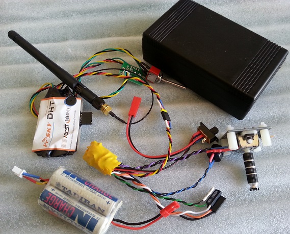

I'm well on the way with my own version - all the bits are assembled & working perfectly on the bench.
need to shorten some of the wiring and then put it in the box

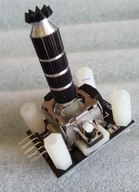

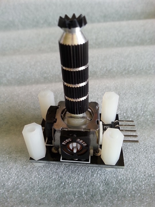

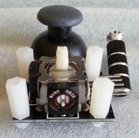

Being 'frugal' (i.e. a tight ar :o) and having a few in my components box, I've decided to use a dual axis game console PS type stick assembly - since I only need a single axis, a slotted hole in the case will effectively 'remove' the 2nd axis function.
the original 'gamer' knob in the background, plastic shaft threaded 4mm for the "bling" stick extension. The stick shaft has a 1.5mm hole down its axis, which I deepened and glued a piece of wire into to make the whole assembly a bit stronger (I hope!?!).
stick extension added. The nylon stand-offs enable the assembly to be mounted to the front of the case.
These units also feature a push-button function, which I shall try. It works perfectly on the bench, but if it doesn't feel right when flying, I'll simply use a separate button.
showing the push button which has a very positive action, press down on the stick to activate.

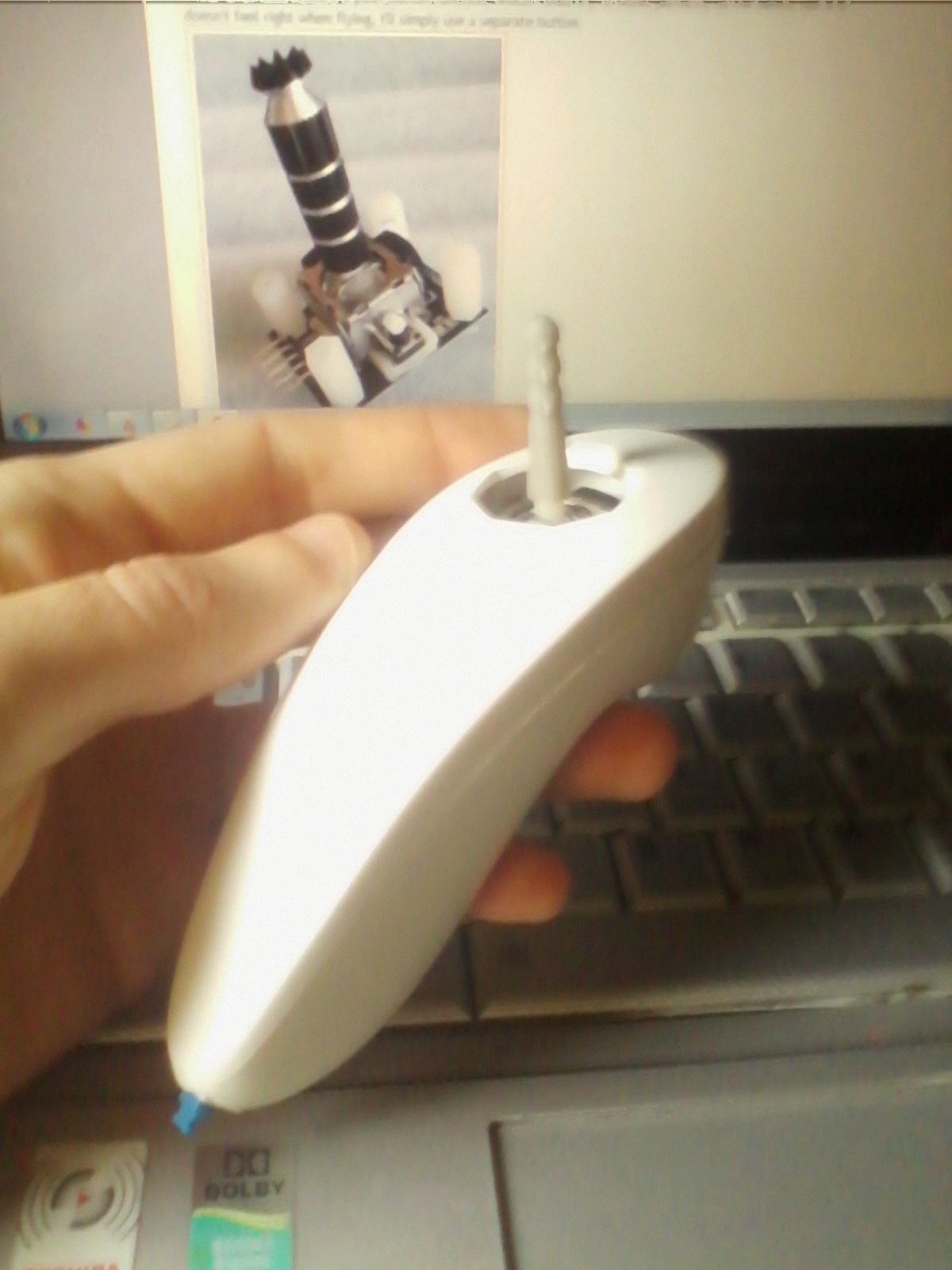

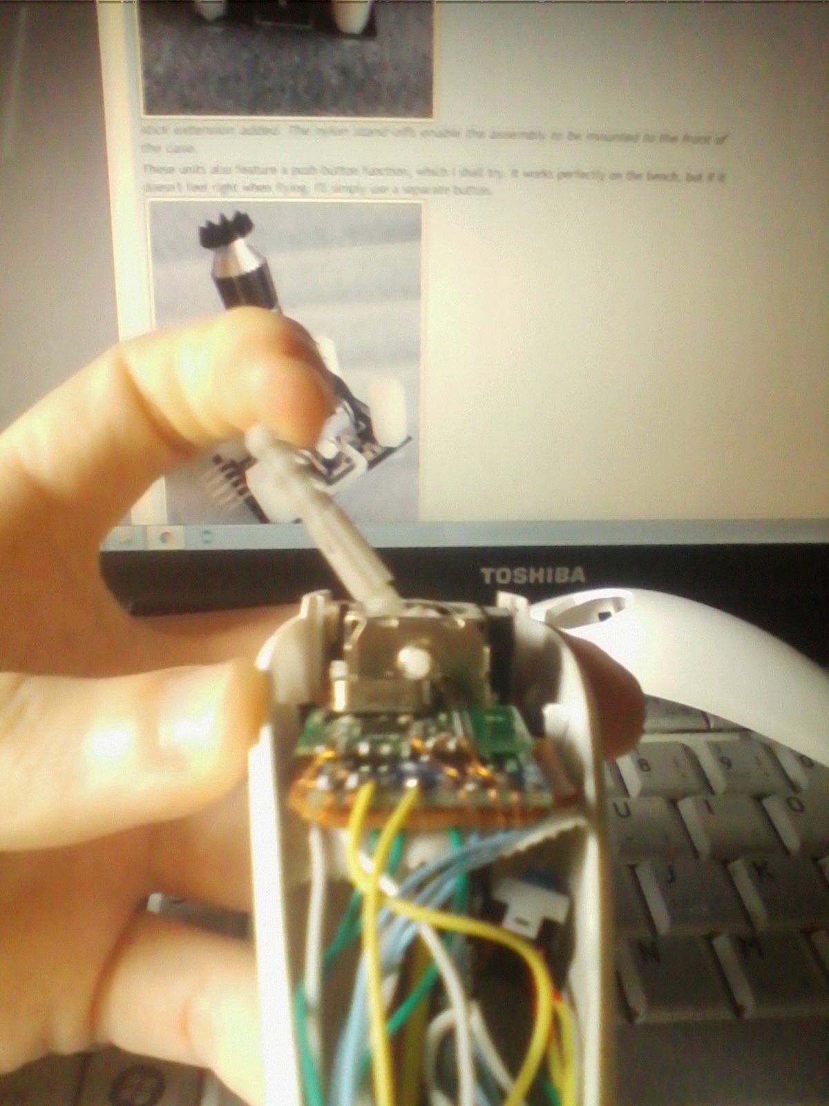

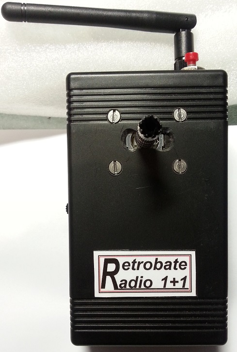

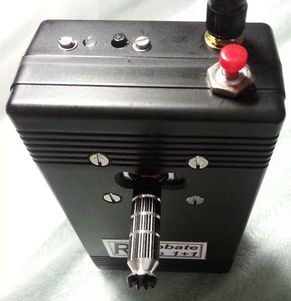

OK, it all fits & it works too :D
Its only a cheap plastic case off Ebay, but it'll do! The slot for the stick had to be opened out at the ends to allow full stick throw due to the short length of the plastic shaft and the stick extension. Looks odd, but it works!
If I were putting it into a metal case, I'd clad it with stick on vinyl to hide the screws. The plastic case has too many ridges & rounded corners for the vinyl to adhere to without peeling or lifting.
red button is in parallel with the button on the stick assembly
I found an issue with the push button integrated with the stick. It only works consistently when the stick is at or near neutral. Consequently, I added the separate button.
Had to have a label...............
It all looked too plane & dark without something to contrast, hence the tongue-in-cheek label :lol:
Hopefully to be test flown on the weekend.

They feel surprisingly good Al, especially for the price. The resolution and linear servo response on the bench are great.
Of course, there is absolutely nothing "exotic" about them like adjustable stick tension, etc. I reason that they must be relatively robust given the gamer application - I've never seen a gentle-on-the-gear gamer when in the heat of battle :roll:
I'll update you after test flying ;)
