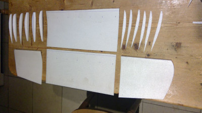

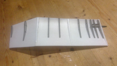

These the parts for the wing - though haven't quite decided how to do it yet...

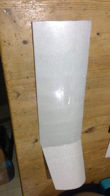

This picture is a Wizard of Oz tailplane 14 inches - and is the simplest form of wing / tailplane ie ribs, no spars
This works fine - but you need to have fairly frequent ribs - and for them to have a reasonable camber. It's the camber that stops the wing folding - if the depron is just flat it bends easily

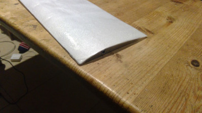

This is (half) a depron wing - 18 inches
I covered it in A3 doculam (laminating plastic) which explains the shine - tips not covered

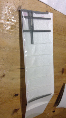

This the original and a higher aspect ratio version - 21 inches
I use a small piece of an aluminium arrow as a tube and carbon fibre arrow repair tubes as a wing joiner - not a good photo but usually 1/3 back from L/E
On larger wings I use two joiners. If I use two joiners I make one longer so that if I feel like it it can become a wingeron wing

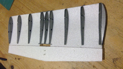

The underside can be made in different ways - mostly depending on how strong you want it to be
This has 6mm ribs (which go in first) - then longitudinal spacers. I tried some cross bracing with dental floss - didn't seem to make much difference but strong stuff.
Doculam on root half of the wing+ on top and bottom - which makes things very strong.
One wing half is 22gm

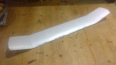

On my 50 in Zeitgeists one has 2mm depron top and bottom and no spars - very strong if ribs are properly spaced - and really quick to build.

Build order is counterintuitive!

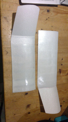

Mark out the rib position on the UPPER wing - biro is good
Put depron on rounded edge of a table and place two open hands. Roll the depron forwards and back - a combination of hand heat and rounded edge of table works fine. You can steam over a kettle / bind and pour boiling water but I can't be bothered.
You may get some longitudinal crinkles on the concave surface and this makes no difference - avoid rib-wise crinkles - you set yourself up for a 'hand clap' wing
Now glue / spot glue ribs in place taking care that the L/E lines up accurately, T/E not the issue
You can add a carbon fibre leading edge but not actually necessary. Sometimes it's helpful for the profile at the L/E but remember to cut an appropriate hole when you make the ribs (much quicker)
Now add the bottom surface - spot tacking is the way to go, starting in the middle lengthwise and spanwise.
Work your way along the span tacking at front / back of each rib - don't glue L/E at this stage
You would think it's easy to build in a twist at this stage but because of the top surface is cambered this doesn't happen
The last stage needs some (but not a lot) of care!
Makes sure the glue gun is really hot - the joining of tom and bottom surfaces is helped by thermoforming with the hot glue.
Start in the middle and only glue the LE between two ribs at a time
Work your way to root / tip alternately
The hot glue is extremely strong and you will end up with a surprisingly strong LE - if you don't believe me make a line of hot glue, let it solidify and then try to break it....
Key idea is that if you have no bottom surface make sure there is a reasonable camber. Doculam is cheap and very strong but don't overdo the heat or you will remelt the hot glue and at that stage you can build in a warp
2mm depron now hard to come by - 3mm is fine
